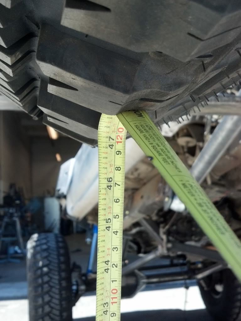

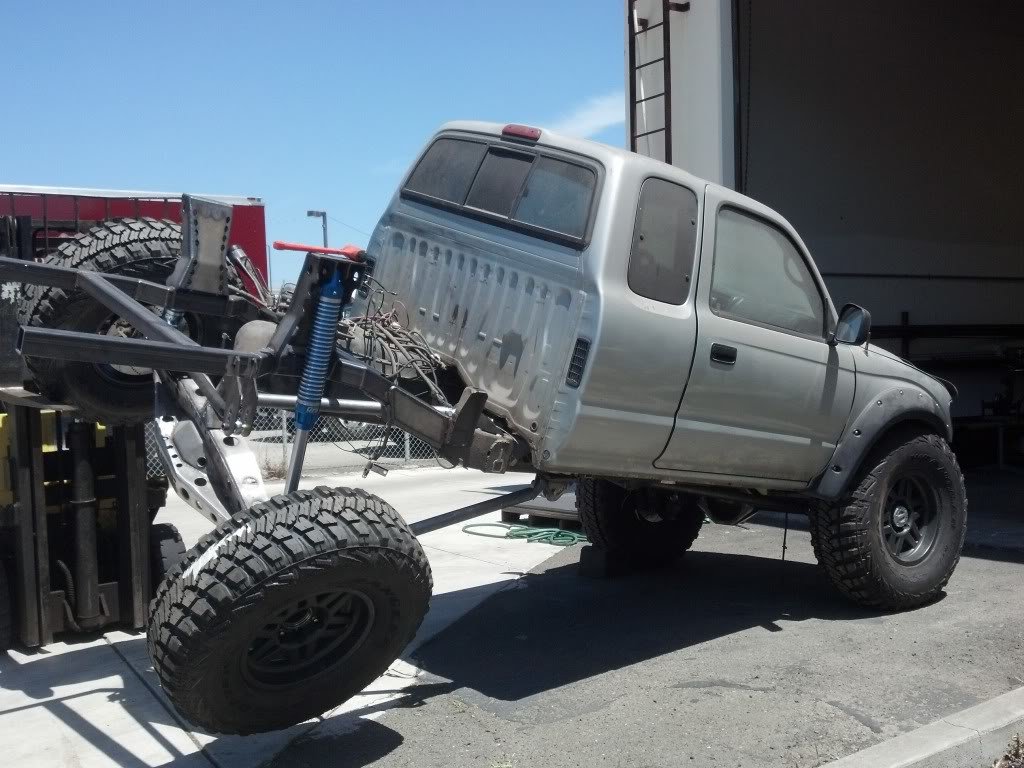

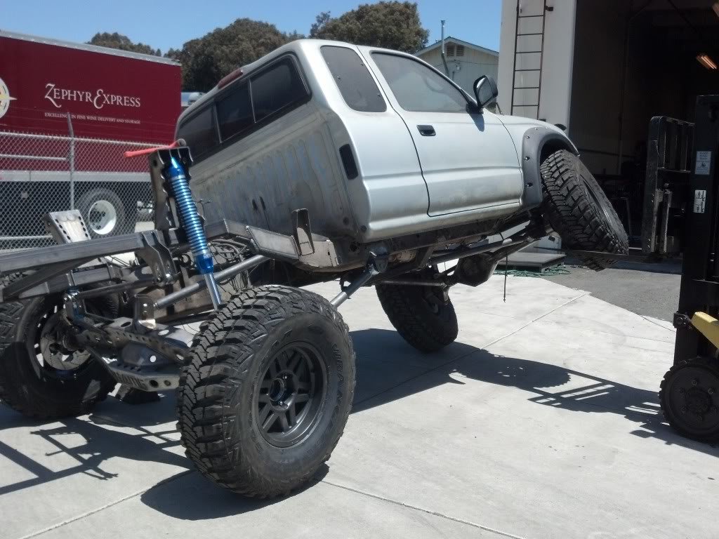

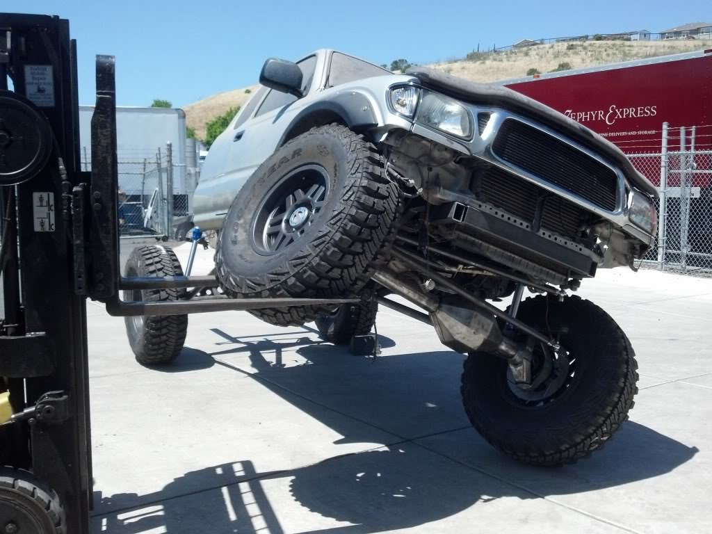

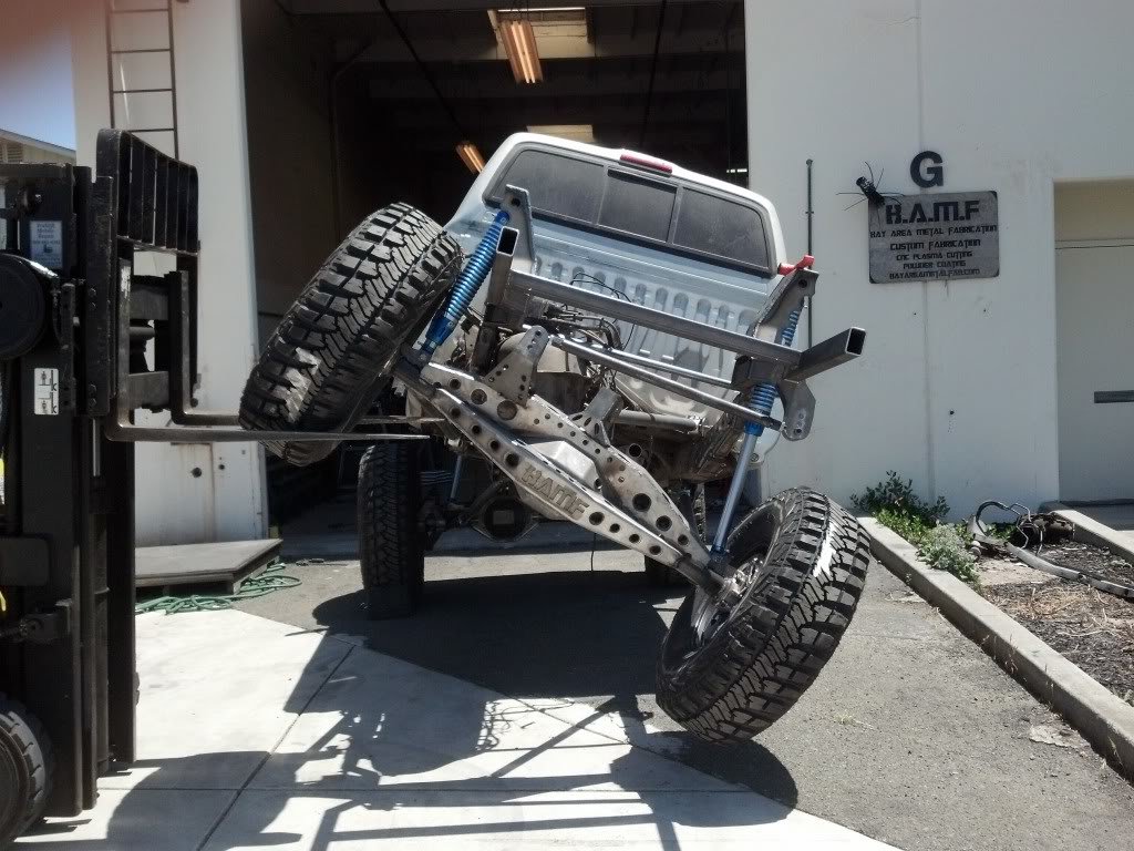

    I was pondering the same thing for hours in the pics it looks like it could be a lot longer but really only about 1.5" total is really all I could get before hitting the frame at full bump. I wanted it longer but the only way to do so would be to make it very low with a 16" drop off the frame or behind the axle about 13". The passenger side movement is only about 1.25" and it's at full droop where it happens. Making it longer might get it down to under an inch but I don't think it's worth the rework for that small amount. I'm going to move the frame side panhard to the lowest hole that should help a little with the side to side moment. With the negative slope of the panhard there is very little side to side movement from 10" stroke to bump so I don't think it will be an issue on the road just extreme flexing is where it will be noticeable. Only time well tell if drives funny down the road and I don't think it will I'll rework it.

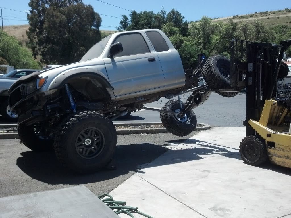

    :rolleyes:Not even 4 feet? :D

    Well that's with the rear tire back on the ground if I just lift until the front tire comes off it's well over 4' :cool:

    I'm sure it is, lookin really good. Gonna be an e-ticket ride for sure

    Look's like you finally figured out how to use the forklift to flex it out [​IMG]
