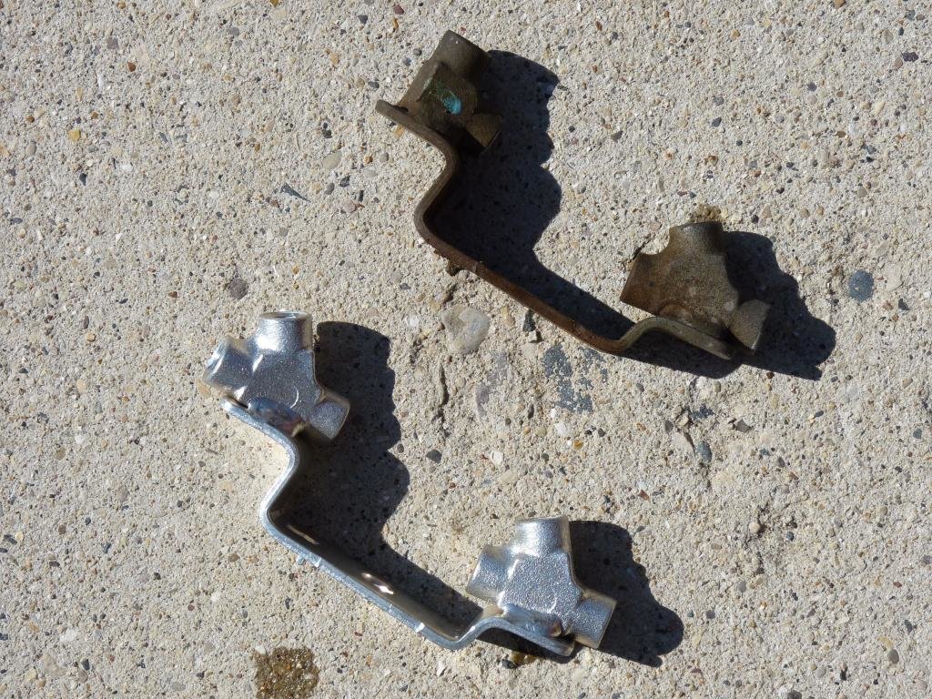

    I need a 1st gen guy without ABS to check their master cylinder and tell me if the back line is going to their front or rear brakes? I think i might have my master plumbed backwards :eek:

    The non-ABS master is the same, the only part I had to replace was this union, I can't find the part number though.:mad:
    The line (47321) coming from the back of the MC goes into the top of the rear union.

    Front line is for front brakes, rear line is for rear brakes

    Okay I've got them backwards :eek: I'm reading more about disk - disk and I'm reading I should have a four wheel disc brake combination valve Ted into my lines. Shit I've just got one line going to the rear and one to the front :notsure:

    Just T the front and T the rear and a single proportining valve in between the MC and rear disks. Fuck all that other noise.

    Yeah thats what i have but my lines are backwards :eek: i should fix that :D
