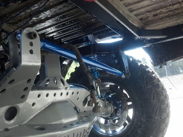

    I've got a little leak :eek:

    WTH is that break fluid?

    Gear Oil.

    It's coming out the ARB line that's not attached to anything my breather is not working well. It's a known issue with the 9" housing. I'm changing the breather to a free flowing line.

    Crap!!! Not good, dude. You probably blew one of the two little ARB air-to-gear oil seals in the carrier, or maybe the little copper tubing got nicked. :notsure:

    I'm reading that its a known issue with the RD99 ARB to seap oil into the air line with bellow type breathers. I swapped it out for a hose and it didnt happen on the way home so we will see if that fixed the issue.

    Well no oil coming out the line today so that's good news. My shop is only 18 miles from my house so the real test will be driving to the meet tonight. I've got a gallon of 85/140 in the truck just in case :D
