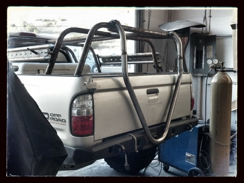

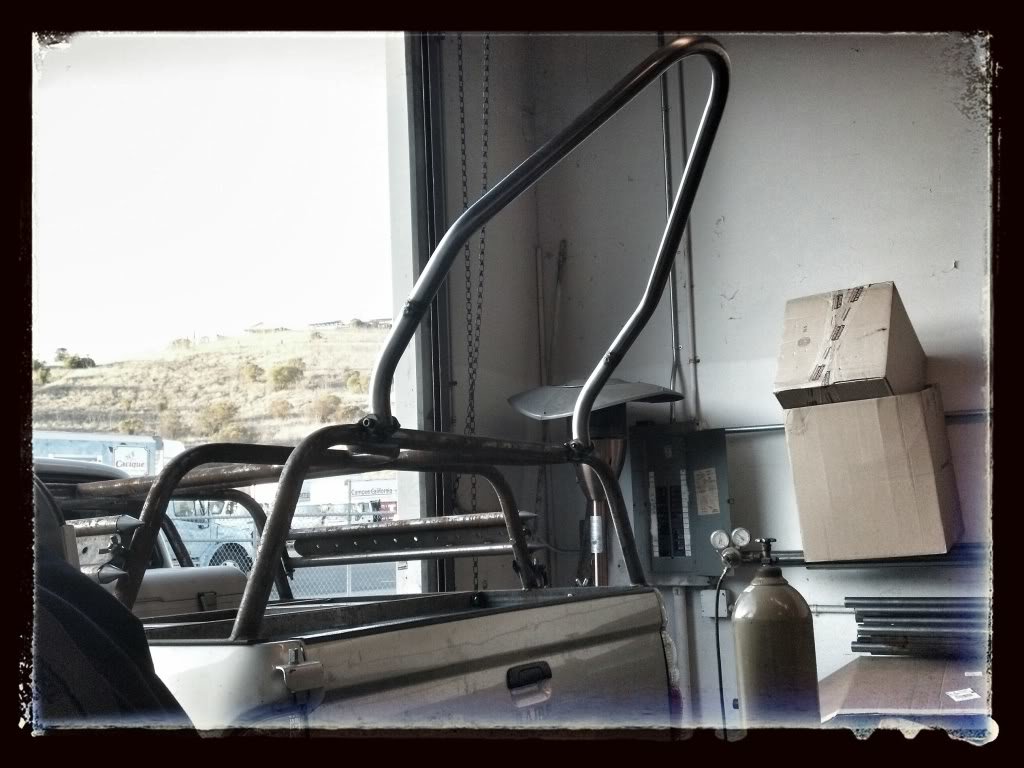

    I got around to starting the tire swing up on my bed rack oh yeah i said swing up! This truck is over the top so i had to build it over the top as well. Its going to have two 90lb gas springs to lift the tire up for bed access the tire mount itself will fold down to the ground so i can load my big ass tire on without braking my back. Two toggle clamps will hold it all down wile driving.

  15. Nov 23, 2013 at 6:13 PM

    but jerry what if you're in a low-ceiling mall parking structure and need to change a tire!?
    :popcorn:

    Cody if you would of read and not just :drool: over pictures. The tire mount itself will fold down to the ground to change the tire.

    I misread but forgot my sarcastic font
    i'll go back to just :drool:

    What happens if you want to tow the boat?

    Jerry buys a Honda Pilot to tow it. :p

    I got that covered I run a 12" drop hitch so the boat will hook up no problem.
