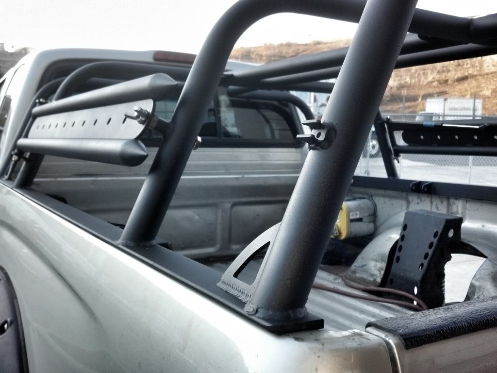

    I got all the welding done on the rack over the weekend blasted and powder coated it. The tire swing up is still not done yet I just wanted to powder coat the rack so it didn't look like shit rusting away on my truck.

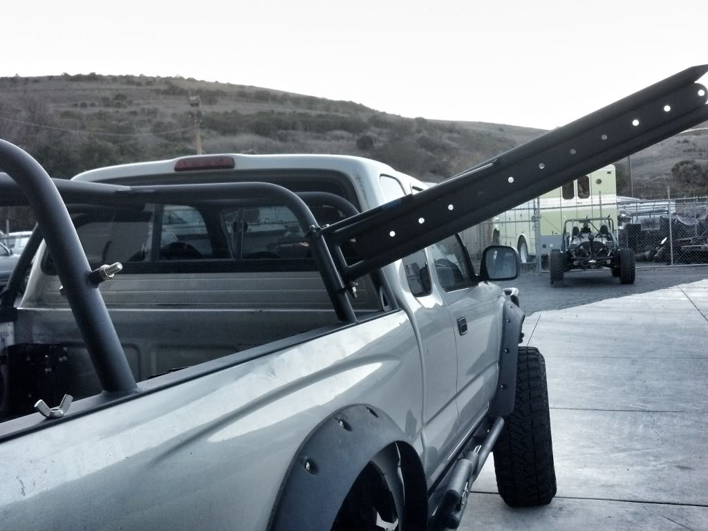

    What is that swing out for

    I have a frame that bolts into the rack these swing out so i can load bins and other stuff in.

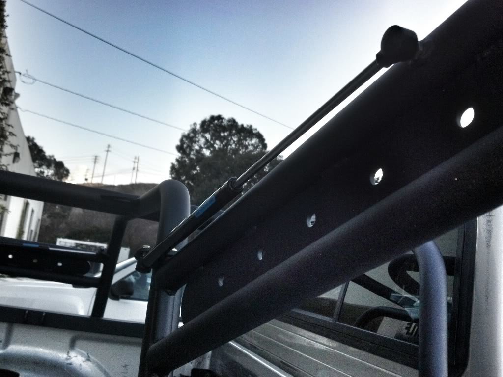

    I just noticed the gas shocks. Very nice idea.

    Yeah I used the 90lb shocks there seeing how they dont do crap for the tire swing up. I did pull out one of the ends on the shock when I opened the the side the weight was just too much for the plastic cap it pulled the threads right out. I ordered some steel caps so I dont do that again.

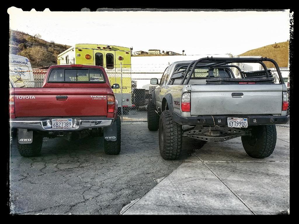

    I get a bunch of people asking me how much bigger my truck is compared to a 3" lift so here it is.
    The truck on the left has 5100's and eibach coils and AllPro expos in the rear on 33'x12.50's.
    My truck is sitting 23.5" at the frame on 37's
