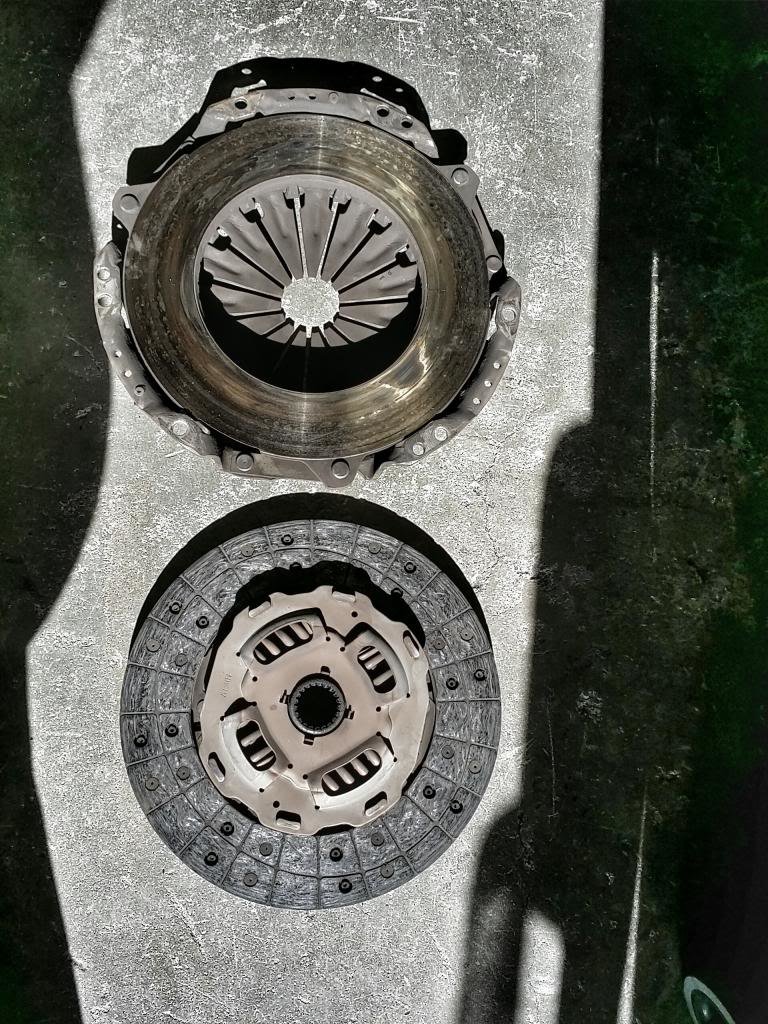

  16. May 7, 2014 at 6:42 PM
    #3556
    JLee
    JLee [OP] The Man! Vendor
    Jul 20, 2010
    #40461
    19,619
    Jerry
    Grass valley CA
    02 Extra cab SAS Linked front and rear
    I lost track thousands of dollars ago.

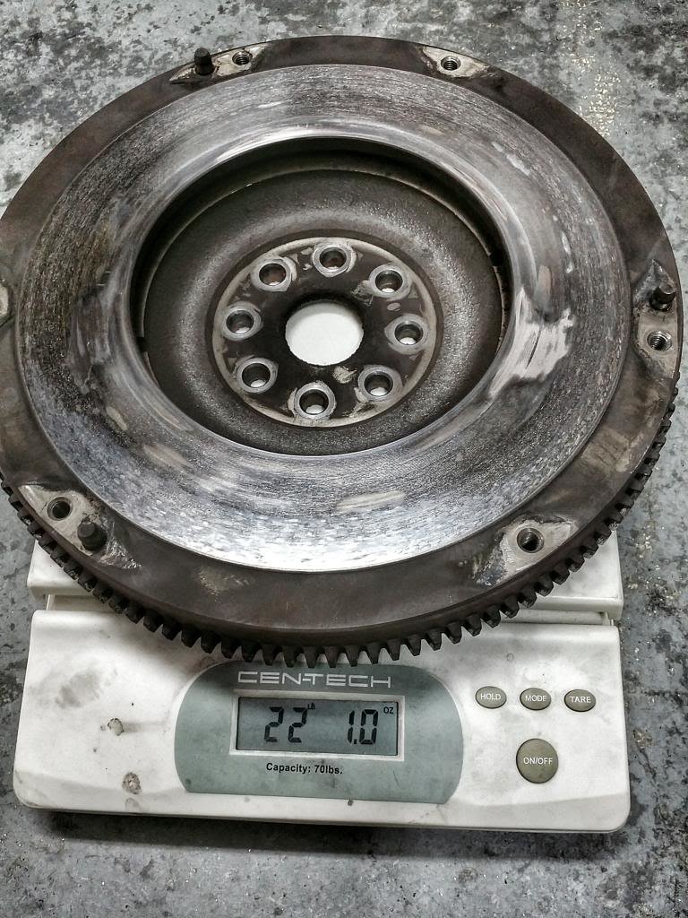

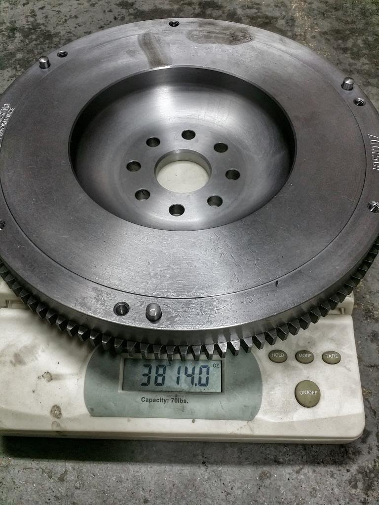

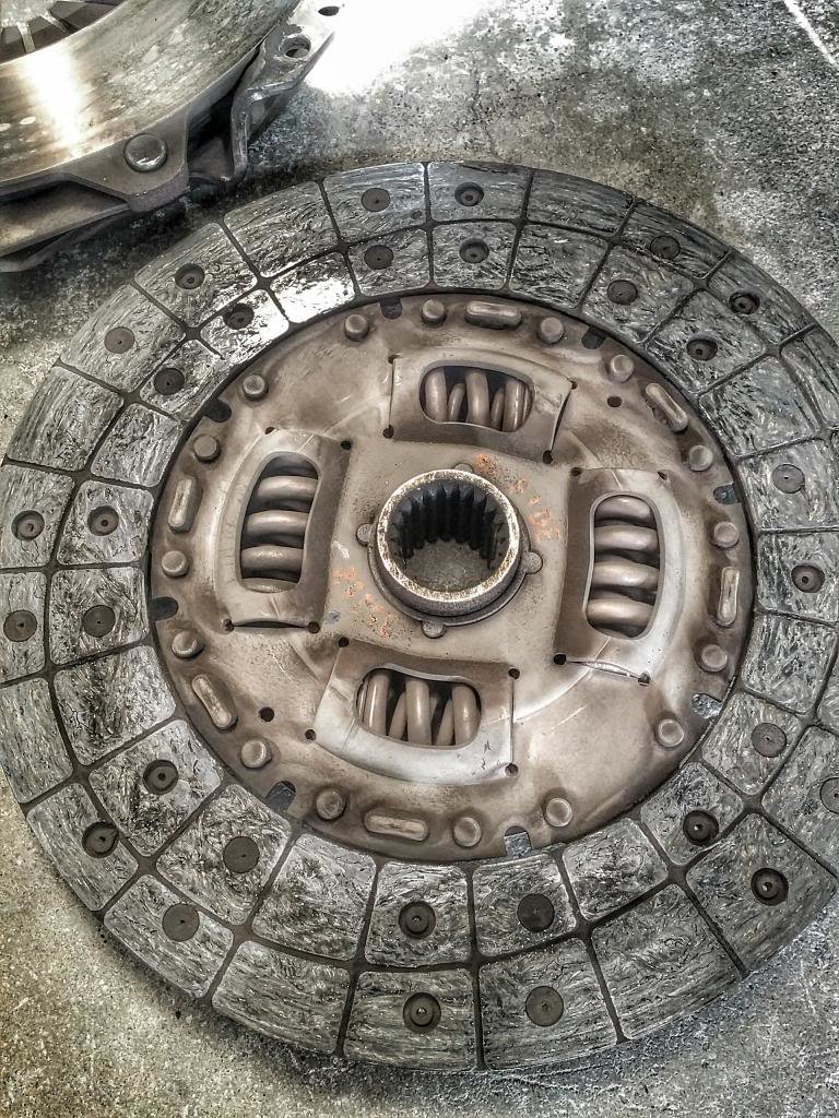

    I pulled the clutch today not too bad of a job once all the IFS shit is gone :D
    Stock flywheel
    LCE flywheel
  17. May 7, 2014 at 6:53 PM
    #3557
    lotsoftoys
    lotsoftoys pavement is boring....
    Apr 22, 2010
    #35790
    7,299
    Jace
    Denver
    98 lifted panda taco
    bunch of crap
    did u put an lce clutch disc and pressure plate in as well? ive been hearing good things about marlins clutch kit
  18. May 7, 2014 at 7:03 PM
    #3558
    JLee
    Jul 20, 2010
    #40461
    19,619
    Jerry
    Grass valley CA
    Yeah all LCE the marlin clutch is never in stock.
  19. May 7, 2014 at 7:20 PM
    #3559
    lotsoftoys
    Apr 22, 2010
    #35790
    7,299
    Jace
    Denver
    bunch of crap
    ah... is it supposed to be a stiffer pressure plate/upgraded disc?
