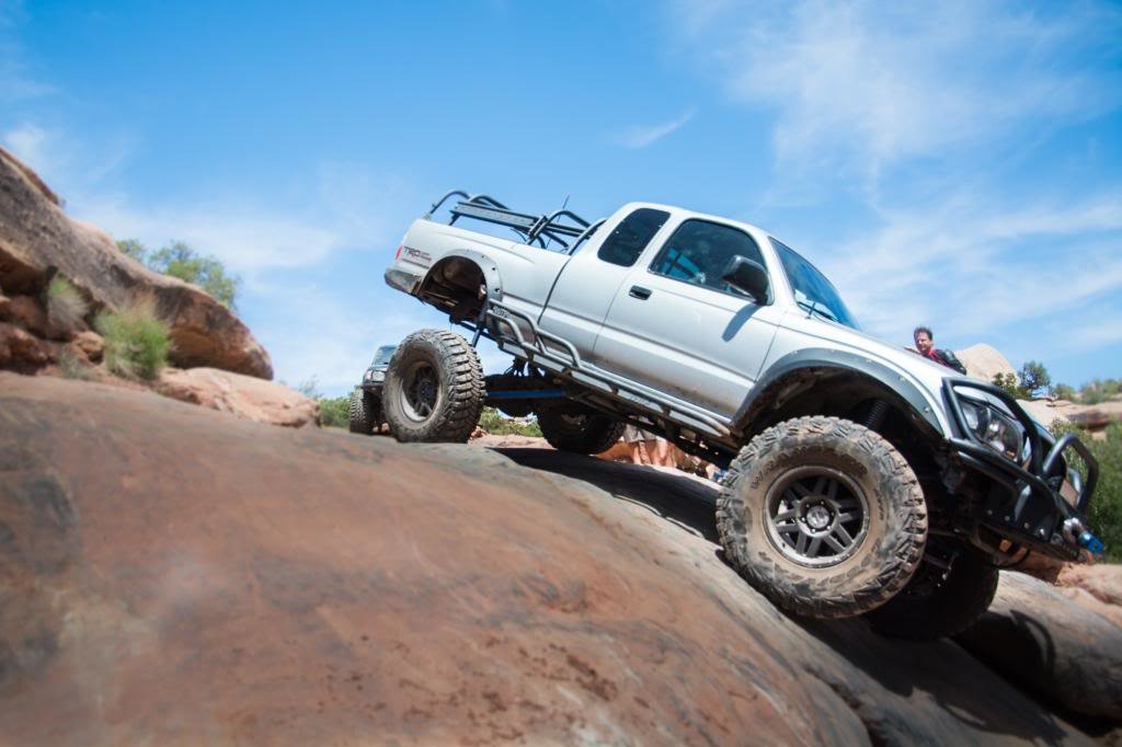

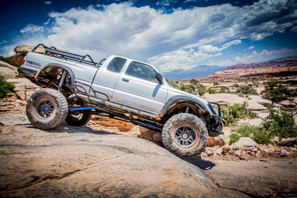

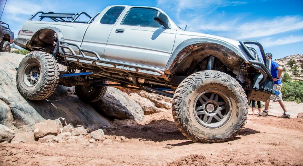

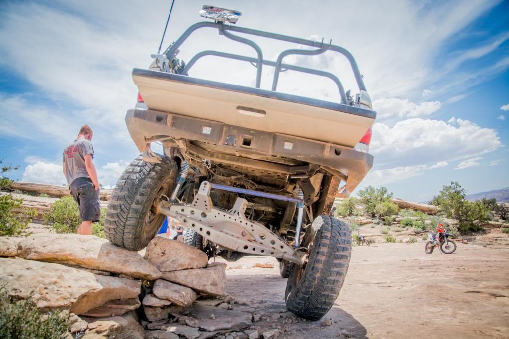

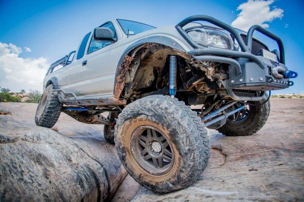

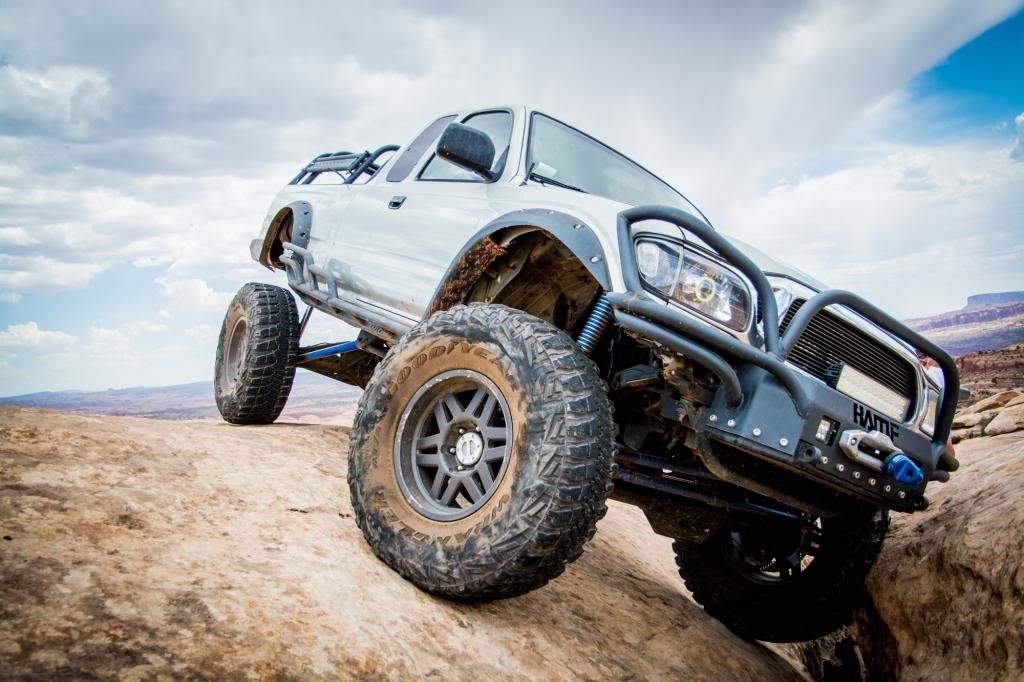

    Well Rock Therapy 2014 is in the bag. 2900 miles of driving 2000 of that was towing my trailer that did awesome! another 900 of driving in MOAB now much carnage to report the truck did great.
    The only issues were a blown ballistic joint on a lower link, power steering line came loose and emptied some fluid out, Took out a tail light and a small spot on the bed on Kane Creek, lost a few bolts on the exhaust on the way home & pretty much lathed my drive line on the slick rock. All that matters is I drove it home pulling the trailer with just a loud exhaust.
    After this trip I decided to swap out the ballistic joints on the upper links to Heims there is just too much play in the ballistic joints so I'm getting clanking after towing and hard wheeling. And that's after a full rebuild of the joints just before the trip.

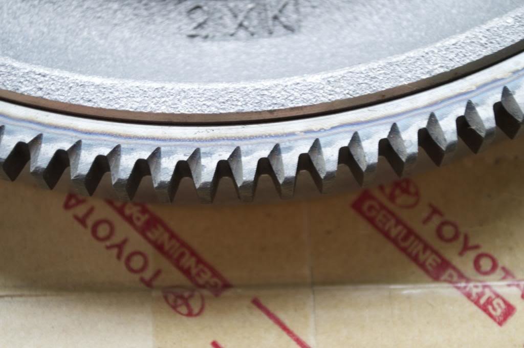

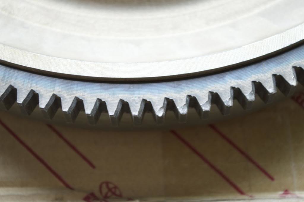

    You didn't happen to take a good look at the flywheel teeth before installing it? Wondering how the one you bought compares to TGP and if you've experienced any starter issues.
    Finally got around to installing the new TGP flywheel to replace the no-name brand one a shop put in during the clutch replacement. What I found:
    Old
    New
    Explains why the starter was grinding every so often. More pictures can be found here:
    http://www.tacomaworld.com/forum/1st-gen-builds/259729-tomtoms-03-trd-xtra-cab-36.html#post8678223

    my new one is cnc machined not cast like the others. I didn't look at the teeth but i have had no issues with it so far.
