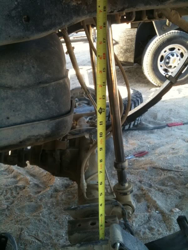

    How much travel do you have on the rear axle. What length shocks are you running as well. Looking to do this to a 2nd gen.

    You know I still haven't measured I have 6 or 7 to the bump in up travel but my wheel up travel is around 10 or 11. I'm just guessing but my total wheel travel is around 16" to 18" that's the top of the wheel to the fender. I'm going wheelin in 2 weeks I'll try and remember to check the droop.

    ^^ are you sure 16-18 of travel????
    for a SUA (spring under axel) with relocated shackle and front spring perch with a 61.5 inch spring and 16inch kings you get like 18 if done correctly?
    if you do get that much travel, how?

    I'll measure when i go wheelin on the 20th. but is the SUA travel measured at the bump or the tire I'm talking about the tire to fender travel.
    then you take out all of the leafs besides the longest one, and let it go all the way up to bump.
    this truck has like 18.5
