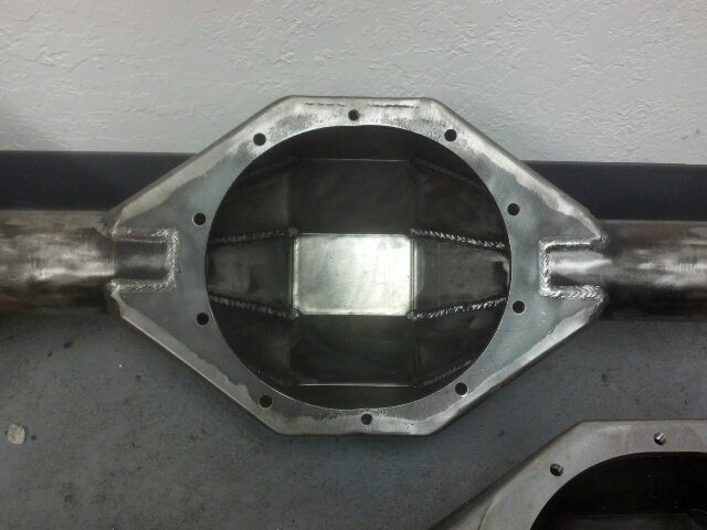

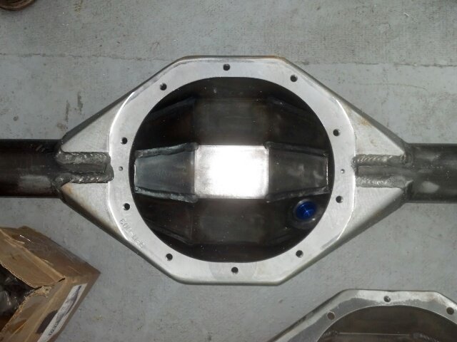

    And this is where spidertrax had a edge over the Diamond and the Ruffstuff.
    Spidertrax CNC machined mounting plate.
    Diamond hot rolled plate still has the mill scale on it :(
    Both are awesome axles but the Diamond will take some machining to get the 3rd on perfect.
