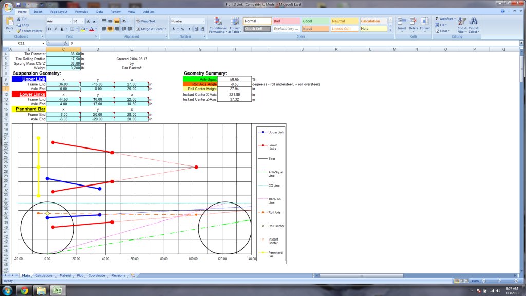

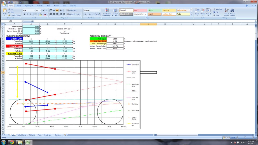

    Here is a quick numbers shot of the front and rear if I was going 3 link on both. Granted I'm still not sure if the panhard can fit that high. If i can get 30" out of the rear the the Roll Axis go's down to 0.17 degrees.
    Front
    Rear

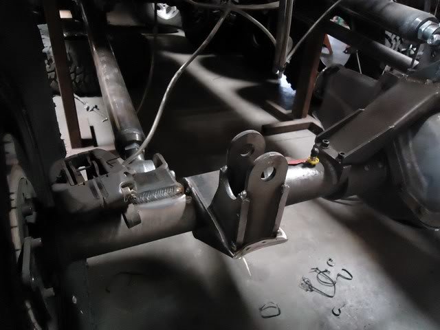

    Maybe you'd be able to utilize a design similar to this for mounting your coilovers:
    Might help in keeping the bed fully intact :cool:
  9. Jan 3, 2013 at 9:04 AM
    #1369
    JLee
    JLee [OP] The Man! Vendor
    Jul 20, 2010
    #40461
    19,620
    Jerry
    Grass valley CA
    02 Extra cab SAS Linked front and rear
    I lost track thousands of dollars ago.
    i'd like to mount them on top of the axle out of harms way If i have to punch a small hole in the bed so be it. And wholly upper link mount :eek: that thing is huge!

    Which is exactly why I set my lowers at dead center on the axle and not an inch higher. Both of my axles are set that way. Thats why I say sometimes that three link calculator can get you doing things that you don't need to or want to do.
