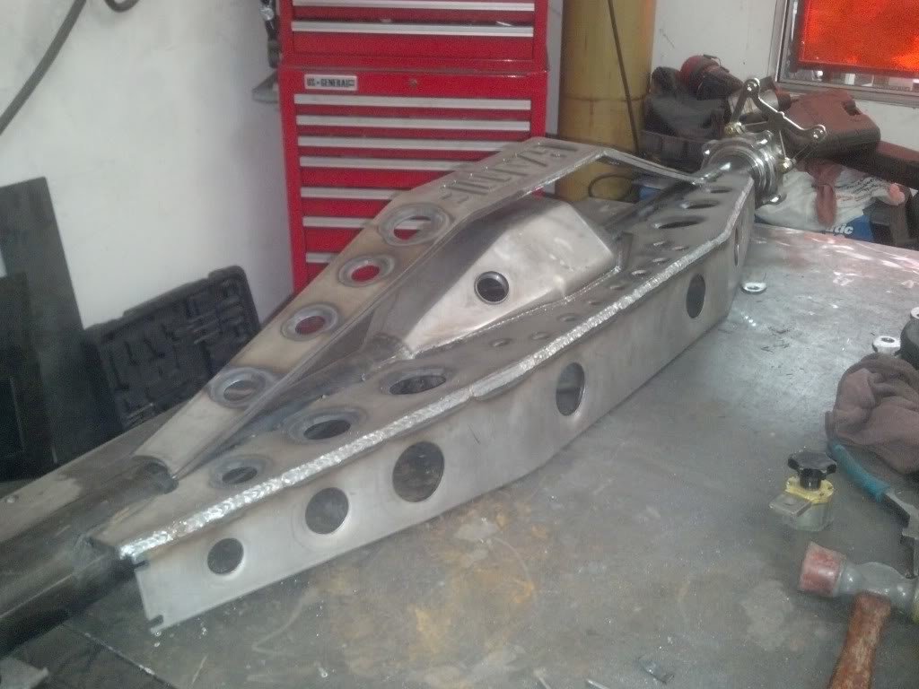

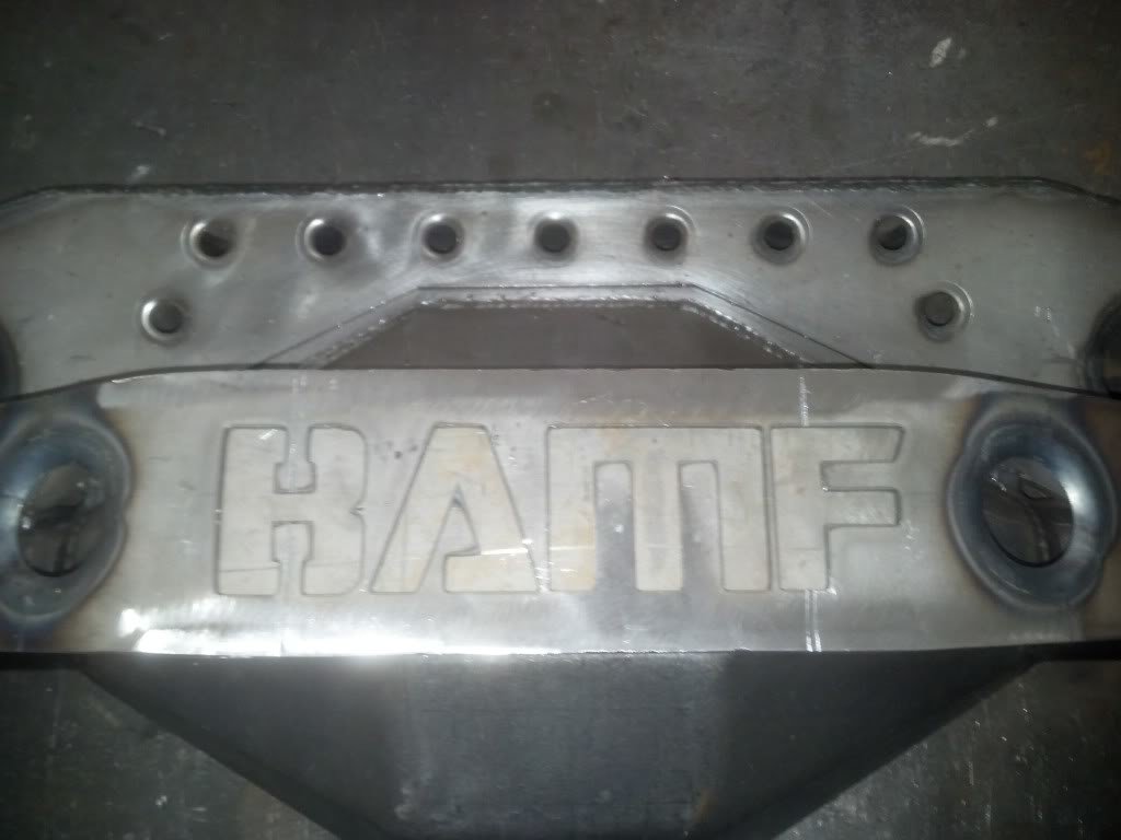

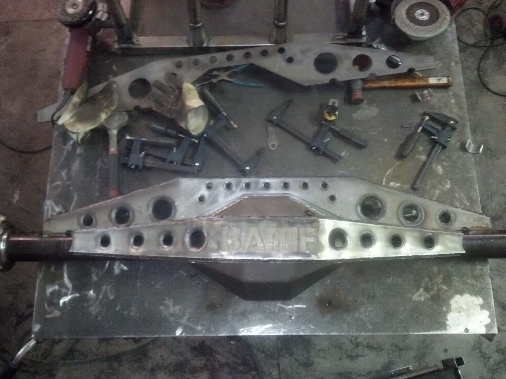

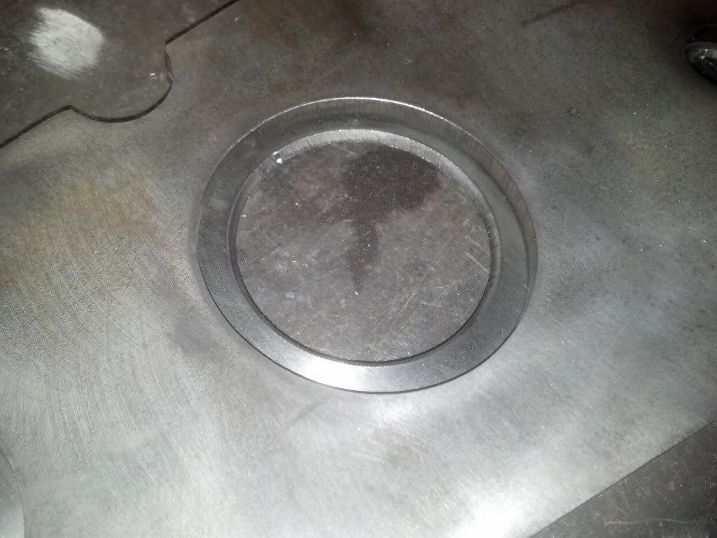

    I started my rear truss today It's looking pretty beastly. I wanted dimpled plate and 1/8th" is just not enough for my taste. So i came up with this.

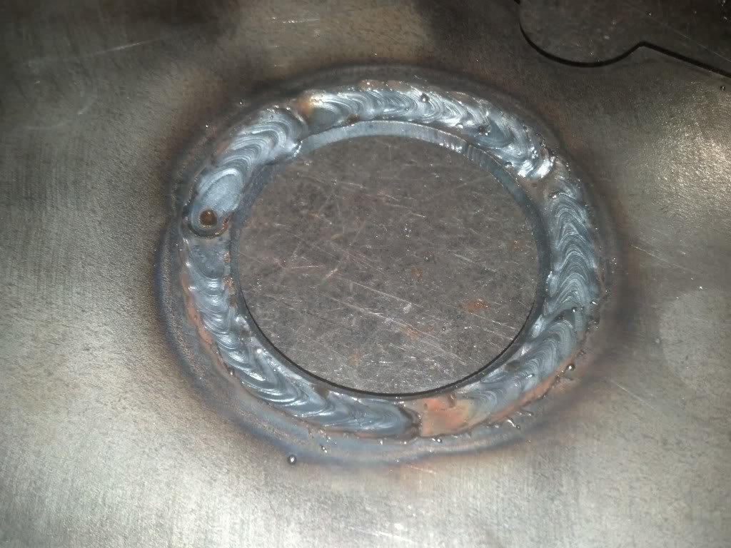

    I cut 1/8th plate and dimpled them. Then cut some 1/4" with bigger holes and skinned the 1/4" with the dimpled plate pretty much giving my 3/8th" I know it's over kill but i had a half a sreap sheet of 1/4" so I just went with that.

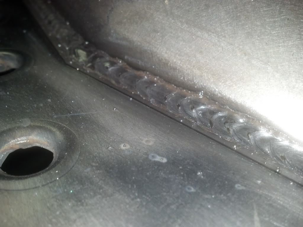

    Fully welded every hole.
    Top fully welded and tacked to the axle.
    I still have to finish the back plates and weld on the front of the top and it's golden. The truss go's all the way to the axle end caps the shock mounts finish it off.
    Fab porn

    Well the rear axle as it sits now is about 200lbs

    thats ridiculously beefy
