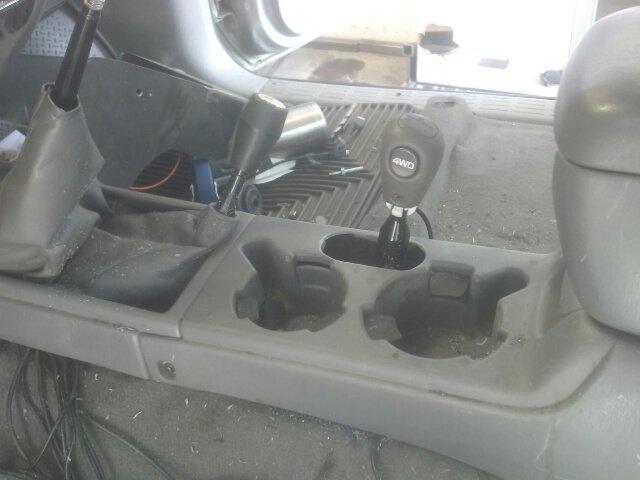

    Well I found my first issue with the T Case and the adapter plate. Once mated the pin from the T case wont allow me to shift into Hi gear it's hitting the adapter plate. Now I have to remove the factory T Case and shave out the slot for the pin a little in the adapter plate so it will shift into Hi smoothly :mad: Should of mated them off the truck.

    The Trifecta of Taco's
    That's odd. Isn't it supposed to be direct bolt in?

    I had to mill out two holes for the lower bolts as well as open up the slot for the shiftier pin. It's not a direct bolt on there is some adjustments. It's really not a bad install at all.
    Oh and the MT you don't have to pop up through the cup holder :D I did not want to loose my cup holder so I was going to make a bracket to move it here anyway.
