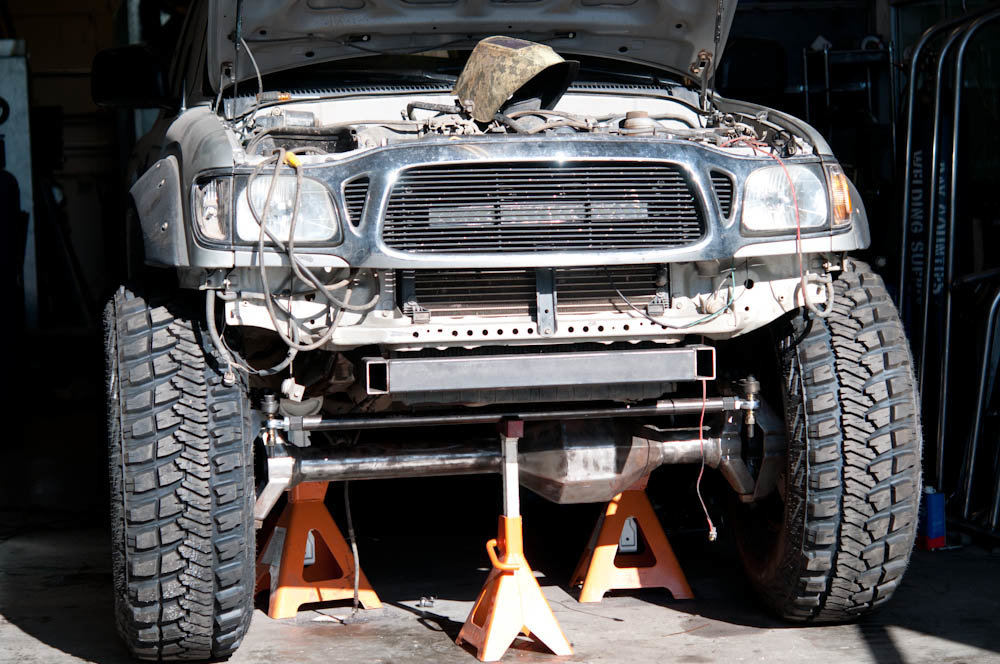

    Oh i'll have about 5 or 6 up and about 10 down in the rear and 8 or 9 down in the front :D

    I wanna see those shocks, gonna be interesting

    I'm thinking they will ship this week i took measurements of the front today they are going to fit nicely.

    Solid mount the tranny too?
    Not gonna have a ton of up travel with that low a frame height too right?

    The motor is not solid mounted if that's what your thinking the factory mounts are still attached to the motor. I'm doing the tranny crossmember tomorrow and i'm using bushed tube for the mounts on the trans and the crawl box.

    I will have 5" to 6" up with this setup

    Oh I will designing the link brackets and Trans crossmember today I don't know if I'll have it all in but pics will be posted :cool:

    Well I hit my first snag mocking up the ride height at 23" this big as Diamond axle just just about to the oil pan :mad: I know I'm going to have to modify the pan to clear it with the up travel I want. I also might need to lift the motor and trans in 1". I'm kinda stuck between a rock and a hard place to lift the motor I need a 1" BL I could also just lift the ride height to 24.5" Humm 24.5" is not that high but not what I wanted.

    I'd lift the ride height...

    Yeah that's what I'm leaning towards I didn't want to be that high but it is what it is. And I have to fit everything under the truck and this Diamond has a big center section.
