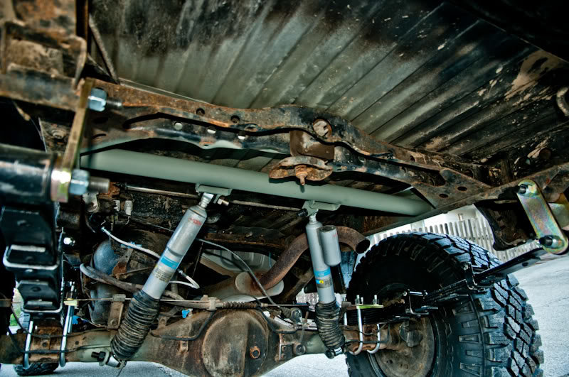

    shock relocation ? for ya jerry...
    any reason why you angled your shocks toward the rear with your upper mounts?
    clearance issues with items on the axle? or was there a performance reason?
    you lower mounts are much cleaner than 2nd gen relocations i've seen too

    I dont remember why i pushed them back but they did okay at speed and flexed like crazy. I think it had to do with clearance more then anything.

    yea there's a lot of crap on the axles to work around haha

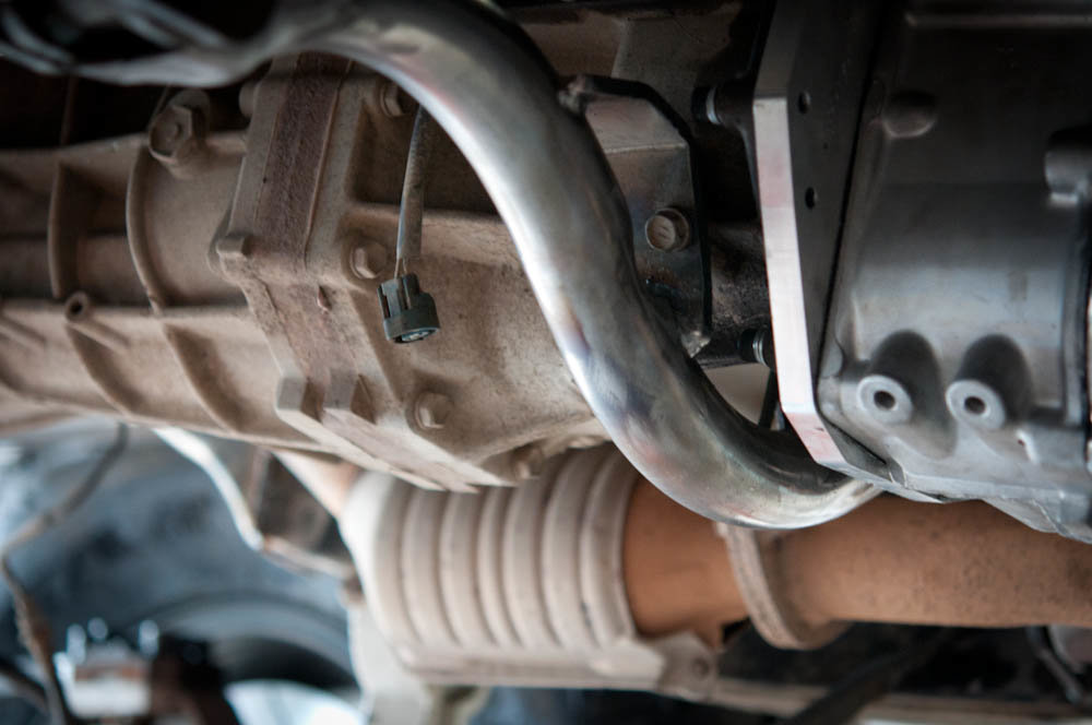

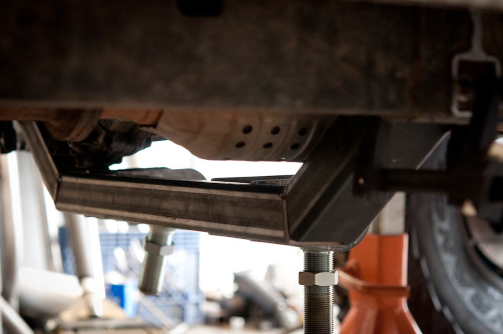

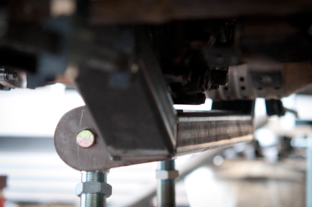

    I got the trans mount all installed today as well as the lower frame link mounts mocked up. They are pretty low I'm going to see if i can get them up any higher tomorrow. I'm going to have an issue with my upper link and the motor mount so i might be re doing that on the driver side.

    That trans mount is fucking sexy!

    Looks good. How do you think you'll be able to raise the low stuff? Will you notch the material?

    I think i have enough room to lift the lowers 1.5 to 2" i'll just cut new brackets with the lift built into them i guess i'll see tomorrow.
    the joints are sitting at 18.5 from the ground right now on the crossmember and the axle side will be about 18.00 so id like to get the frame side closer the 20". Other wise i'll have to lower the axle side mounts to get a good antisquat.

    Could you get some Long Tube Headers and take out the Cats? Would give you an additional 1-2" then you already have :cool:

    I cant lift the crossmember unless i move it forward the transfercase is closer then the cat. And i cant pull the cats i'm in Califorina remember :(

    Oh isee. A little bit shorter of a link shouldn't effect much if you change everything accordingly.

    Yeah that crossmember is just clamped to the frame right now so i can move it but then i get into the front driveline so its a toss up. I also like the location of the crossmember it does gaurd the T case where its at right now.

    I see. Not sure if its mentioned previously, but is your Crawler/TCase clocked up to clear the frame rails? Maybe gain some height that way if not.

    Oh yeah its clocked up to the body i had to beat the floor with a hammer just to get the case clocked to the next set of holes :D
