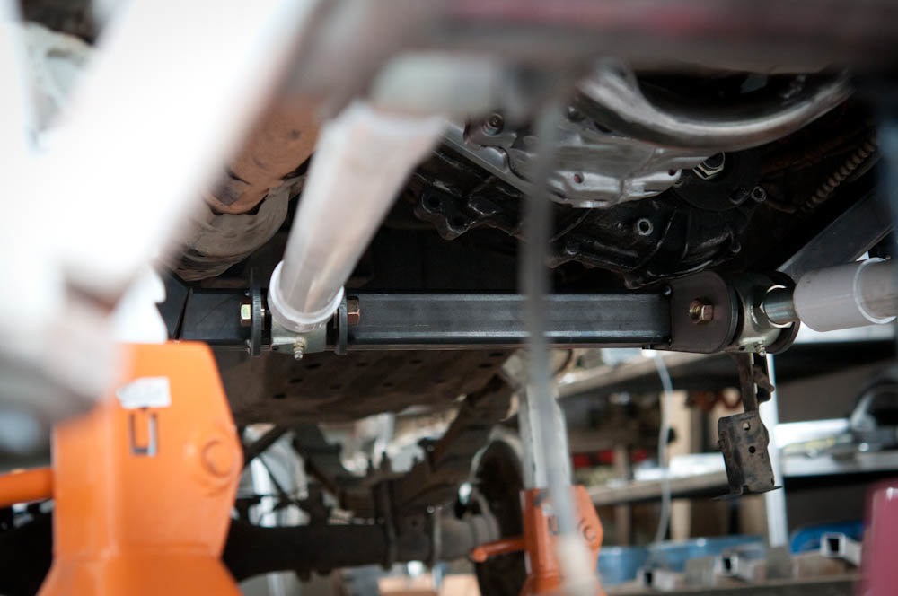

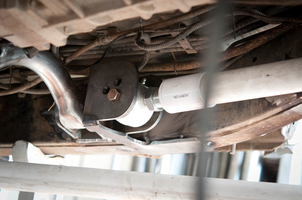

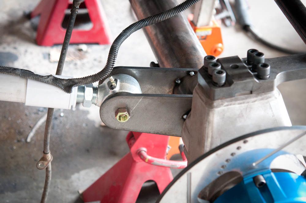

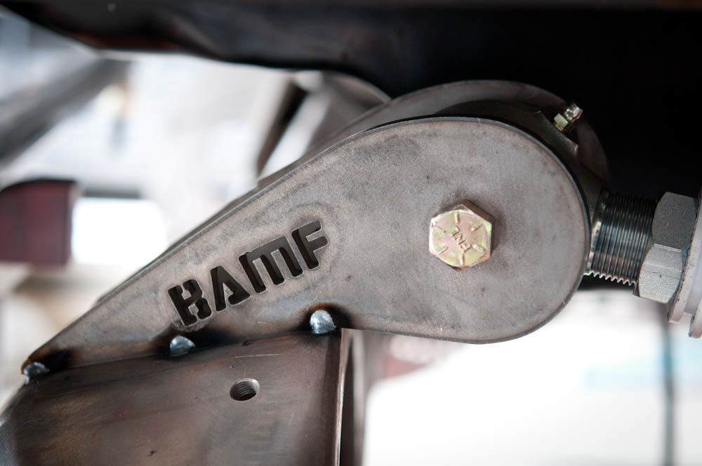

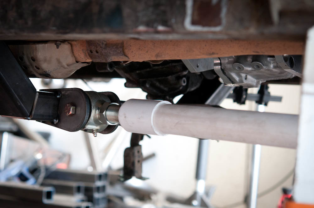

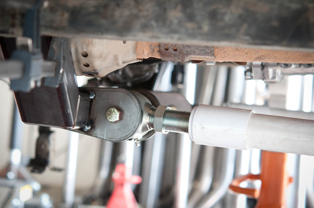

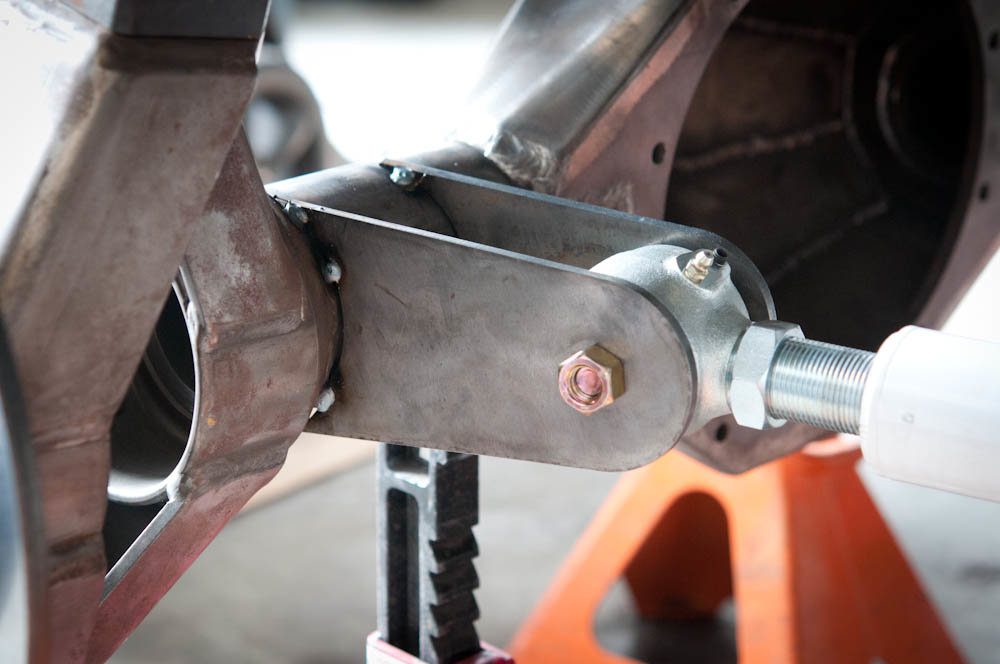

    I got the links all mocked up today everything is tacked in place with heavy tacks. It looks pretty good I will have to modify the motor mount to get the 5" up I want as well as a few more other things. I set the caster to 7* and I'll see how that is i couldn't really find any info on what the SpiderTrax knuckles like to be set at so i just set it there. One thing I didn't like is the guy that I bought the axle from set the pinon angle at damn near 90* it's about 86* with a 7* caster. I'm thinking he set it up for a Hi-9" being so low it shouldn't be too bad.

  2. Mar 31, 2013 at 5:27 PM

    Awesome work as usual! Very clean design on the mounts.

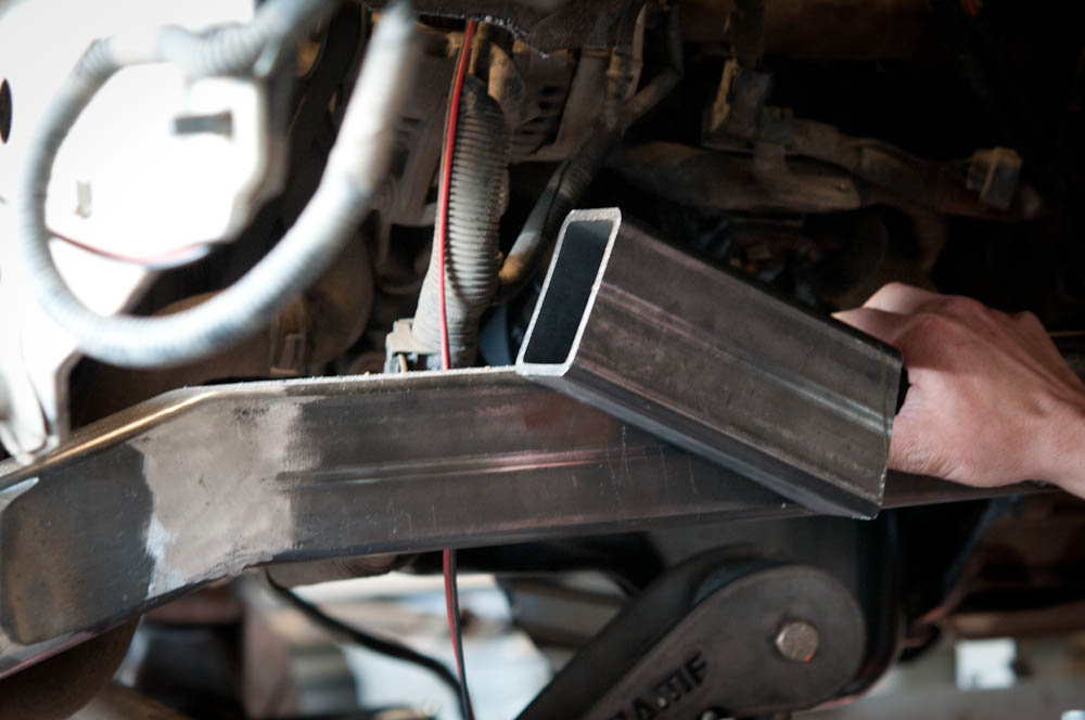

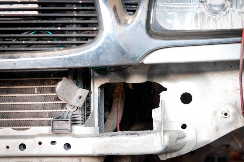

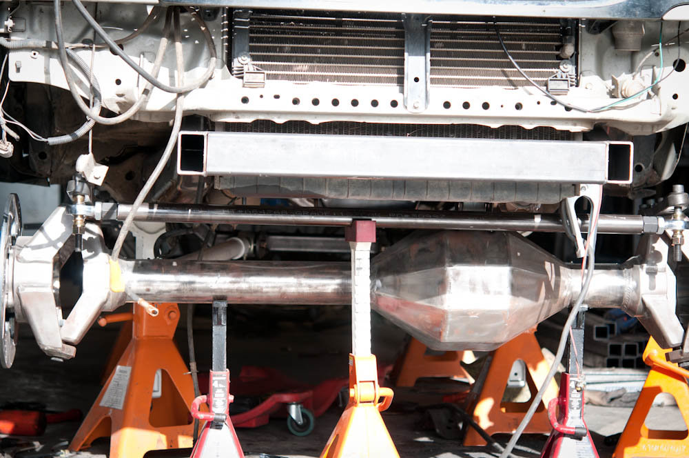

    Not much to report tonight did some test fitting on the IFS box and the drag link and I'm going to have to cut the frame :( I don't like where it's sitting so I'm hacking it up tomorrow and building a new section from the motor mounts forward. Here is how high the new section will sit.

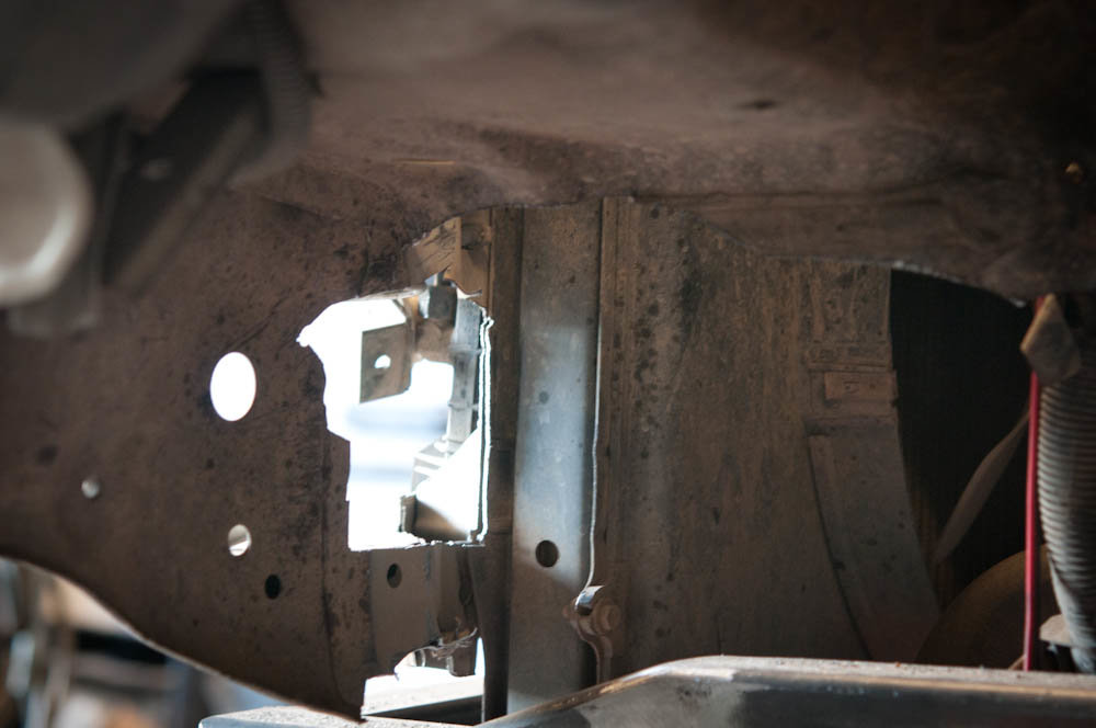

    Oh and some cutting it's just a rough cut but the IFS box fits nicely :D

    Beautiful work!! Did it come out close to what you came up with in the link calc?

    Yeah it did the upper is a little shorter then i did it at first but everything looks pretty good. I've still got the flex it out to see if anything is hitting i have to glue the pvc links first of they will fal appart :eek:

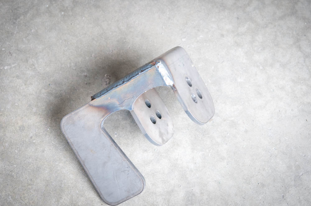

    I won't lie, I still don't know what all the words next to your pics you post mean. I just like looking at the shiny new parts :) It's like I'm in first grade trying to read books all over again.

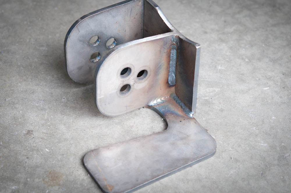

    x2, steering box mounts are a very common area of failure.

    The frame is 2x3 x188 wall tube and it will be plated with 1/4" plate so i think it will be strong enough. And the ifs box is tapped for hydro so yep :D

    i'd assume you'll flip these links around when you're done right?
    would suck to rip those f'er off
    looking good man...can't wait to see this beauty in person man!
    i :laugh:'d at the IFS box cut out

    Yeah i was thinking i should make them out of steel too i dont think that pvc will hold very well :rolleyes:
