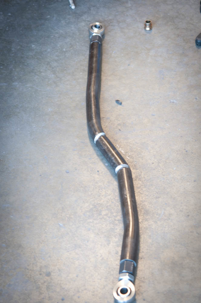

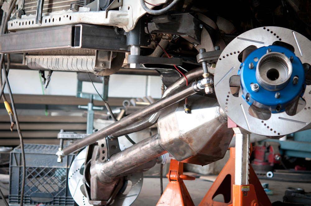

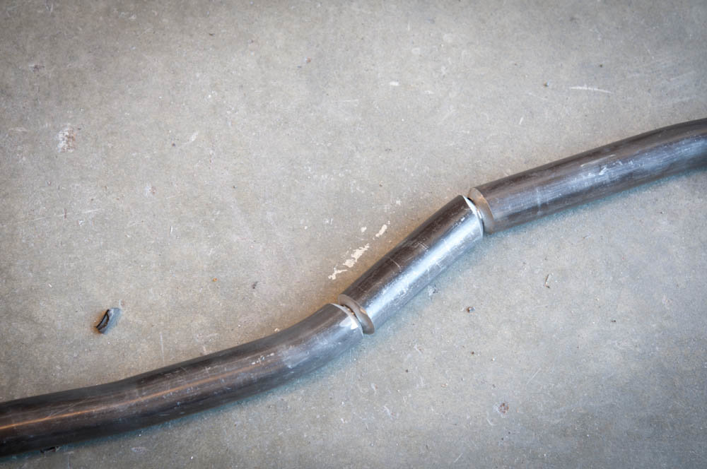

    Well i decided to re do the pan hard i started mocking up the new one this evening. It wont be as crazy as the other but it will have bends / splices. I'm going to sleeve it at the splices with 1" cold rolled soild stock just for safe measure :D

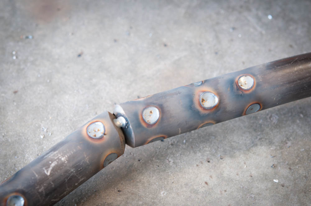

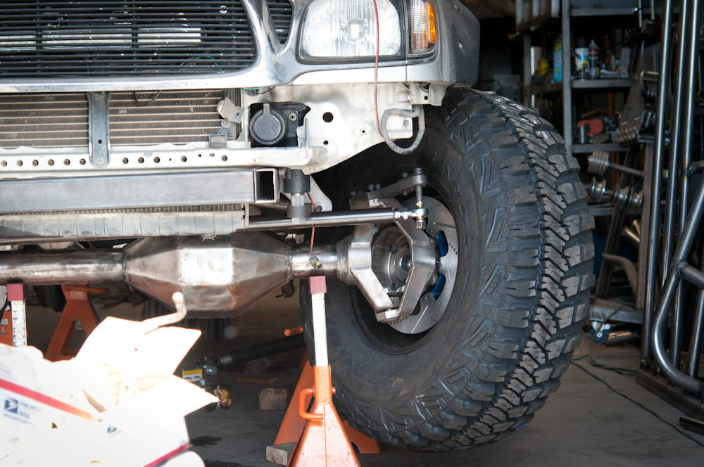

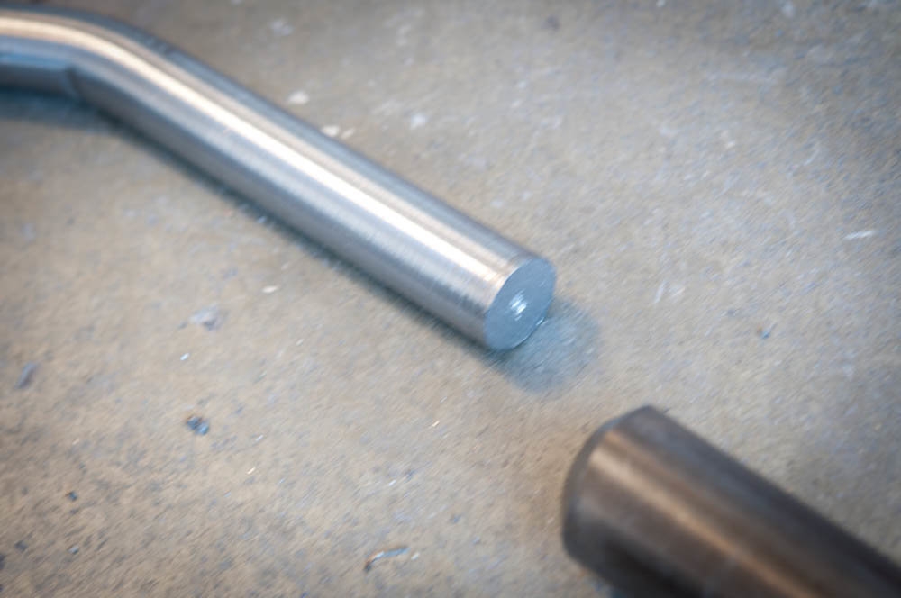

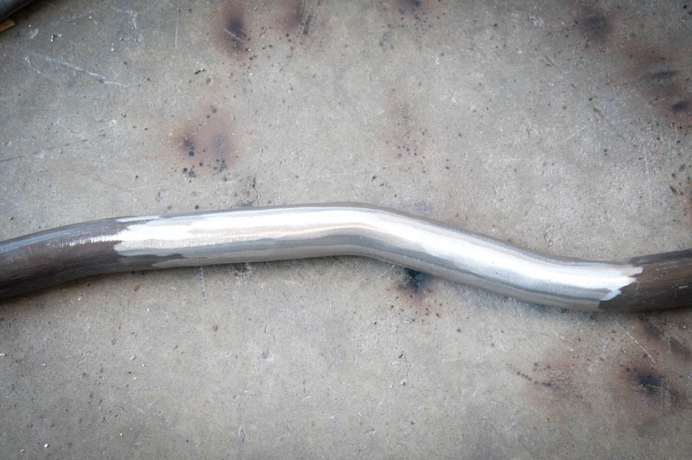

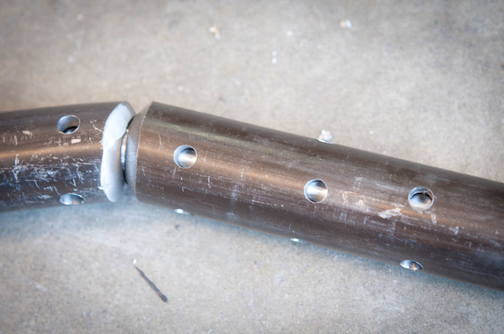

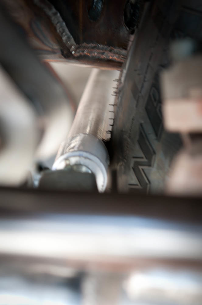

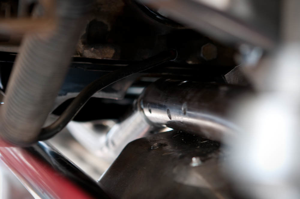

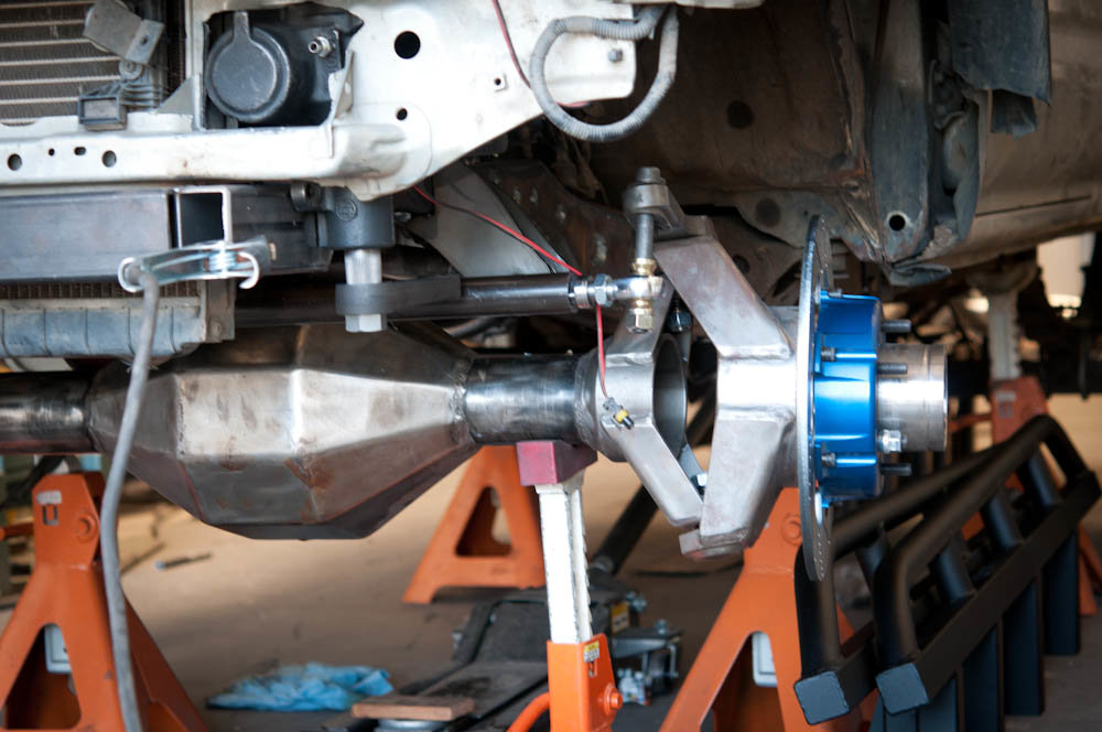

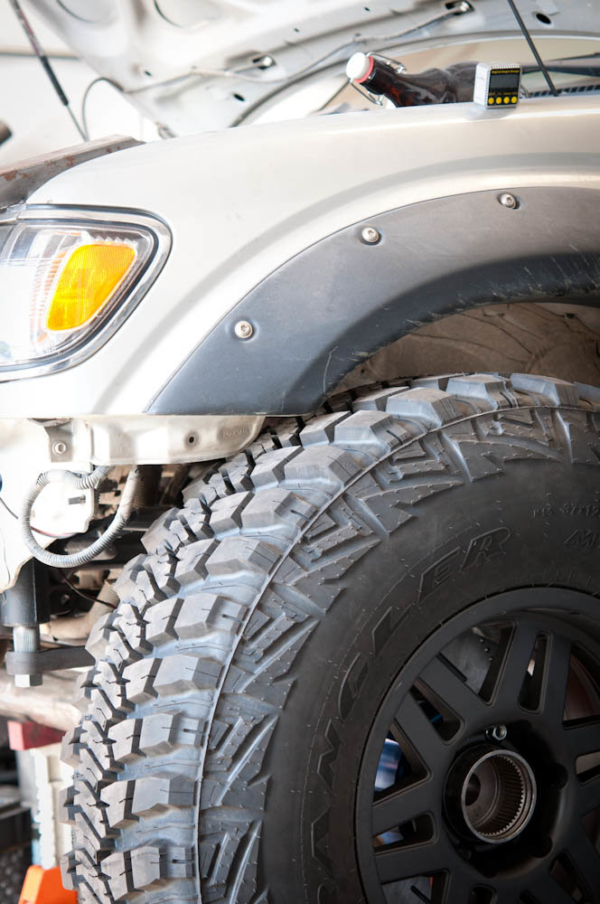

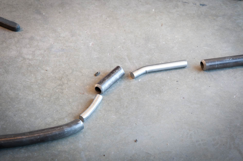

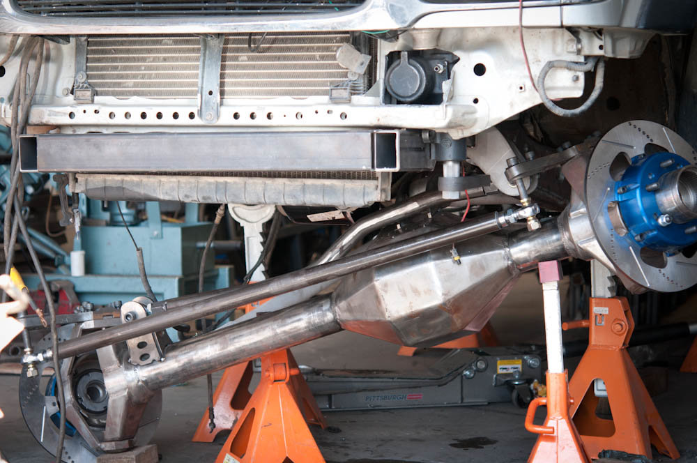

    Well After working 12 to 14 hour days in the shop this week and not touching my truck once I said I'm taking a 3 day weekend and working on the truck.

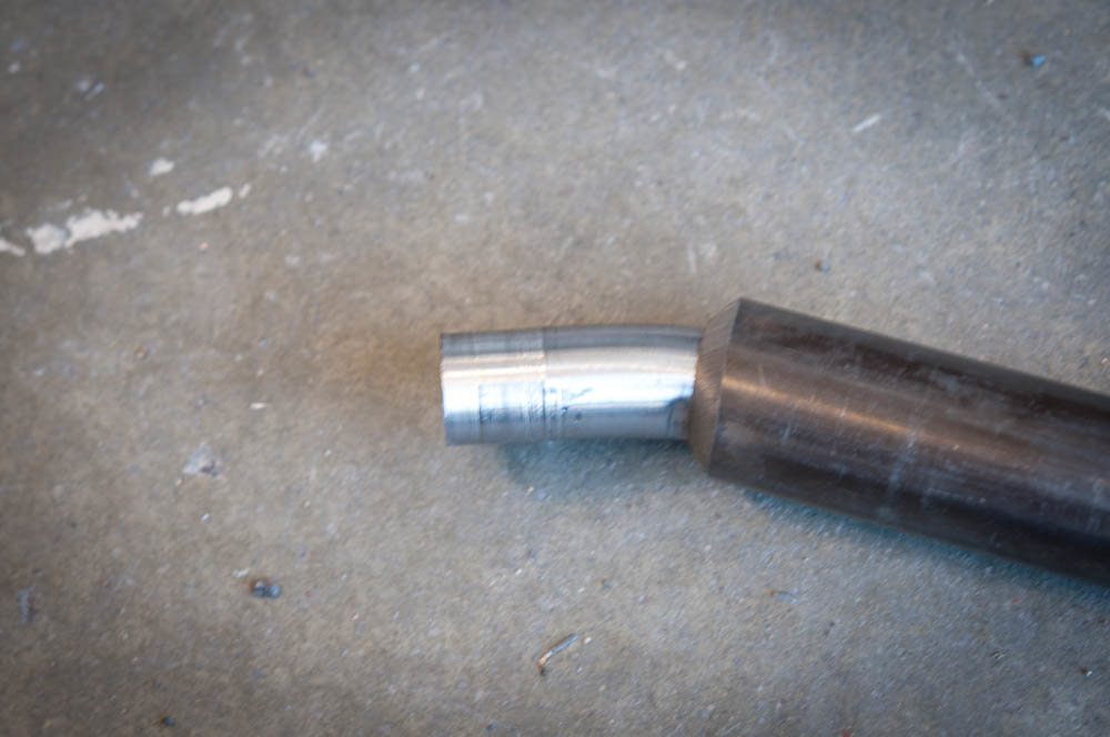

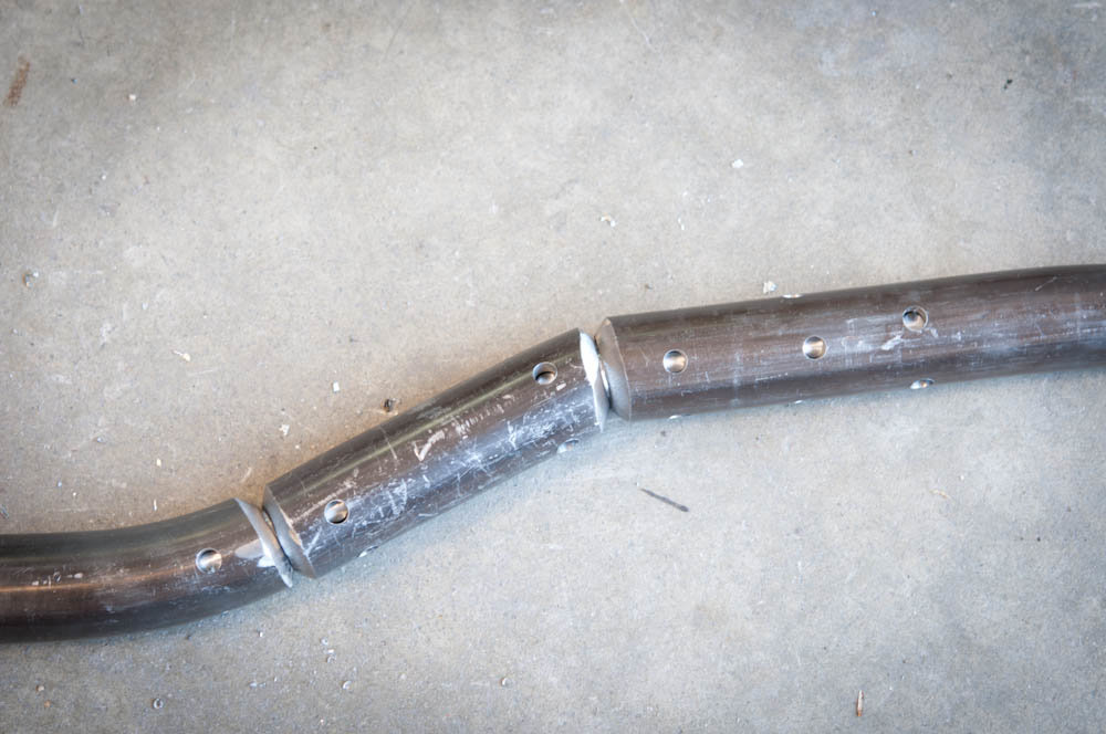

    I made a new pan hard it has 2 bends and 2 splices. I took some 1" cold rolled solid stock and turned some sleeves. So it's 1.5" .250 wall DOM sleeved with 1" sold stock Id say it's pretty damn solid.
    I drilled 5/16th holes for plug welding.
    Rough sanded

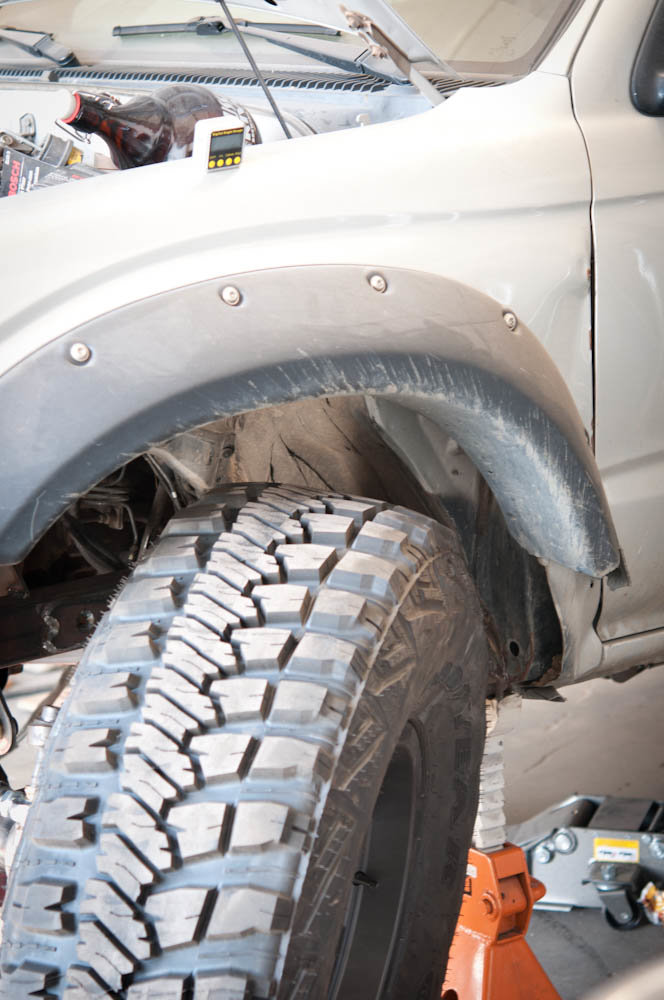

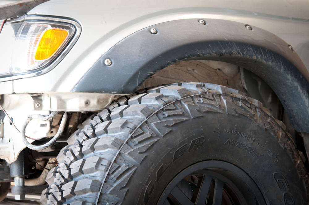

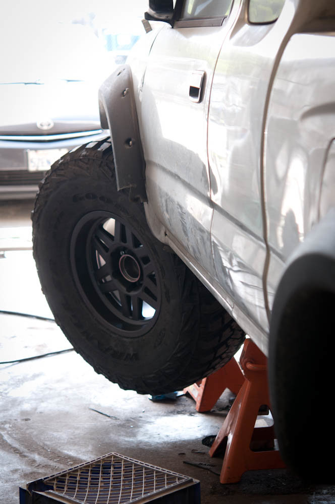

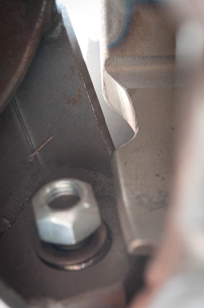

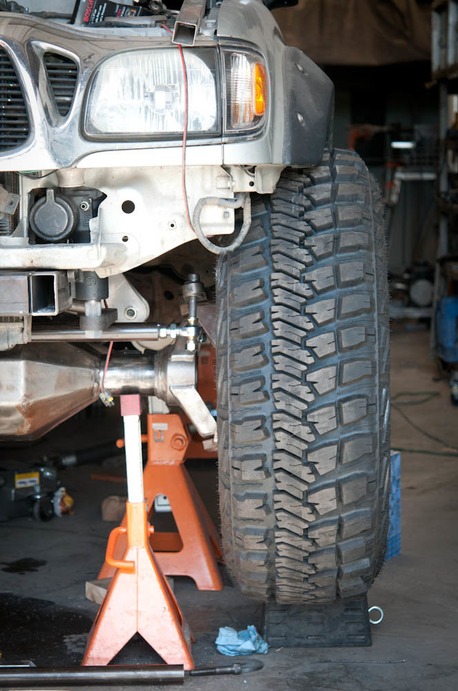

    Driver full stuff passenger drooped out steering full passenger

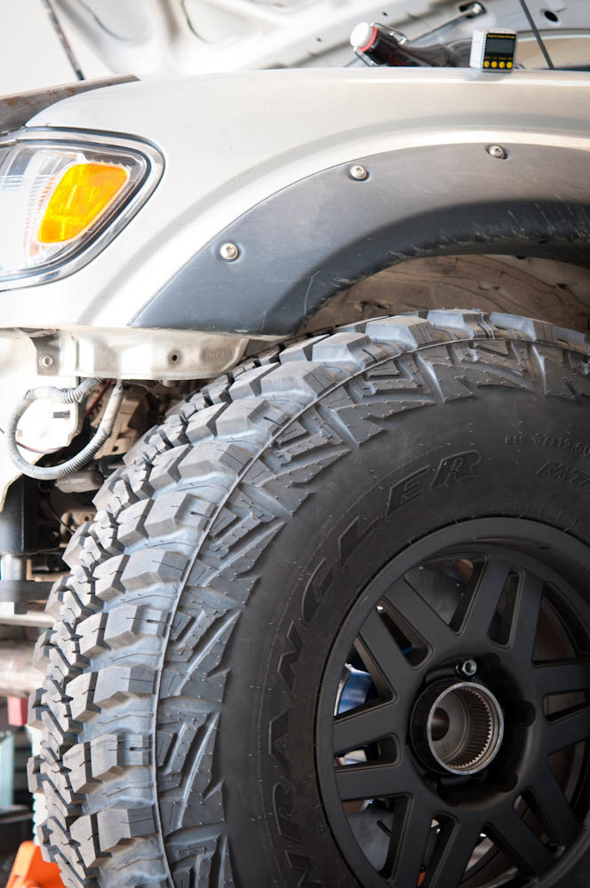

    Then I see this :( Tire rubbing lower link just before full lock and double stuffed. I guess I was right I'm not getting 50* of steering so I'll limit it with the PSC ram
    Just before the stop it's about 45* now still pretty dam good.
