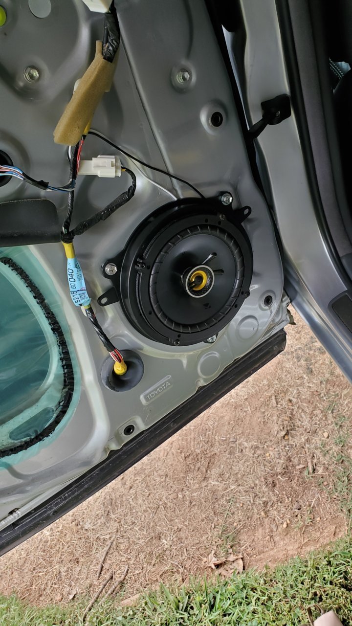

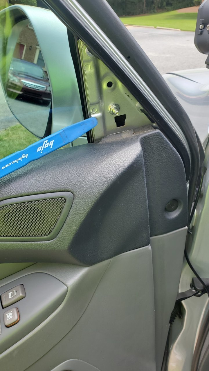

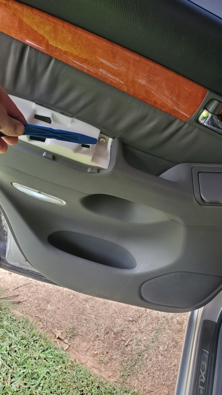

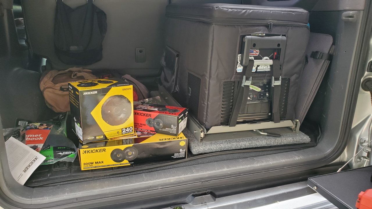

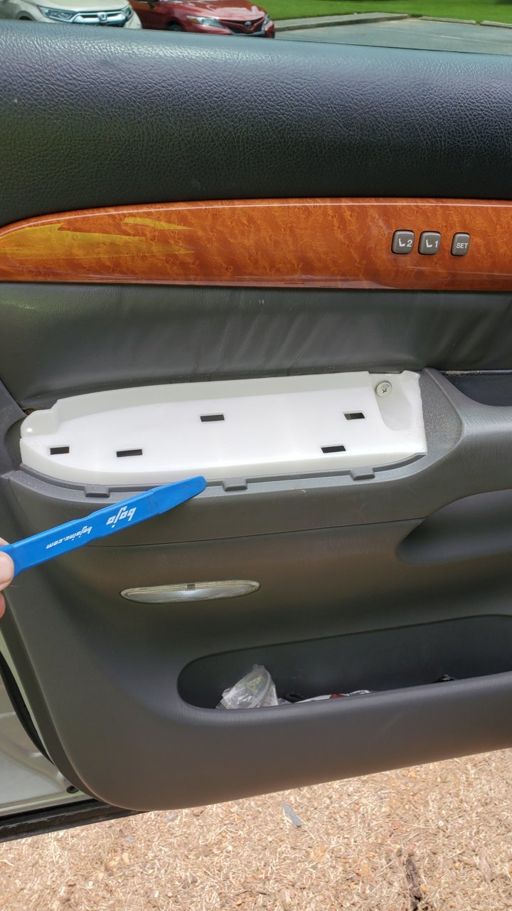

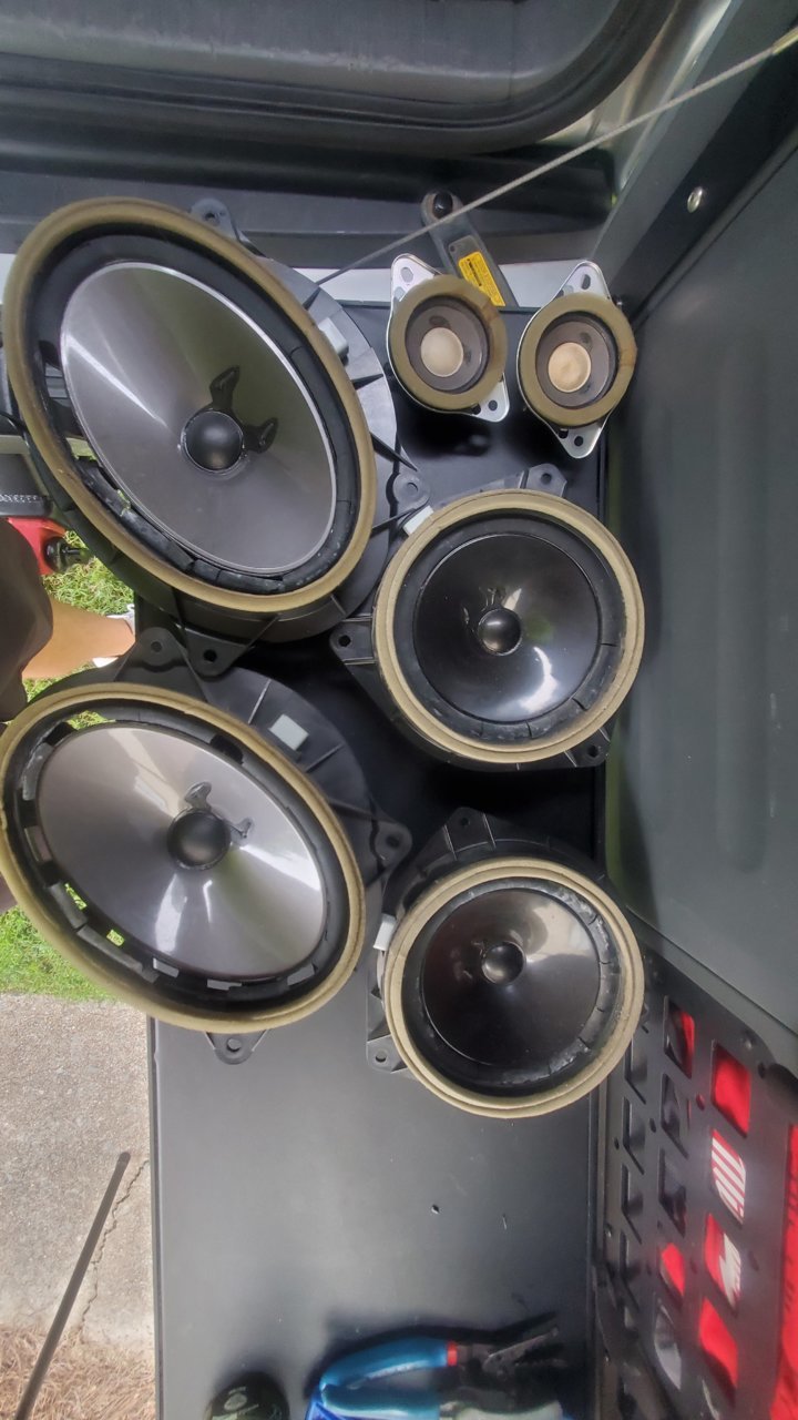

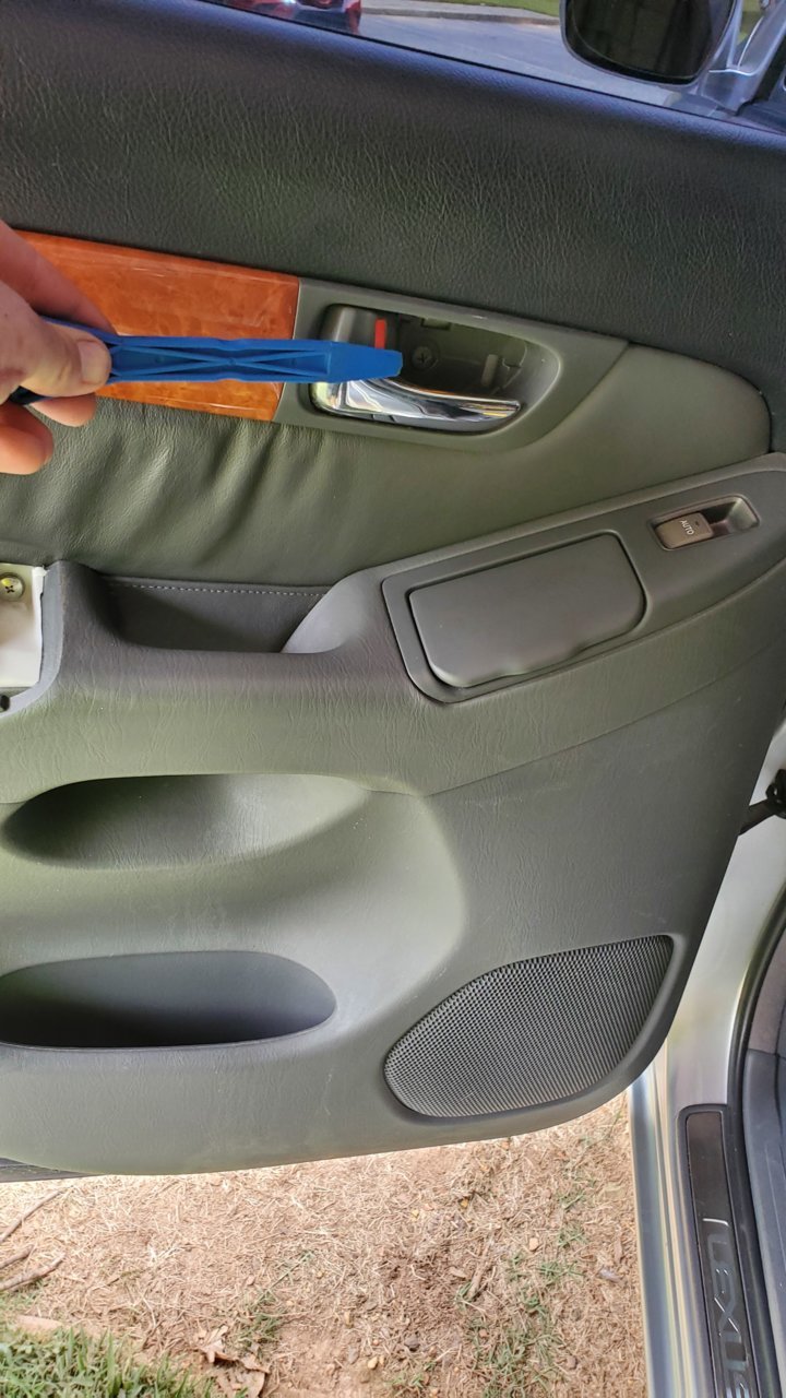

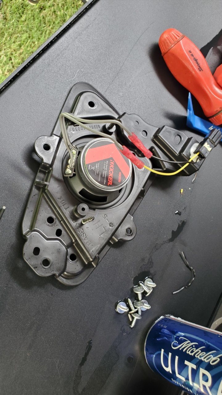

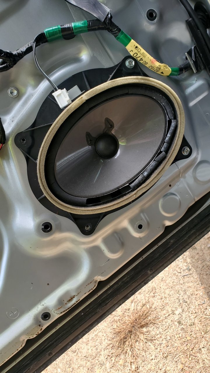

    So the man in brown delivered the goods from crutchfield so i got busy.
    Once again the part #s are
    Front Mids - 47KSC2704
    Front Lows - 43DSC6704
    Rear Door Components - 46CSC654

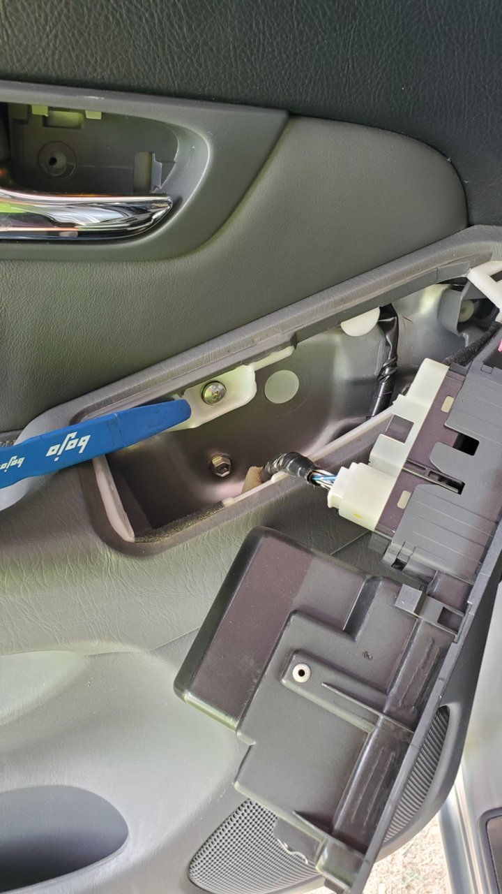

    Removal of the front door panel is pretty simple. Below are some pics highlighting the screws that need to be removed before you can start popping the door panel awat from the door. Also remember the plugs and door lock/door handle cables.
    The front mids have to be wired since there are no adapters, black to grey/black and yellow to grey. Its straight forward just know that its somewhat involved. They are also attatched to the door panel and not to the door frame.
    The front lows included the wiring adapters and the mounts. Nothing special to it.
    Moving to the rear doors, below are pics pointing out the hiden fasteners you will need to remove.
    Once again the rears included a harness and adapter. Nothing to it.
    The factory speakers were trash after 17 years and after playing with the HU settings the base still leaves something to be desired but its def an improvement over these things.
    Over all it was a 3 beer job and not difficult at all, And for the $200 investment i have in it, im pleased.

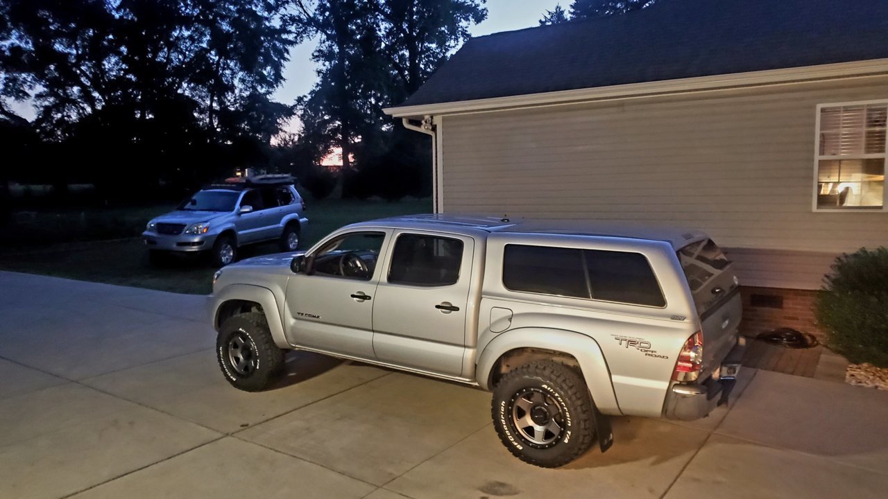

    Dobinsons Suspension, SOS sliders and slimline bumper, Smittybilt winch, Skinny Geolanders and a tune
    I have actually sold my 2019 DCOR to my son. He has walked into a Dobinson’s lifted skinny tire Taco.
    I have moved onto a 2023 Jeep Gladiator Rubicon. He has the low mileage, 37000 truck replacing his 2014 4cliner 4 speed 2nd pre runner, Will follow along on this forum for all of the great info.

    The Taco sits on 33 skinny’s with a Dobinson’s lift.
  12. Aug 27, 2023 at 4:35 PM
    #212
    Sinagua
    Sinagua Beerdom Brewing - brewing in the shadows
    Feb 15, 2018
    #244530
    177
    Rob
    Harrisburg, NC
    2019 OR DCSB, 2022 Accord Sport Hybrid
    Ruby is sitting on factory 33’s. Running on a smooth shifting 8spd auto

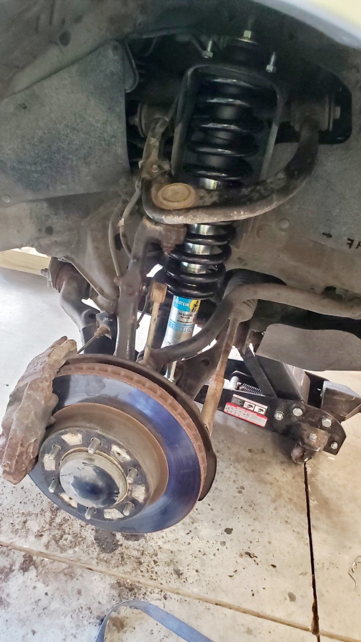

    Got my pops taken care of this afternoon. Bilstein 5100's w/ OME 885's and a 1" block in the back from eibach along with new U - bolts. His 2nd gen is a 2011 and from what i could tell had never been taken apart, we made good use of the cut off wheel.
    All in all he was happy. Wheels and tires are 17" factory offset Racelines and 265/70 BFG KO2's.

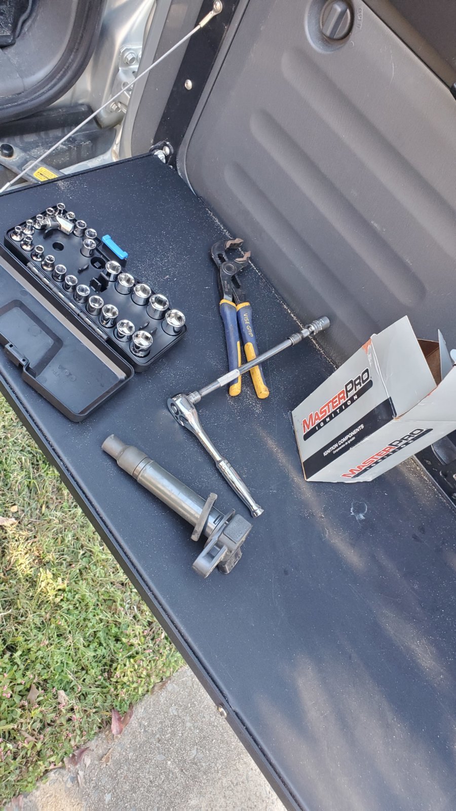

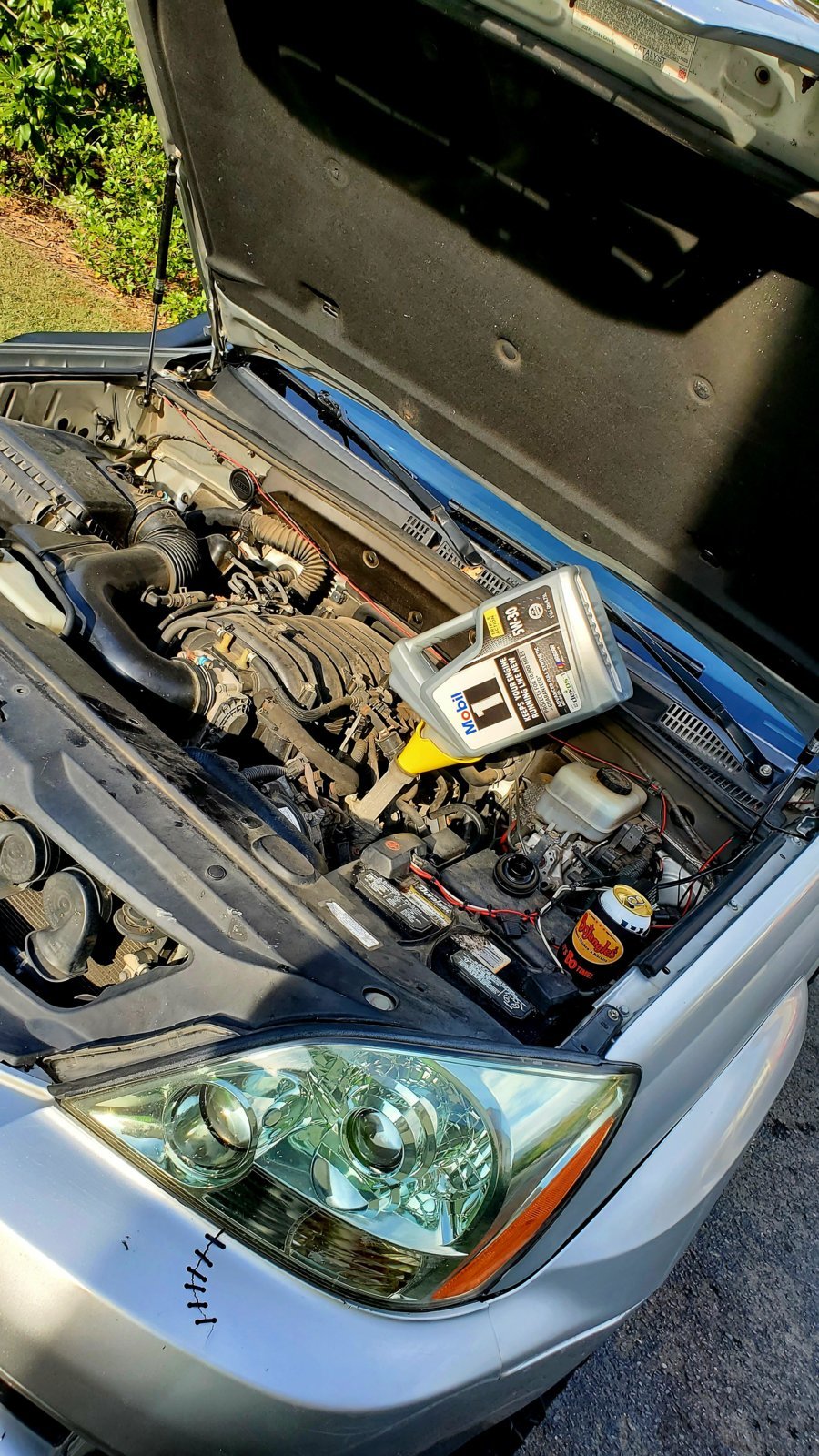

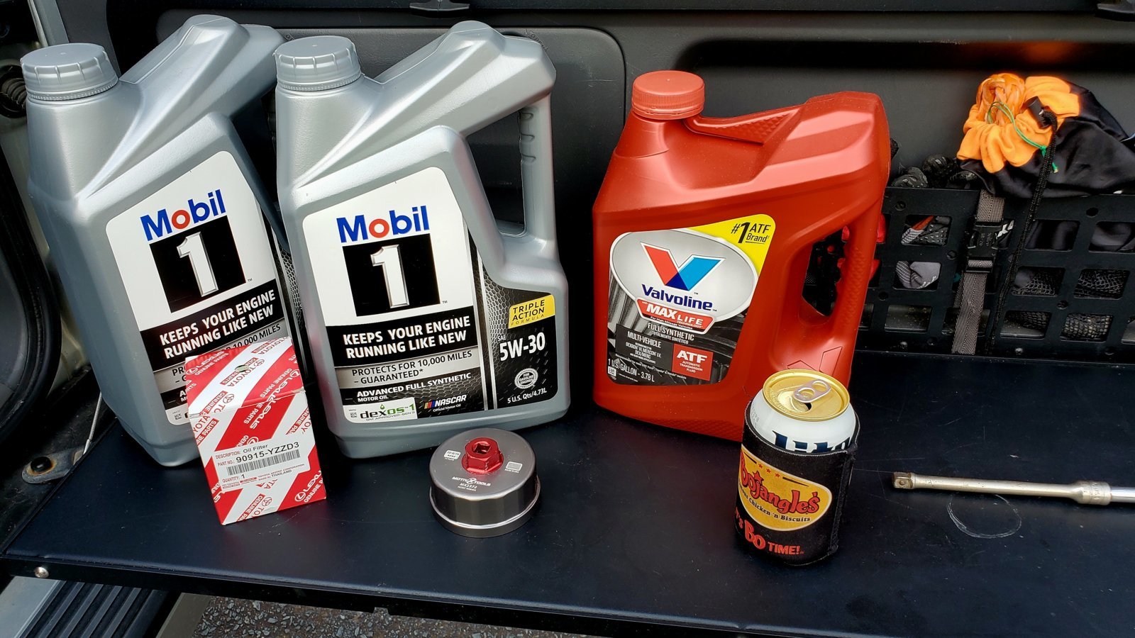

    With a fishing trip at the OBX and 1500 mile week coming up i decided to go ahead and change my oil, drain and fill on the trans, grease the driveline and another round of fluid film.

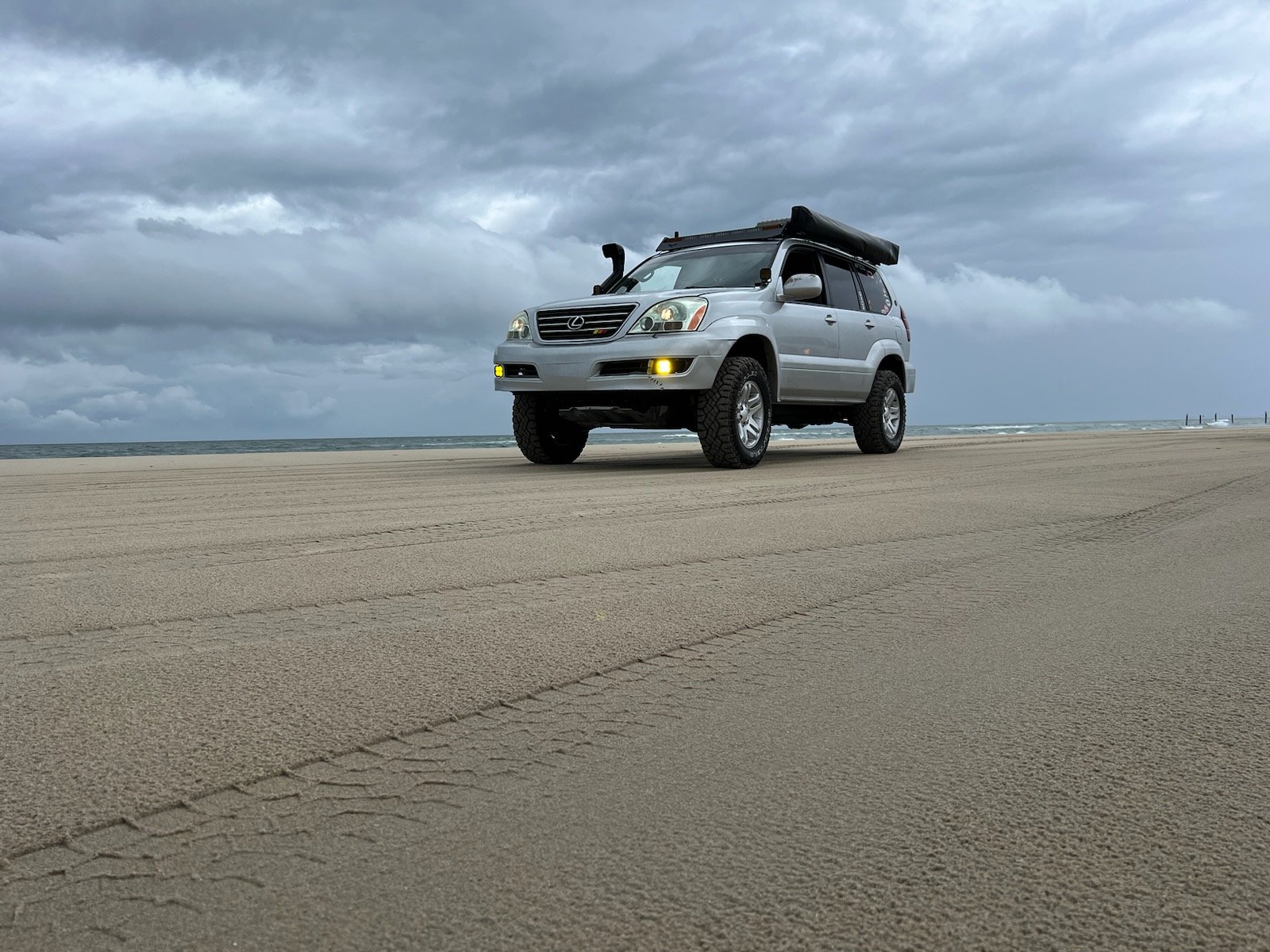

    Trip Report. October, 2023
    881 miles driven total. 58 miles of beach driving.
    Avg MPG was a lack luster 12.8.
    We had my dad and stepmom tagging along in his clean low mileage 2nd gen. We arrived in carova on Saturday Oct 14th.
    Hwy 12 dead ends north bound onto the beach and continues north for another 11miles until you hit the NC/VA state line that is gated.
    The next 7 Days were filled with fish, cold beer and damn good meals.
    Red Drum, Black Drum, Pompano, Speckled Trout, Kingfish, Bluefish and Sharp Nose Atlantic Sharks. The keeper Red, Black Drum and SNA didnt go to waste and was thouroughly enjoyed. ll dump some fish pics here and let them tell the story.
    Aside from the spectacular scenery and great fishing Corova is home to the some 100 wild horses that were brought by the Spanish in 1600's. Its a special sight to be fishing on the beach and see wild horses at the waters edge.
    All in all it was a great trip aside from a small issue i encountered on the way home.
    The GX performed flawlesly for the most part, we were about 10miles from home on the return trip and she started to stutter, i new at an instant what it was. I pulled the code on the ScanGuage and sure enough it was a P0306. A misfire on Cyl 6, i limped it home and grabbed the spare coil i carry and we were back good as new. The coil that poppes was original and made it 263XXX miles.
