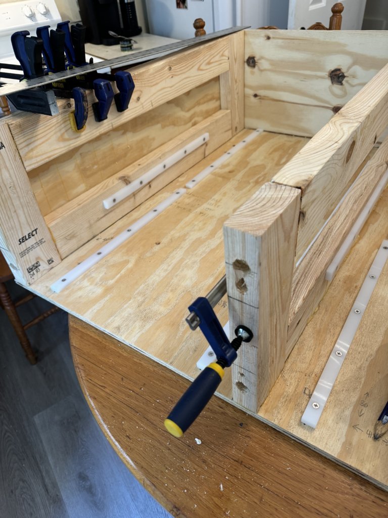

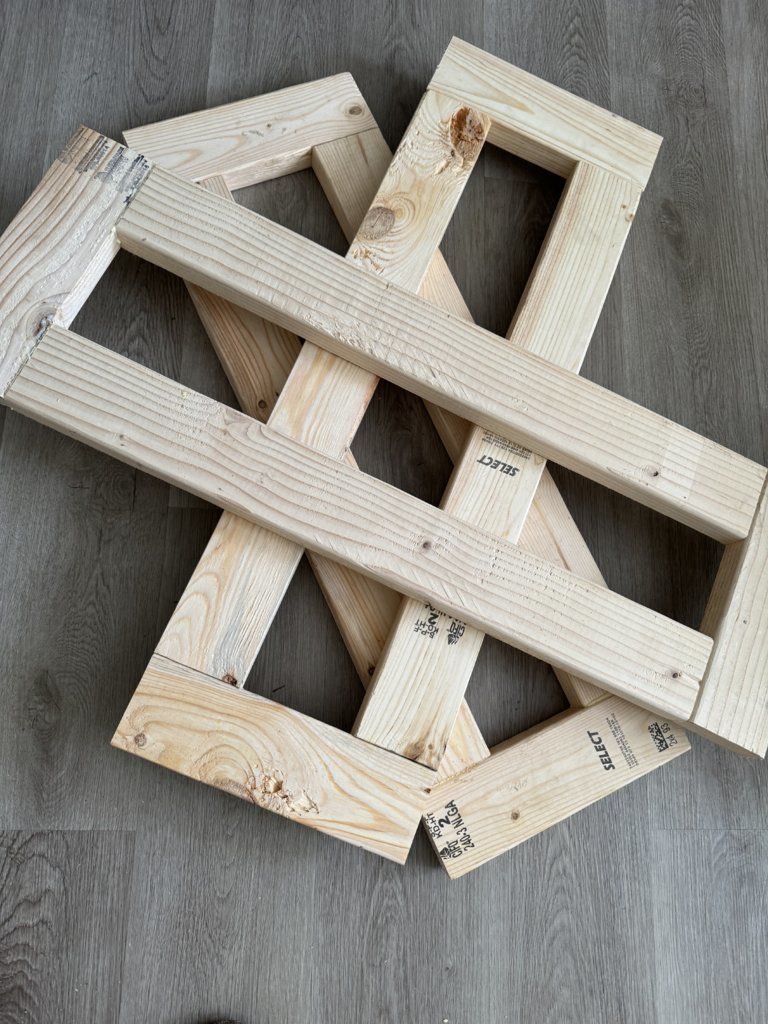

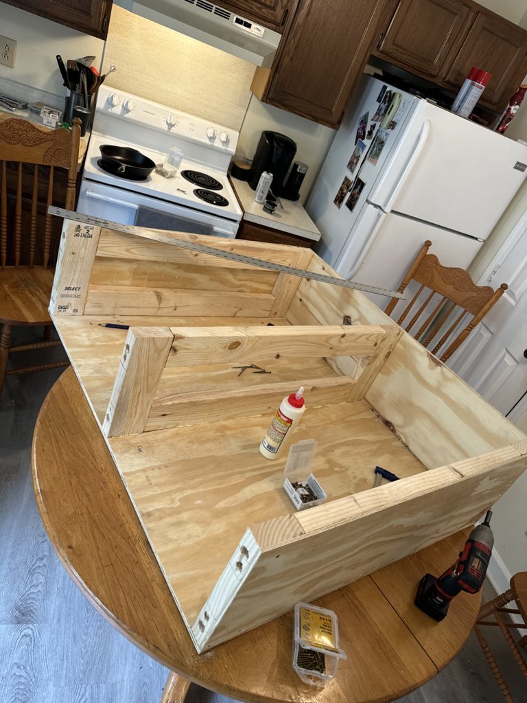

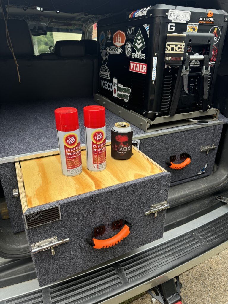

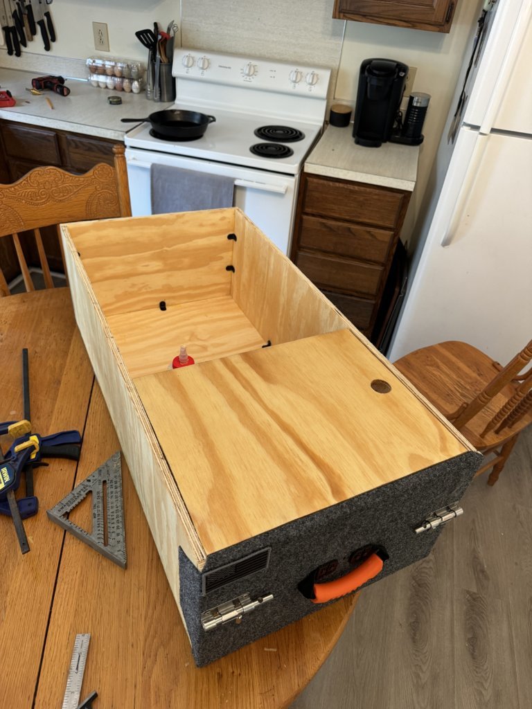

    Finally got an update for the build thread. Been wanting a drawer system for a while but refused to pay the ridiculous price that company’s like ARB or Dobinsons want so I drew out a plan. Made a cut list and went to work. 1/2 pine ply and 2x4’s. I wanted to do it right but do it cheap. Everything is glued and screwed using GRK screws and Titebond. Dimensions are 41.75 wide and 36 deep. Total volume is around 48 cubic feet of storage.
    Total Cost is between $325.00and $340.00
    Total weight I would estimate at around 160lbs. I’ll dump some pics and if anyone has any questions I’ll be more than happy to answer them
    Verifying fitment using the factory cargo tie down threaded inserts (M6 x 1mm)
    Building the frame to best utilize strength and make the most of the weight I was adding.
    Instead of ball bearing slides I chose to go with UHMW. These were purchased off of Amazon and are practical bomb proof

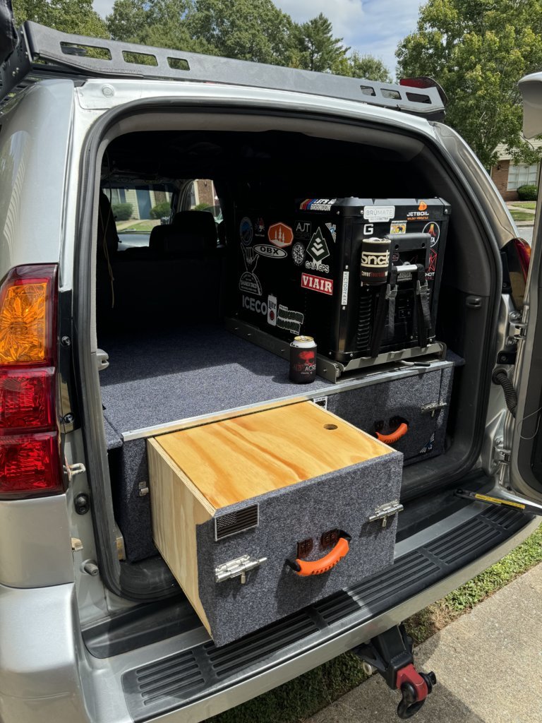

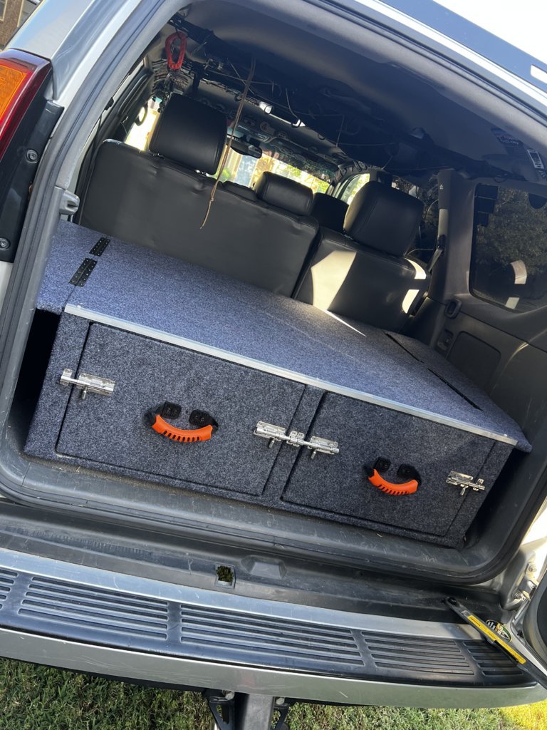

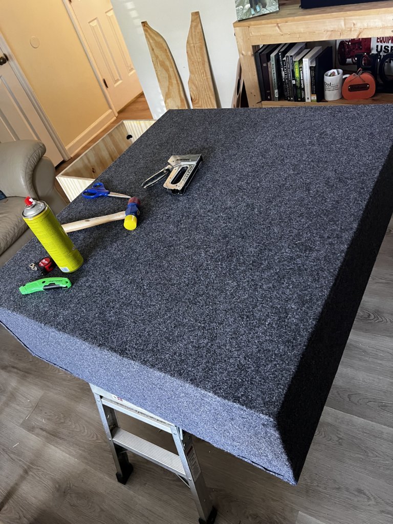

    Next was building the drawers. Pretty self explanatory. Glued and screwed. Got those built and next came carpet and hardware. Paddle latches are ridiculously overpriced so instead I went with lockable gate latches and the handles are kayak handles. Total cost was around 18 bucks, again off of amazon.

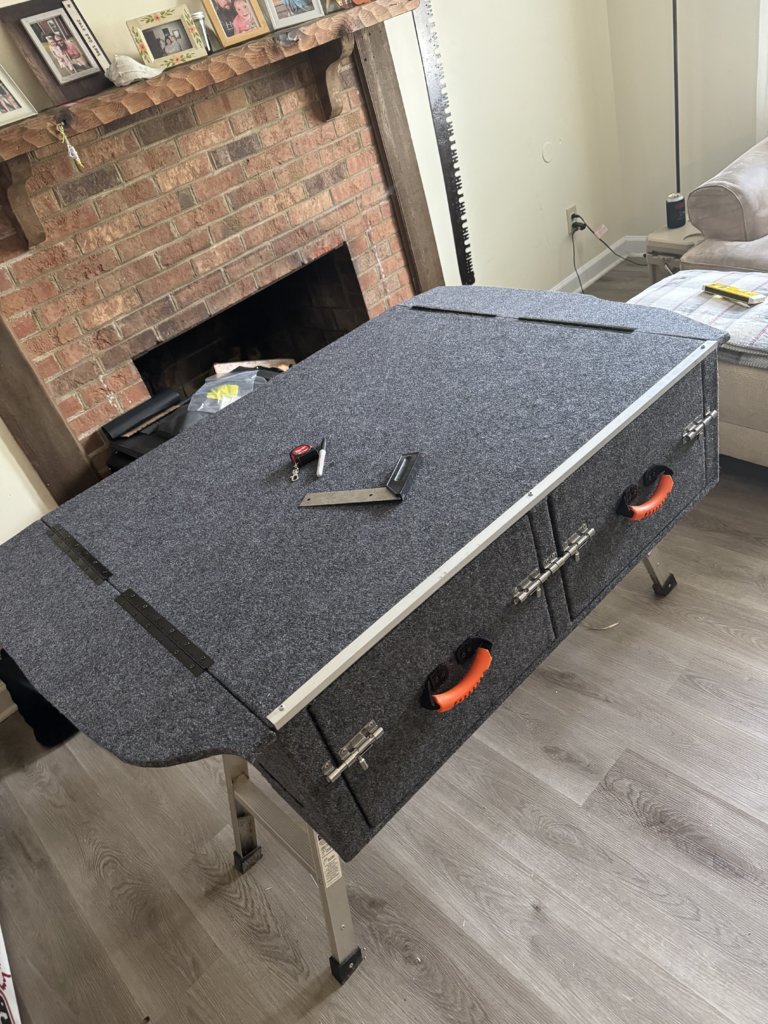

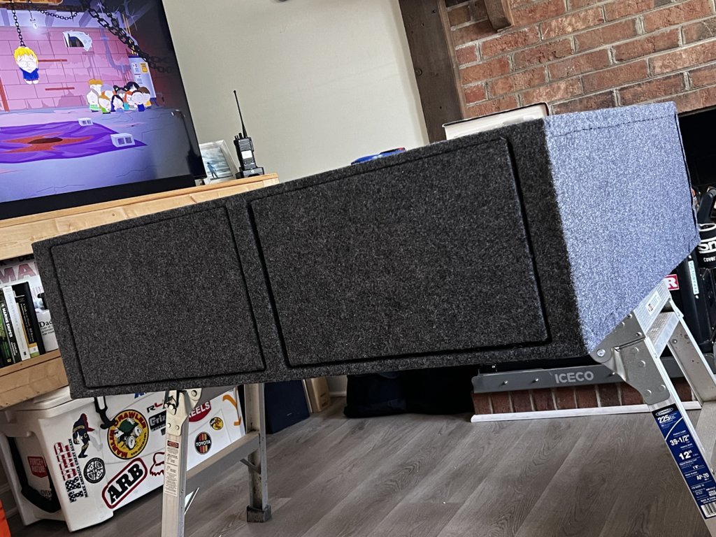

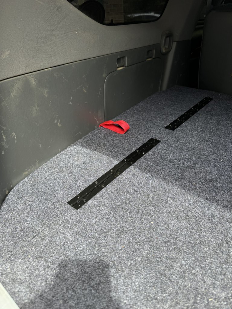

    I used cardboard to make the templates for the wings. Used 16inch piano hinges to allow me to access the area to the side of the box.
    With all that done it was time to get it mounted and get the fridge slide and fridge installed.
    I added some nylon webbing to the wings to make it easier to flip them up.
    The last step was adding a small “ table top “ on the inside of the drivers side drawer. It got a polyurethane finish.
    All in all I’m happy with the outcome but already have ideas to do it better next time.
    w.adventures likes this.
