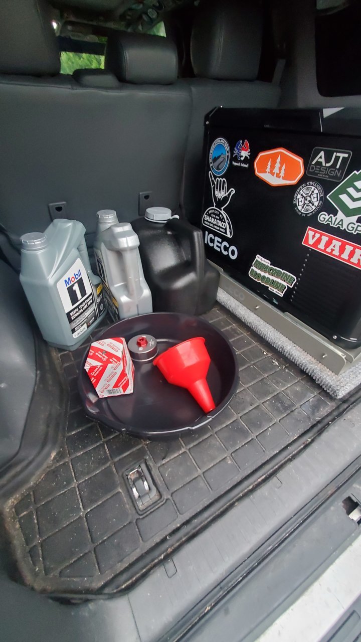

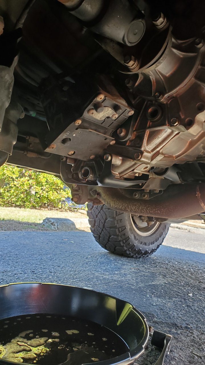

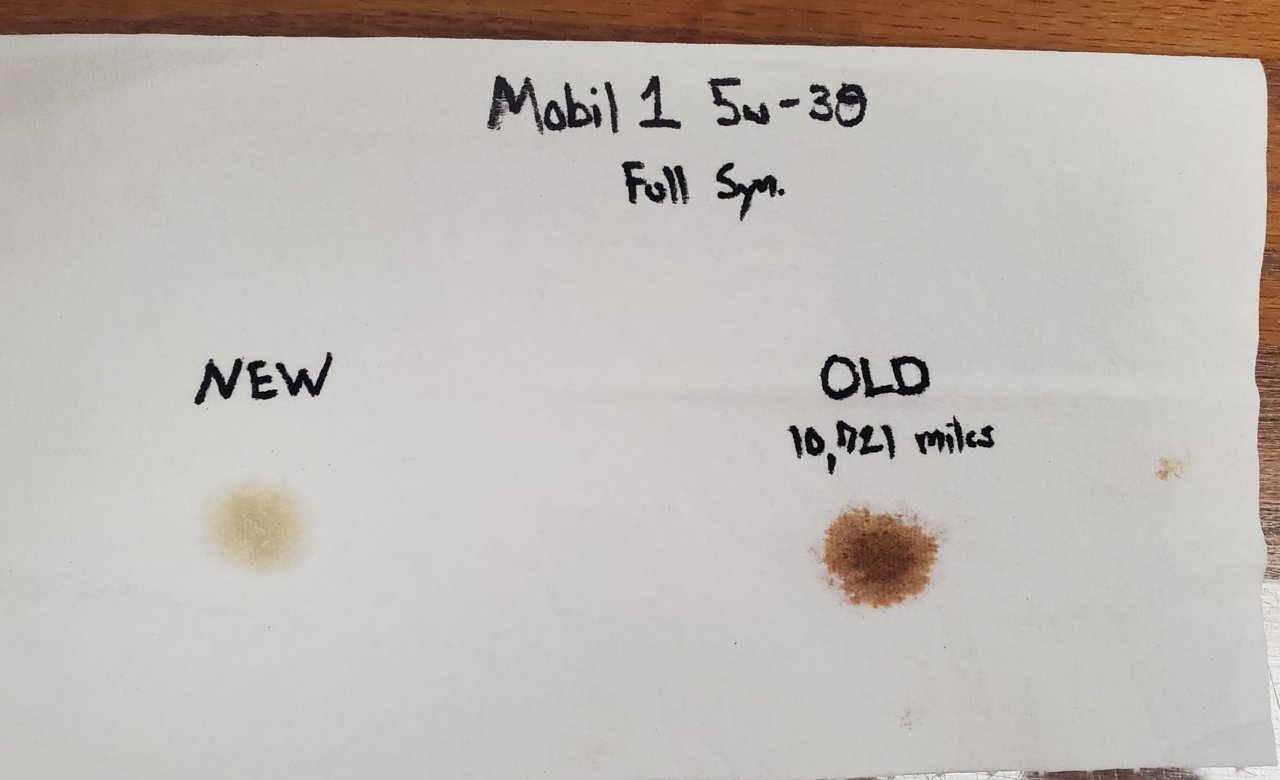

    Just recently did the 2nd oil change. Went back with Mobil 1 and 90915-YZZD3 filter. Over 10k miles on this OCI. A sample was collected and will be sent to blackstone.
    At over 10k miles the oil was definitely dirty but not at all black. No glitter or anything else found during the drain.

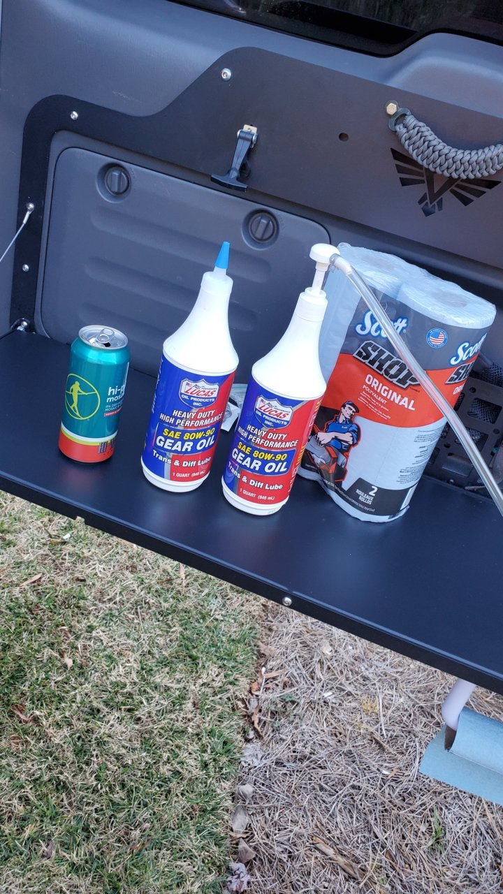

    Got around to doing the Transfer case fluid today. Found out It was in good condition upon draining but I was unsure seeing as how I havnt done it since purchase.
    Got a deal on 2 Quarts of Lucas 80w-90 so that is what's on deck today. Both fill and drain are 24mm and always Crack the fill plug first.

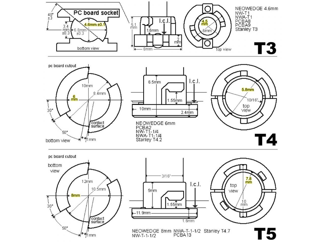

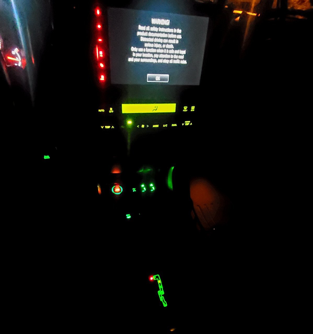

    From the date of purchase alot of the interior switch backlighting never worked. So another thing on the list was to get these working.
    After some research and measuring I ordered up some T3 (8mm base) Neo Wedge LED's in green.
    Install is straight forward, pull the switch out to expose the bulb and install the new. They are polarity sensitive so keep that in mind.
    I've owned this thing for 18months and this is the first time all these switches have been lit. Def gonna take some getting used to.
    Archangel likes this.

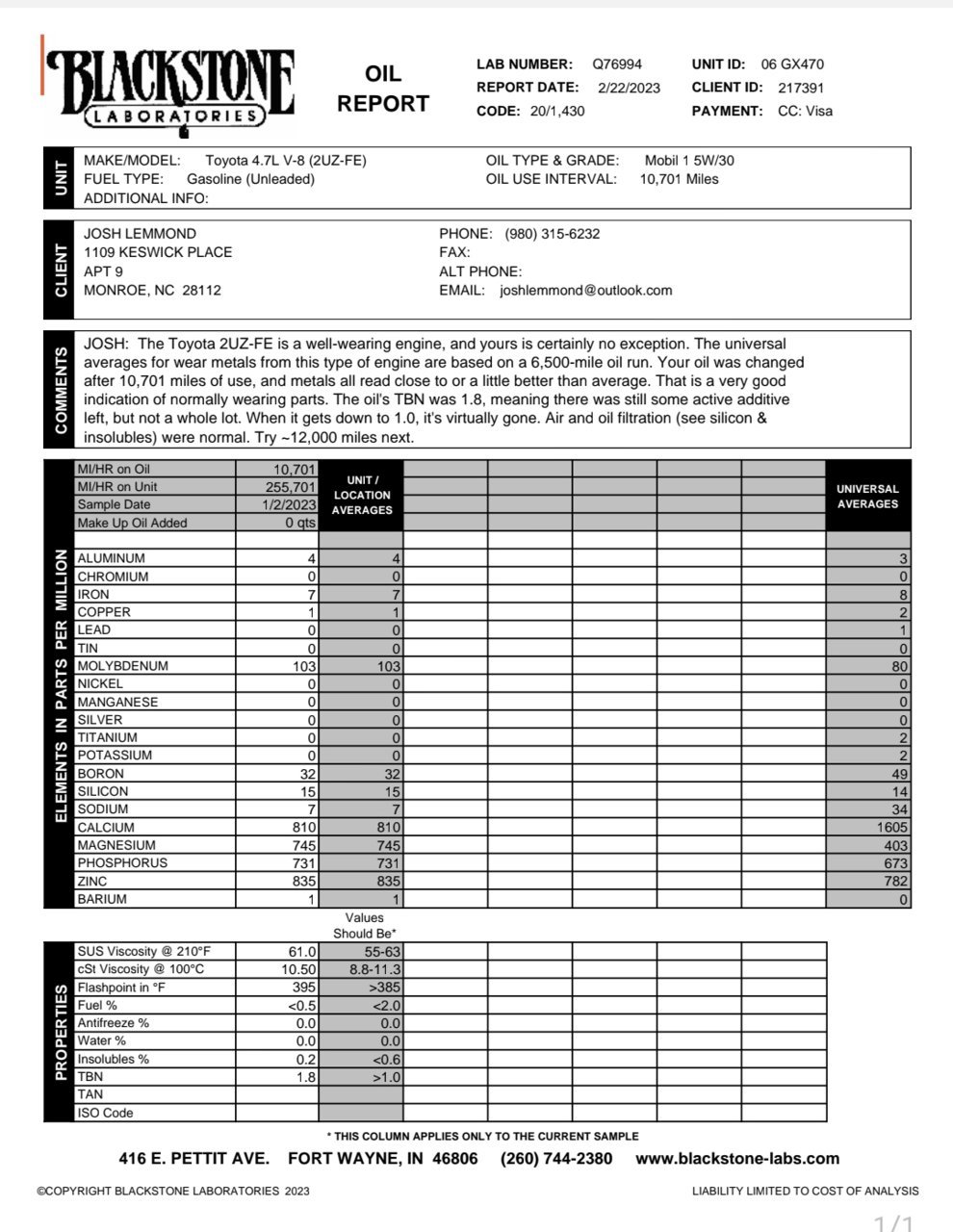

    Got the oil analysis back from Blackstone labs today. There results were very encouraging.
    JOSH: The Toyota 2UZ-FE is a well-wearing engine, and yours is certainly no exception. The universal
    averages for wear metals from this type of engine are based on a 6,500-mile oil run. Your oil was changed
    after 10,701 miles of use, and metals all read close to or a little better than average. That is a very good
    indication of normally wearing parts. The oil's TBN was 1.8, meaning there was still some active additive
    left, but not a whole lot. When it gets down to 1.0, it's virtually gone. Air and oil filtration (see silicon &
    insolubles) were normal. Try ~12,000 miles next
