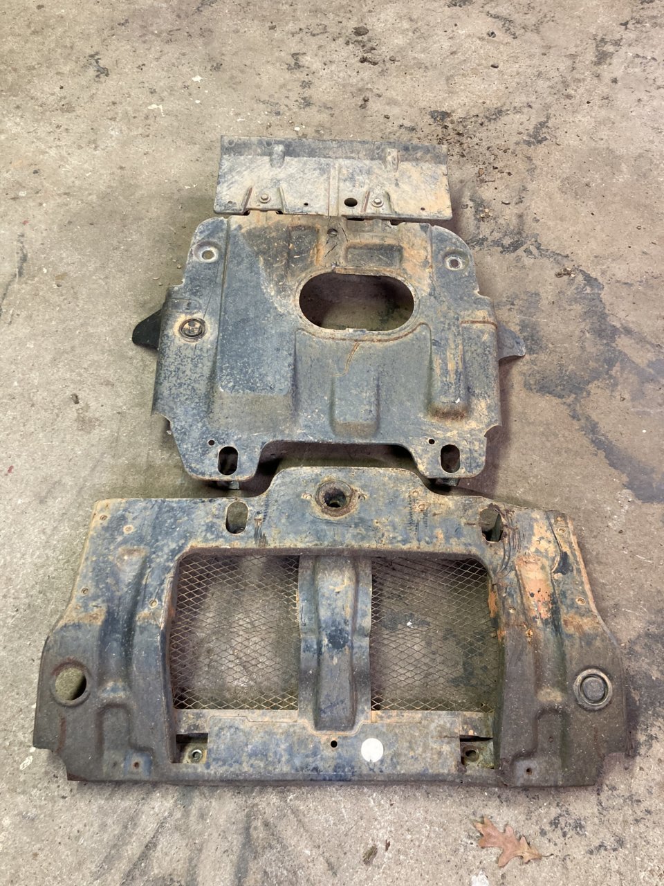

    Don’t worry he doesn’t have anything but factory skids too.

    Yeah and they are bent to like crazy.
    Never said anything about steel skids :pJust how terrible the stock skid plate is on these things(it literally has mesh in important spots). You did a great job cleaning and painting the stock skid

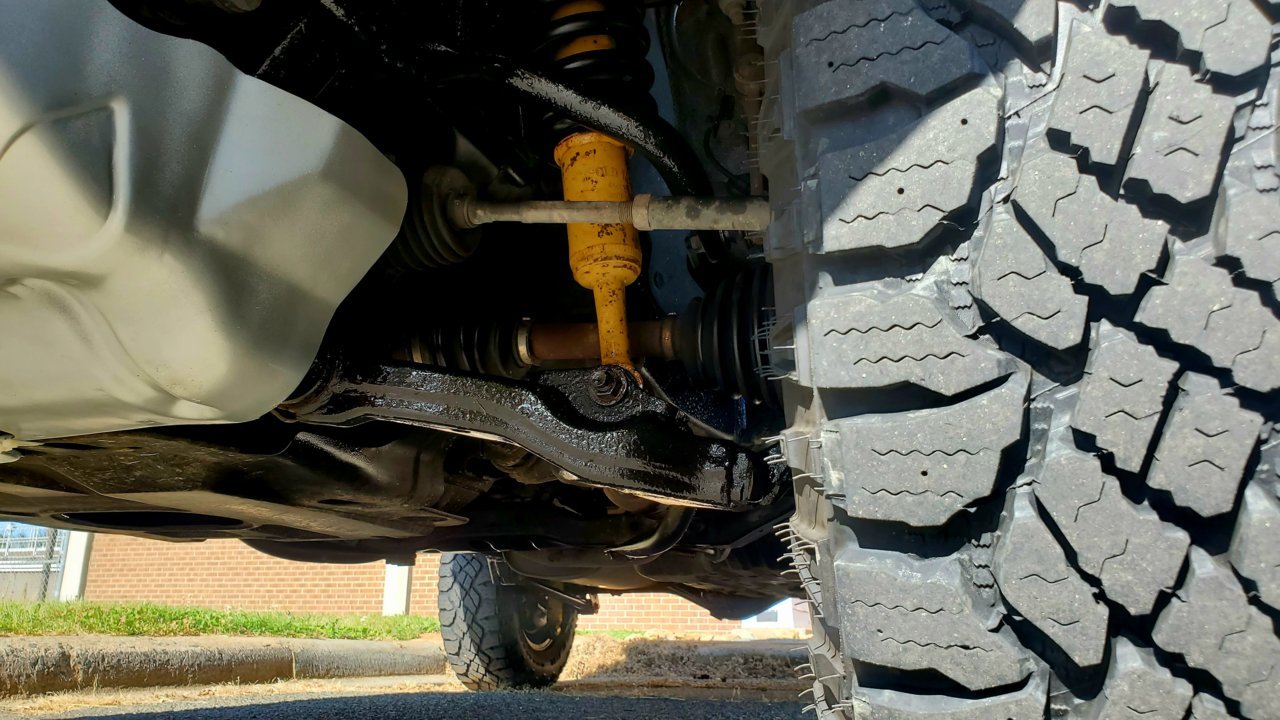

    Was able to knock another thing off the Maint. List yesterday. With quite a bit of surface rust but nothing to bad just yet, I wanted to get ahead of the issue. After reading so many rave reviews about FluidFilm I decided to give it a try.
    I was able to pick some up from the Autozone near me for about $13.00 a can. I bought 2 cans and used 1 and 3/4 cans. No prep work was really done but frame and all suspension components were relatively clean and 100% dry.
    Some of the surface rust in question.
    FluidFilm in aerosol cans.
    Having never used this stuff before I glanced at the instructions and per the can ... " you can spray it on everything " so that pretty much what I did. Frame, cab mounts, suspension components, Axles and diff's, cab mounts. If I could reach it, it got sprayed but within reason.
    It definitely goes on with a very filmy consistency and does have an oily smell. 24hrs later it looks just like it did when I sprayed it on. Hopefully this will keep the corrosion reasonable on this 18 year old frame.
    I will go back in the next few days and give everything a once over and look for spots i missed or areas that could use a little more. Living in the south we dont really have any issues with salt and slag but we spend a considerable amount of time at the beach and on the beach and protection from those elements cant hurt.

    All that mall crawling has beat up my skids. The kdss skid plate is half mesh, at least yours has more tinfoil. We need to plan a camping trip to uwharrie or the gulches.

    Why is the mesh portion so much bigger on the KDSS models?
  10. Apr 24, 2023 at 8:48 AM
    #130
    SearArtist
    SearArtist GX poor
    Jan 5, 2016
    #174151
    18,980
    NC
    GX470 & GX460
    Things
    the swaybar hangs a lot lower
