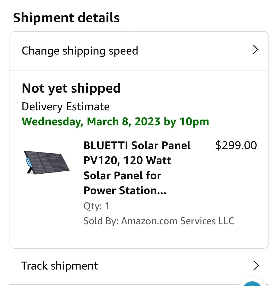

    Been using my Bluetti EB3A to power my Iceco VL45PRO fridge and charging the power station off the 12v cigarette outlet in the GX. This is a great and easy solution as long as the car is running and the alternator is doing its job.
    However when we're on the beach or parked up at camp, we were basically on a wing and a prayer as far as battery consumption was concerned.
    To try to alleviate that I picked up a Bluetti 120w solar panel. Should work nicely in keeping the power station topped up. I'll post more once I get it in my hands.

    Should be more than enough to keep the battery charged and the fridge powered.
    200w panels for my Jackery 1000 work great at Fort Fisher.

    My thoughts exactly. I'm excited to put it to use. My fridge only draws around 30w once it's at temp. If i can get at least 50w of solar an hour we will be in good shape.

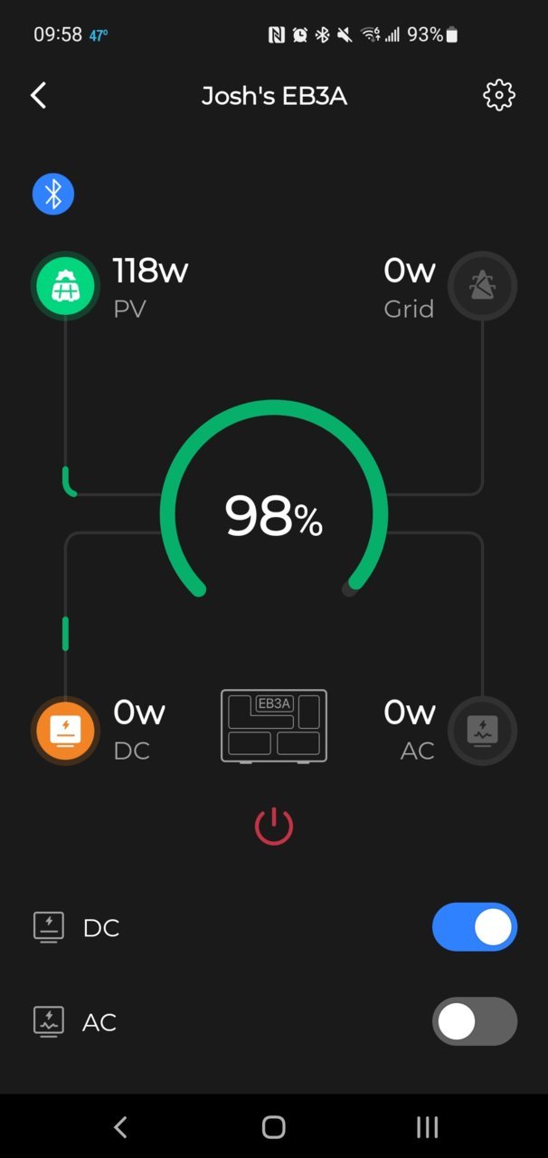

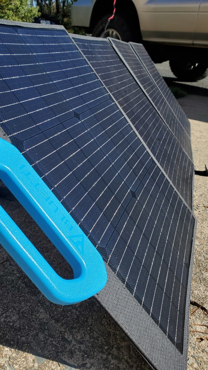

    This morning was the first morning of full sun since I received my PV120 so I set up up to see how it woukd do. And im happy to say I was more than impressed.
    The first screenshot was at 0930. Solar panel was pulling 118w while the eb3a was sending out 49w to the fridge. The fridge was empty and at an ambient temperature of 49 degrees when I turned it on.
    Second screen shot was at 1000. Solar was still providing 118w. The EB3A's battery percentage had increased from 88% to 98% and the fridge was at 32 degrees and holding.
    I'm super stoked to be getting so close to the advertised 120w output. The panel seems to be constructed well and I think the $300 price point is fair. Not a steal but fair. The only thing I find lacking is the length of the MC4 leads. I will be purchasing extension cables to allow for better placement depending on conditions.

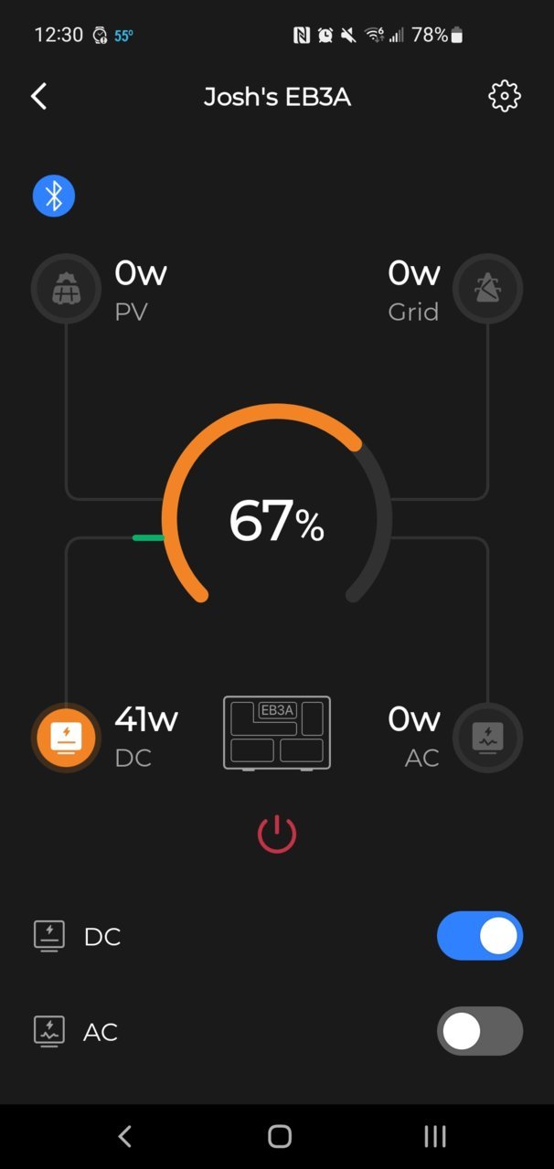

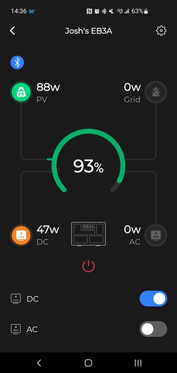

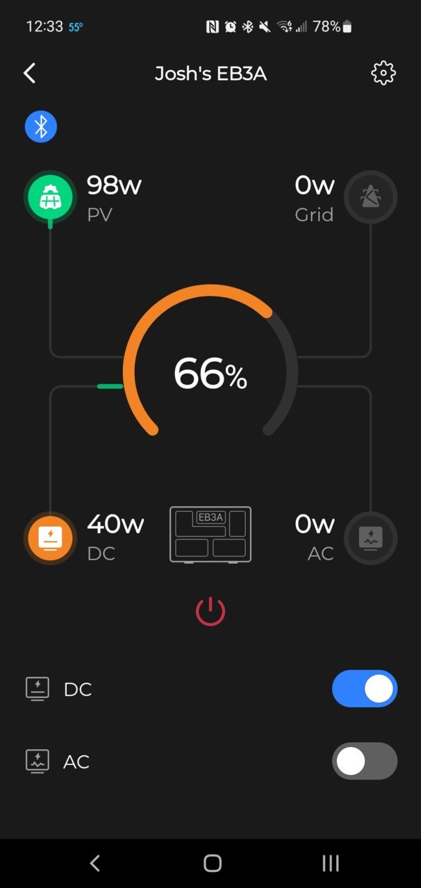

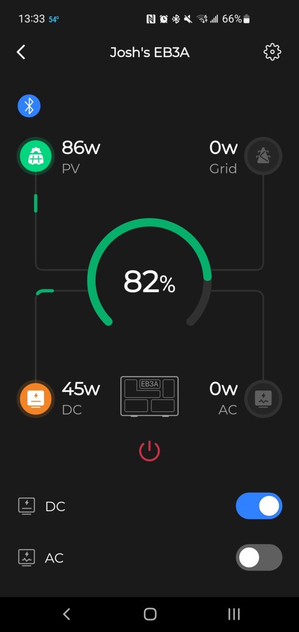

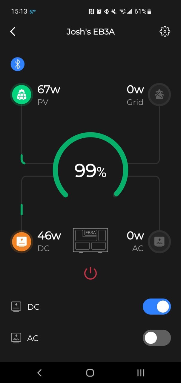

    After a successful use this morning, I thought I woukd try it again. So sometime around 1030 this morning I let the fridge warm back up and then set it at its lowest temp setting. At the same utilizing the USB ports on the front of the fridge i plugged in my phone and my JBL charge Bluetooth speaker. I spent the next few hours letting the power consumption of the fridge pull the EB3A's power down to 68%.
    I brought the solar panel back out and monitored performance on the hour.
    EB3A prior to solar imput @1230
    After solar imput @1233
    Solar charging @1333
    Solar charger @1436
    Solar charging @1513
    It's pretty evident that under my normal usage and with a healthy supply of Vitamin D ... the 120w of potential solar is more than capable of supplying my usual power demand while still charging the EB3A from 68% to 99% in a little under 3hrs.

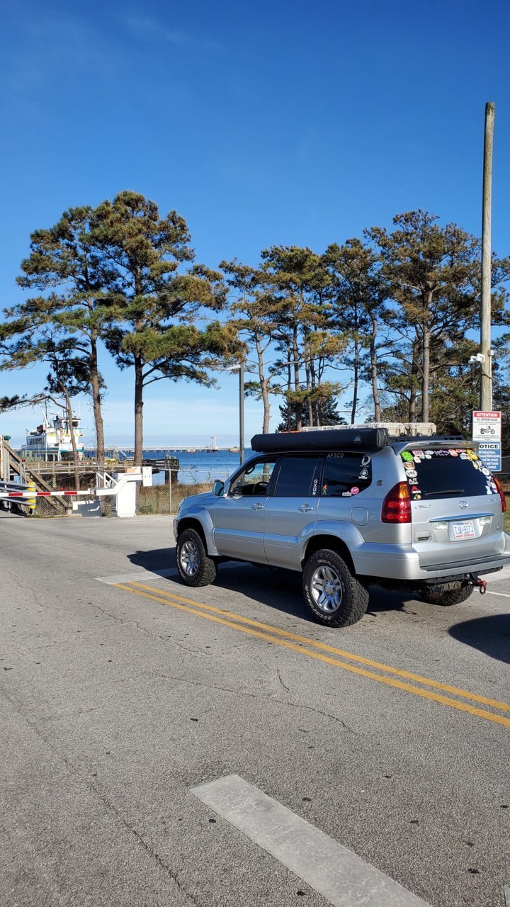

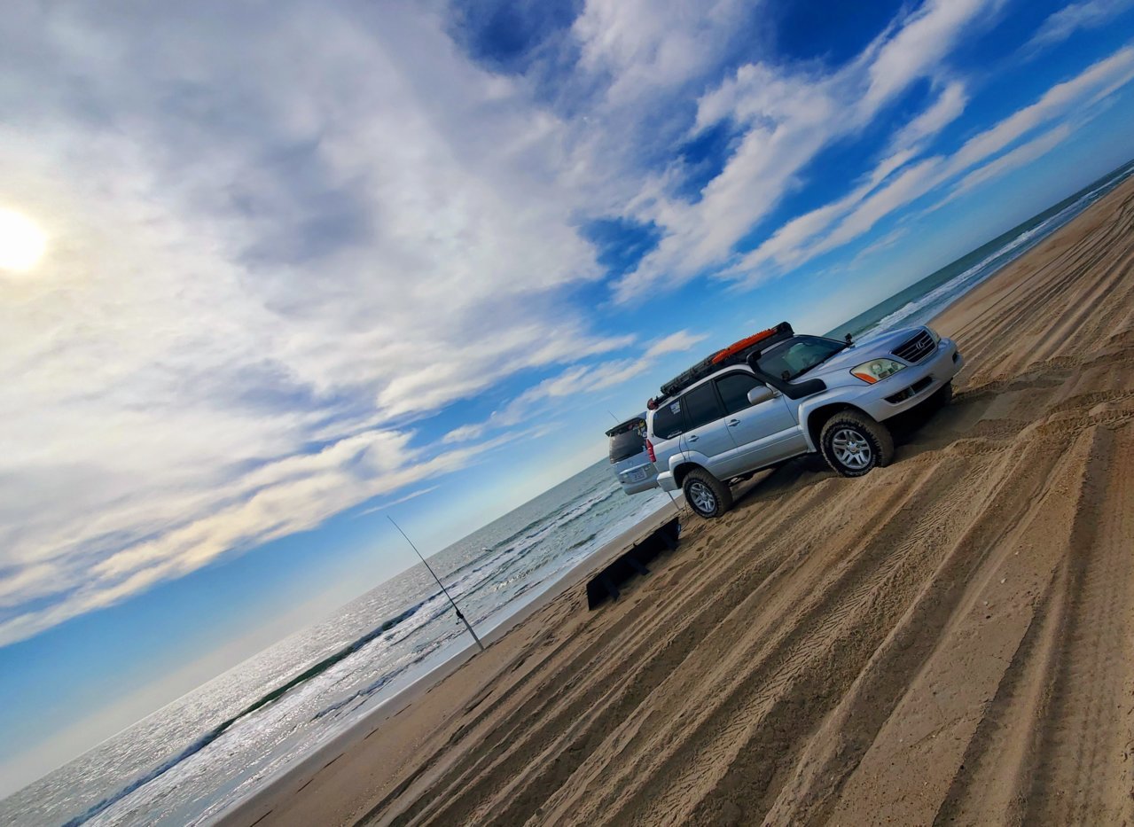

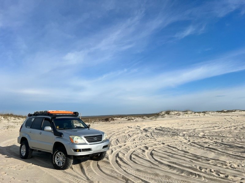

    Trip Report. 3-18-23
    First trip to the NC coast for the year. 450miles covered total. 19 miles of Beach Driving. Stauns down to 18psi. Fishing was decent for an early season trip. MPG avg 13.

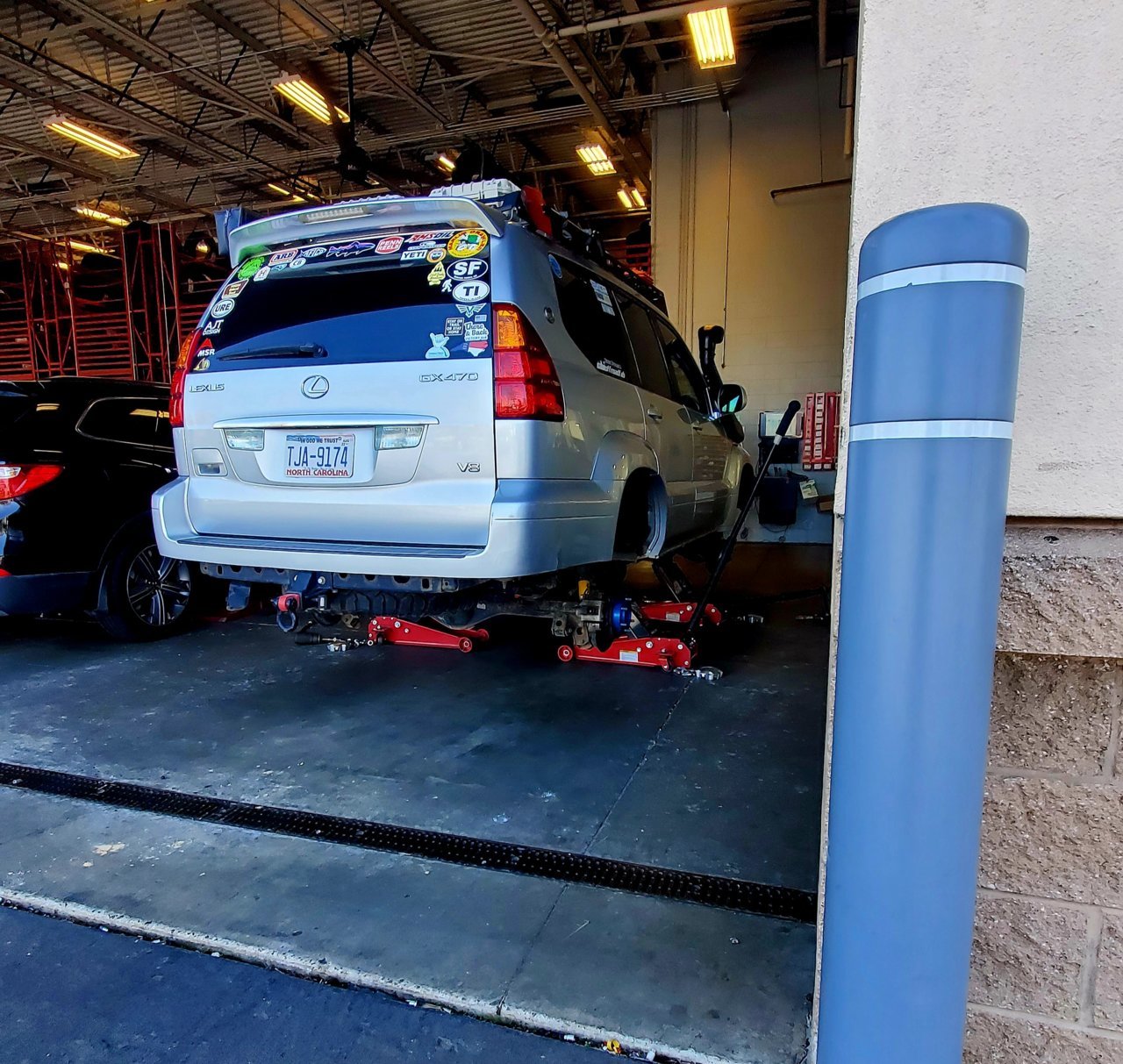

    Tire Rotation by the boys at the local @Discount Tire
    I've currently put about 21k on it since I've bought it without a rotation. The Goodyear's are wearing well with 30/70, off road/highway driving, currently running 38psi front and 36psi back.
    Current mileage is 257,660

    Make sure to tell Jacob to have the boys use the finger plates on those wheels. Otherwise, you'll be returning for a rebalance.
