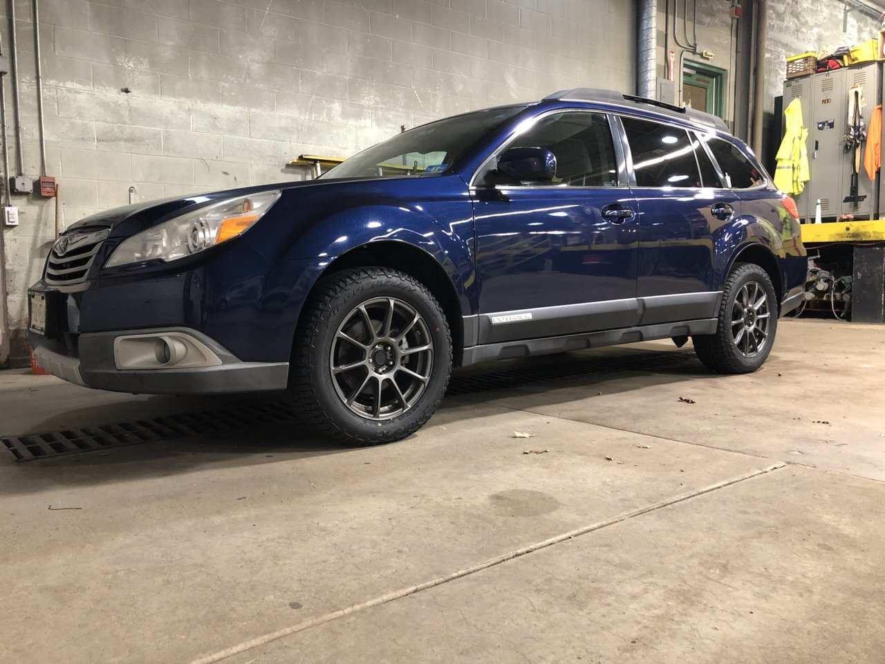

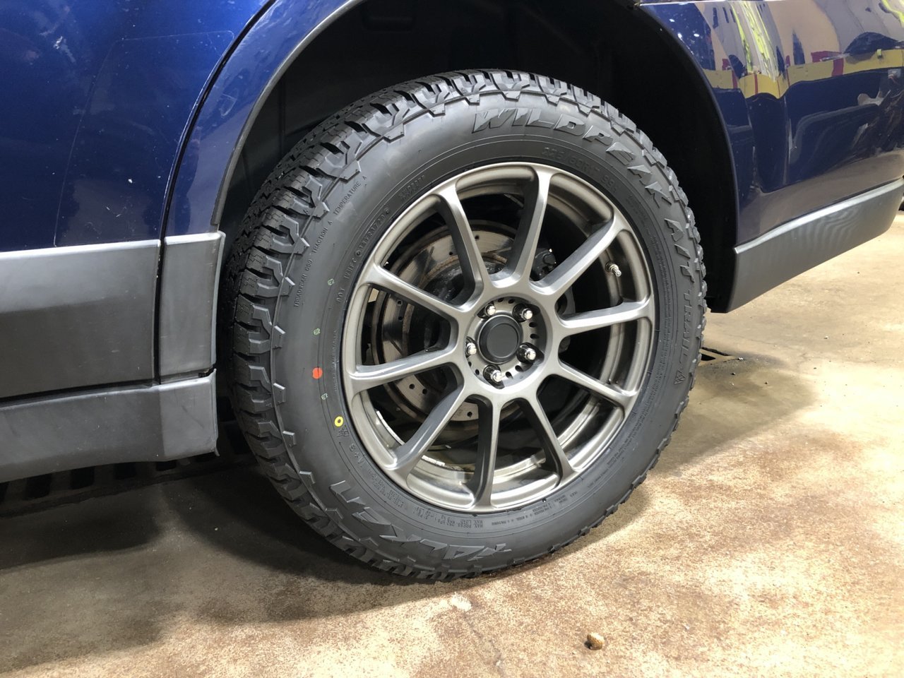

    Decided to go ahead and get the heads milled, new head gaskets, water pump, timing belt, tires. Need to order pads and rotors.
    225/60/17 falken wildpeak at trail
  15. Jan 15, 2021 at 11:13 AM
    #35
    JLink
    JLink [OP] Well-Known Member
    May 9, 2010
    #36795
    12,579
    Josh
    Ocean, NJ
    Lifted, Locked, Armored. Ready To Wheel.
    Well that didn’t fix it, so we ended up swapping out the motor :(
    $8k later, it has a new used motor, new tires, new pads and rotors.

    Ocean, NJ
    Falken wildpeak trail at 225/60/17
