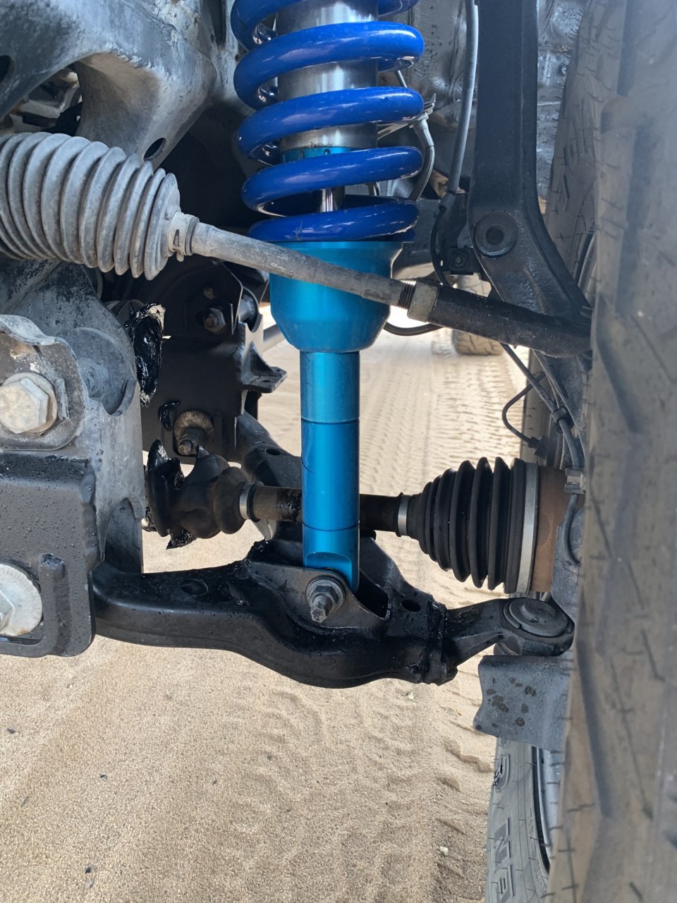

    Finally got the kings installed! And holy these springs didn’t settle much so I will have basically no threads showing on the shock body. CB8E426F-9C45-480A-873E-7C861DEEAED7.jpg

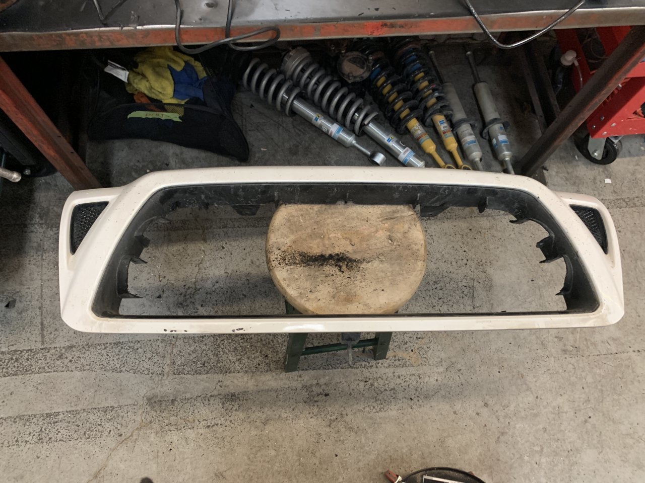

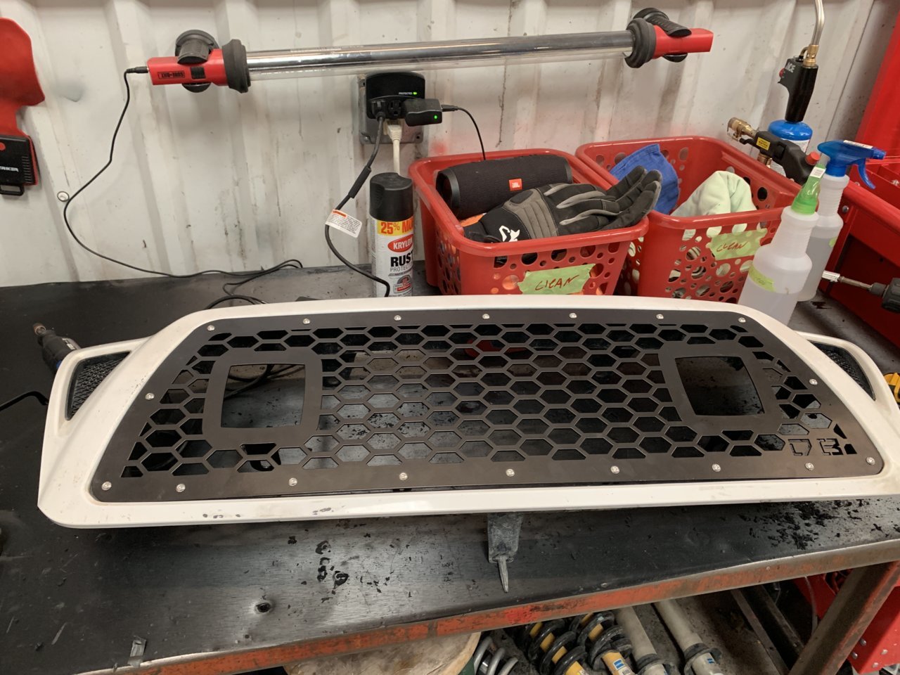

    I also got around to installing a DB customs grill. I was pretty nervous chopping up my OEM grill but install was straightforward with a dremel. I also just placed an order with caliraised to get some pods for the grill and ditch light kit.

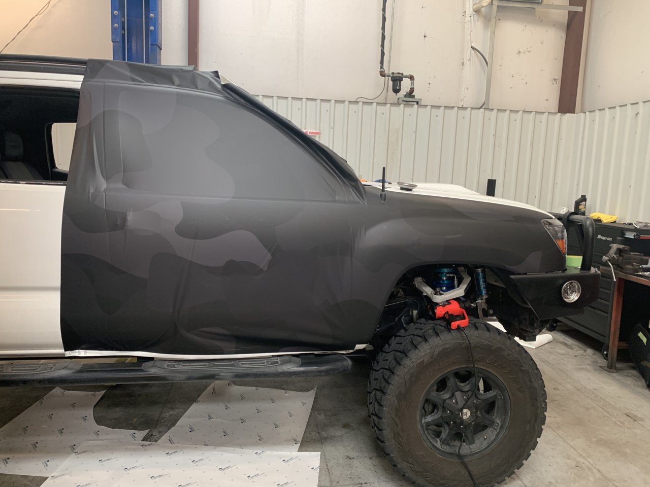

    Getting started on my new vinyl wrap. Pretty long tedious process but I’m super happy with how it has been turning out.
    PRO TIP: if you pull in a triangle to the corners it makes the vinyl lay flat then you can do overlapping squeegeeing to lay it faster.

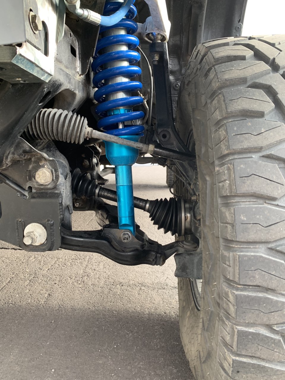

    feel like an idiot for throwing my OEM ones away because split boots. Also my fabtech diff drop was re installed half assed by the person who installed my new gears. So I think I broke the bracket which allowed the front diff to raise about 1” and when the truck had droop on the front left while climbing the hill was enough for it to snap. Here is what I found after replacing the CV. I honestly hate how lazy “mechanics” can be. Instead of spending the money for installs I will be doing a majority of my own work to my rig. Took me a couple hours but I was able to lower the diff down and get 3 bolts as it should have all connected. This improved my angles but I will now need to lower my preload on the coils. I think I need a nicer spammer wrench than the ice pick king sent.
    Thanks @HomerTaco for the help. See bottom pic of updated CV angle.

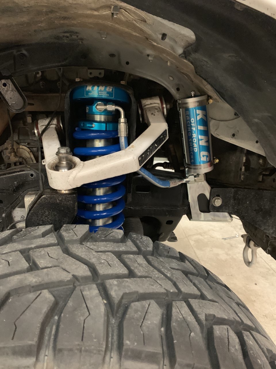

    Whats up my man. I saw you did a little write up on the DK UCA's and I see you still have them. How have they been treating you since your last report? I read somewhere the UCA can rub the hose of the rezi a little. I also have Kings, so hence the inquiry. Hows your caster numbers looking? I need to replace bushings in my SPC's, but thinking it may be time to upgrade a bit. How often do you find you need to dry lube the ball and grease the bushings? I know I'll need to do more maintenance coming from an SPC, which I pretty much do nothing for, just trying to get an idea. Appreciate any info you can give, thanks.

    So far so good. I dry lube them anytime I’m doing maintenance on the truck. Haven’t ever had any squeaking come from them ever. I think I’m going to replace the uniballs soon. I’ll have to get back to you on my alignment numbers. And I do not see any rubbing on the resi or resi hose.
