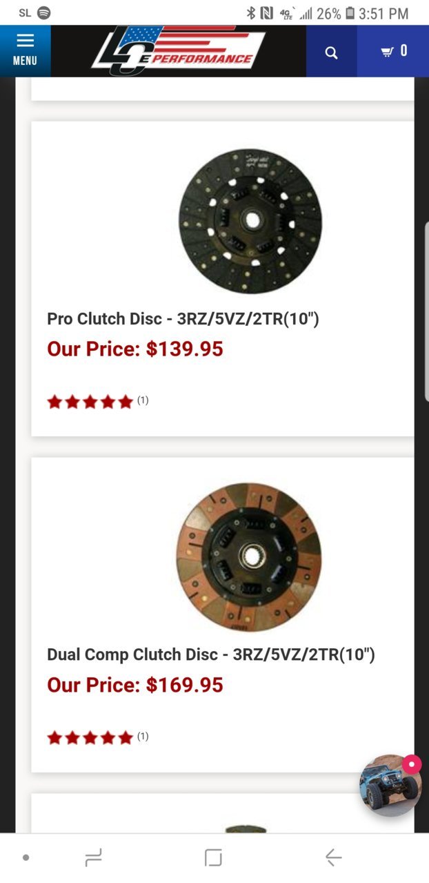

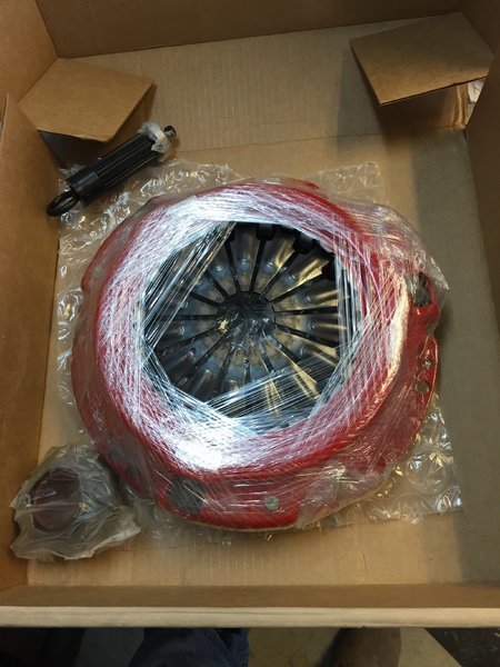

    I think I'll stay with the pro clutch most likely and I'm hoping I can just replace the disc and put in the heavy flywheel

    Or is it recommend I do a whole clutch again for good measure?

    Do the full clutch. The labor is the hard part. Don’t want to do the job twice

    Yea you right!!!! I think for sure on the heavy flywheel and debating to get a PRO again or check out other options like the spec clutch.

    Just like David said. You gotta do the whole thing. You could maybe reuse the pilot bearing. You might not like the dual comp pad. They have a smaller engagement range.

    Yea if you guys are running the pro I should be fine with it again too. But I think the heavy flywheel should help having to feather the clutch to prevent stalling along with an obvious regearing.
