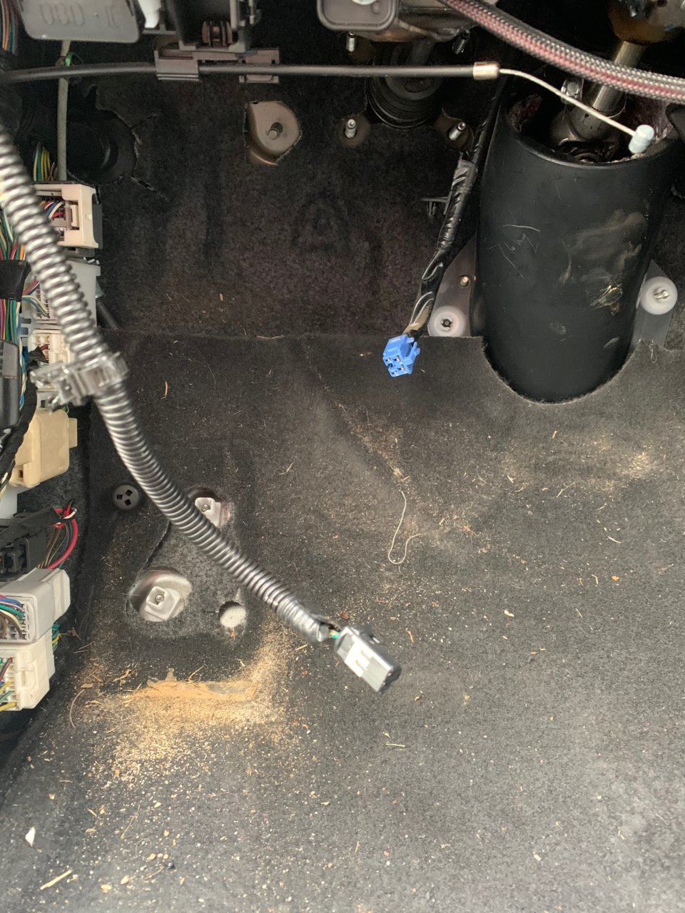

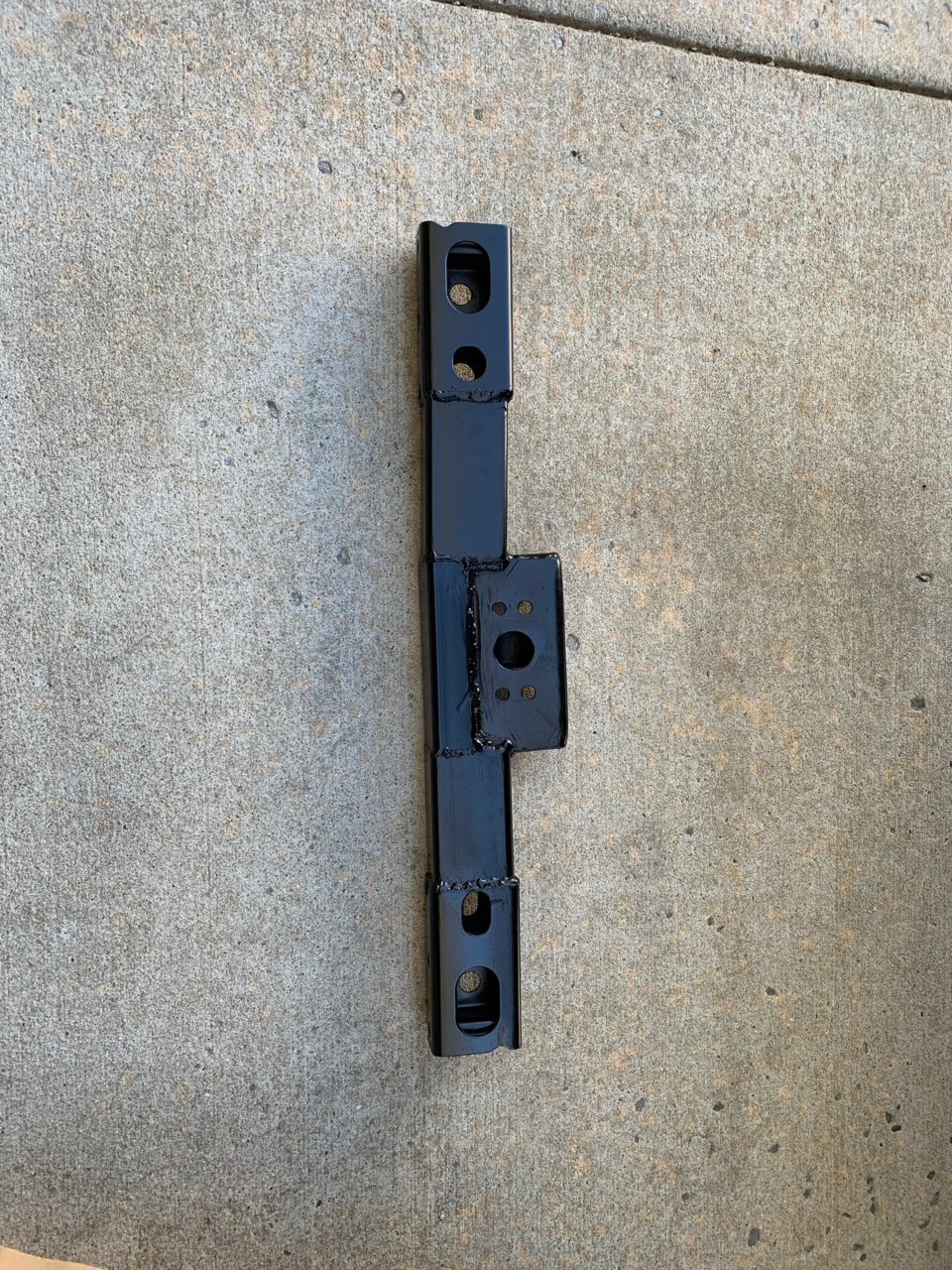

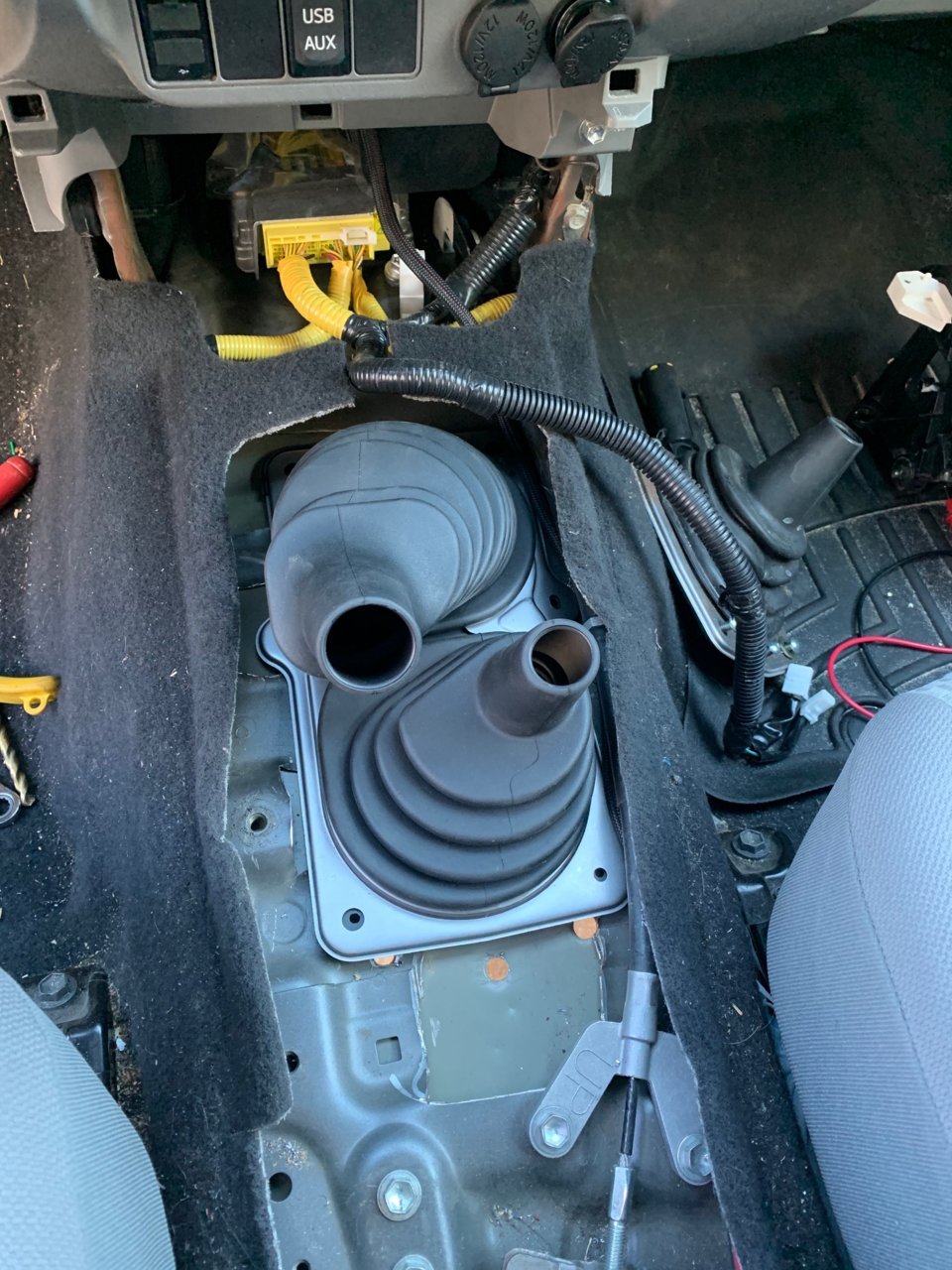

    5MT SWAP
    I’m in the middle of doing a manual swap on this turd. I’m pretty sure it will be the only 2nd gen 2.7L 5MT 4WD DCSB. Not that it’s much to brag about.

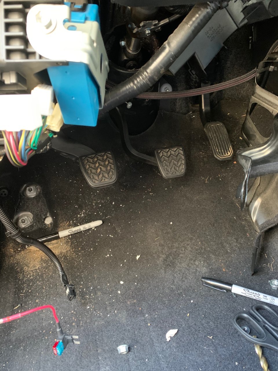

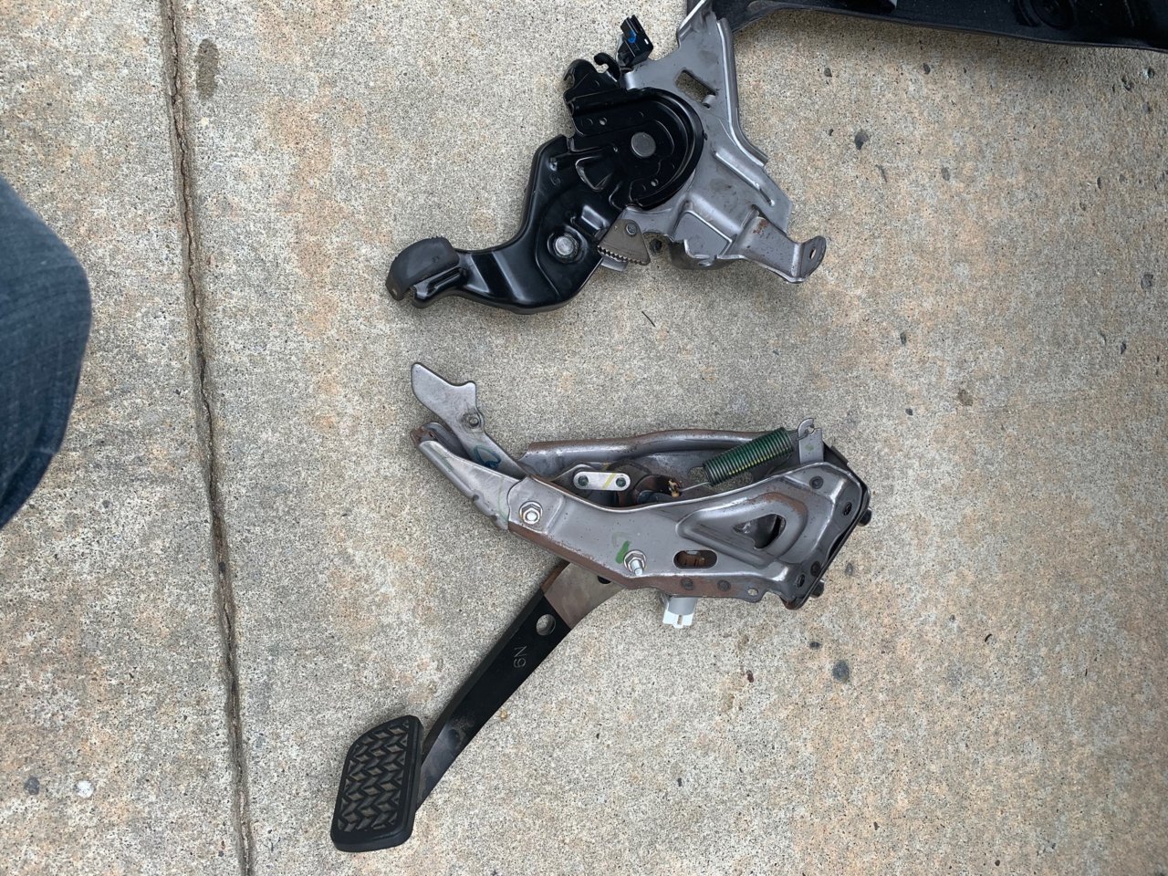

    Auto Pedal outta there:

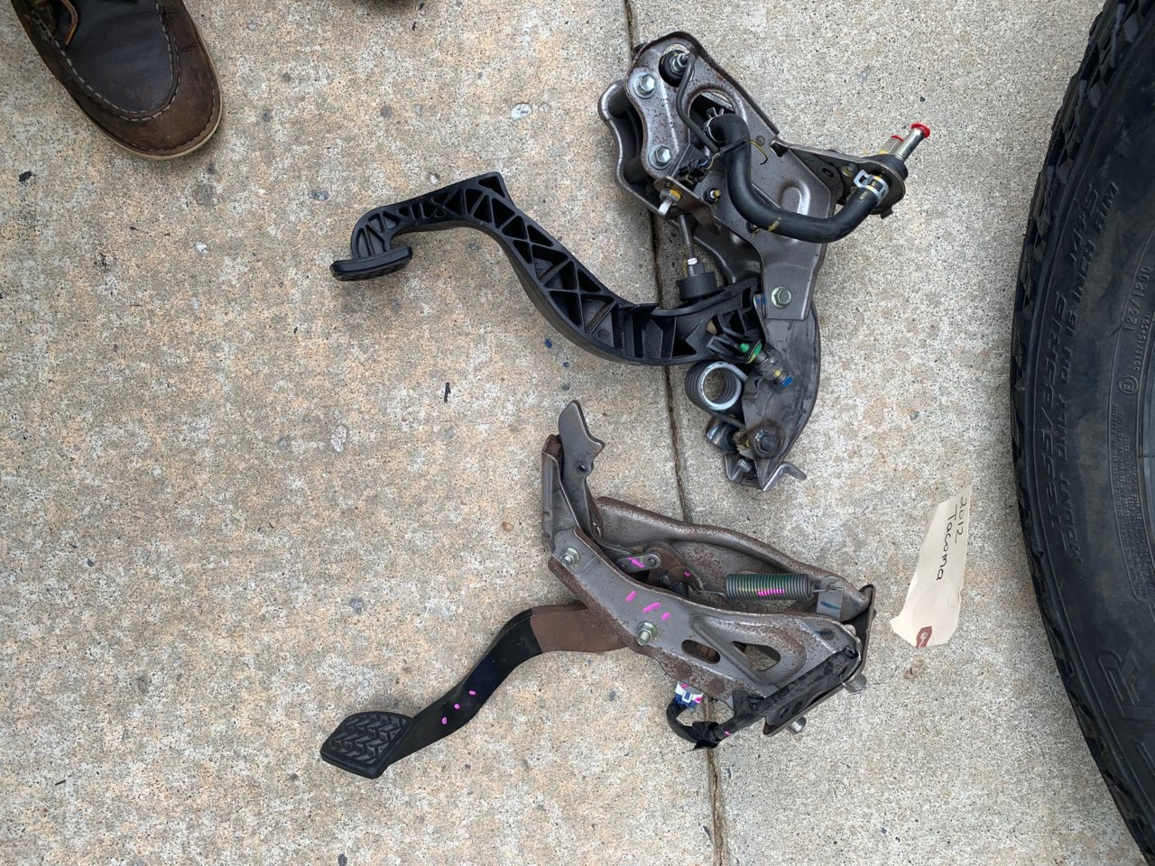

    New Pedals:
    Remove parking brake bracket:
    New Pedals Installed:

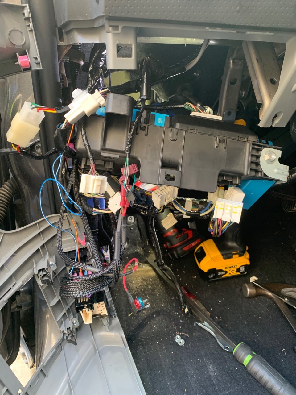

    I don't know what the hell I was doing there, but shit got a little out of control.

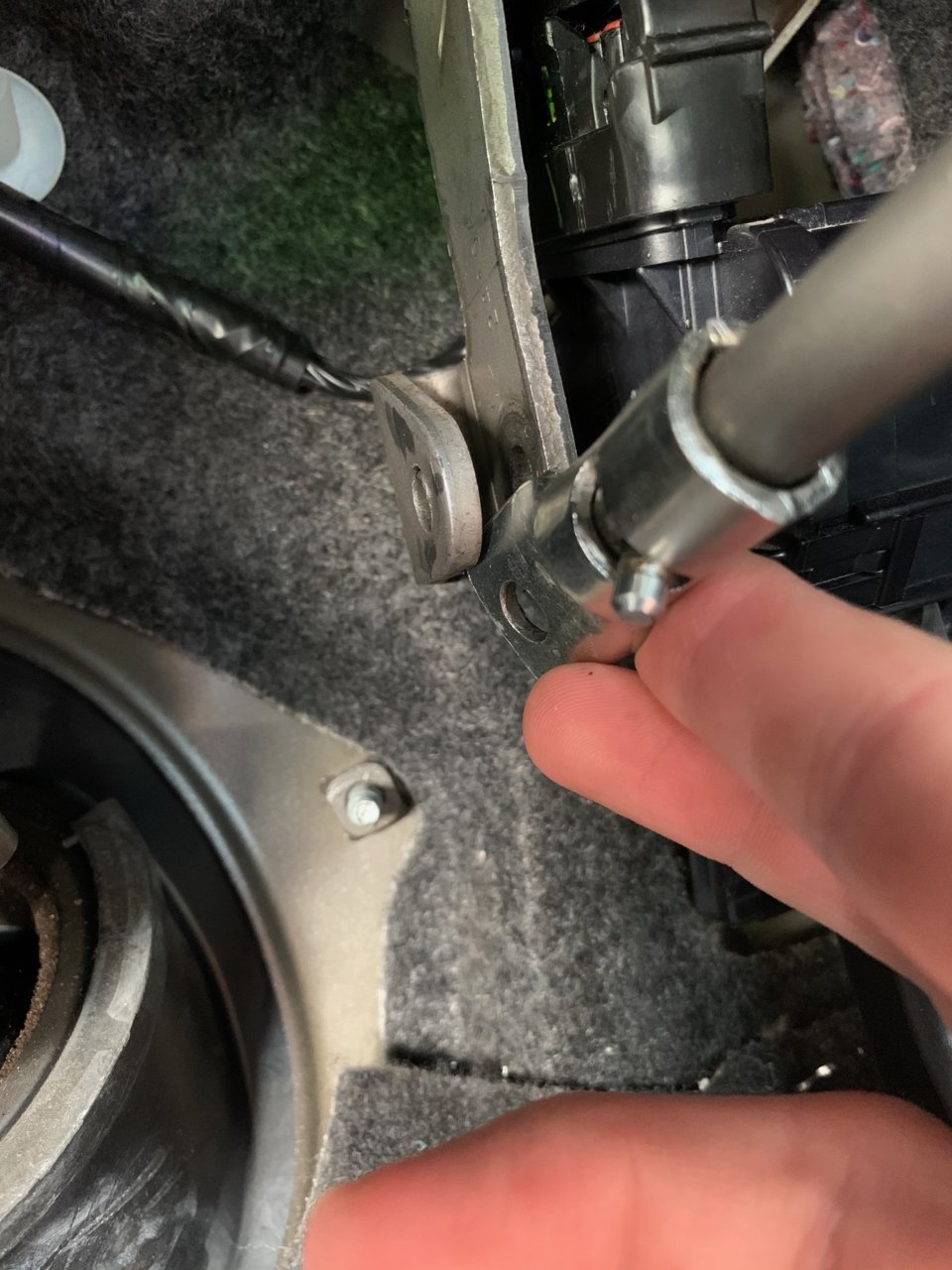

    Fucking hand parking brake not lining up:
    Fixed with a 3D printed spacer.

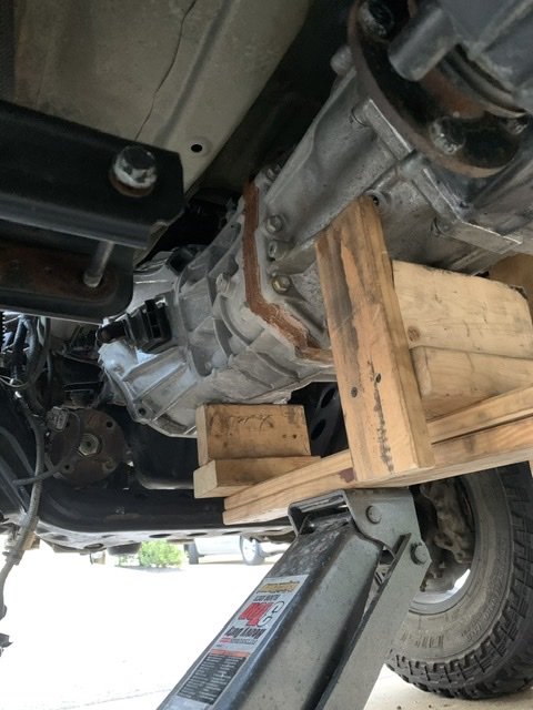

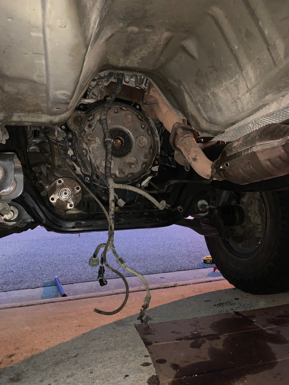

    Removed transmission:

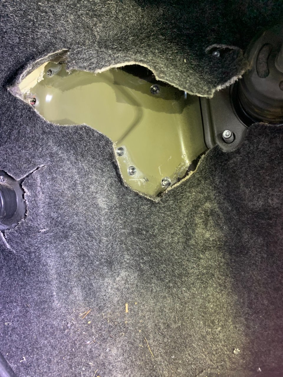

    Modified the cross member:

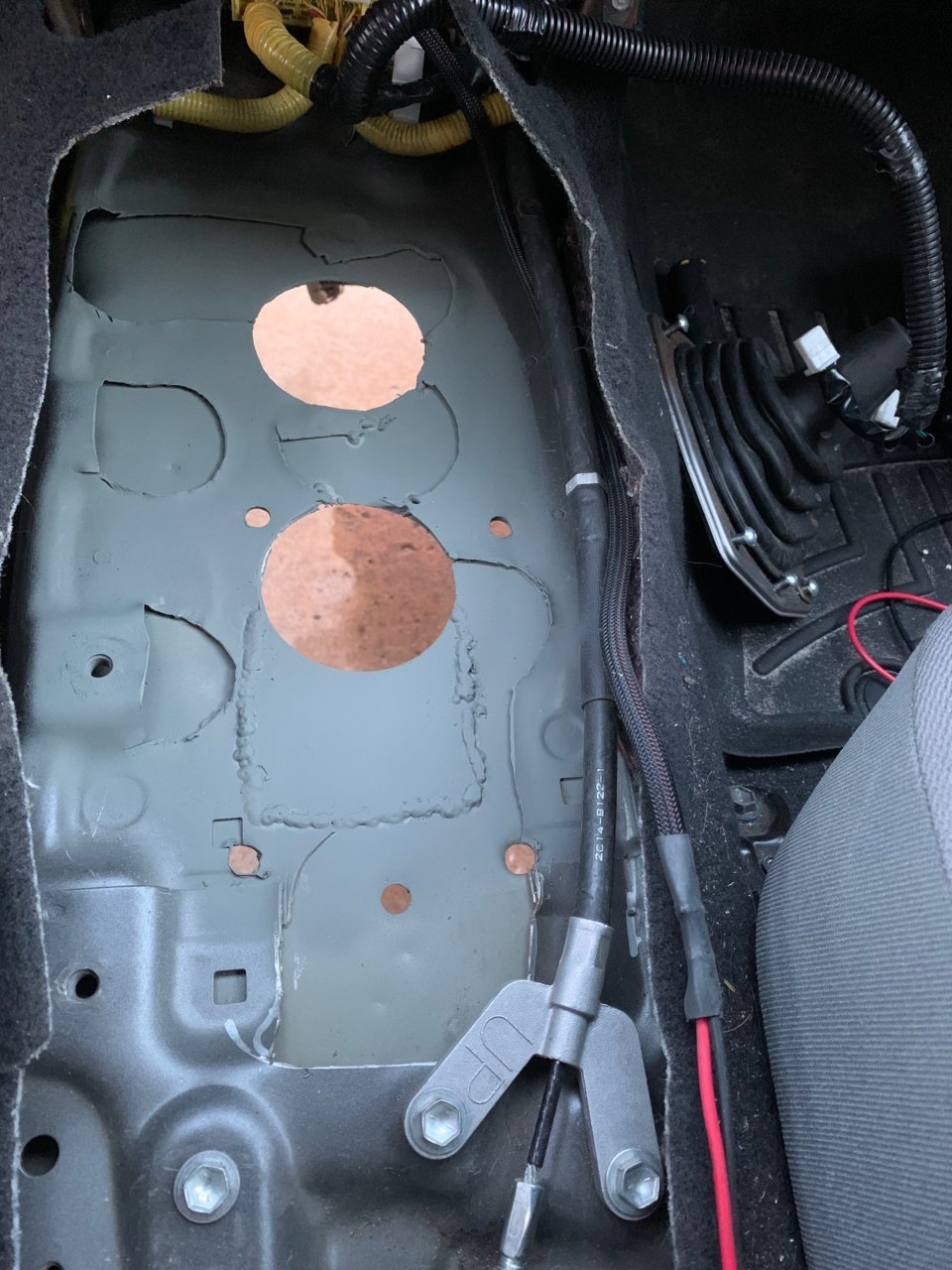

    Transmission tunnel almost ready:
    Working through a few more details. Hoping to button everything up this weekend.

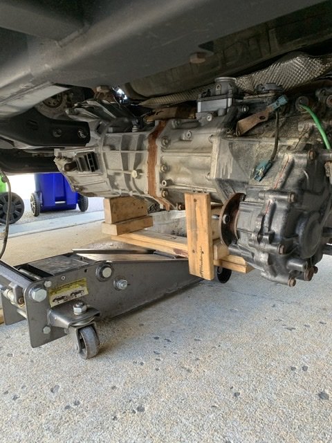

    Transmission and transfer case patiently waiting on the homemade transmission jack. Should have the it back in tonight. Just gotta install the new clutch.

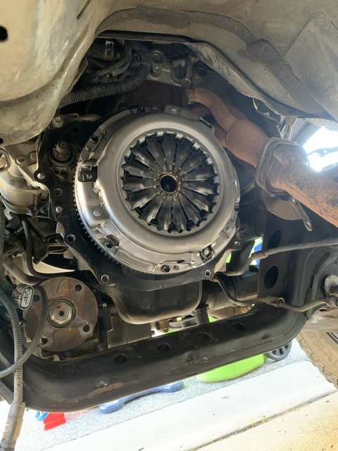

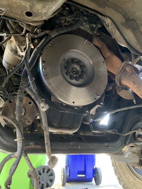

    Flywheel and clutch installed. Getting closer.

    Transmission in. Couple bolts holding it in place for the night.
