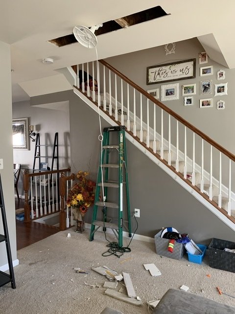

    I still have a list of truck projects, but my 4 yr old decided to make a car wash for his Hot Wheels that turned into a flood. He plugged the sink and left it running for at least an hour.

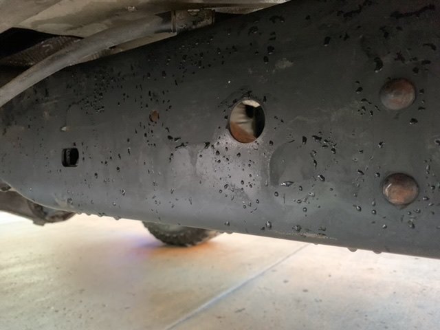

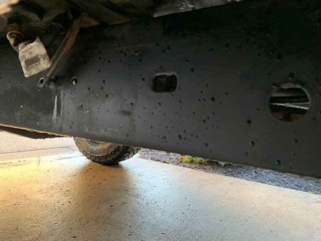

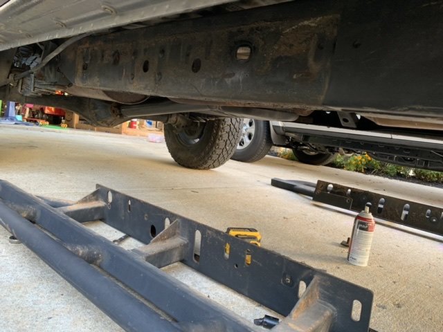

    Baltimore, MD
    '14 MGM DCSB Postrunner 4wd Conversion, Debadged

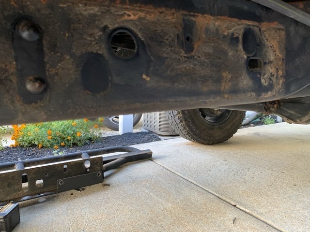

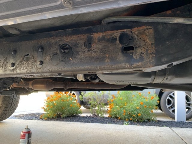

    Pulled my sliders off after 3yrs. Figured I better clean up the frame and get Fluid Film on before it gets too cold. Only a could of spots that need to be touched up with paint after all this time.
    Before cleaning:
    After cleaning:
    Need to grab a little paint and touch up a couple hot spots then lube up with FF.

    Is that dirt or rust in the before pics?
  13. Nov 13, 2020 at 2:37 PM
    #133
    jowybyo
    jowybyo [OP] Well-Known Member
    Nov 19, 2013
    #116863
    6,092
    Joe
    Baltimore, MD
    Dirt. I haven’t painted anything yet. Just hosed the dirt and FF off.
  14. Nov 13, 2020 at 2:44 PM
    #134
    EatSleepTacos
    Mar 24, 2015
    #151688
    59,842
    Randy
    West Valley, AZ
    2017 4Runner
    That’s pretty impressive then. I would have expected worse, especially with how salt crazy Baltimore area is.
  15. Nov 13, 2020 at 2:50 PM
    #135
    jowybyo
    Nov 19, 2013
    #116863
    6,092
    Joe
    Baltimore, MD
    I spray FF in between the frame and the mount flange as best I can before every winter.
    EatSleepTacos[QUOTED] likes this.

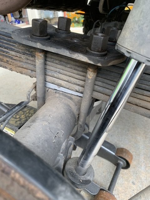

    Also got this stupid things installed.
    No, the u-bolts weren’t tightened yet in this photo. Still have a 3° pinion to DS angle and a decent vibration at about 45-55 mph. Need to dial in the carrier bearing spacing.

    Thread on that nut is awfully suspect lol

    What nut? Are you messing with me?

    On those nuts for the ubolts. The nut isn’t threaded all the way on the ubolt.

    Oh yea that’s why I said this....
    There’s almost 3/4” of threads sticking through the nuts now that they are torqued.
