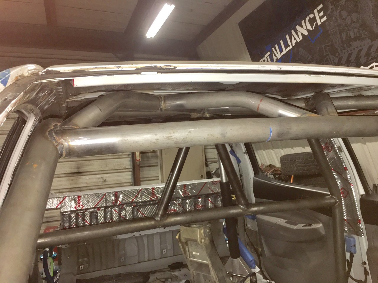

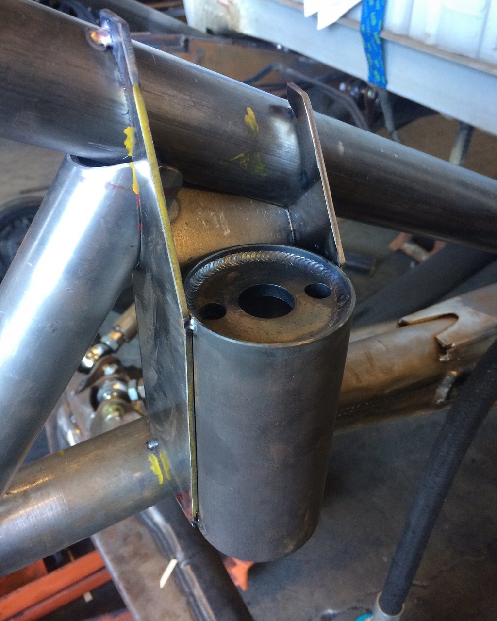

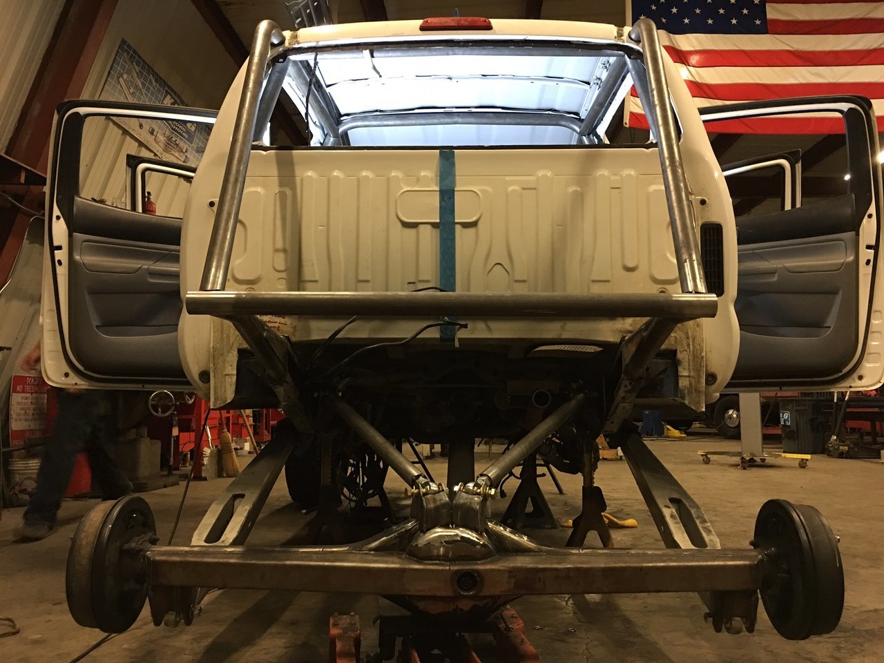

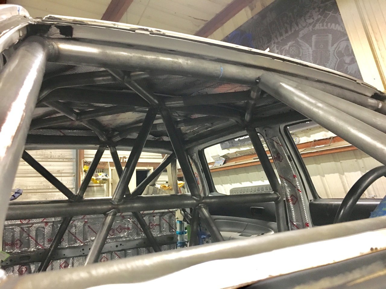

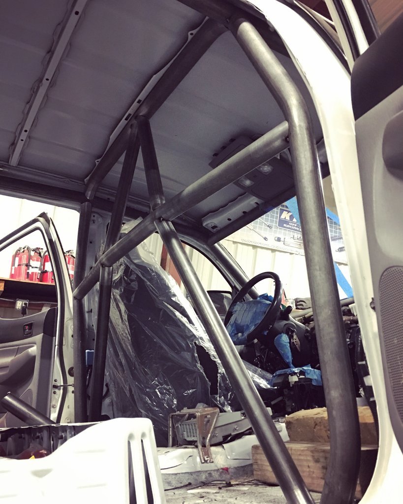

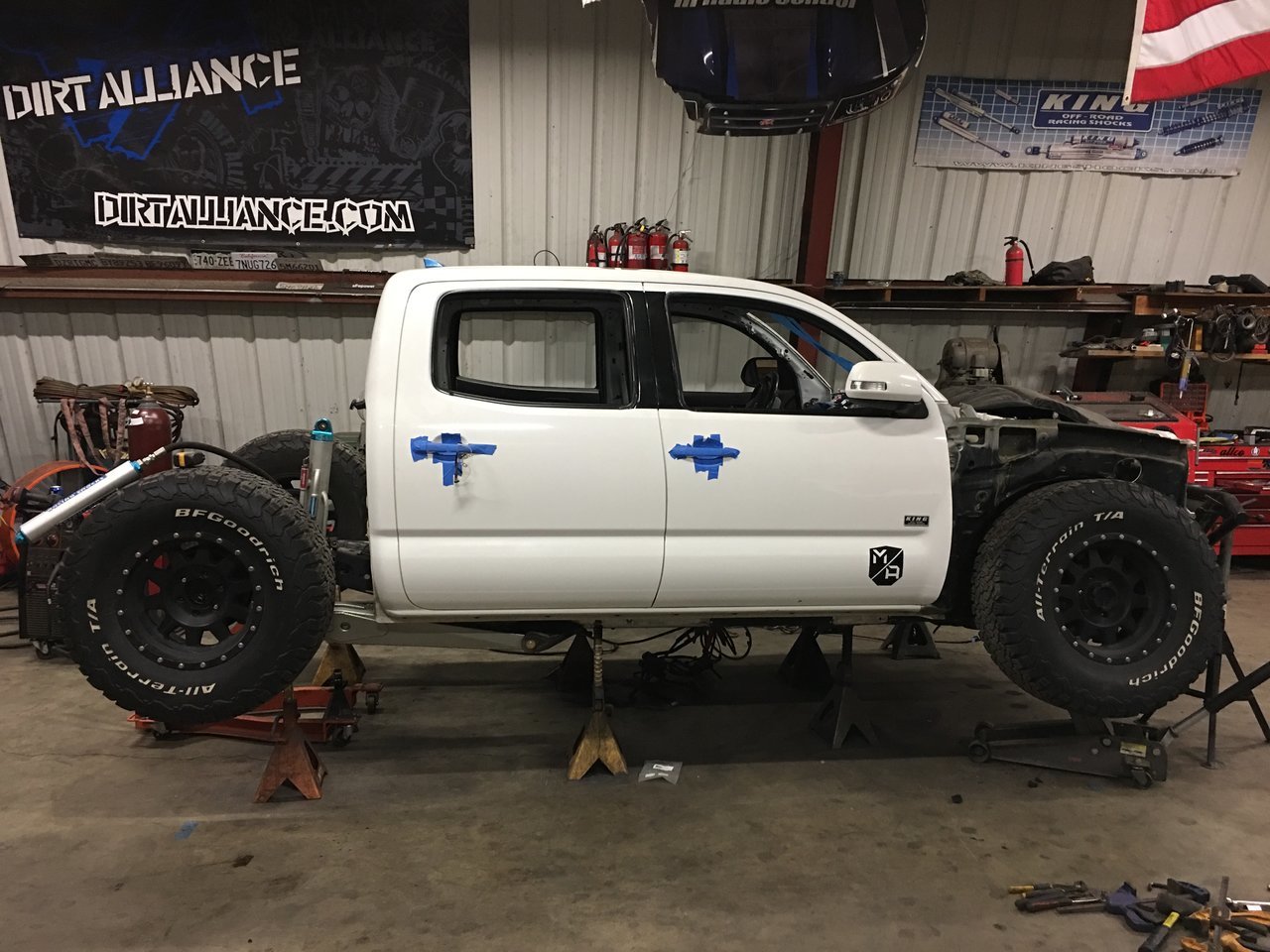

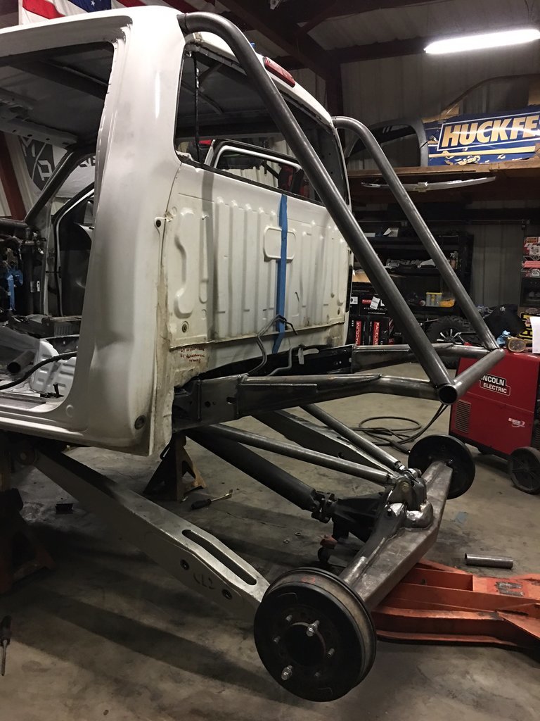

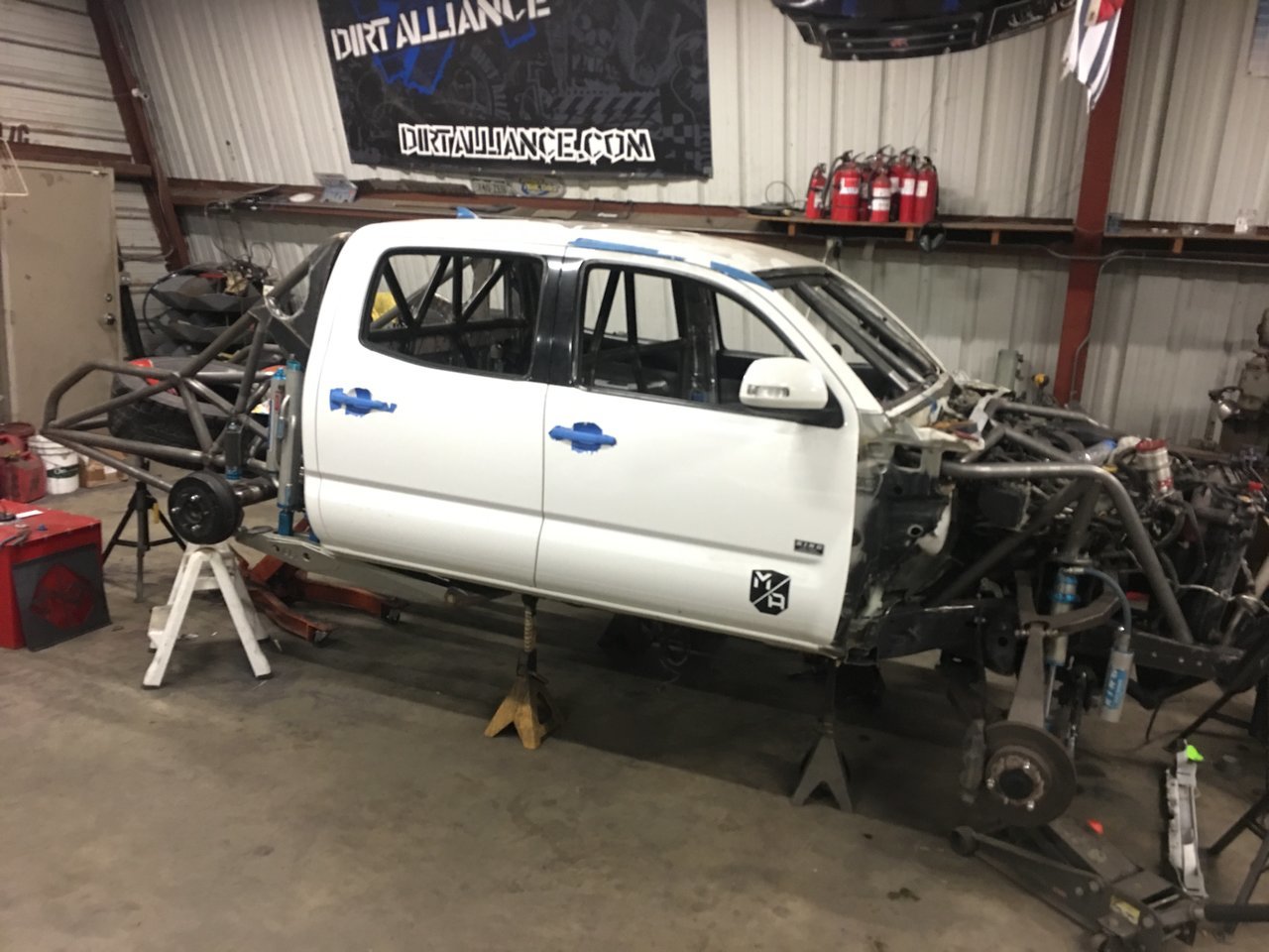

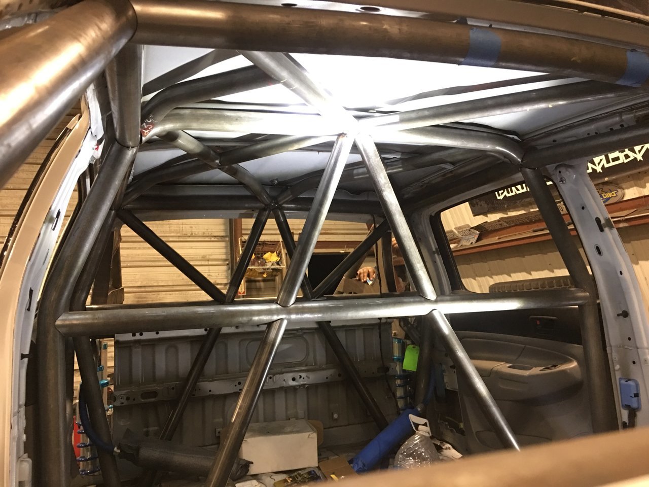

    B-Pillars and lacing done, onto the C-Plane and then roof tubes.
    Upper link mount welds from the man, myth, and legend... ALL-Co

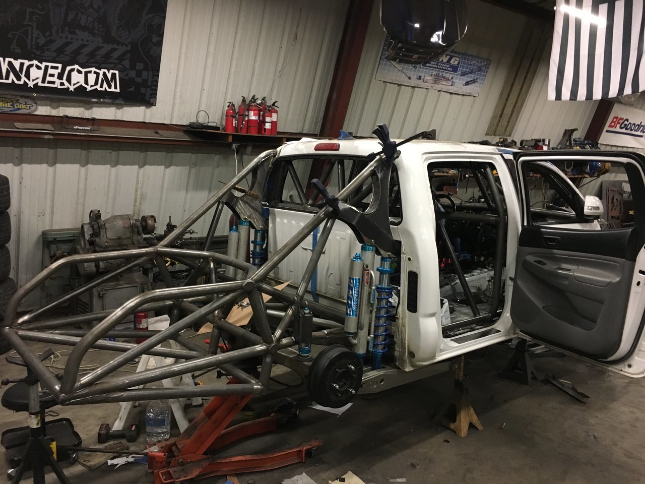

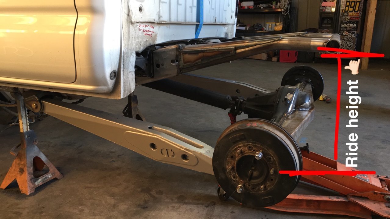

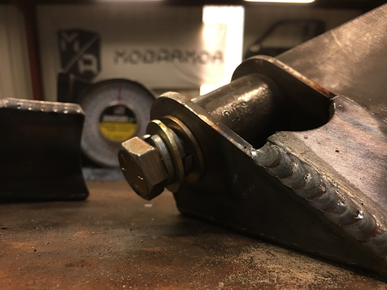

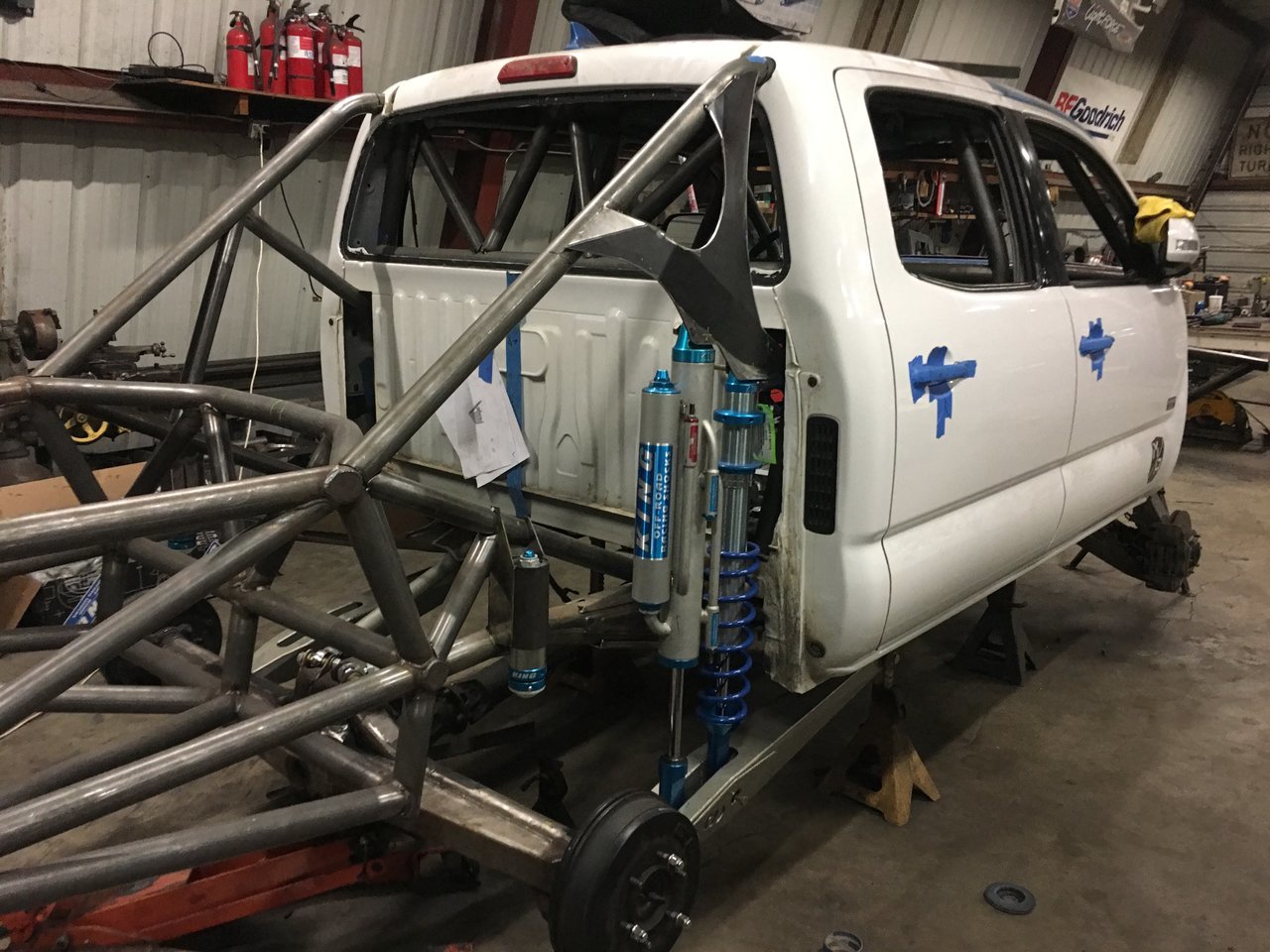

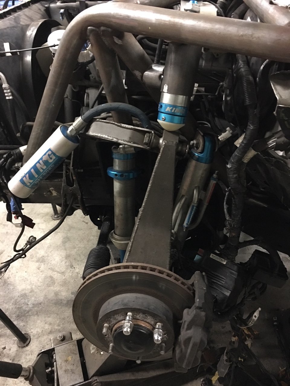

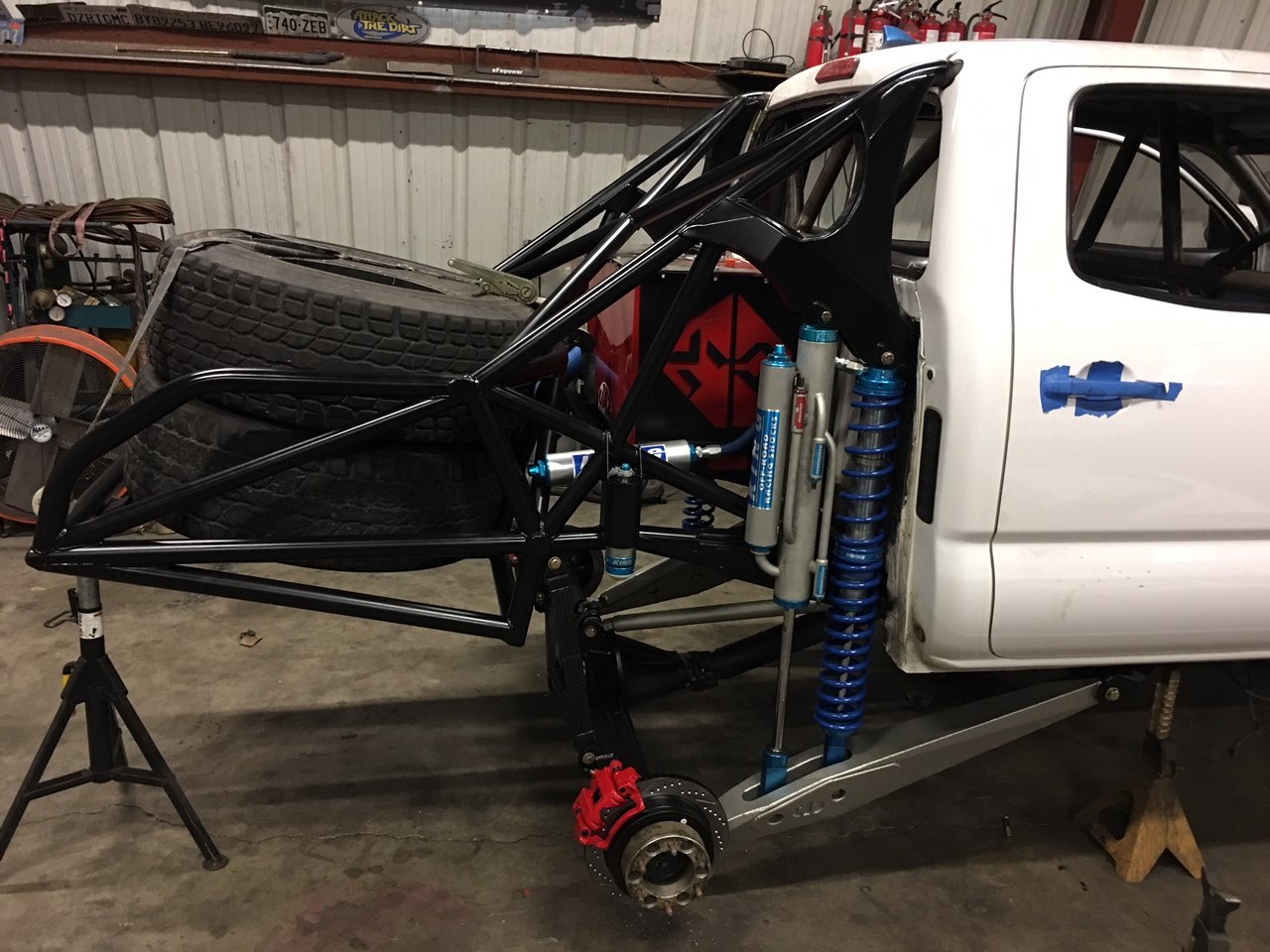

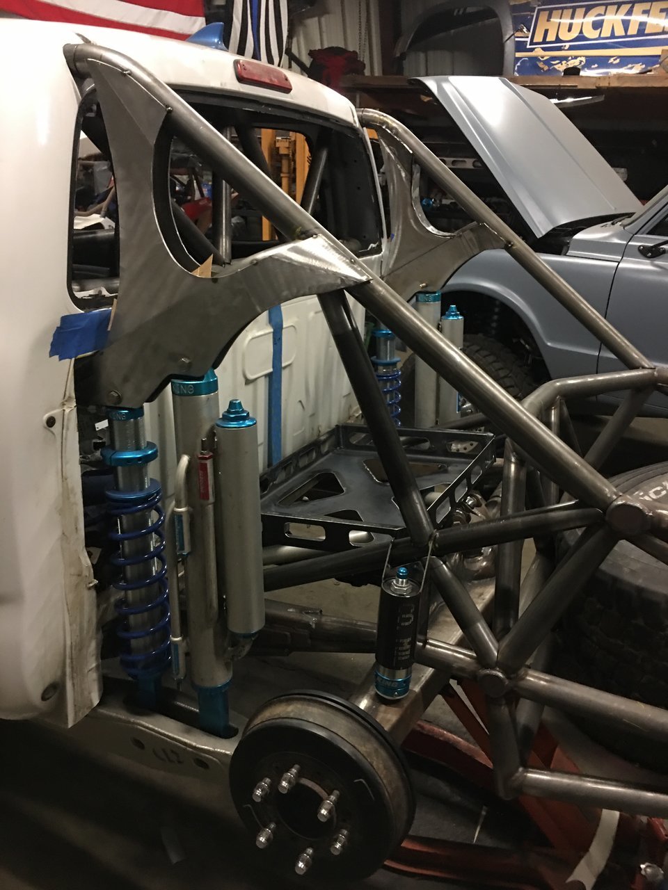

    3.0x16" bypass, 2.5x14" coilover, 2.5x2.5 bump should make this thing pretty smooth

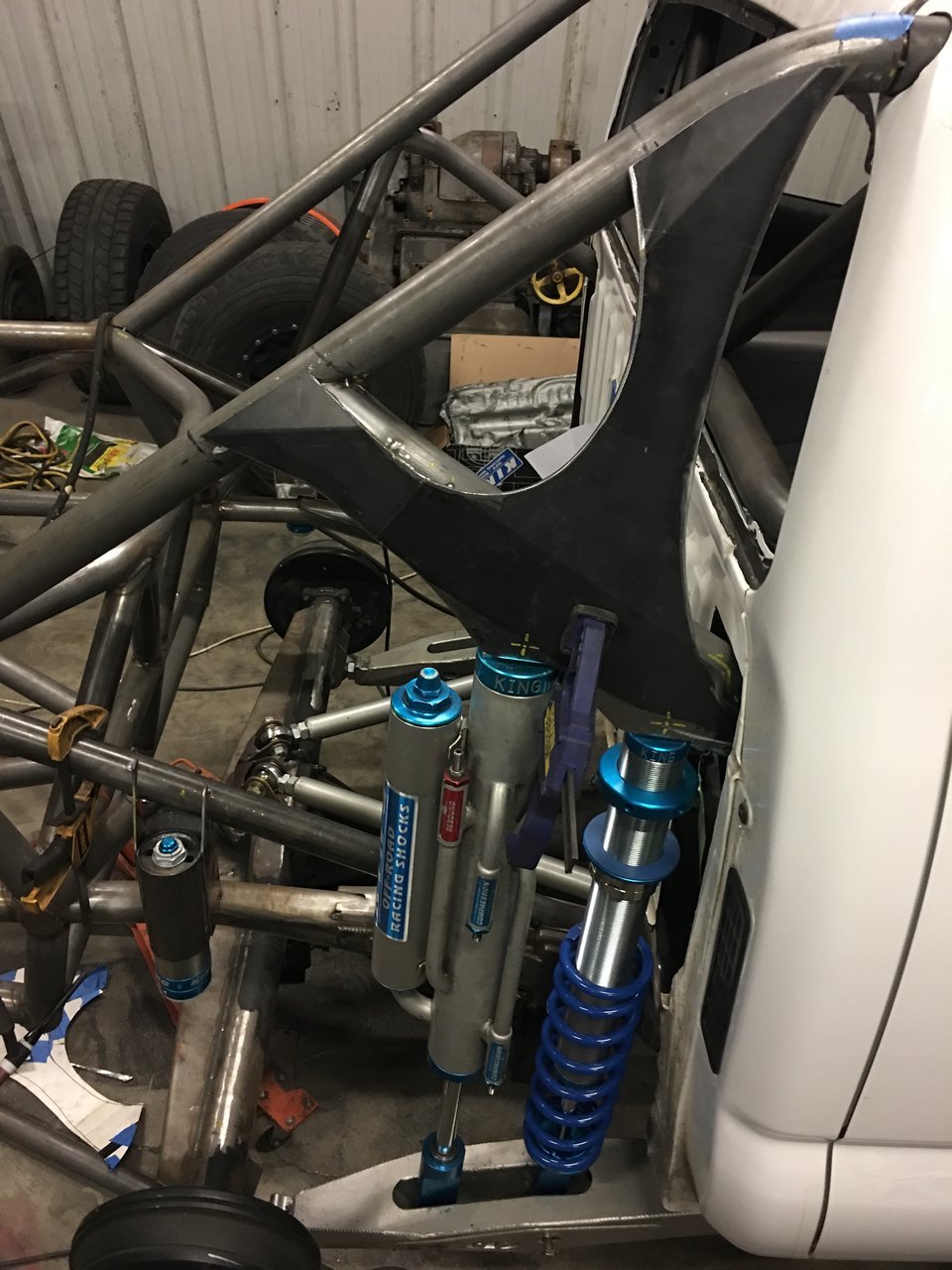

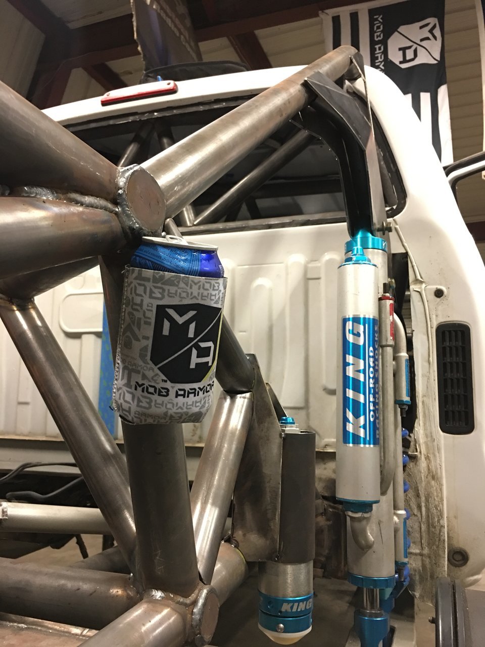

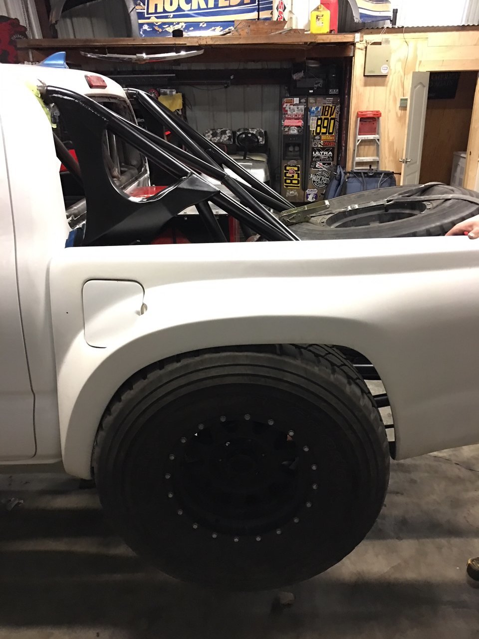

    Last bid of progress before turkey day.
    Shocks are mounted just need to fill in the towers.
    32 gal fuel cell basket mocked up

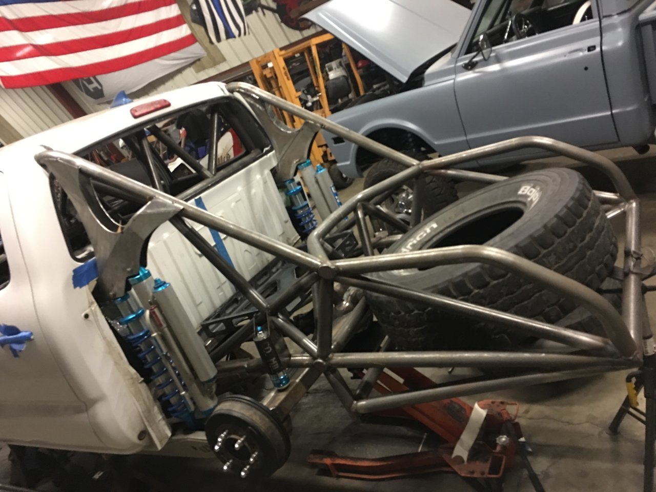

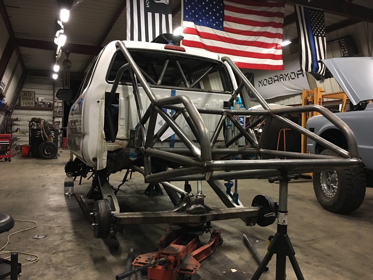

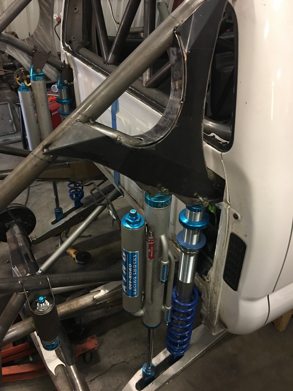

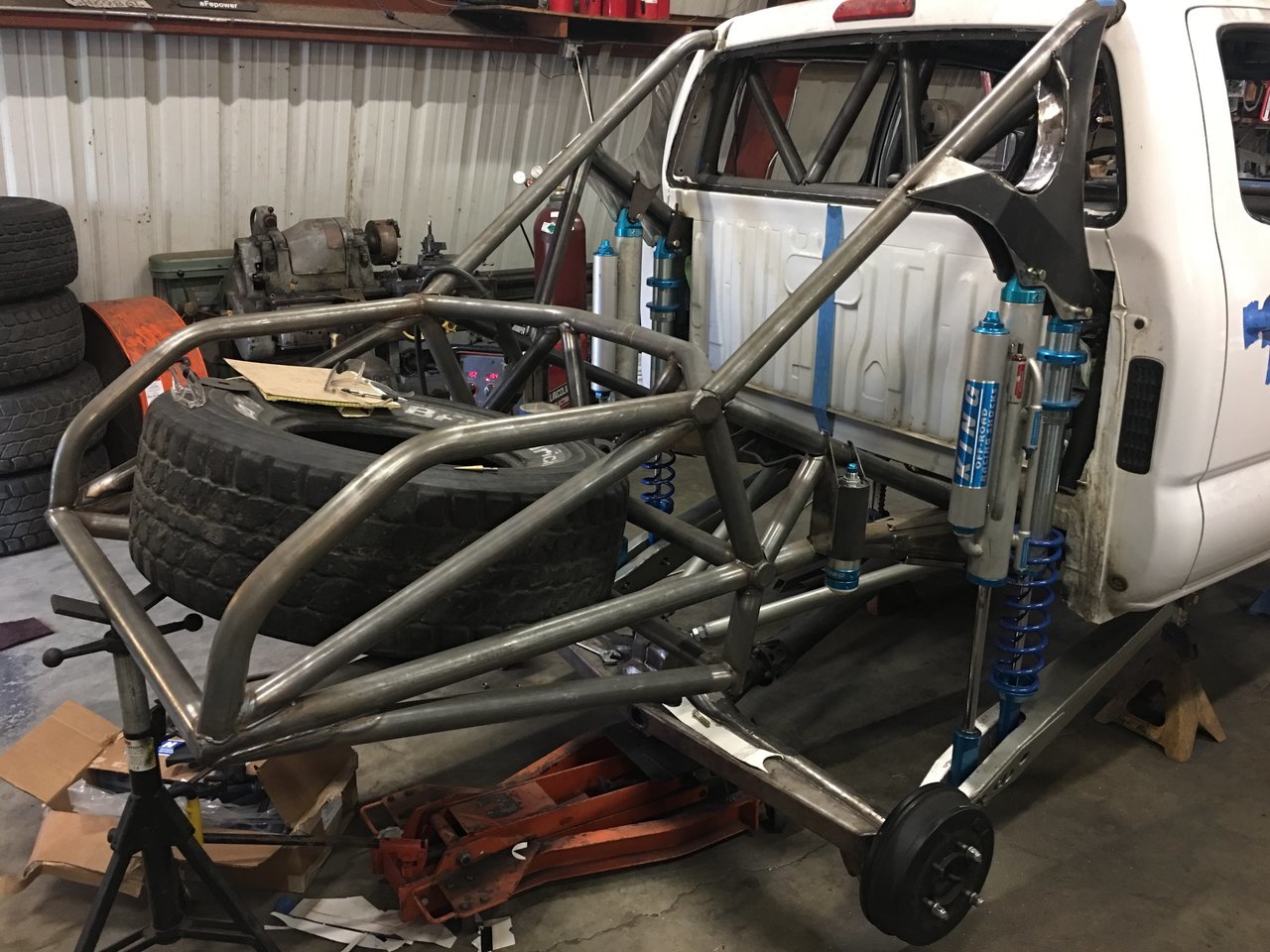

    Finally getting these beef cake shock towers boxed in and ready for welding. These we're a ton of work lol
    Starting to get laced up! Dropping the cage for final welding next week

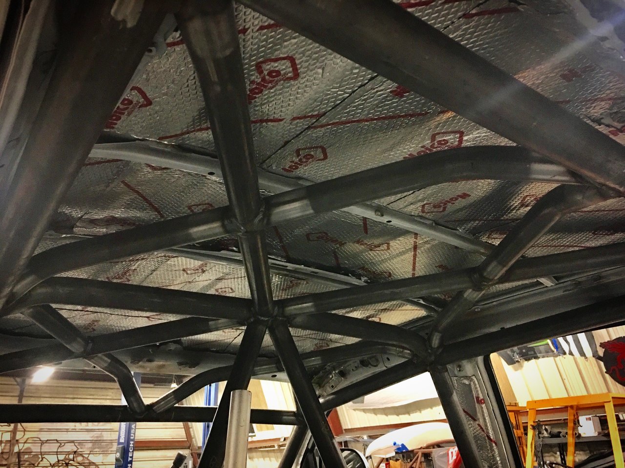

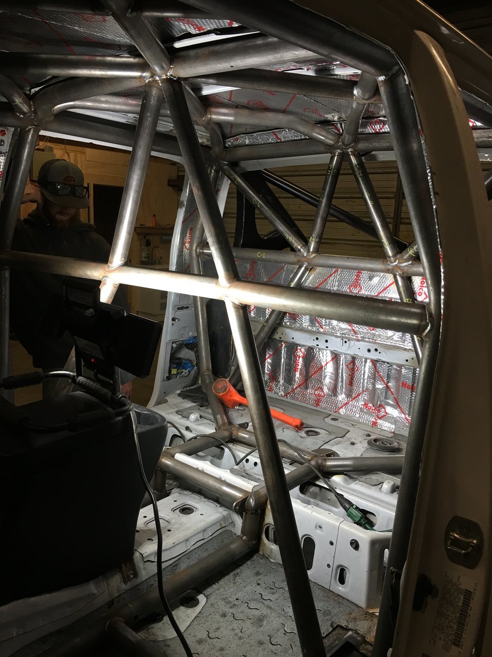

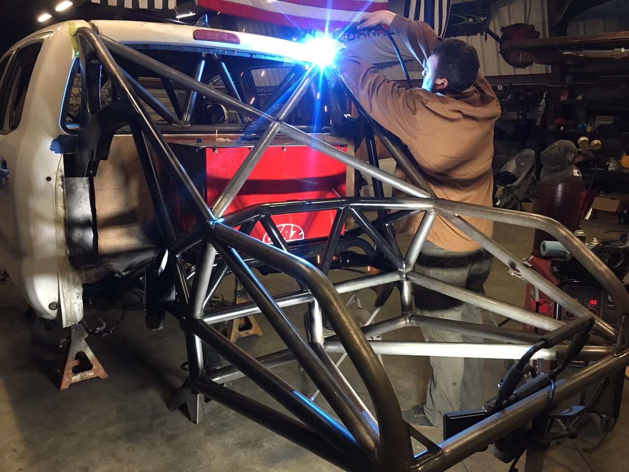

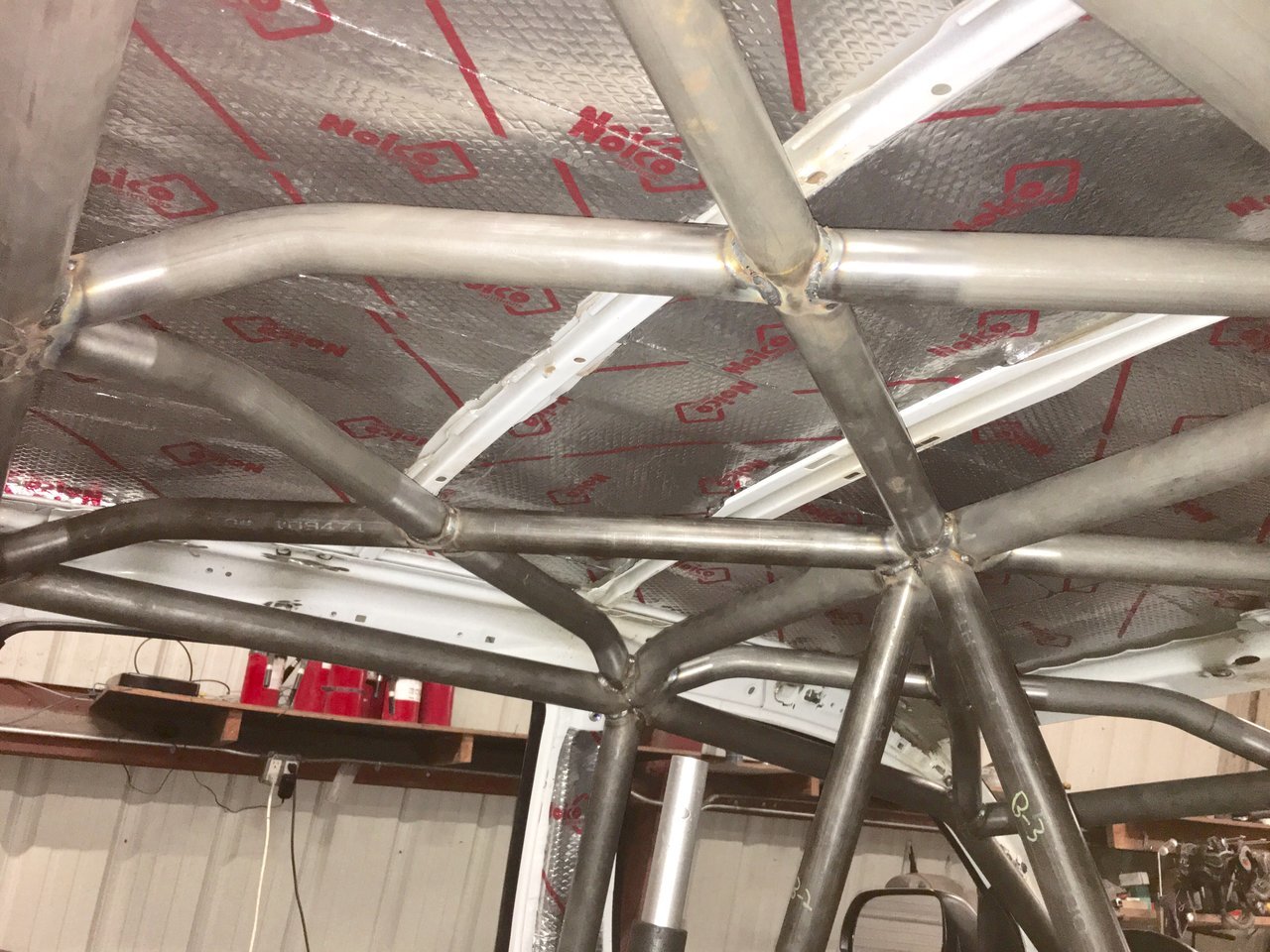

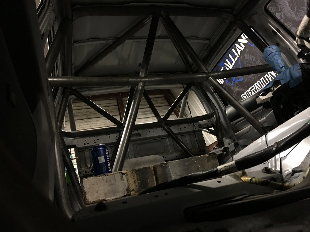

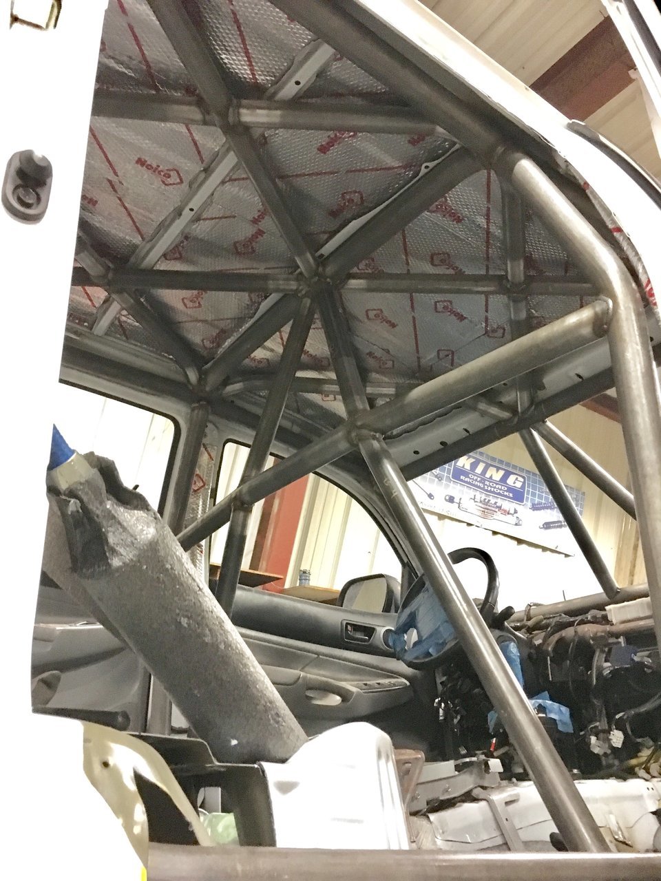

    Dropping the cage sucked but was very necessary to 360° weld. Threw some sound deadening in while we had room

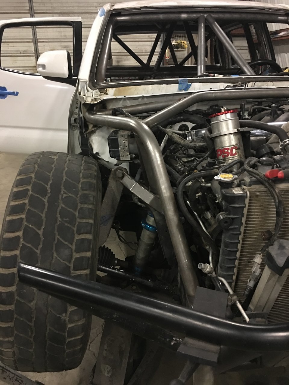

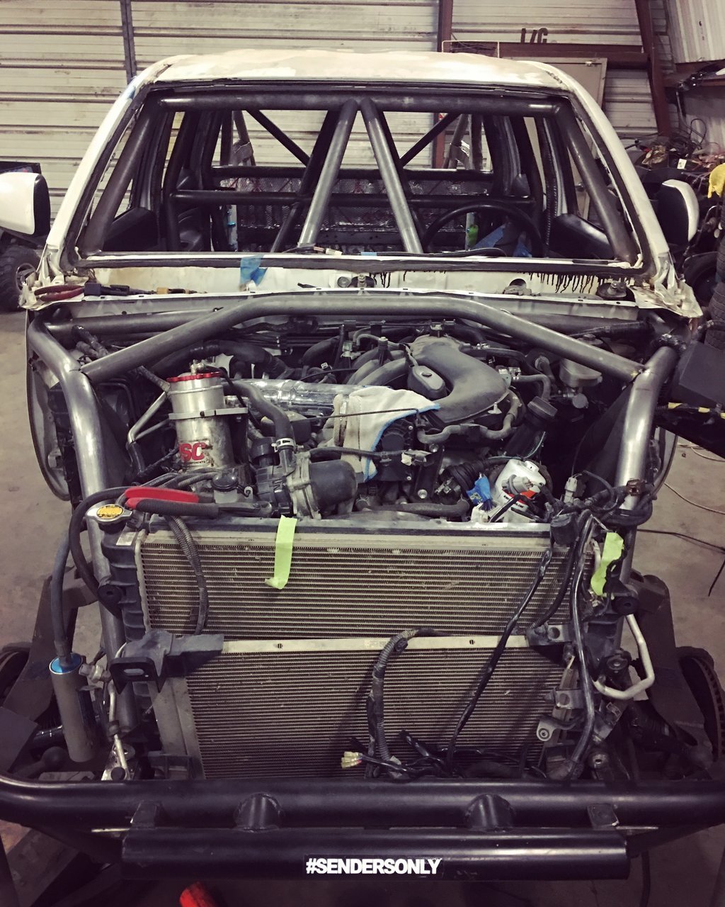

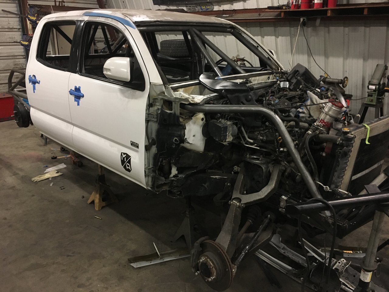

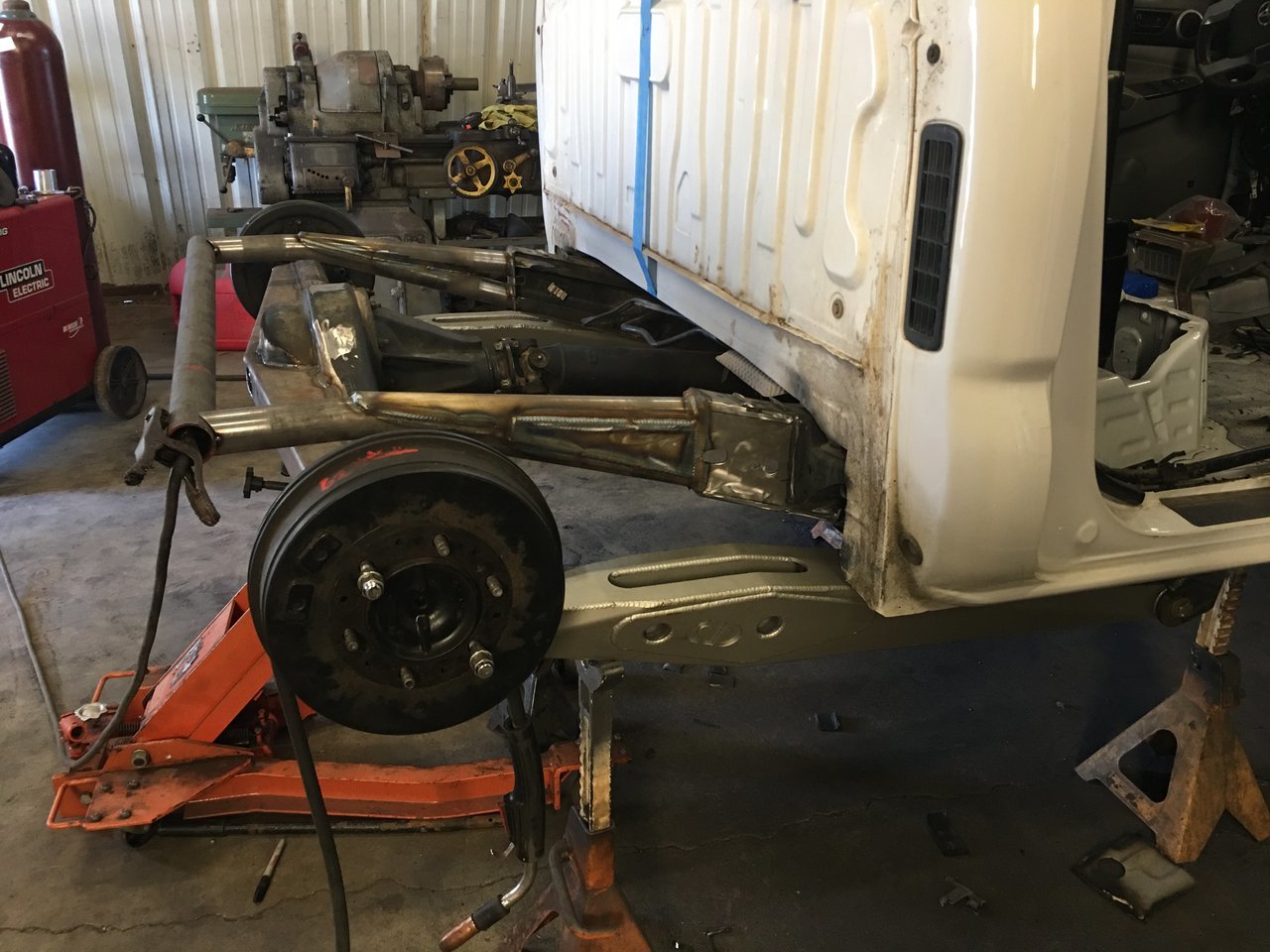

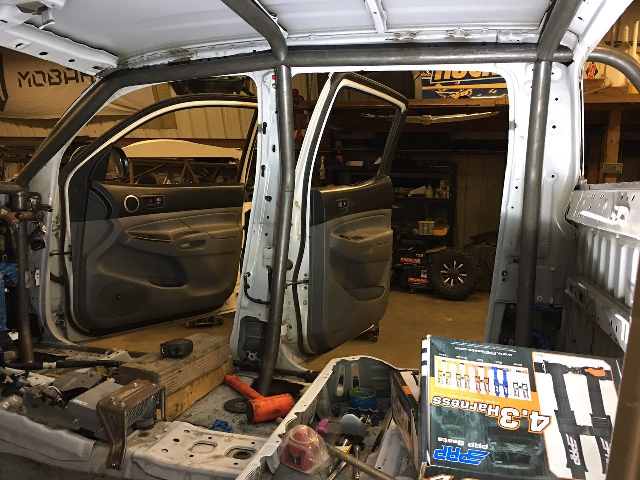

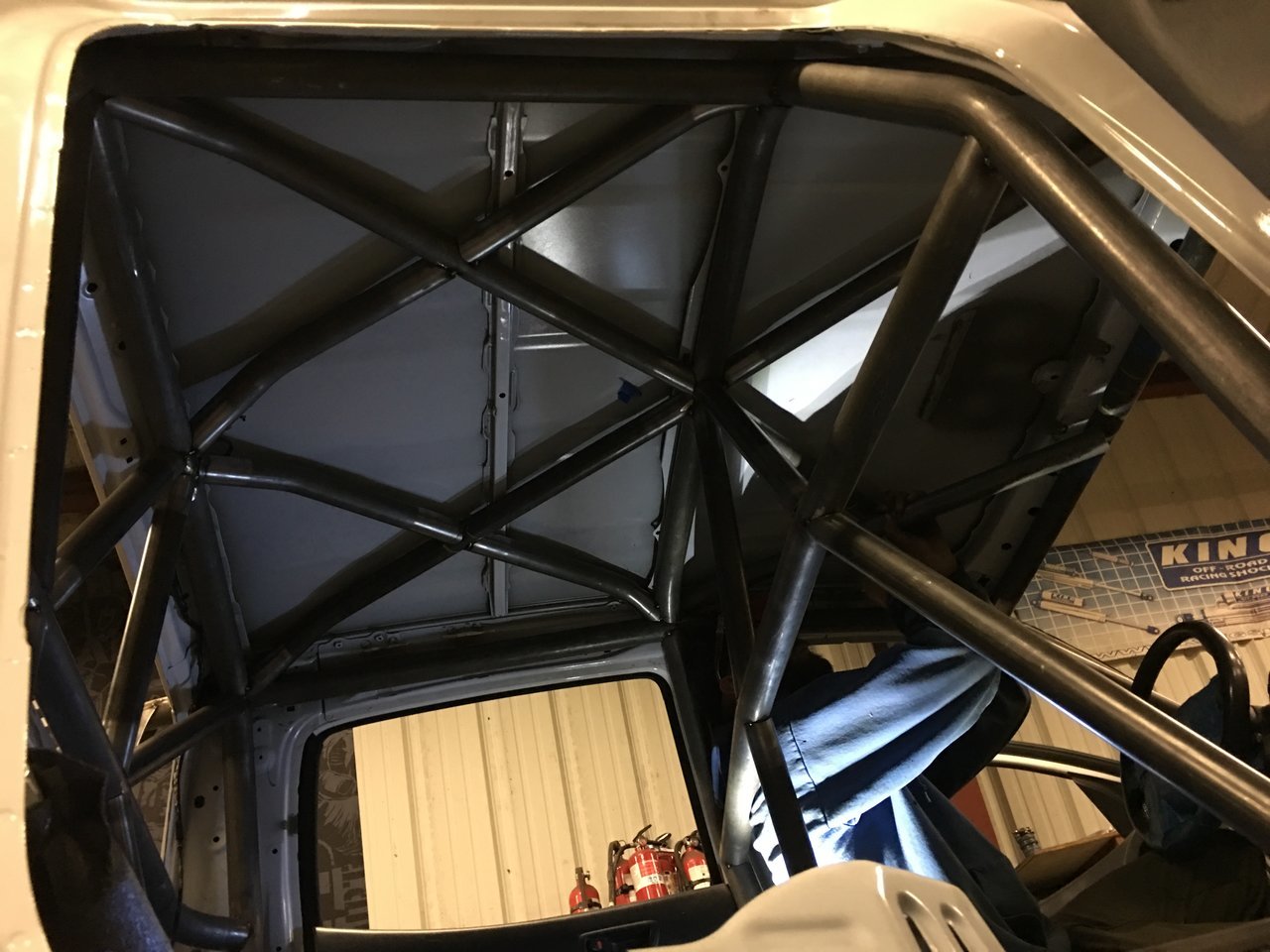

    Shock towers going back on the final welding and the back half structure is complete
    Engine cage and front half reinforcements under way

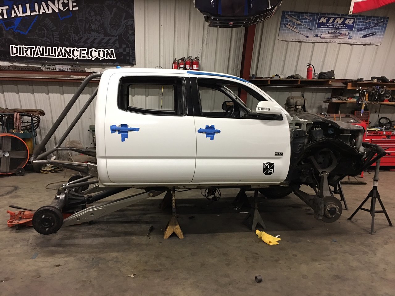

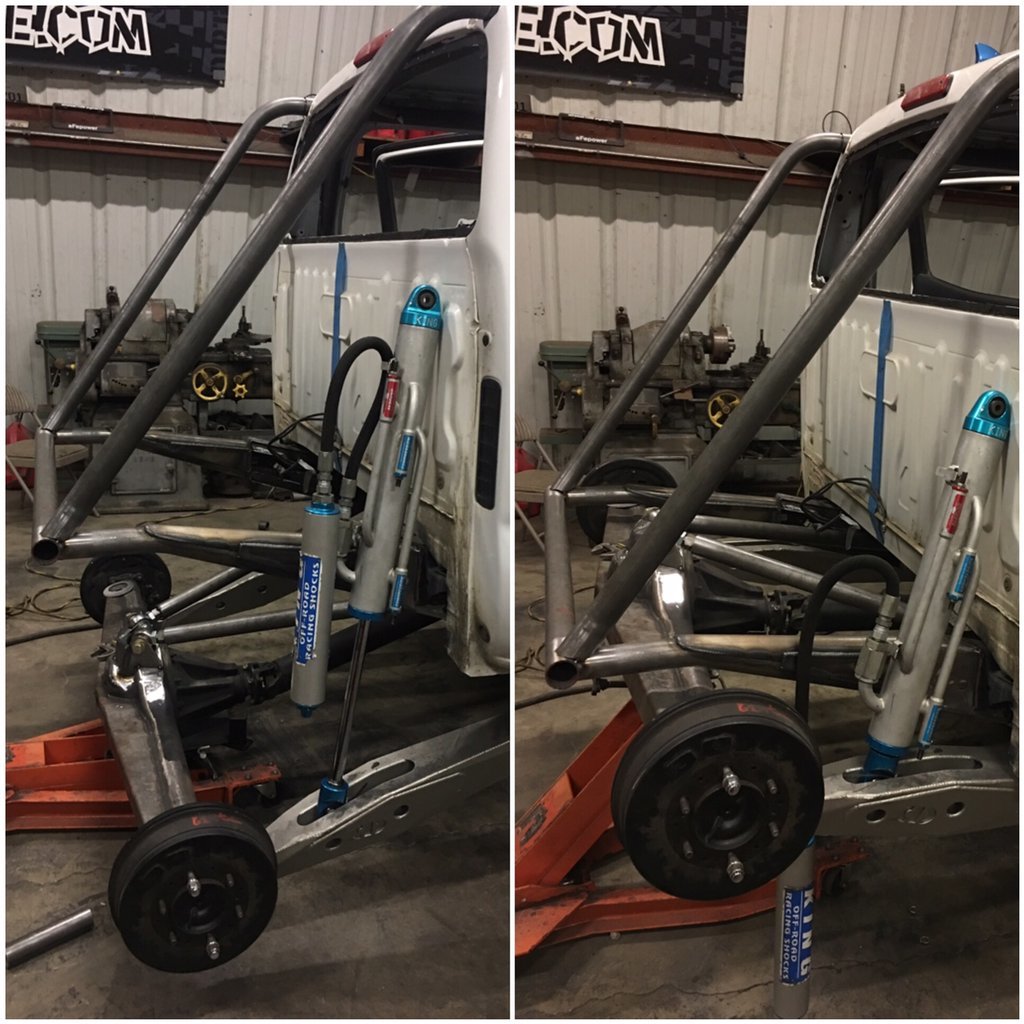

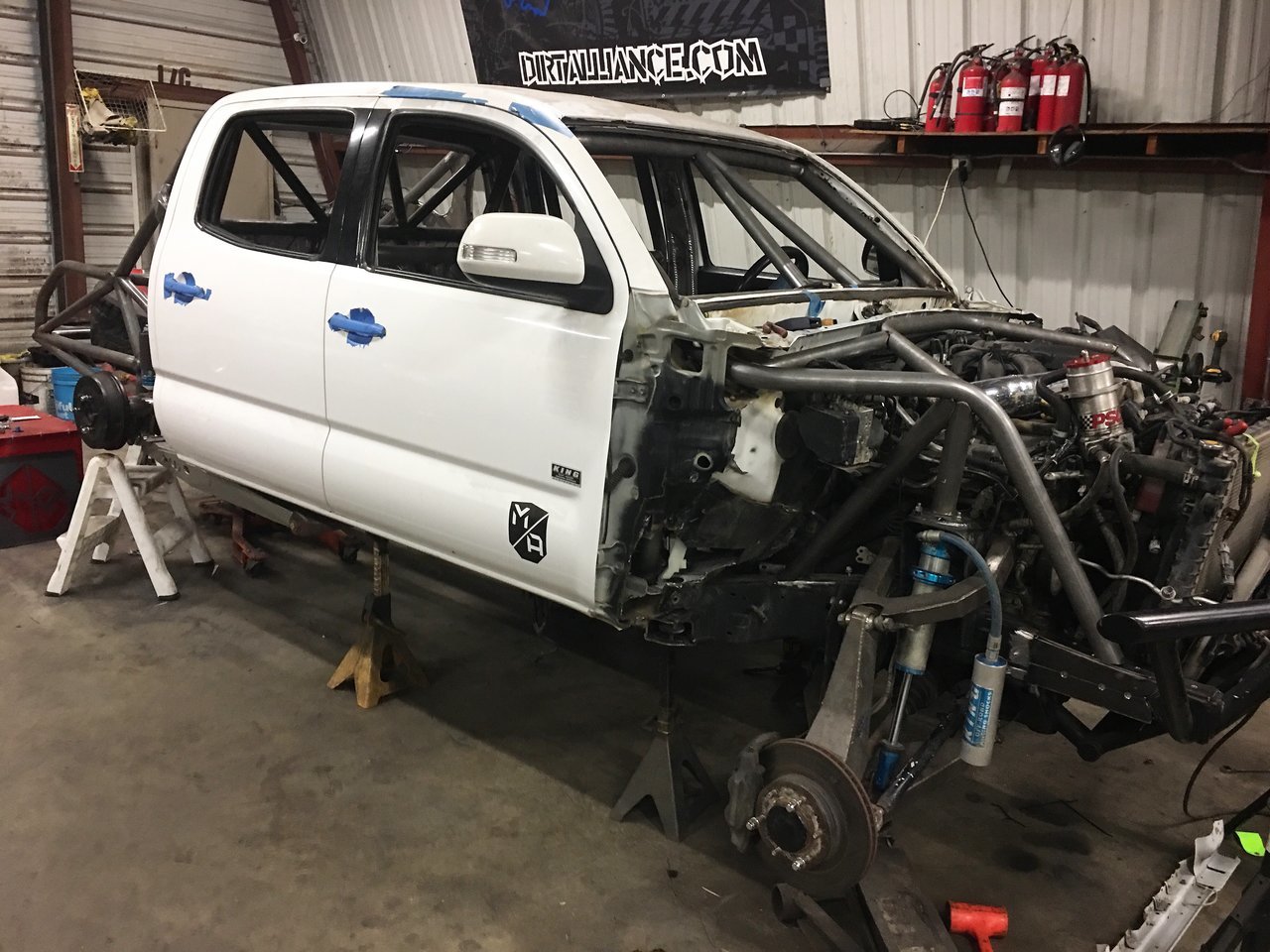

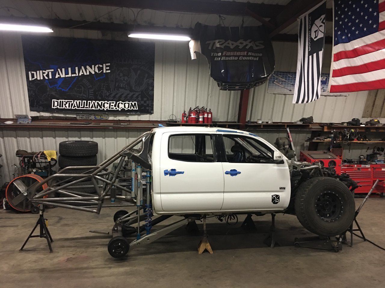

    Cage structure is done, seat mount and floor tubes are done. Onto finish welding, mounting front bumps and reinstalling front shocks.
    Stock pivots with bolt on kit from Dirt Designs will cycle ~15in of 4WD shredding

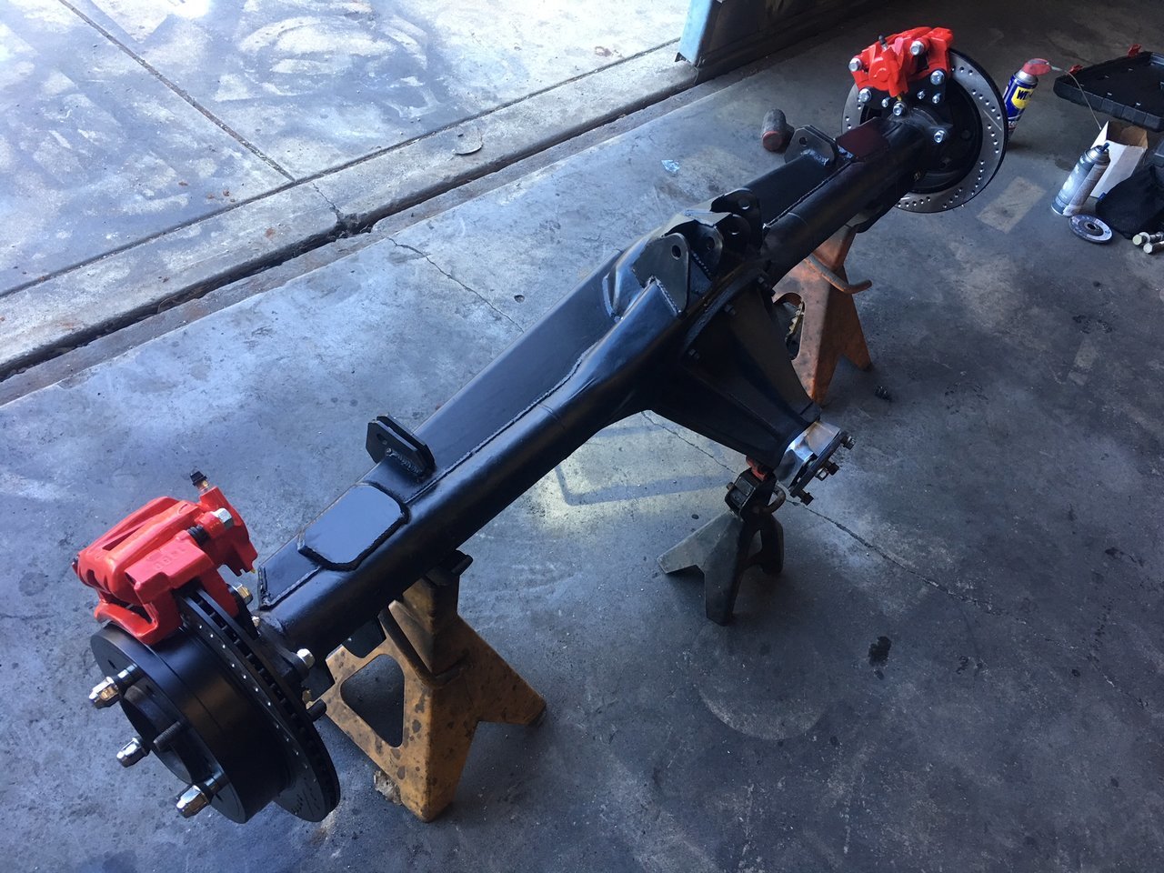

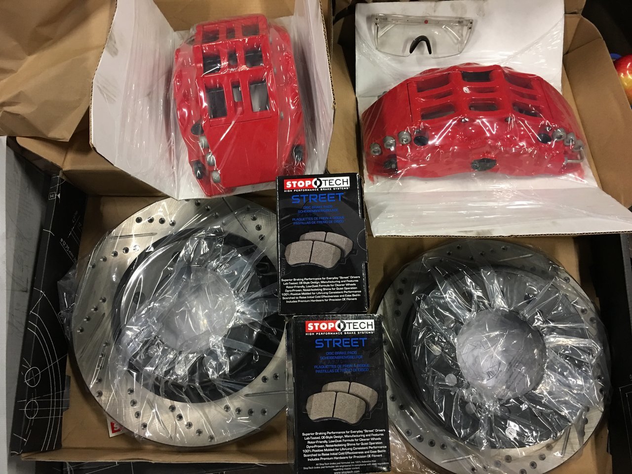

    A big brake kit from SOS Performance with six piston front calipers, drill and slotted over sized front rotors, and a rear disc brake conversion to ditch the factory drum brakes! So stoked! Check this link to find out more

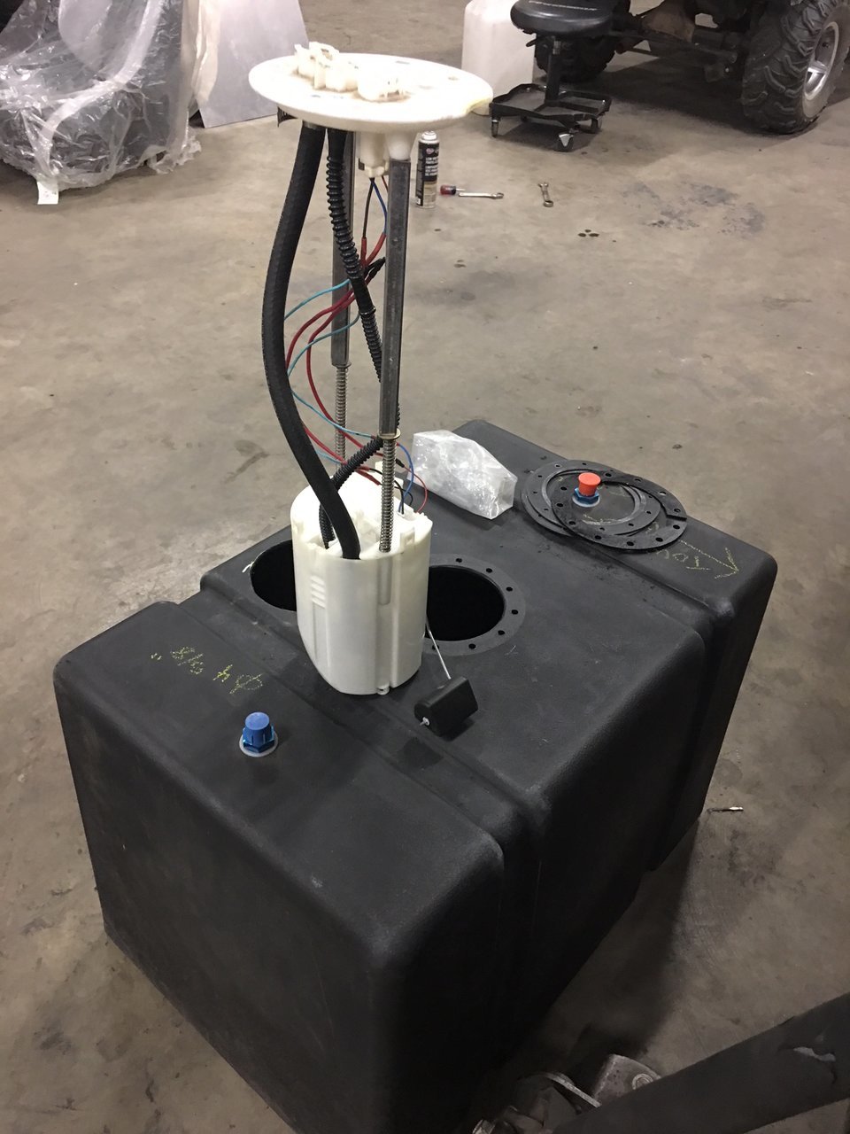

    Got the fuel pump extended and plumed into the cell. All factory parts
