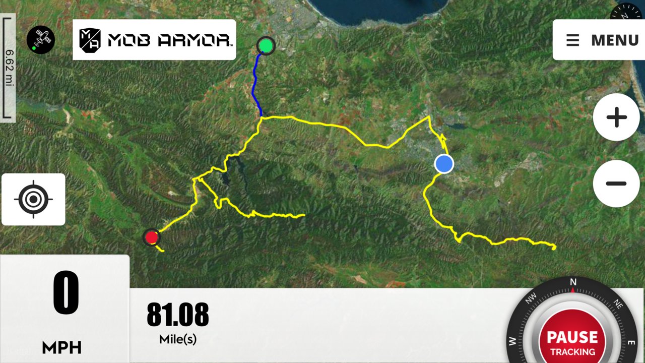

    Went dirt road hunting today, got about 100 miles (20+ not on GPS) of freeway/dirt/street on the truck today which is rad just to make sure everything is solid.

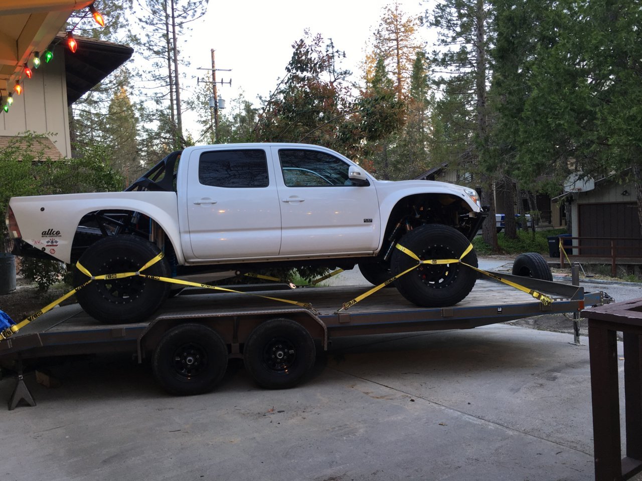

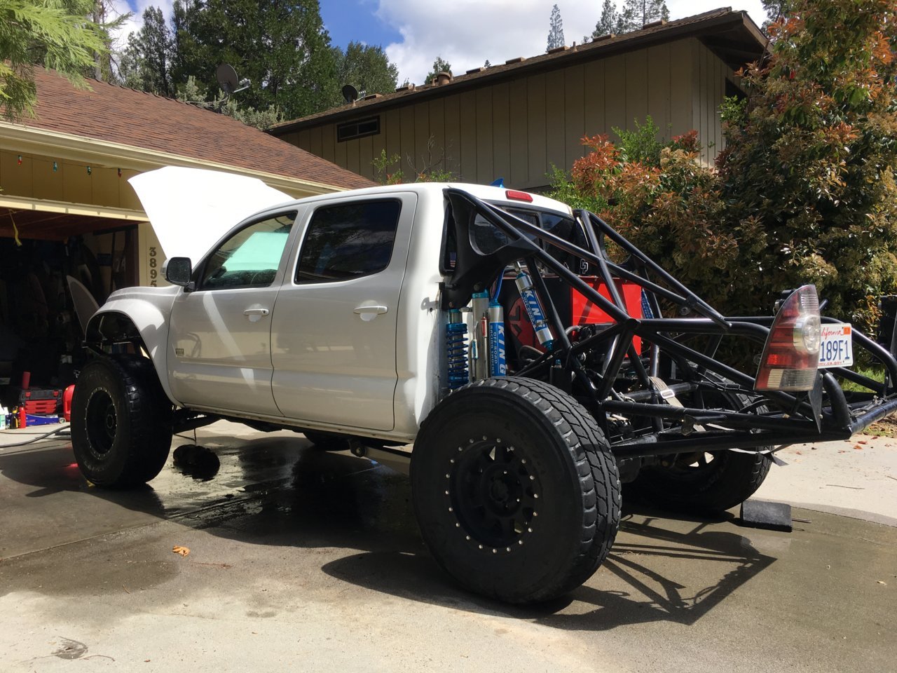

    4 hours of mud fun = 2 days cleanup and still not satisfied with mud removal.
    82C33B89-7473-498F-AD85-6766B4AE2DF1.jpg 91A49EF3-7A85-4E68-9DFF-6629282A27B0.jpg

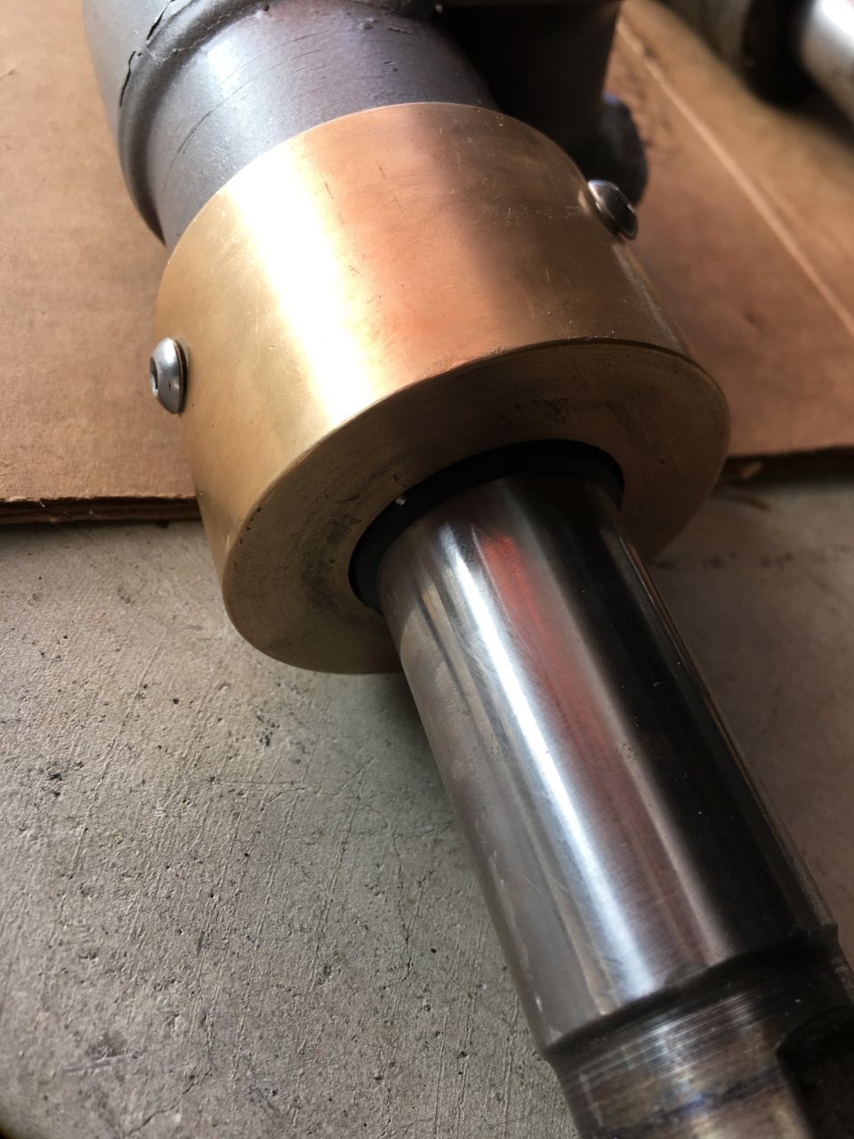

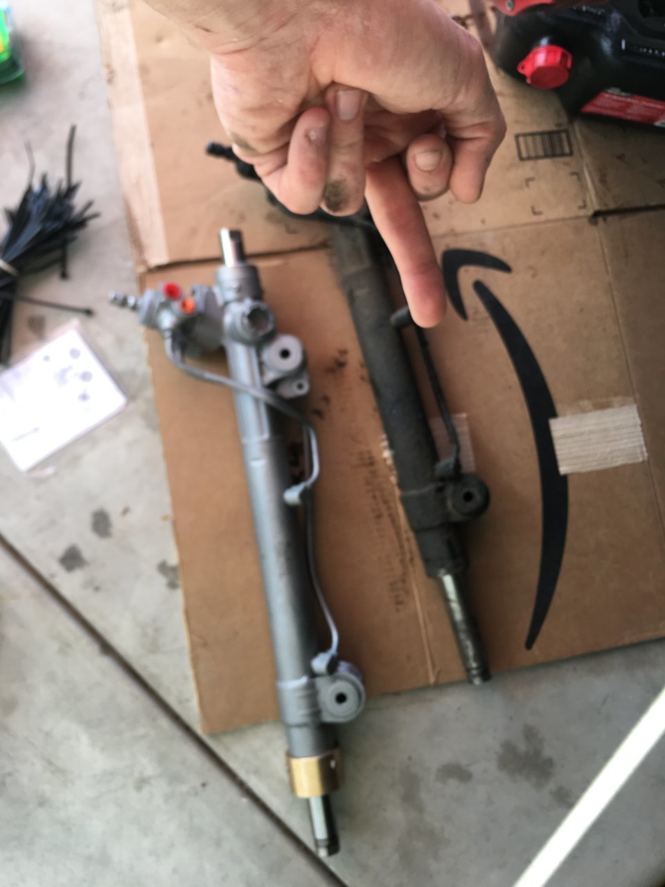

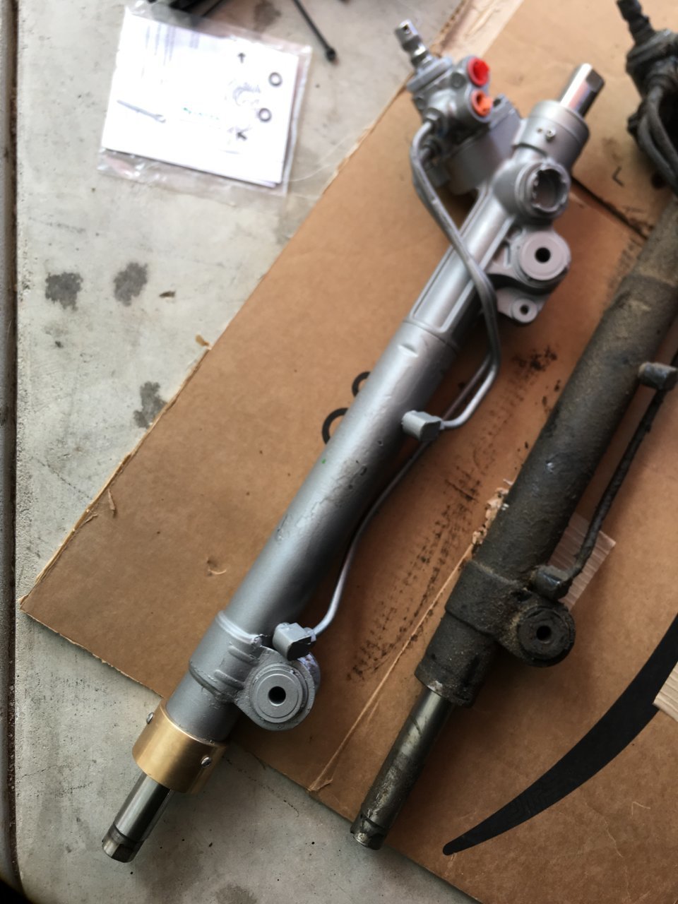

    New to me remanufactured vatozone rack with brass bushings to give support and stop the rack from hating me in 6 months, hopefully.

    What exactly is the brass bushing doing?

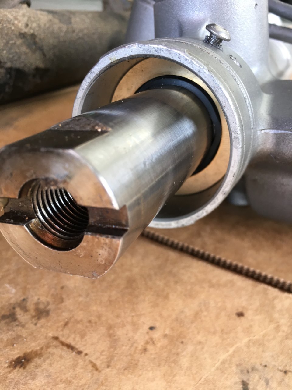

    Without getting too far in the weeds, let’s get into the weeds lol
    We’re trying to eliminate or reduce the drawing below.
    there’s a lot of deflection/bending that occurs at the open ends of the rack since there is very little mechanical support when you add massive tires and decide to drive crazy. The stock rack isnt designed for 37s and long travel, it’s made to last 250k freeway miles. These bushings tighten the opening at each end of the stock rack and give more support to the actual “rack” portion of the rack & pinion to keep it from pushing out of its main axis of travel (dotted line in pic above). Once the rack gets pushed up/down by the tie rods and out of its main axis, it pinches seals and ruins them.
    It’s a prototype, might totally fail and make it worse, or the tighter tolerance might give it exactly what it needs.
