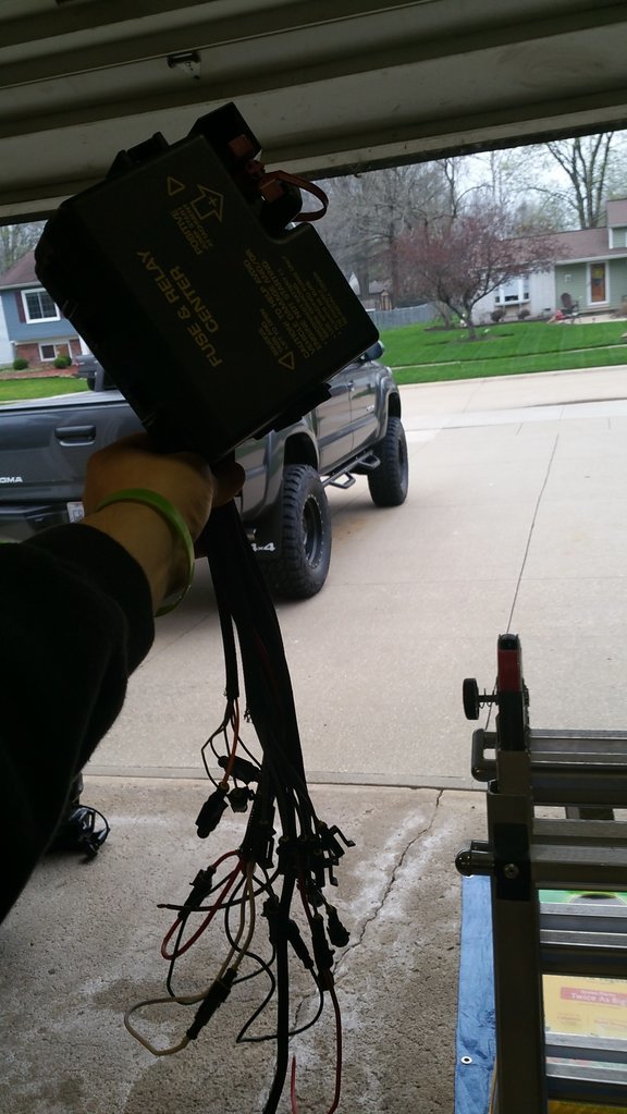

    Mounted fuse box last night :) Just needs wires hooked up!

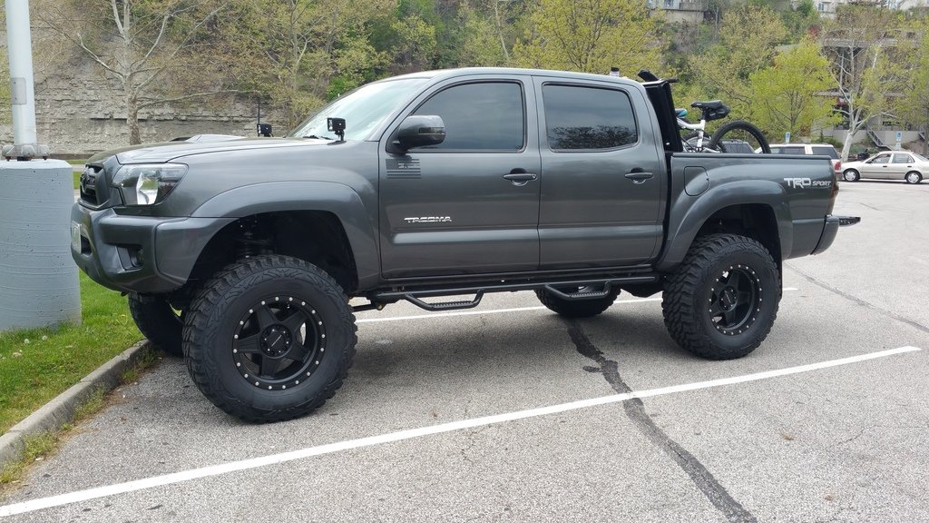

    First ride with the DIY bike rack worked well. Moved around while mounting bikes, but that's it, nothing while driving I noticed.

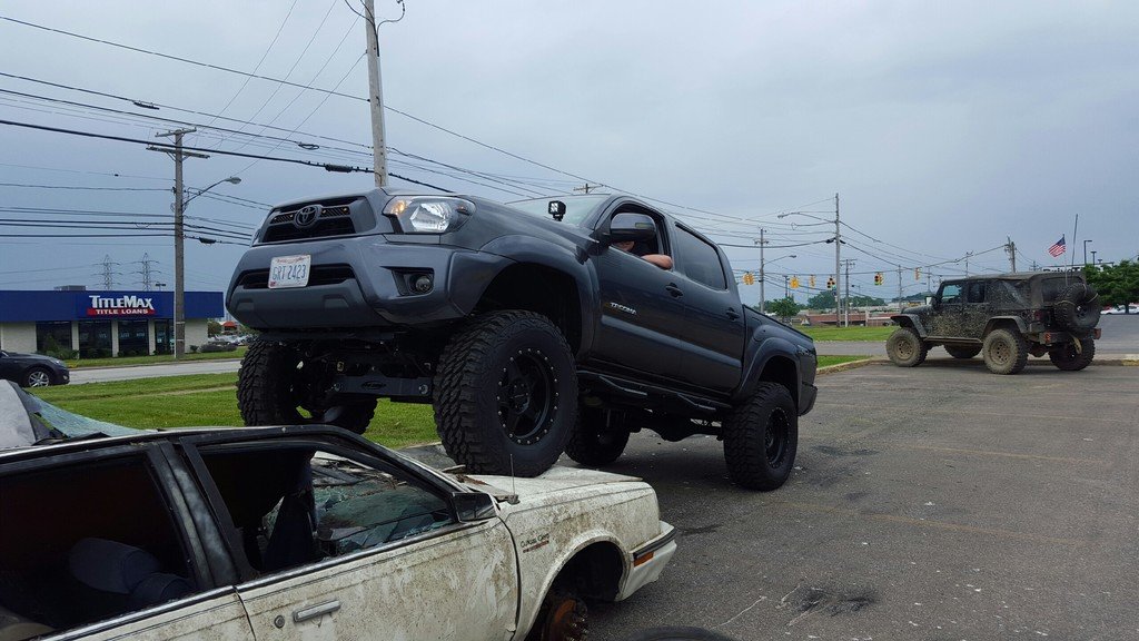

    Took the Taco to a mintruck show, rather then my bagged Dakota.. haha.

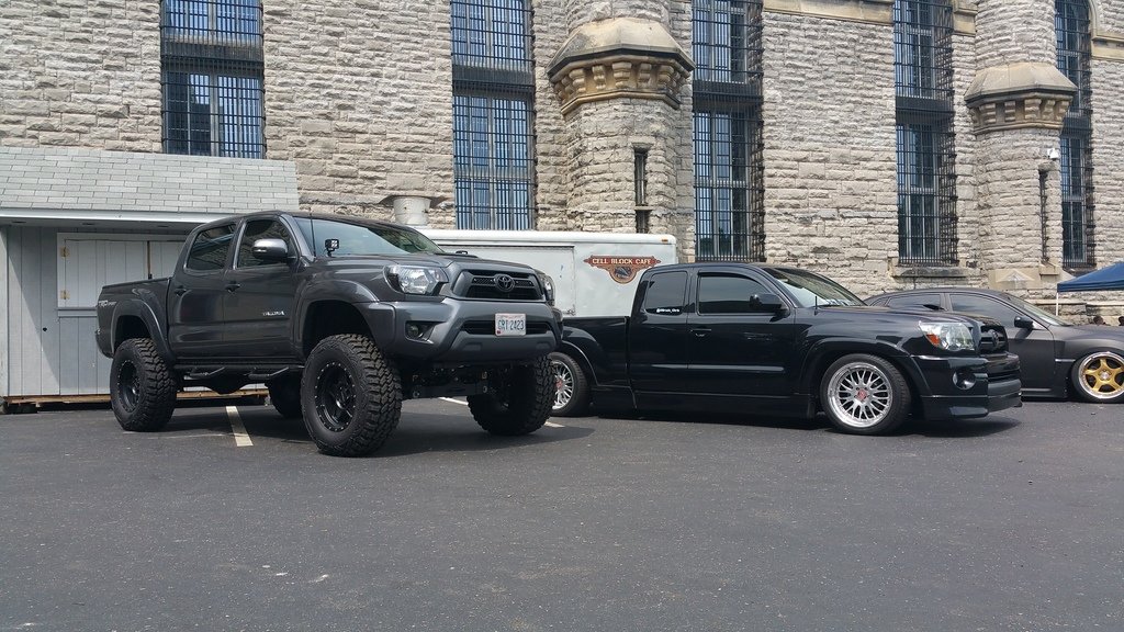

    Took some pictures on an access road behind a church for sale by me... haha.
    Next to the other toy..

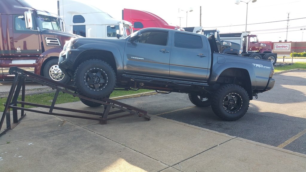

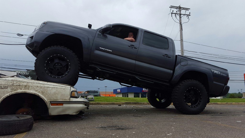

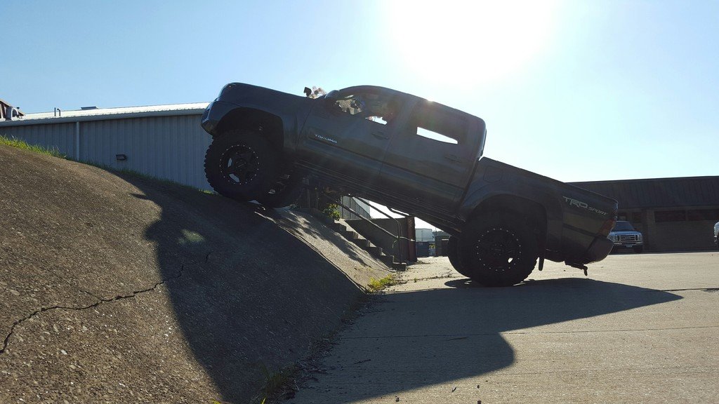

    Little more flexing on the clock at work..
    Tires to the dash..

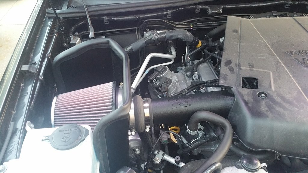

    K&N 63 Series Intake Installed on Tuesday night. Don't mind the dirty bay.

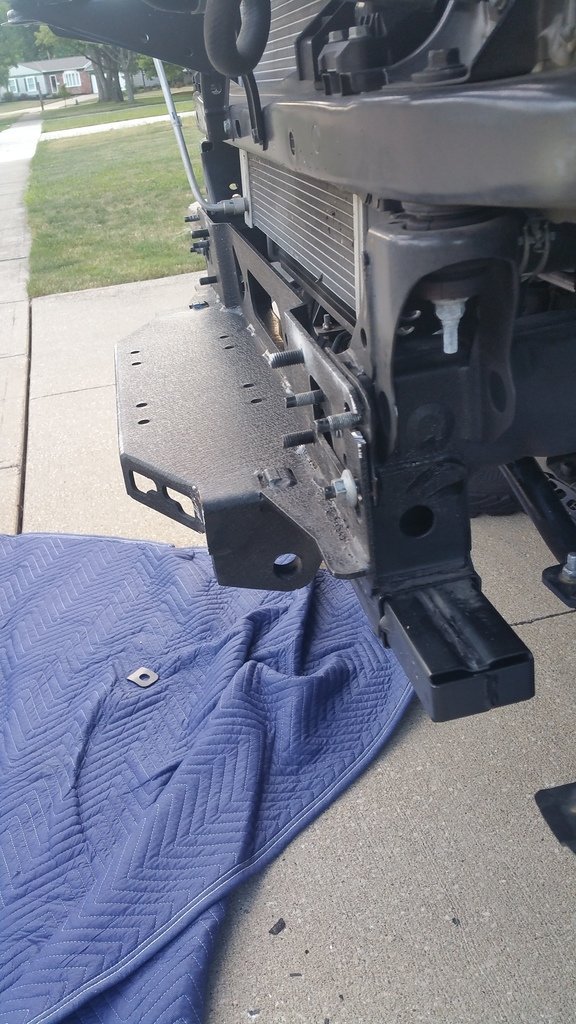

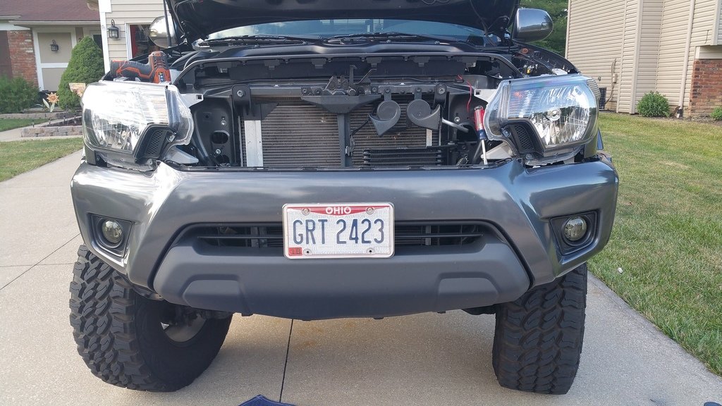

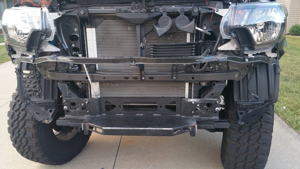

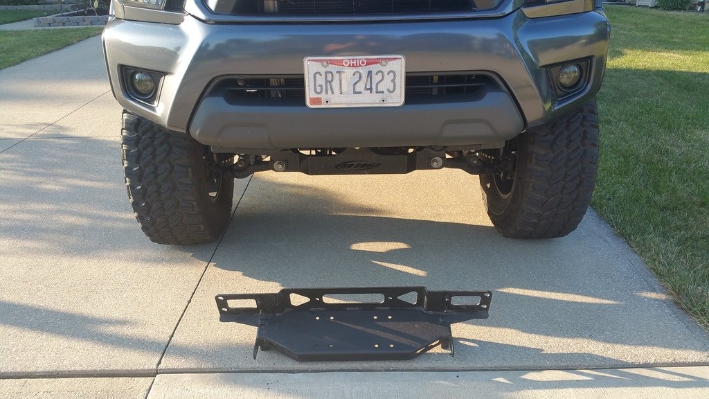

    So I saw this winch bracket from a Wrangler JK in the scrap bin at work. Took off of a crashed JK but this part is fine... I did some measuring, flipped it around and it may work backwards to make a Hidden Winch mount.. So that's something I'll be messing with this weekend. I'll have to run a winch fairlead bracket, but we'll see how things go.
    Did some curb crawling after work yesterday too.

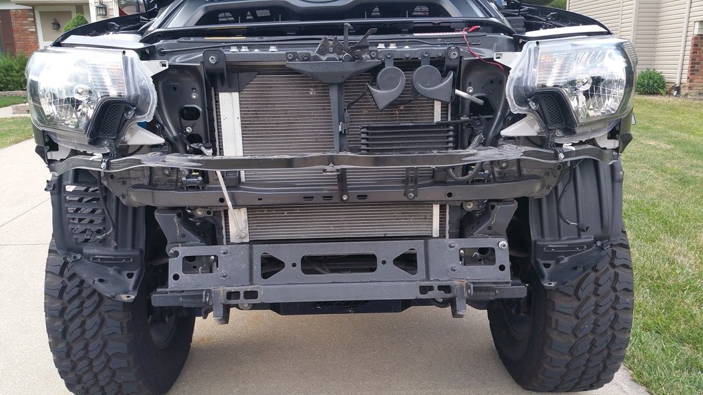

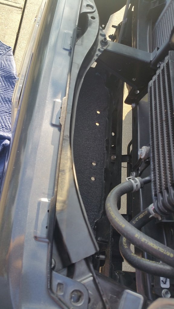

    Tried my first attempt at making that winch mount work. Pretty good!
    Bumper off.
    First attempt on hanging it up... Had to cut a bolthole out.
    Cut the other side and got it on their a little better.
    Need to cut off that tow hook on the driverside, and see how it lines up under bumper. Either way I will be welding a plate to redrill holes onto it, so I can move it up or down if needed. That's where I stand, due to all my batteries for sawzall being dead. Until next time.

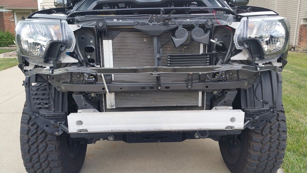

    Got the mount sitting more flush. Had to cut down the D Shackle Tabs, and cut off the front 2 mounting hooks (which were on the back originally).
    Have to trim the front bottom lip to clear bumper better then it should be good to go.
    Bumper over it, bulging a bit because of the lower area I need to trim.
    Behing it.

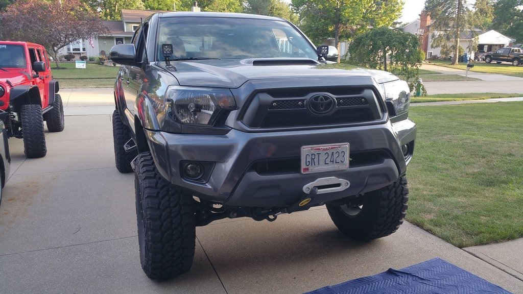

    Got it all wrapped up Saturday night.
    Made 6.5"x4.5" steel plate with holes drilled to sandwich the bracket on for extra support and mounted up winch mount. The fairlead was mounted on with a Poison Spyder Hawse Fairlead mount like below with some metal spacers to push the fairlead forward to the bumper.
    http://www.4wheelparts.com/Winches-...px?t_c=18&t_s=124&t_pt=5143&t_pn=PSC45-57-010
    Here she is!
    Got to use it yesterday too, my pop up was stuck in the dirt from settling in over the winter. Worked good! :thumbsup:
