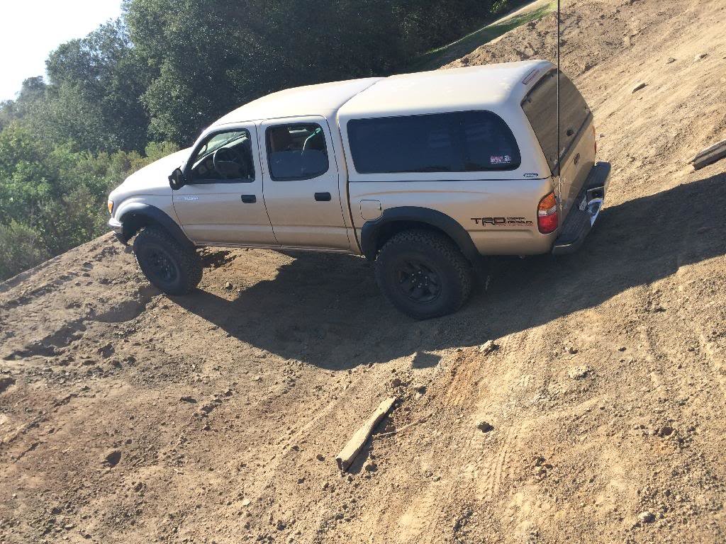

  17. Mar 25, 2014 at 12:14 PM
    #37
    johnboyTRD
    johnboyTRD [OP] Well-Known Member
    Sep 19, 2013
    #112818
    3,226
    John
    South SF bay
    2003 Tacoma Double Cab TRD
    Full ome lift, nitro charger sports all 4 corners (rear shocks relocated), Dakar pack w/ AAL, 882 coils, diff drop, toytec 1" shackles, trail gear low profile front bumper, Tuff Stuff winch, bamf sliders, RAT skids, BAMF Bed Rack, Tepui Kukenam RTT, RAT rear bumper,
    Pic from the weekend...
    A few more
    I suck about taking photos... Not my thing I guess.
