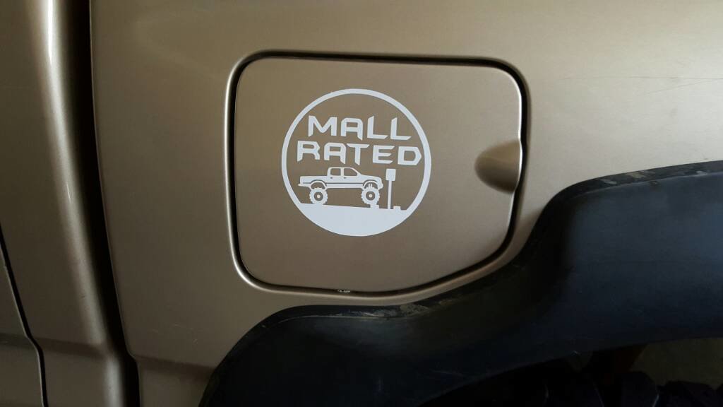

    John.. have you checked your mail lately? :spy:

    Nice! Yeah I'm probably going to step to a 35 in about 9 months.
    I'm a little worried about that. I usually drive 65
    Noice.
    I did! Just got yesterday. Need to pop that on the taco this week :) thanks again man, really appreciate!
