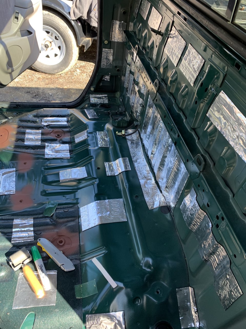

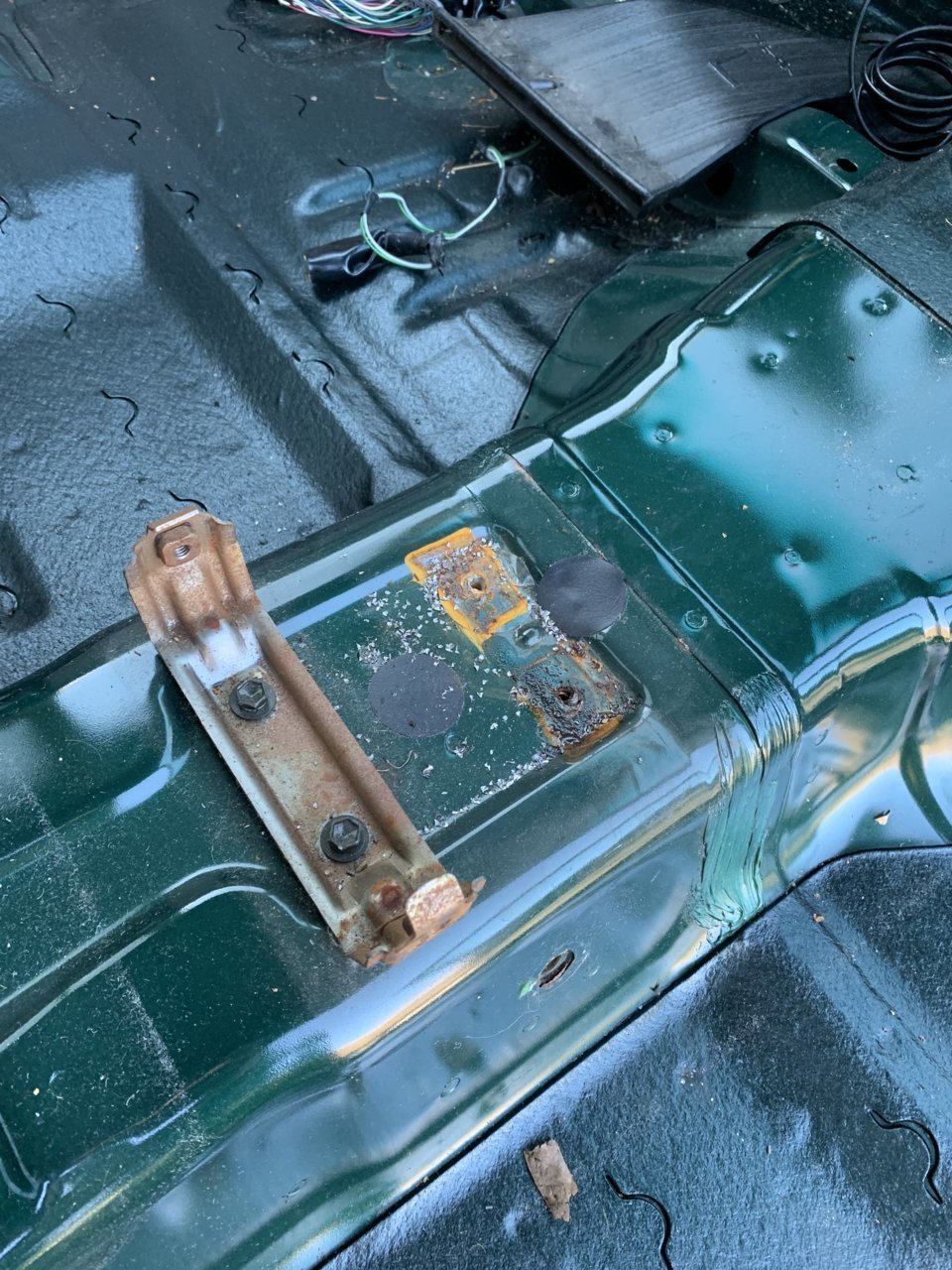

    So I pulled most everything out except the ceiling. I need to figure out how to get the rear grab bars off. Anyone do it before? I still haven't spent anytime searching, will do that tonight.
    Really happy with how things look under there, a couple bolts I'll replace with nice new ones, and I'm going to wire brush any rust looking spots and hit them with a quick touch of rustoleum. Tomorrow is going to hit 50 or so and be sunny, so finally a nice day I have off that I can get sound deadening done. Pretty excited as the cab is a bit loud with nothing. I have tile,foam and some mlv left over from other vehicles and will do as much as I can.

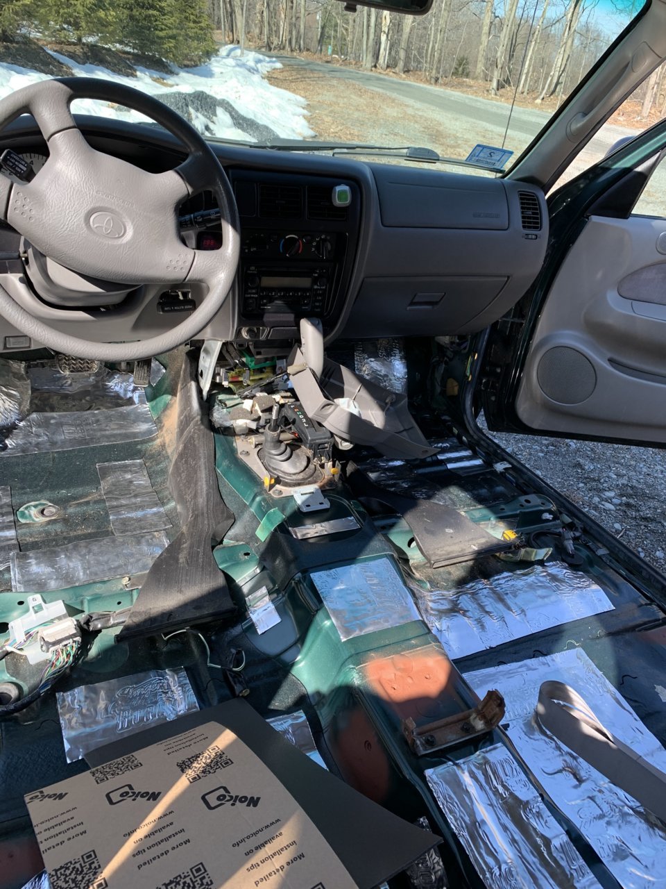

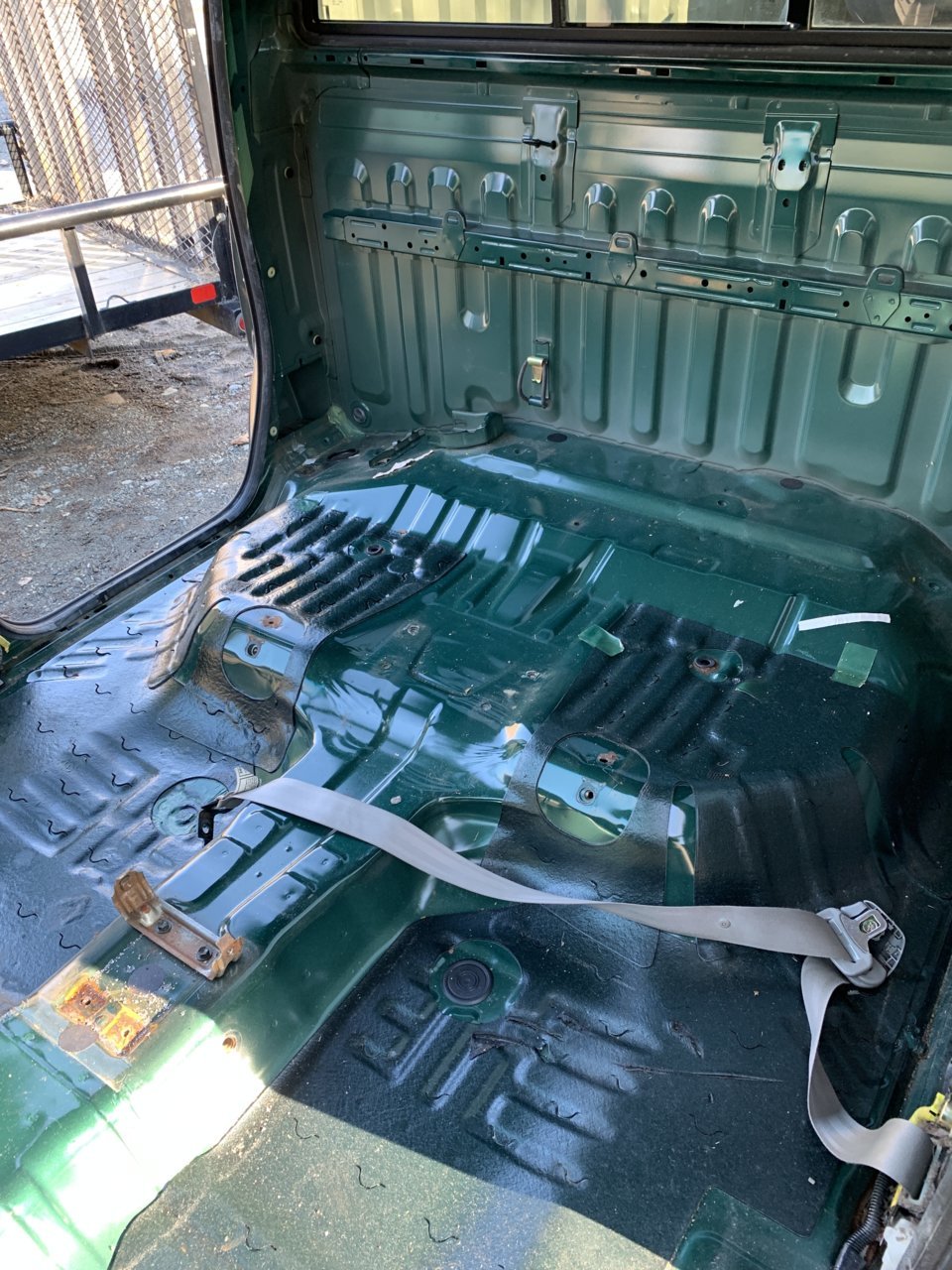

    Finished up the sound deadening. Did some tiles then covered it completely in Noico foam type stick on stuff. I only did the stinger road kill for the 20-30%, and covered the noico about 95% of the interior. Next up is doors, but I'm gonna take a week or two off before I do another day of this.
    Forgot to take photos after I did the tiles. Was able to take it all apart and put it together with only one bolt breaking off on me, happy with that.

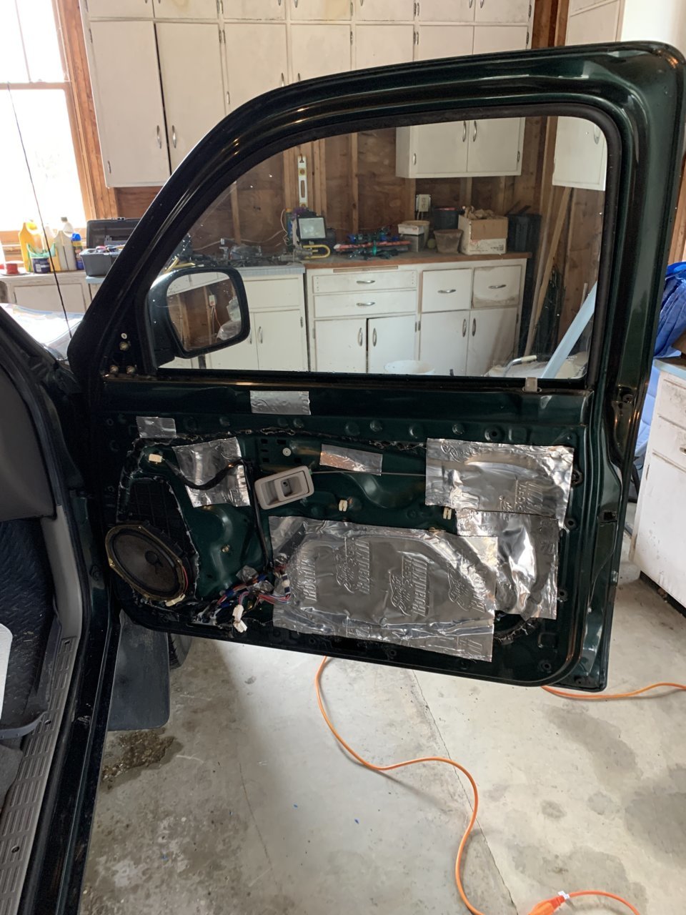

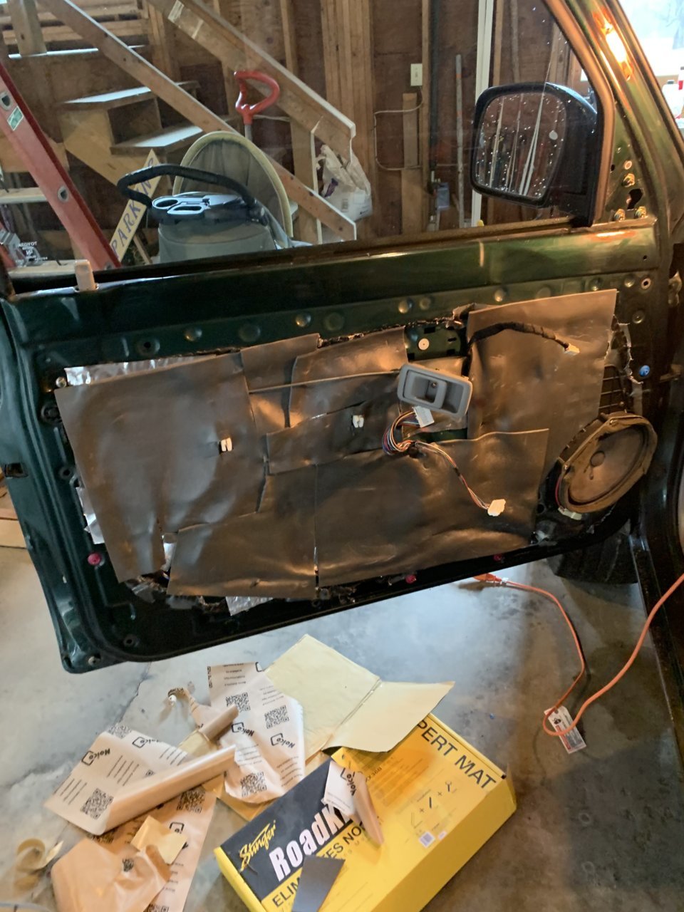

    Got the front doors done today, it was raining so I called my parents and asked if I could pull into their garage for the morning, got the :thumbsup: and went over. Didn't take a ton of photos, but will attach two. I put a ton of the damper tiles on the outer skin and back of the inner skin, then tapped around and filled the holes on the front. With the foam stuff, I did better on the second door, and I cleaned up the one in the photo a bit before I put it back together. I broke 7 clips pulling the doors off, even though I did it slow and steady, just old plastic. I had exactly 7 left over from doing my 2018 taco and 2016 4runner a while back. So all back together! Made a big difference, will do the rears soon enough, waiting on temps where the stuff will stick well :)
    Then when I got home, the UPS man came with my HU and wiring. So I just finished up crimping those together. The HU has a micro Amp, and requires a battery connection, so I had to call up Crutchfield and see how they wanted that. Shout out to them for quick easy info. Going to pick up my wifes 4runner in the morning from a service, and then will instal this thing after that. Anyone know if that hole in the firewall is accesible from the HU area without messing with more trim?

    I'd say its definitely worth the $250 I will have spent on material by the time I finish the rear doors. If you pay someone to do this it can easily get over 1k just because of the time involved in taking everything apart, and then if they do a clean job, the time it took to cut and install it all. Even so, I'd still consider it worth it on an older truck like this.
    There is nothing between you and the road except some sheet metal and a very thin carpet or piece of plastic for 95% of this truck. To me it was really loud driving around compared to the other cars I've had, especially since Ive done something like this to all of them in the past 7 or so years. Between how loud I had to turn the radio and the road noise it wasn't comfortable to me, and sometimes even almost painful if I had the radio too loud. It literally feels different inside now, you feel secure and almost cocooned. Things are significantly more quiet, I'm not sure what it would be technically, but the "butt dyno" feels like at least a 50% improvement in noise, and add a 20% bonus for the added comfort I now feel in there. I can go 60 and have a regular volume conversation with my wife. The speakers sound better and I don't need to turn them up as much, and I even think it seems to trap the heat a lot better now that I have most of it but the roof done.
    If you have a weekend or two, and $200 bucks or so (if you use noico tiles it's probably cheaper than the stinger roadkill I used and basically the same) I'd do it. Even just do the doors first as a trial, when you close them and hear that super solid *thunk* and the difference it makes you will want to do the rest. I've never met or talked to anyone on a forum who has regretted doing this. :yay: It just takes some patience and get some instructions. I have the "master" instructions from crutchfield with removal instructions for any 1st gen. Feel free to send me a pm and I can send it your way, but there are also some great threads on here I used to see photos and real examples.:thumbsup:

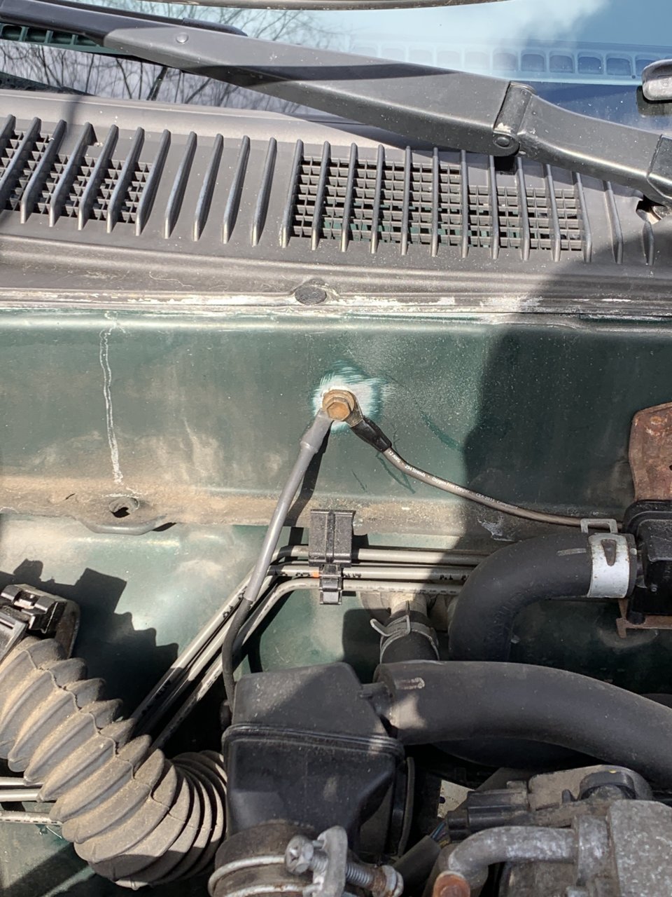

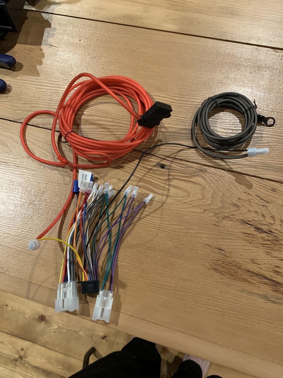

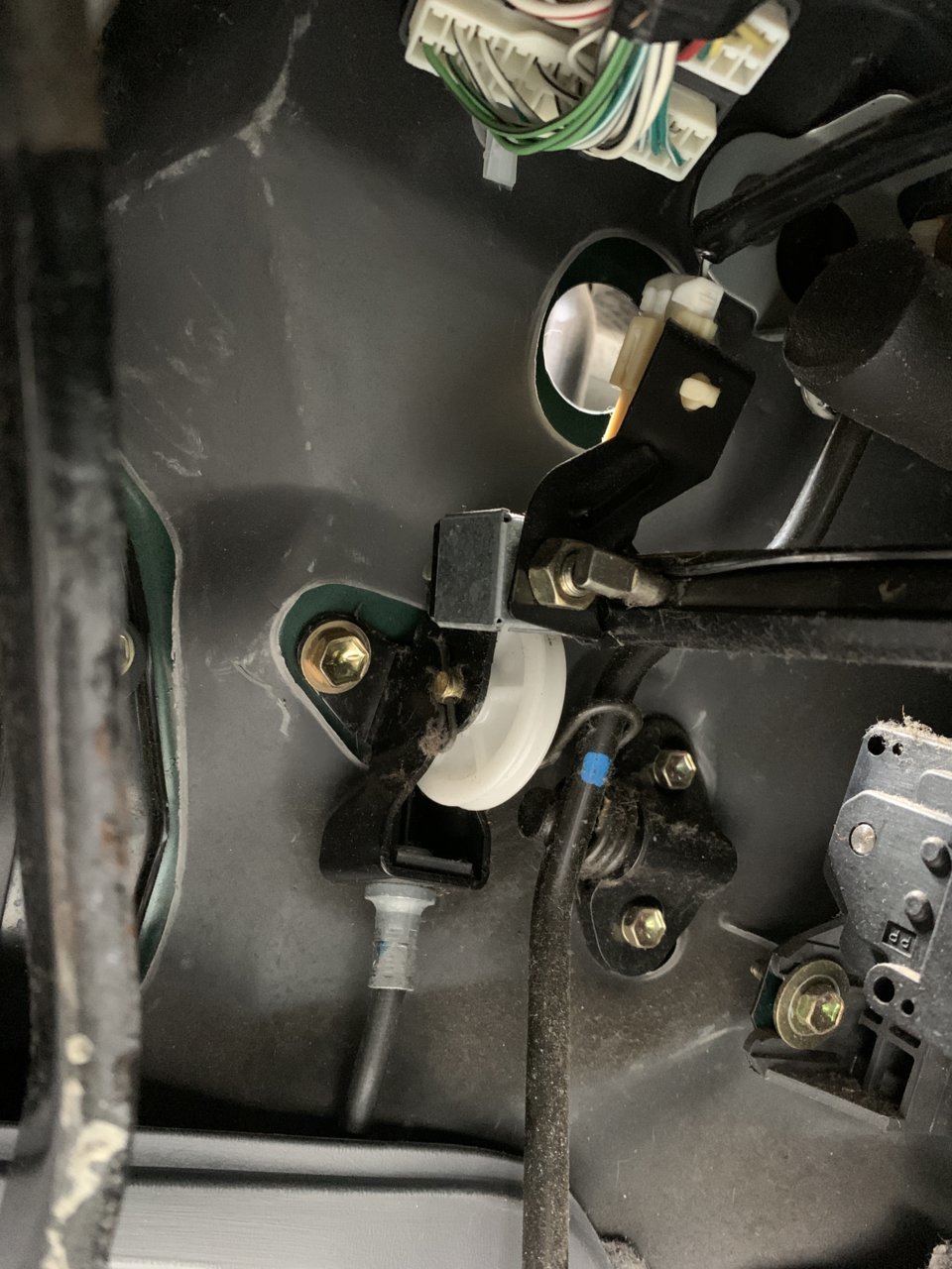

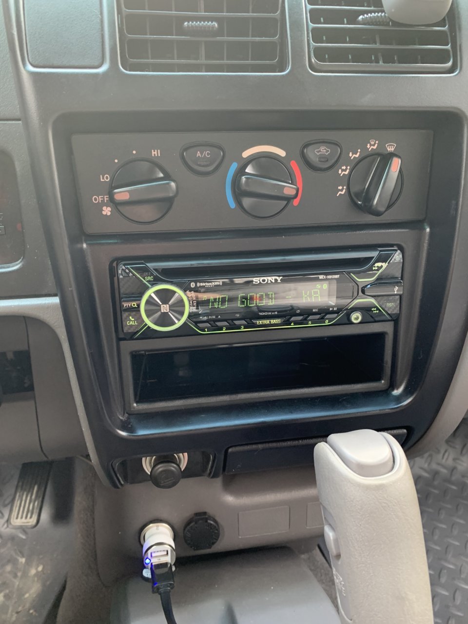

    Alright, head unit is in action here! Really relieved that I didn't mess it up bad and run into issues, this is the first time I've done something like this. I am fine ripping apart things that don't have electricity, but don't usually feel comfortable messing with it. My cousin has done a handful of these and talked me through the initial wiring, which was the only confusing part.
    I used the Crutchfield instructions which were A+ and also this thread: https://www.tacomaworld.com/threads/how-to-2001-1st-gen-aftermarket-cd-player-install.303835/ Shout out to @zacharypaul89. You're old ass thread is still helping folks! :hattip:
    So as I think I mentioned in an earlier post, this has a built in D amp and needs to wire direct to battery. Luckily it was super easy getting there! You can run the power cable behind the stereo and down by the gas pedal, then there is a rubber plug just waiting for your wires! Upper right corner of photo below:
    Ground that bitch out! First I cleaned up the area with a quick wire brush to make sure there wasn't any paint messing up my day. I've seen and read about people with big confusion over why things didn't work and that was the problem.
    Then put it all back together and jam out :rasta::rasta:
    I can also get rid of the stupid charger, as the USB on this HU charges my phone, AND I have a place to stash my phone and wallet with the tray that came with it. But best of all is how this thing has woken up the speakers. Between the sound deadening and this new head unit, it's a whole new truck and sound experience. I am excited to do the rear doors, and eventually replace the speakers, but this is going to hold me over for a while I think :rimshot::headbang:

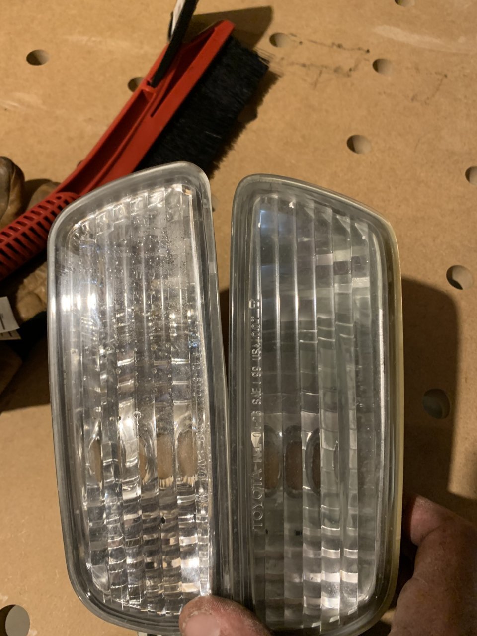

    Replaced the turn signal lamps today and put leds in the new ones. Super easy to change, these trucks are so easy to work on!
    new ones:
    my passenger light is next in that department but not really rushing since I don’t drive a ton at night
