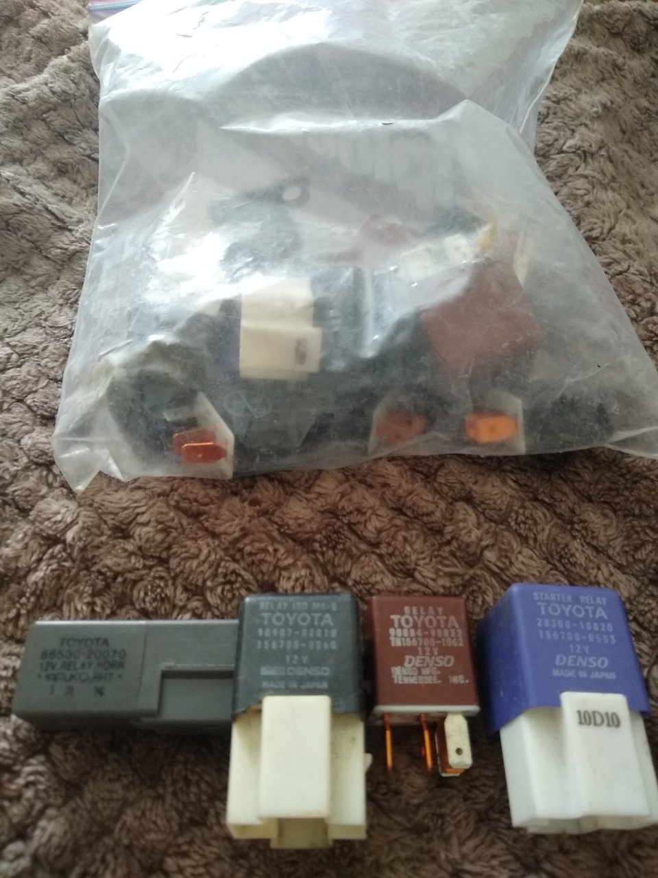

    Which relay you need from Toyota? I have a bag of relays that I've built up over the years but Toyota/Denso relays rarely fail. If I have one you need, I'll toss it in the mail to you. Just cover shipping :D

    The relay for the flashers/blinkers. I might even have it in my basement if I do a hard look. If I have trouble getting a hold of it after this week I will take you up on that offer. Thank you!

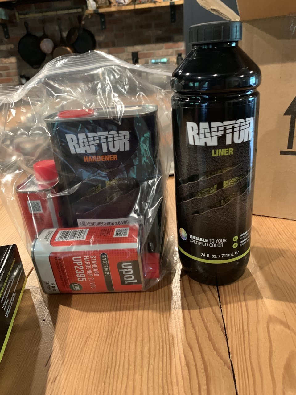

    Bed is sanded, and primed with self-etching primer. I ordered the raptor tint kit, thinking it would be black and now need to wait on the black tint, I think will show up tomorrow?
    One coat of adhesion promoter for the tight spots and a quick double check to make sure I have all the bare metal covered, and I'll spray. I think either tomorrow or Friday most likely.

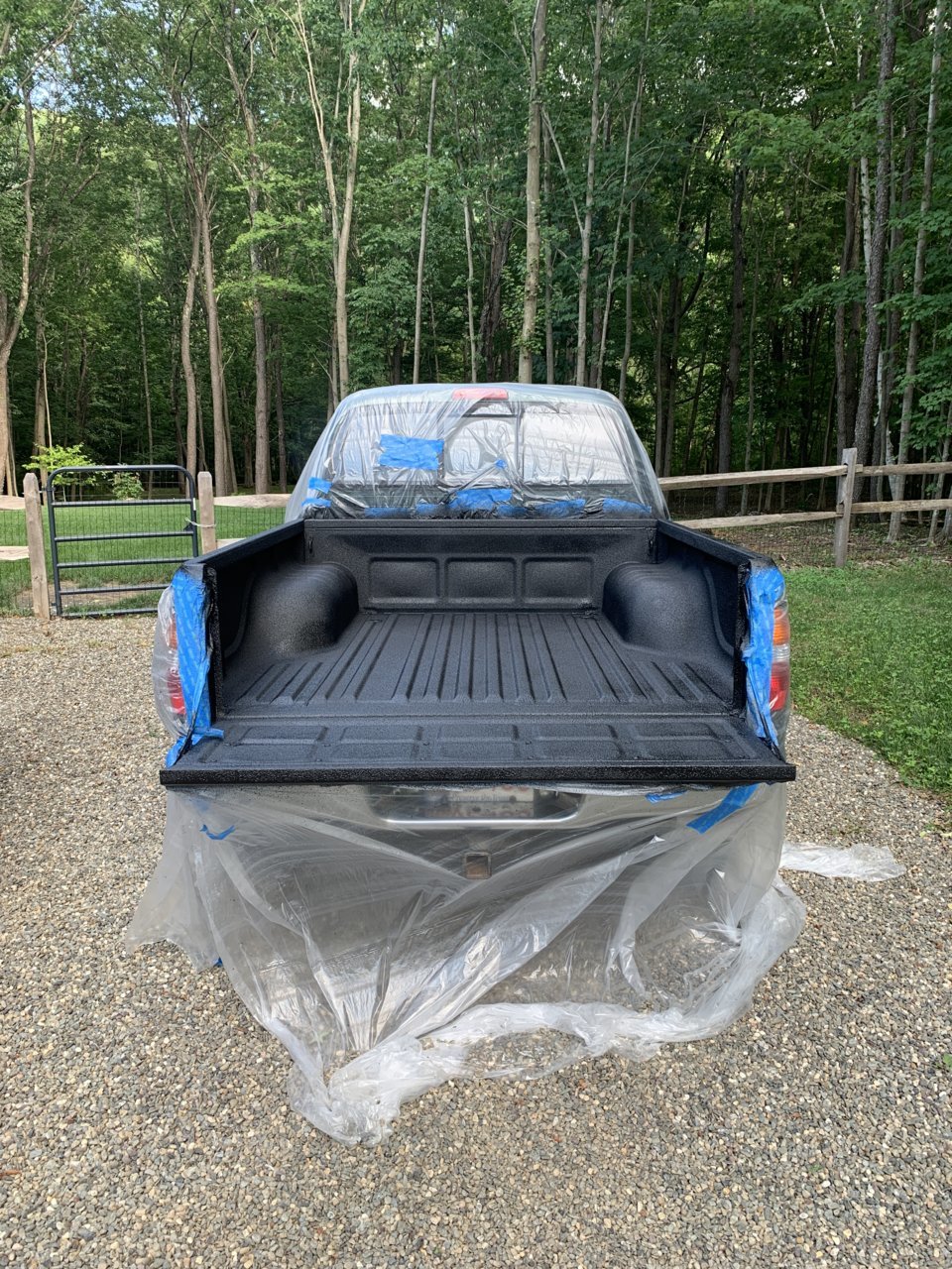

    Alright did some downhill in the morning and finished spraying this afternoon. Used 3 bottles, maybe could have done 4 but I think 3 did the trick.

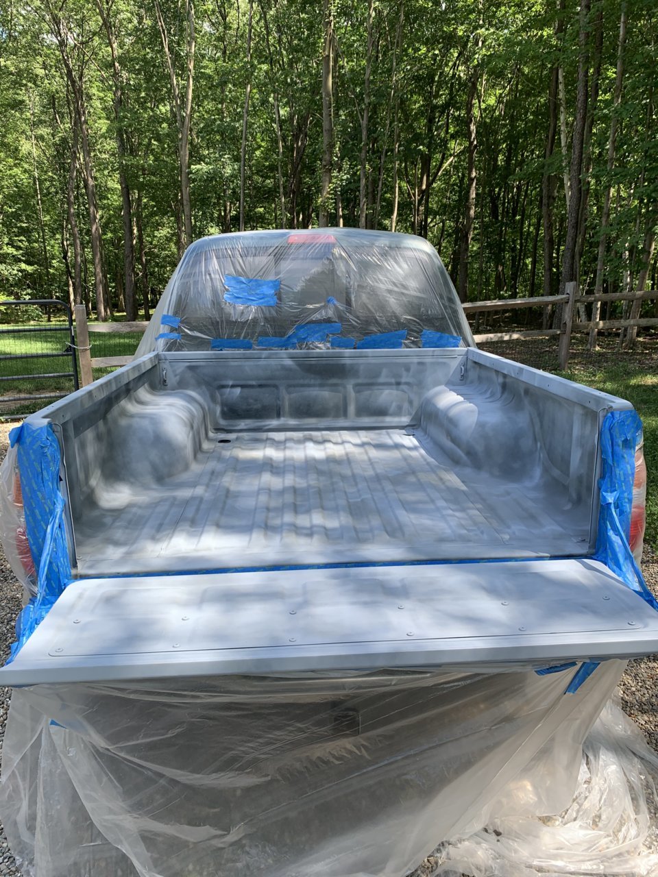

    prime it good guys! (I already sanded degreased etc... at that point)
    1st coat. I went light, if I were to use 4 bottles I think going a little heavier on first coat would be where it would come in handy most.

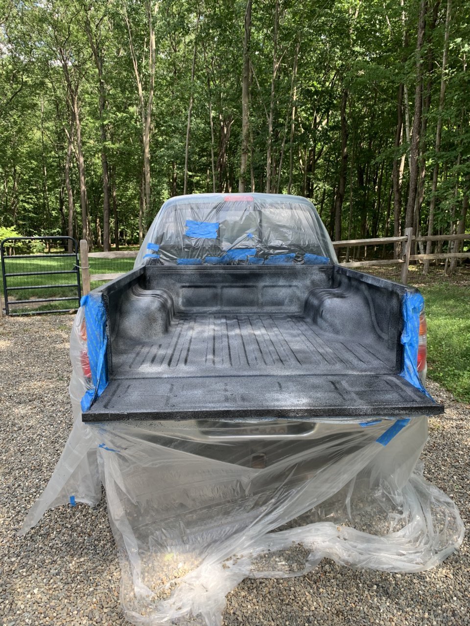

    2nd coat. Did two bottles
    Overall a couple small areas where I would have liked to tape a hair lower or whatever. But I’m satisfied and think the truck is in a better situation without the plastic liner and the little bits of rust I removed and primed that were hiding underneath.
