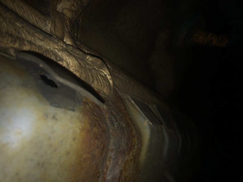

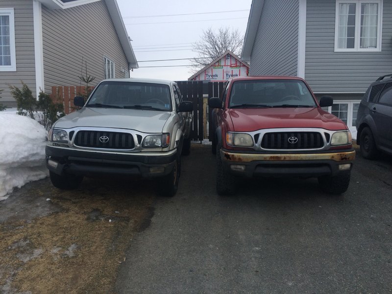

    So update on the frame rust issue with silver 04 PARTS TRUCK. I figured before I do anything I should see if this is covered under the frame recall as my 02 Tacoma was. The Previous owner did not get the undercoating applied that was offered this expired in 2012. If previous owner did then the frame would have a 15 year warranty from the date it was made.

    Called Toyota and the frame for the 04 parts truck would cost me $10000 ..... not going to happen

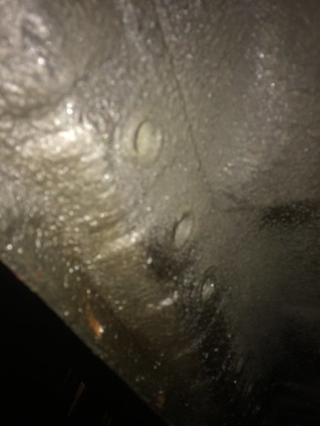

    So on my 04 parts Tacoma silver the inner rocker has holes covered by stupid rubber things.
    On my 02 Tacoma red I took a step drill and opened them up and put plugs in them. I filled with rust check first.
    Forgot I did this but when I was looking at my fuel filter I remembered.

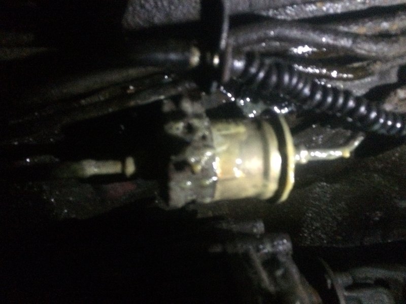

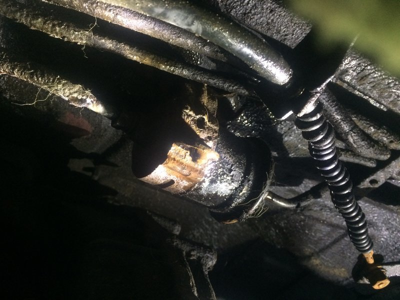

  12. Feb 22, 2017 at 9:03 AM
    #72
    Jon G
    Jon G [OP] Hoarding Tacomas one at a time,
    Jan 25, 2017
    #208594
    1,830
    Jon
    St John's Newfoundland Canada
    02, 04 & 07 Tacoma
    Magnaflow 2.5 Catback Exhaust K&N filter

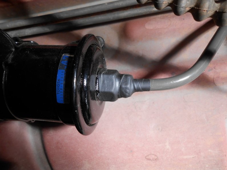

    IMG_2985.jpg :)

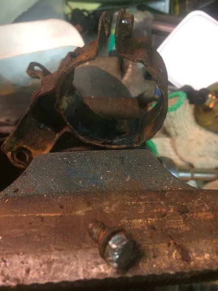

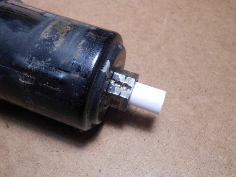

    So i am having problems getting the filter off my 02 ..... i mentioned it in a different thread and Dirty Pool provided me a excellent answer !
    Thanks
    arctic04trd likes this.
  13. Feb 22, 2017 at 9:03 AM
    #73
    Jon G
    Jan 25, 2017
    #208594
    1,830
    Jon
    02, 04 & 07 Tacoma
    Dirty Pool SAID ......
    Not uncommon at all and I figured you would run into this.
    First, use a quality well fitting line wrench, the fit can vary quite a bit. Stop before rounding the fitting or twisting/kinking the hard line.
    I had a fitting rust to the line even after using anti-seize on the threads at the initial install.
    The idea to free it up is to "flex" the threaded female half on the filter. Squeeze the fitting with the biggest baddest pair of channel locks or even better vice grips. Squeeze on the points of the hex not the flats. Try several squeeze and release cycles. With vice grips you can tap the jaws with a hammer to help break the bond. Use the penetrating oil of your choice.
    If this doesn't do it and you still knew when to stop, break out the drill. Drill a row of holes along one of the flats to weaken the fitting then do the squeeze operation again. No need to go too deep with the drill.
    I went a little deep here, but all is well.
    On assembly I still use anti-seize but give the fitting a wrap with that rubber tape that fuses to itself to keep the weather out.

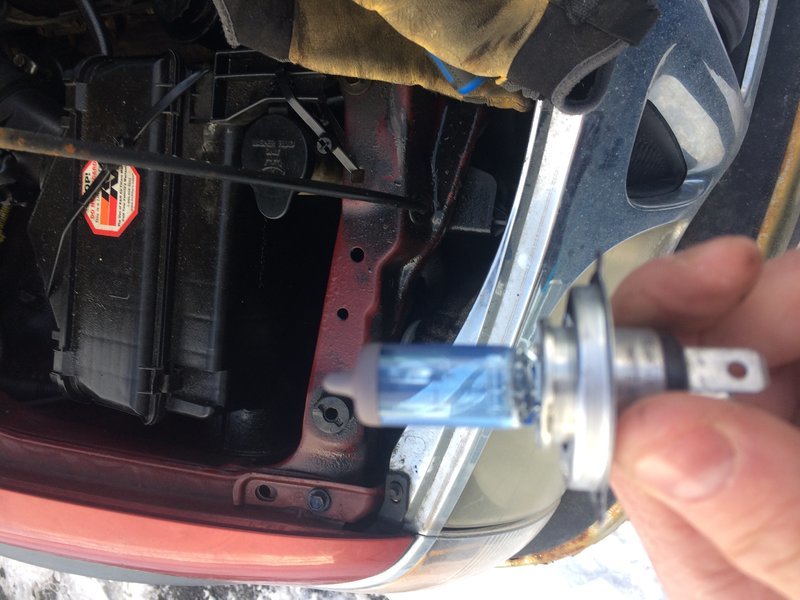

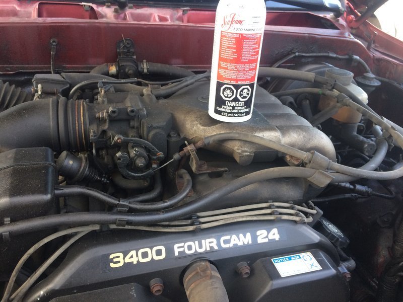

    Did the sea foam to my 02 red Tacoma and changed my headlight that has been out for 5 months ... no joke IMG_3101.jpgIMG_3102.jpg

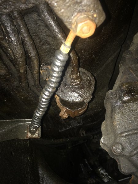

    Tacoma fuel filter change was not as hard as I thought it was going to be. First time I had it off and I have owned the truck 7 years. I did have to take the bracket off to get the old filter out and the new filter installed. Then I sprayed it with rust check
    230000km
    Change your filter !
