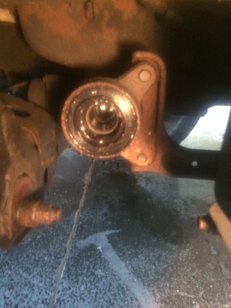

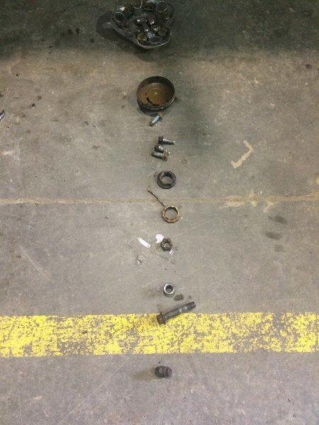

    Crappy weekend so I stayed in town and started some much need work on the Tacoma. I needed tires in the worst kind of way, I have had them bought and paid for back in the fall, I did not want to put them on without a front end alignment. To do the alignment I wanted to fix the lower ball joints as they have dry rotted boots and are puking grease. One of my cv axel boots were also puking so I decided to fix that while I was in there. To top it all off what not install the lift. Started with a stock height measurement at each Corner. IMG_3621.jpg IMG_3622.jpg IMG_3623.jpg IMG_3625.jpg
  3. May 21, 2017 at 10:34 AM
    #83
    Jon G
    Jon G [OP] Hoarding Tacomas one at a time,
    Jan 25, 2017
    #208594
    1,851
    Jon
    St John's Newfoundland Canada
    02, 04 & 07 Tacoma
    Magnaflow 2.5 Catback Exhaust K&N filter

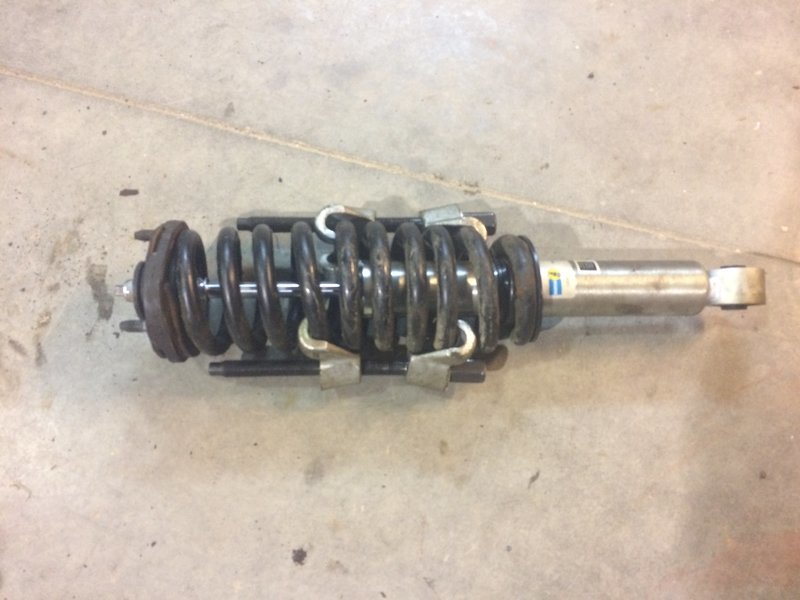

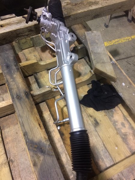

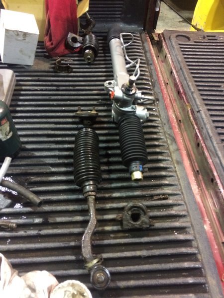

    Taking stuff apart IMG_3626.jpgIMG_3629.jpgIMG_3633.jpgIMG_3634.jpgIMG_3635.jpgIMG_3636.jpgIMG_3637.jpgIMG_3638.jpgIMG_3639.jpg

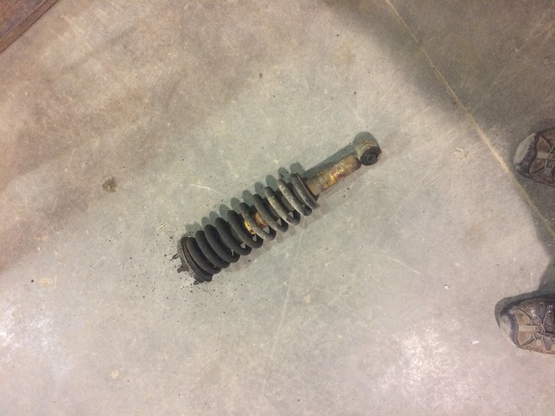

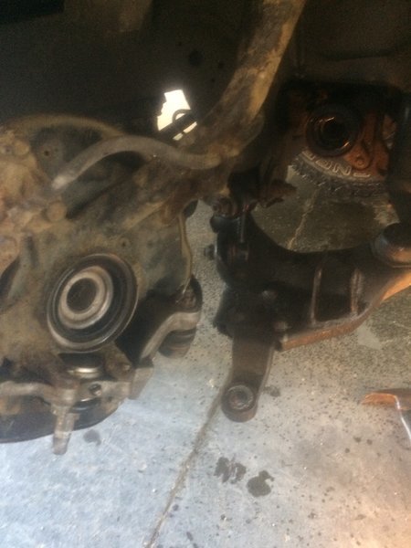

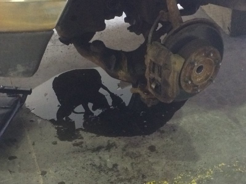

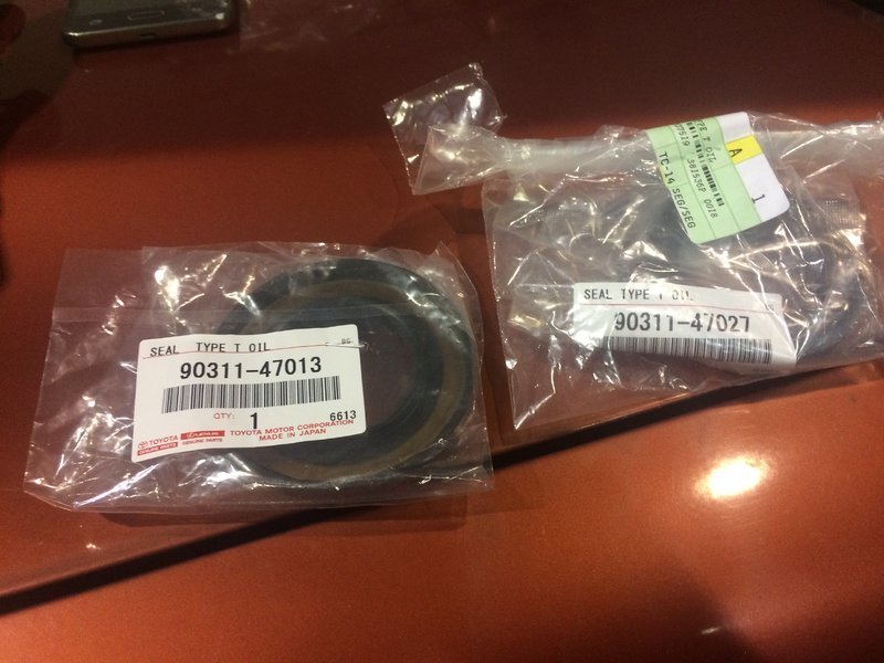

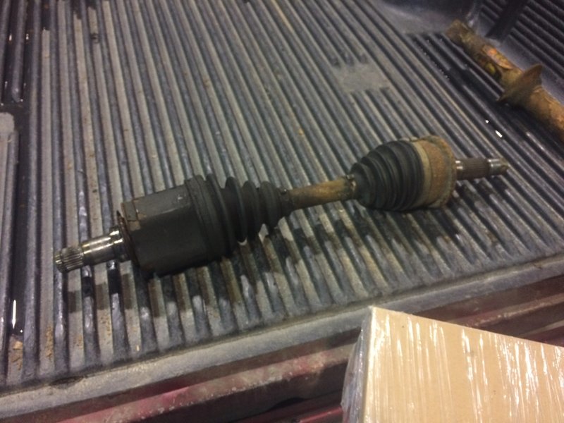

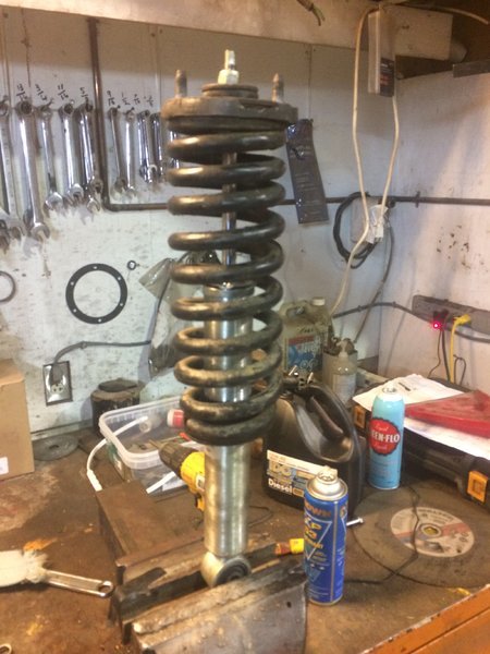

    Due to a well worn seal for the diff I decided to not risk it and install new ones. All the local parts stores are closed and Monday is a holiday so I will have to get two on Tuesday fix after work, tires and alignment on Wednesday
    Kemosabe and Dalandser like this.
  6. May 23, 2017 at 4:21 AM
    #86
    Jon G
    Jan 25, 2017
    #208594
    1,851
    Jon
    02, 04 & 07 Tacoma

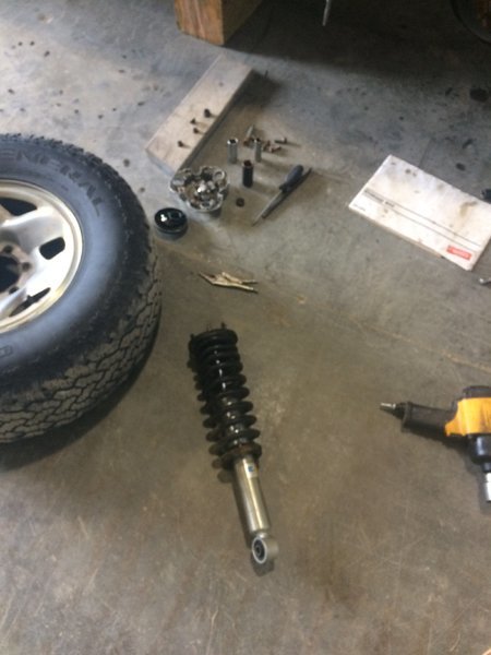

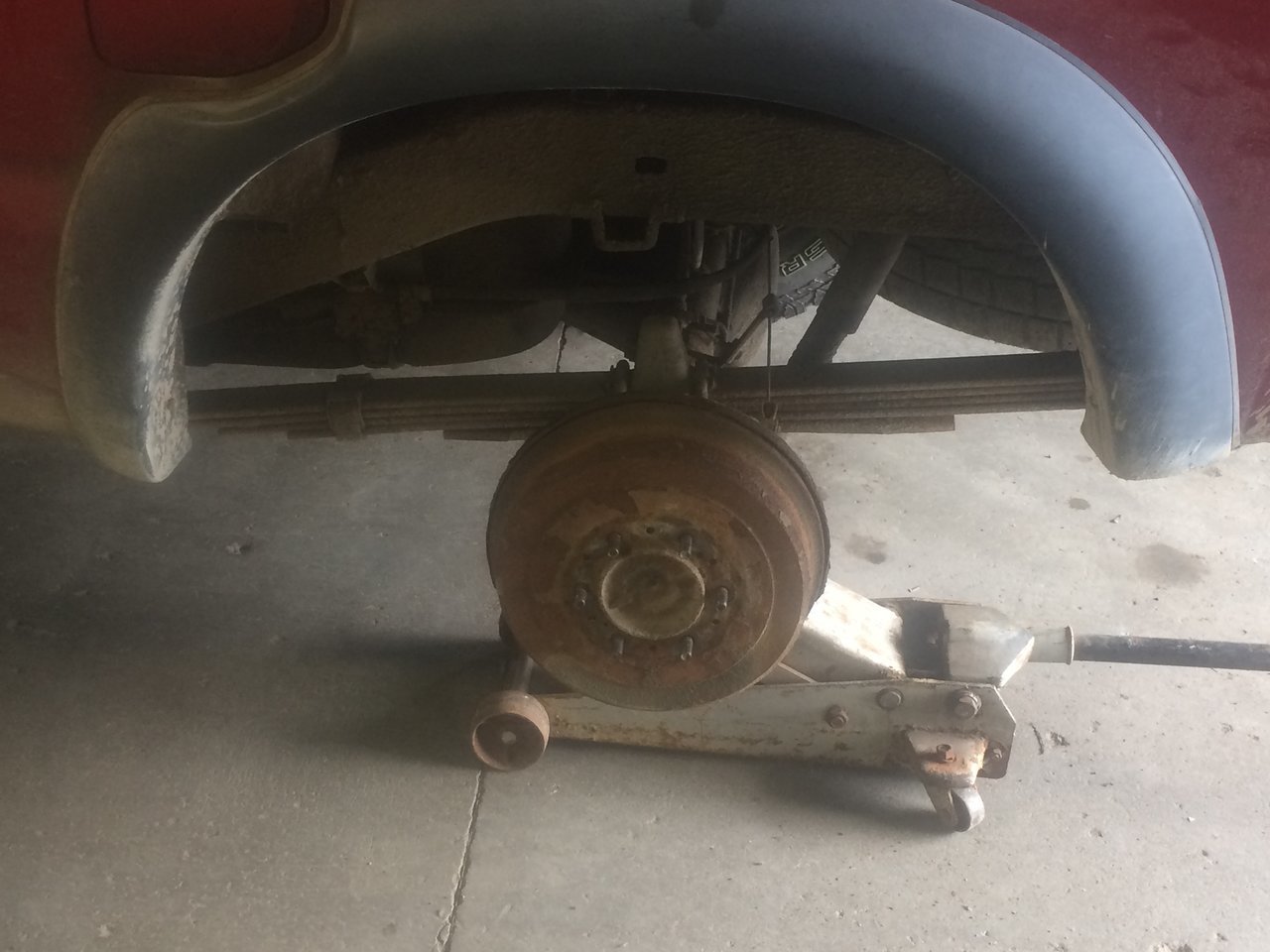

    Had to put the truck 1/2 back together to get it out of the garage at work ..... had to order the seals :(

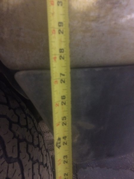

    IMG_3649.jpg IMG_3650.jpg IMG_3651.jpg IMG_3652.jpg IMG_3653.jpg IMG_3654.jpg IMG_3655.jpg

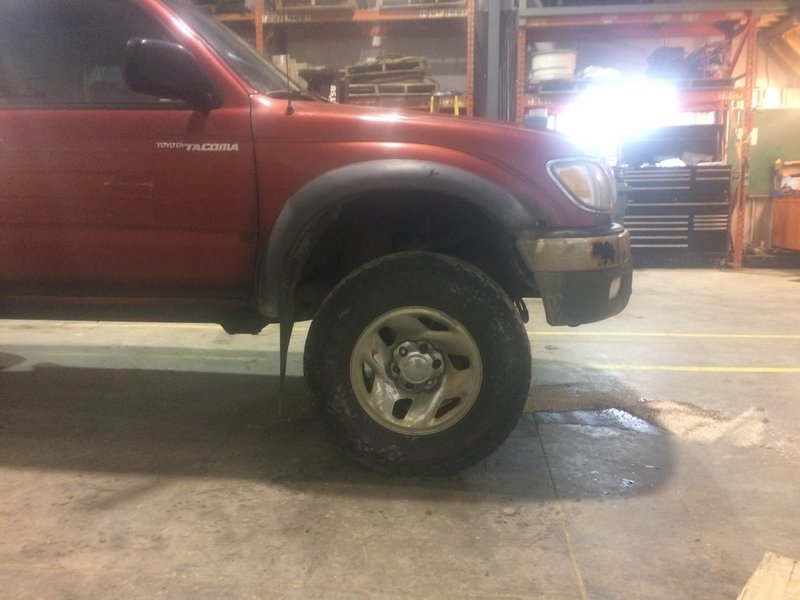

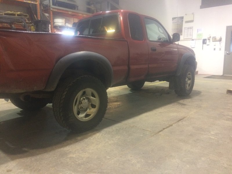

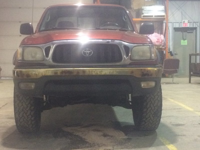

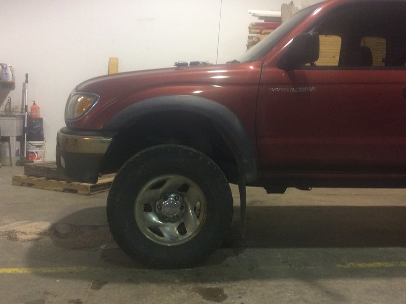

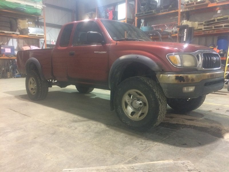

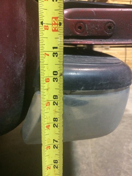

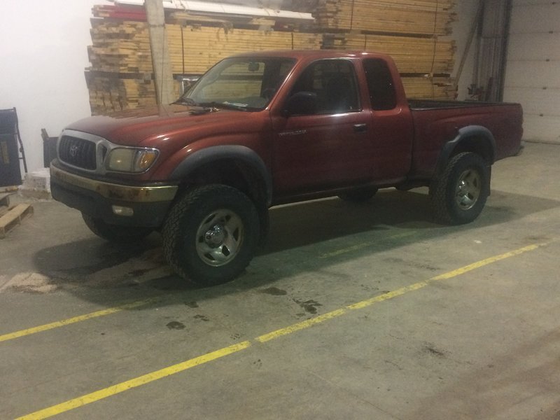

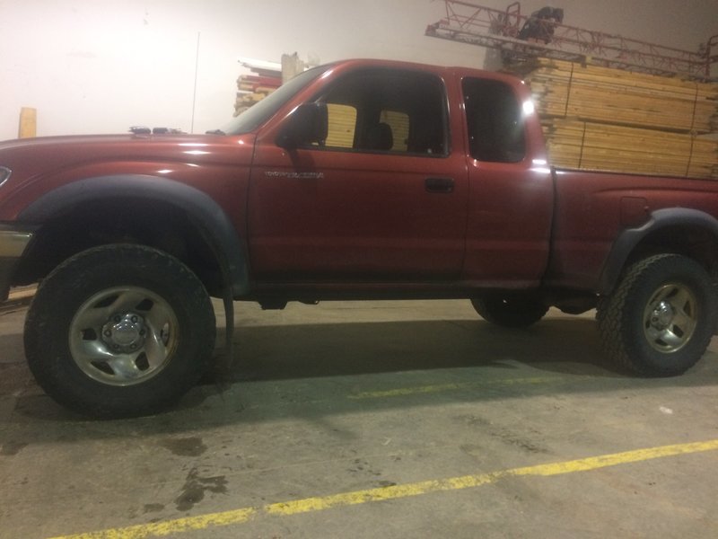

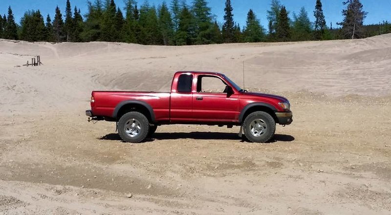

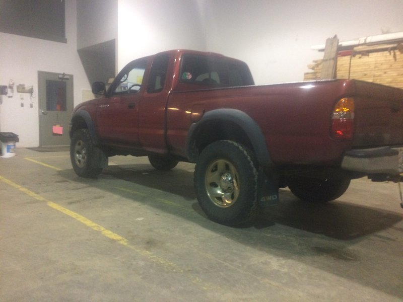

    A before picture of the truck with a AAL in the rear and STOCK TRD shocks and springs notice how stuffed the tire is in the fender
    If anyone is reading this and thinking about doing this lift I wish i had done this when i first bought the truck ... well worth the $

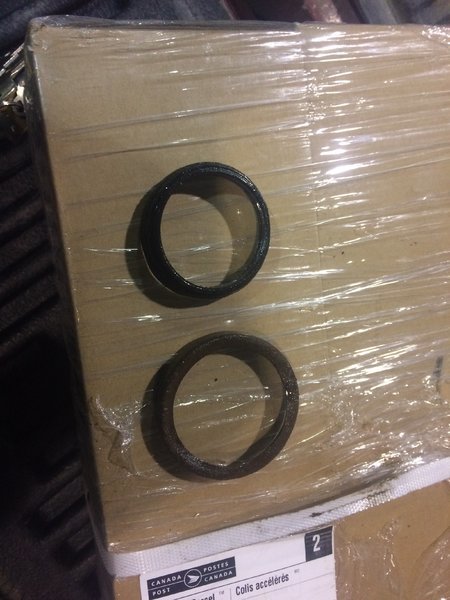

  9. May 25, 2017 at 9:00 AM
    #89
    Jon G
    Jan 25, 2017
    #208594
    1,851
    Jon
    02, 04 & 07 Tacoma

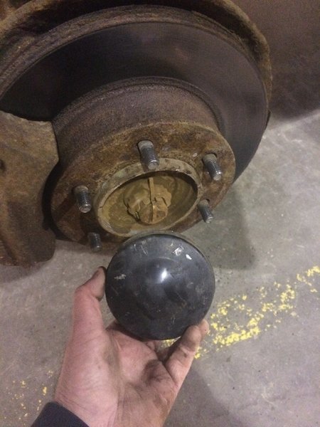

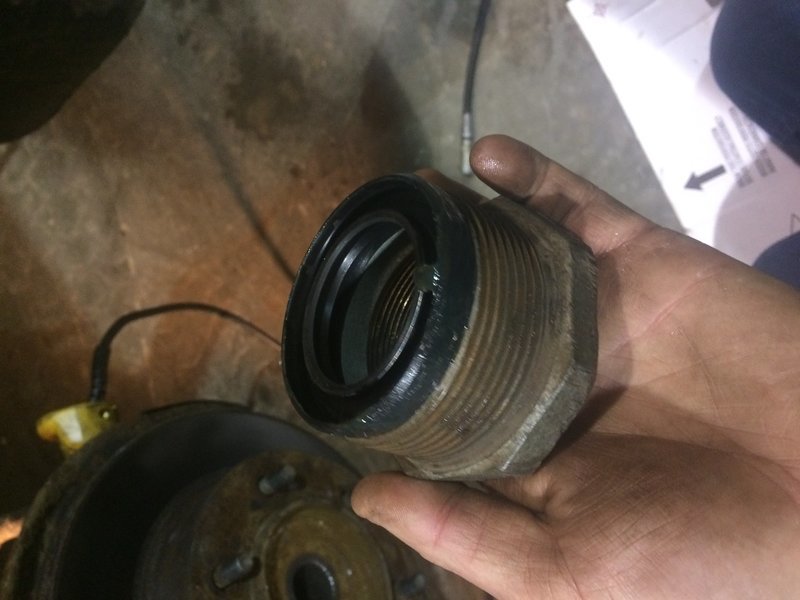

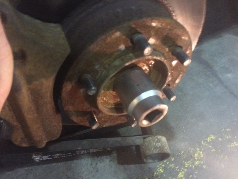

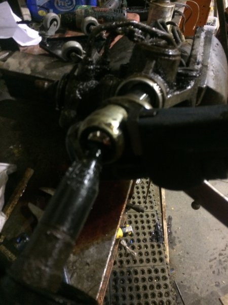

    So let's try this the hard way
    The truck was only 1/2 put back together as I decided to new cv axel seals in and had to wait for them to come in air from Toyota.
    So I was doing this after work with my good work clothes on as I forgot my dirty clothes at home, and apparently one glove. This is not off to a good start.
    The seal drivers seal went in ok as I found a pipe fitting that worked as a instlation tool.
    While I was installing seal with it half in I was interpreted at least 10 times and laid the special service tool down never to be found again. IMG_3675.jpgIMG_3674.jpgIMG_3673.jpg

    Spent 45 min looking for service tool no luck moving on found a slightly bigger pipe finished install, it is flush all the way around except on the top where it sticks out 1/16. I am going to take my chances as if I do anything else I risk hurting the seal. Got the new cv axel into position and tried to get it in past the snap ring retaining clip and no sir..... tried 4 times frustrated, hungry, and tired I put the ball joint back in and went home.

    Thanks for the video !
    Lots of excellent information
    I was having a issue getting the new cv axels in the diff due to the keeper snap rings. I was trying to cheat and do it without taking the shock off. Once the shock was out of the way I could align the axel straight and give the end a light tap with a hammer and it poped right in.
    Trying to do it with the shock still installed put it at a slight angle and I also did not the power of the sudden blow to compress the ring to get into the grove.

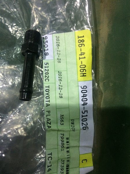

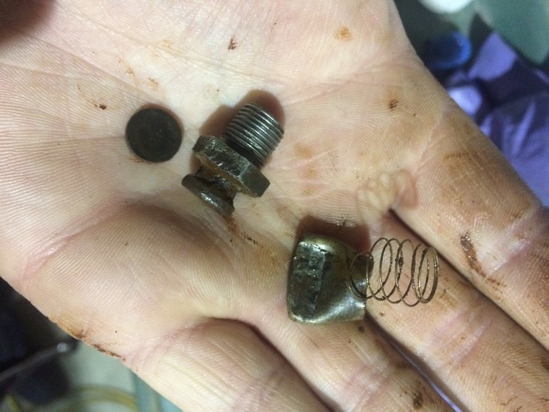

    As far as i know the diff mod will also work with second gen trucks. My rear axle seals were leaking every time i went over the highway, I would take the plug out to check the rear diff fluid and there was allays built up pressure in the rear end, i decided to do the breather diff mod and no more pressure or leaking !!!!

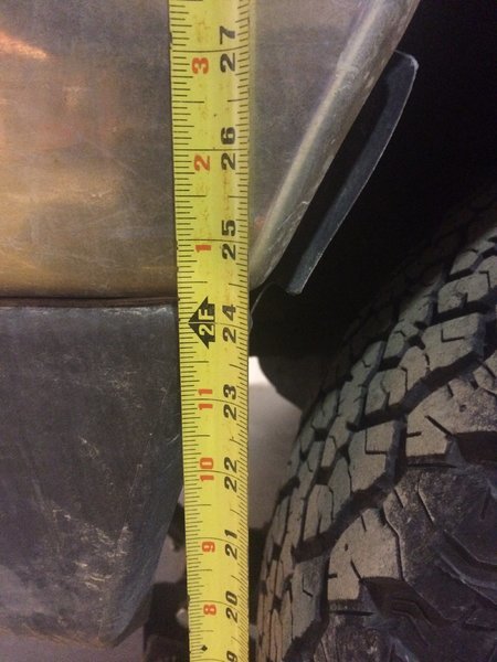

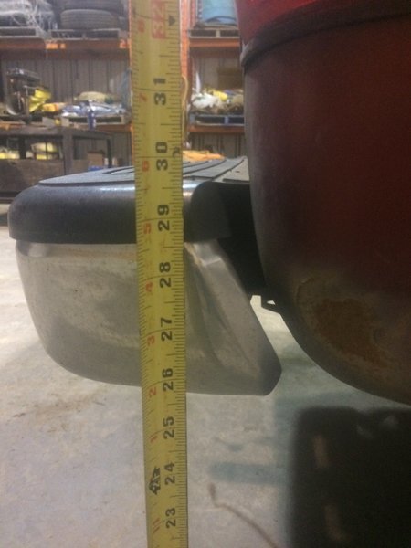

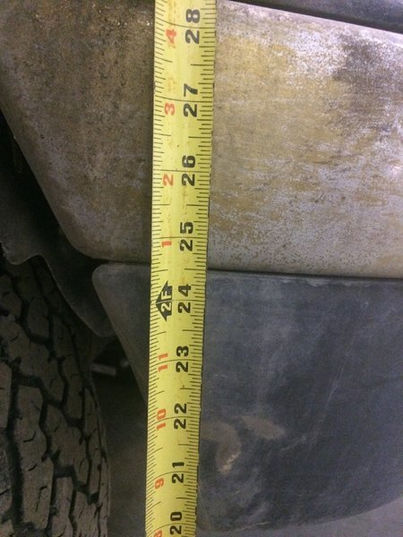

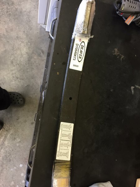

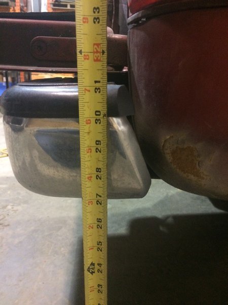

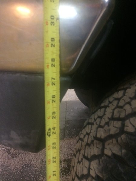

    IMG_5509.jpg Had a flat over the weekend :( put a temporary repair in it rope plug. Took it to a tire shop this morning to get it fixed properly. Noticed my rear springs look rather straight .... they were new when the frame was replaced .....

    I think they are mostly flat for everyone lol mine are starting to curve on the wrong way tho... you may be good to find a overload for it? Or maybe get them recurved?
