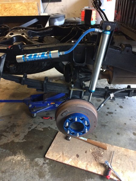

    Stock wheels and tires still had a little up travel left but my jack was fully extended
  6. Dec 22, 2016 at 11:33 AM
    #46
    Goobersbro
    Goobersbro [OP] Well-Known Member
    Oct 9, 2015
    #166262
    1,899
    Jon
    North of Sacramento
    2015 dcsb o.r
    Locker anytime mod Pelfrey armor Warn recovery
    Both sides are burned in, ruff stuff resivor mounts are burned in and paint is drying! I'll do the brake lines in the morning and then the rear end will be done for a while.

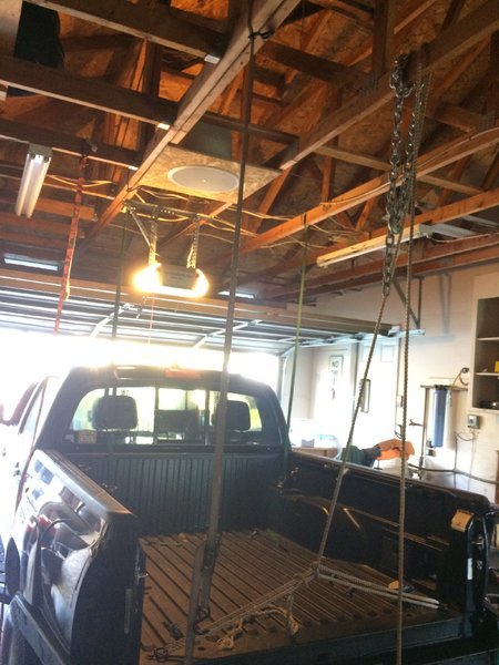

    Getting the bed back on to check clearance by myself was quite fun this morning IMG_3554.jpg

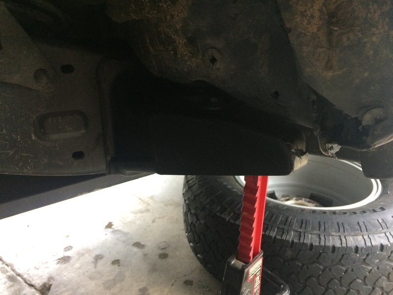

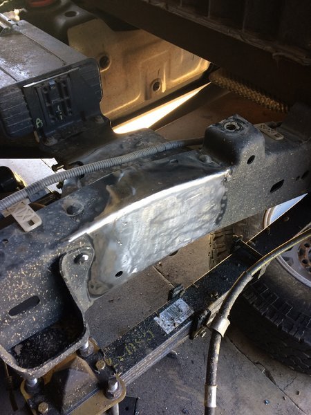

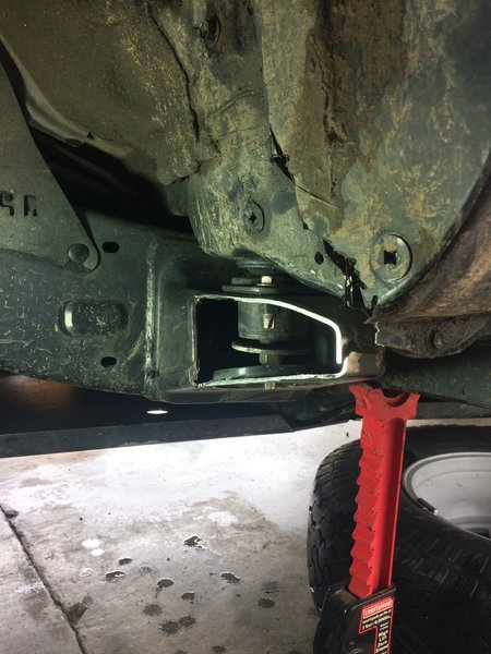

    Took the bed back off today to finish painting the towers, and install the longer brake lines. All in all very happy with how everything turned out. I also installed my spidertrax 1.25" wheel spacers today as I'm getting new tires thrown on tomorrow. Also in preparation for new tires I did the cab mount chop.

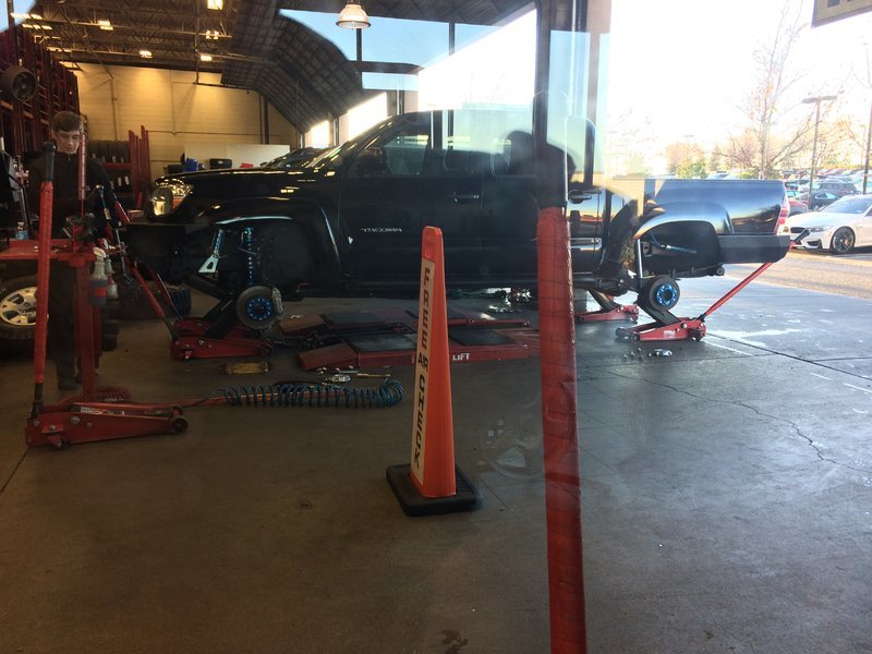

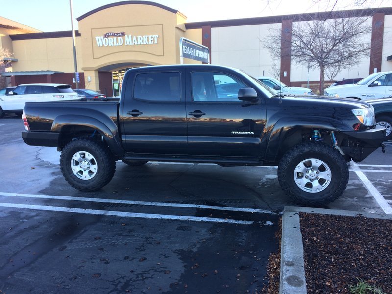

    So this happened today. 285/75/15 wrangler mtrs installed

    Thanks guys. Yea the stock mounts were a pita to remove. Just took my time with a cut off wheel and when I felt it was close I hit it with a hammer and they fell off. Then just took an aggressive polishing wheel to the remaining weld and walah

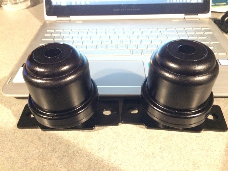

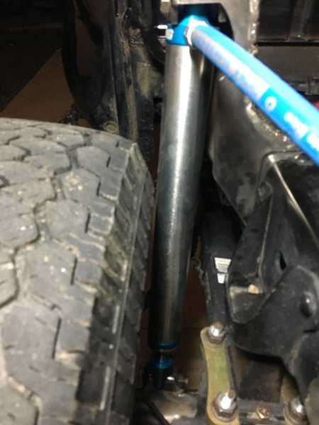

    Was supposed to go snow wheeling tomorrow but after an 80 hour work week I'm just going to relax around home. Maybe install these though :D they showed up early this week. These should be much better than the stock bumps for some of those faster hits IMG_3732.jpg

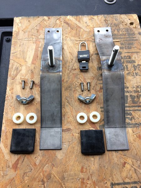

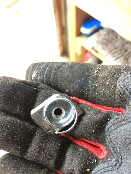

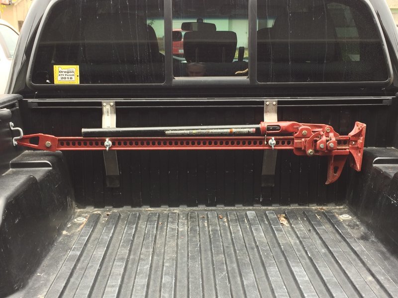

    Decided I need to make some mounts for the hi lift. Cost me around $30 in material including the lock.
    Bent it all in a bench mounted vise. Just made a simple 4 point saddle using 30 degree angles the bottom extends an additional 1/2" to account for the thickness of the bed rail

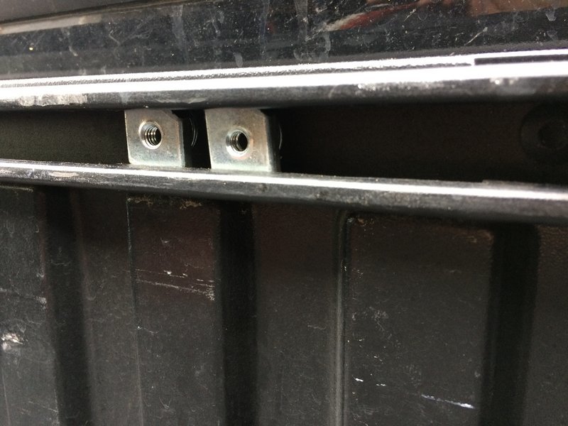

    Then drilled out the holes and modified some 1/4" spring nuts to fit
    Also got two rubber sleeves for putting over the bottom of the mounts as they just rest against the bed
    Rough test fit
    Still need to weld the bolts to the back, drill the bolt for a lock and paint everything

    Welded up and drilled. Ready for paint. I am using plastic sleeves instead of nuts to space the jack off the mount as well as space the wing nut. Here is a shot of all the misc pieces except the spring nuts.
