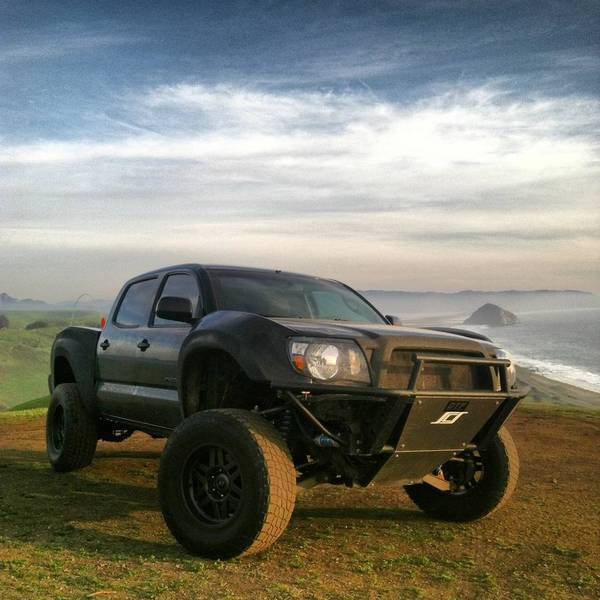

    HOW SHE IS SITTING NOW

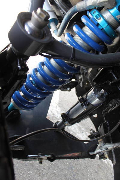

    Front Suspension
    DTF Race Kit 18" Travel (Bumped/Strapped)
    -Black Powder Coat
    -Fabbed Spindle
    -Boxed Uppers
    -Double Sheered Steering
    -Solid Mounted Lowers
    -TRAC LCA Gussets
    -Heim Steering
    -Heim UCA's
    -Derlin Bushings
    -Total Chaos Coil Bucket Gussets
    -Dual Limit Straps
    -ARP Lug Studs
    -Extended Brake Lines
    SAW 2.5x10" Coilovers Dualrate
    SAW 2.5x10" Secondary Piggyback Shock
    Fox 2.0x2.5" Hydro Bumps w/ Polly Performance Cans

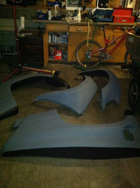

    Fiberglass Install Help From Cayucostacoma

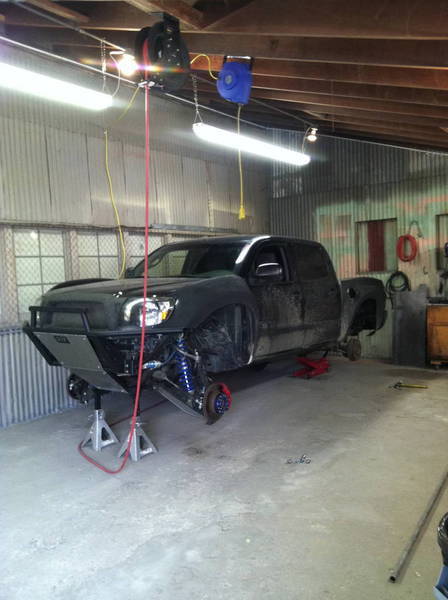

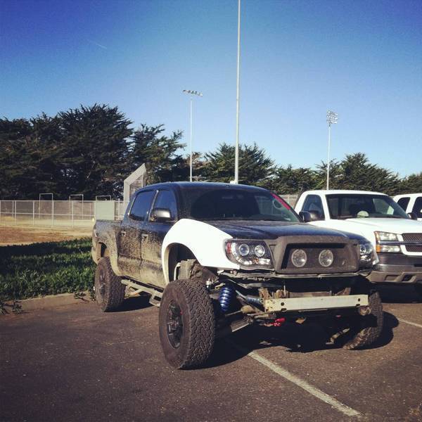

    New Years Pismo Run

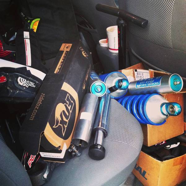

    Comparing Shocks
    Took Some Random Instagram Pics haha

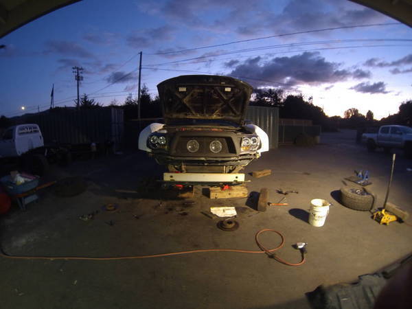

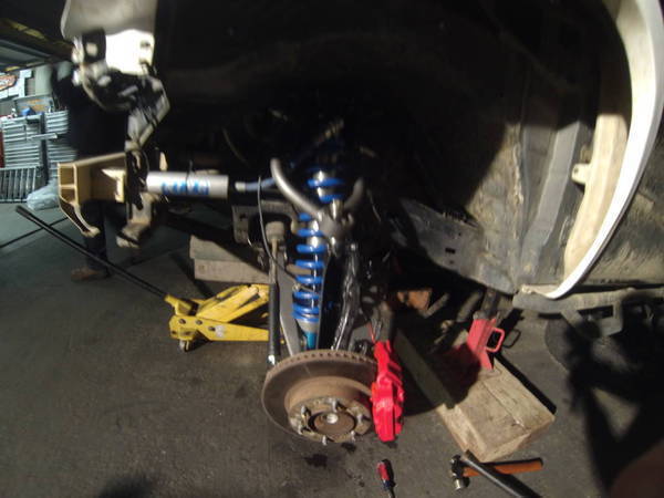

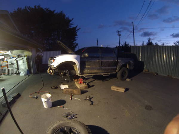

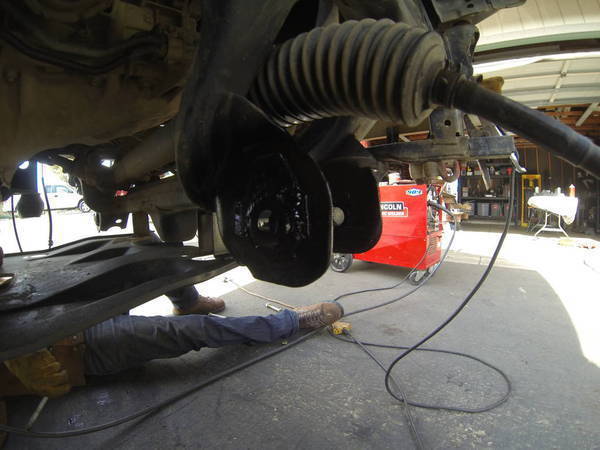

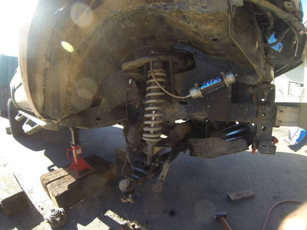

    Day One Of The Engage Kit Install Took Pics With My Hero 3
    & My Buddies Old Toyota He's Building Up

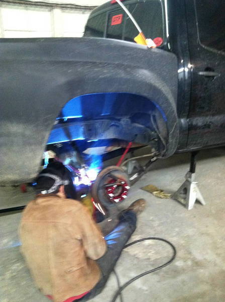

    Photos From Day 2 Of The Install! Special Thanks To Anthony(DTFtacoma)

    Anthony (DTF) Made Sure To Take Good Care Of Her & Fix Her Up!

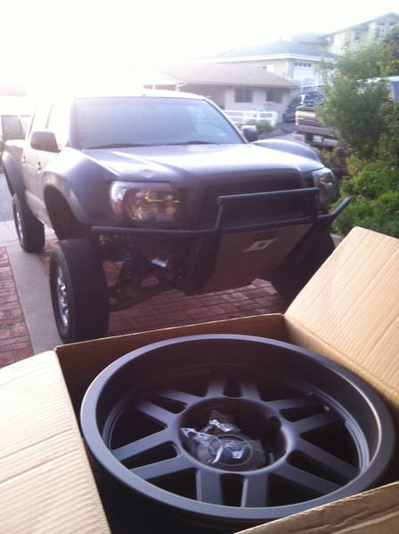

    Got Her Back And Threw The New Wheels On With The Fresh DS

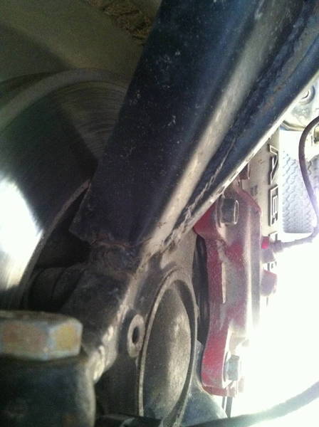

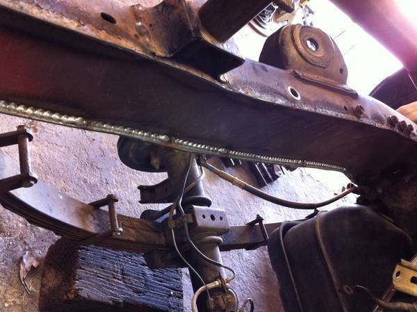

    FIXED With Some Steel

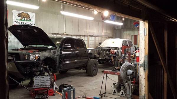

    Dropped Her Off At DTF Two Weeks Ago ;)
    So I Also Took Off All The Glass To Get It A Real Paint Job Primed & Sent To Paint

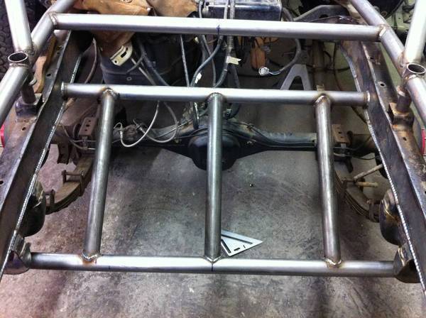

    Anthony's Fab Work :eek:

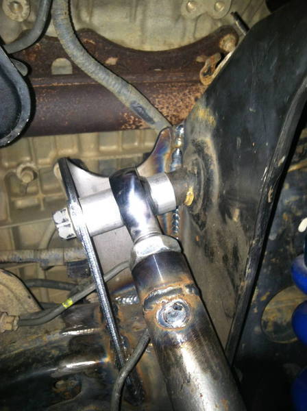

    Fixed The Alignment Issue With New Bungs For The UCA's

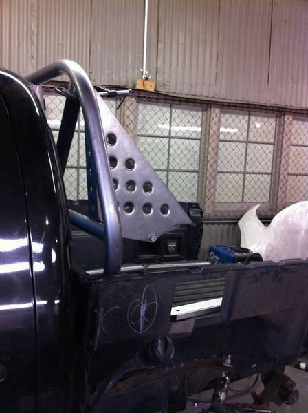

    Tire Carrier & Frame Box
    The Night Before Powdercoat...Longggg Night lol

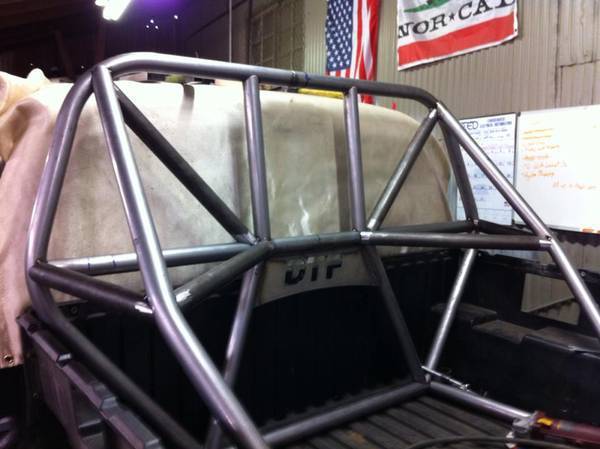

    Going To Be My Flip Up Light Bar When I Get It Back From Paint

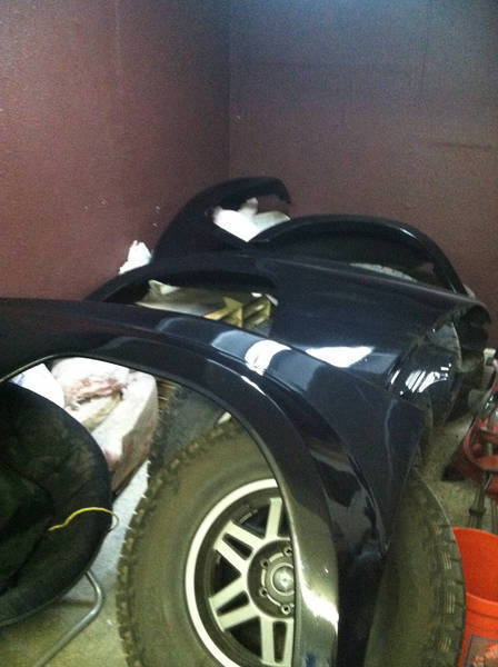

    Macco Exceeded My Expectations On The Fenders

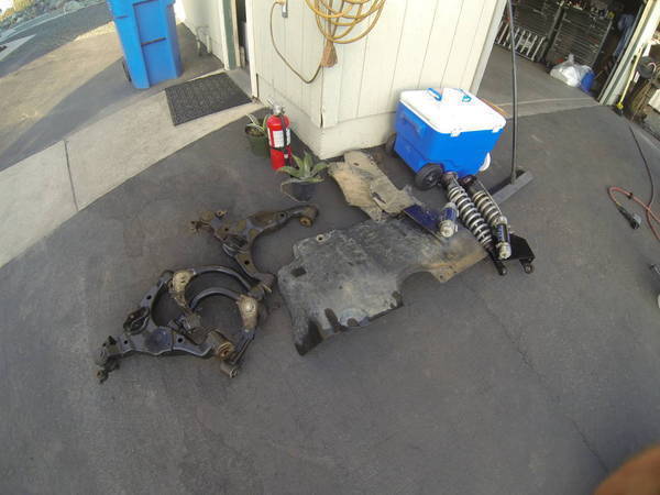

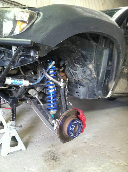

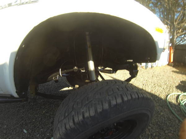

    Swapped spindles with my little brother today and took some pics with my hero3 during the process, hoping to finish it tomarow :D
