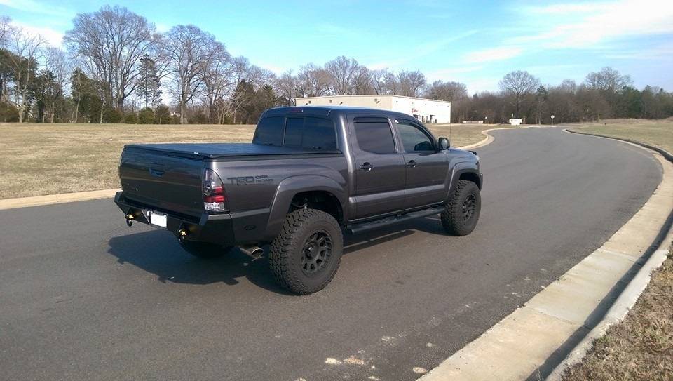

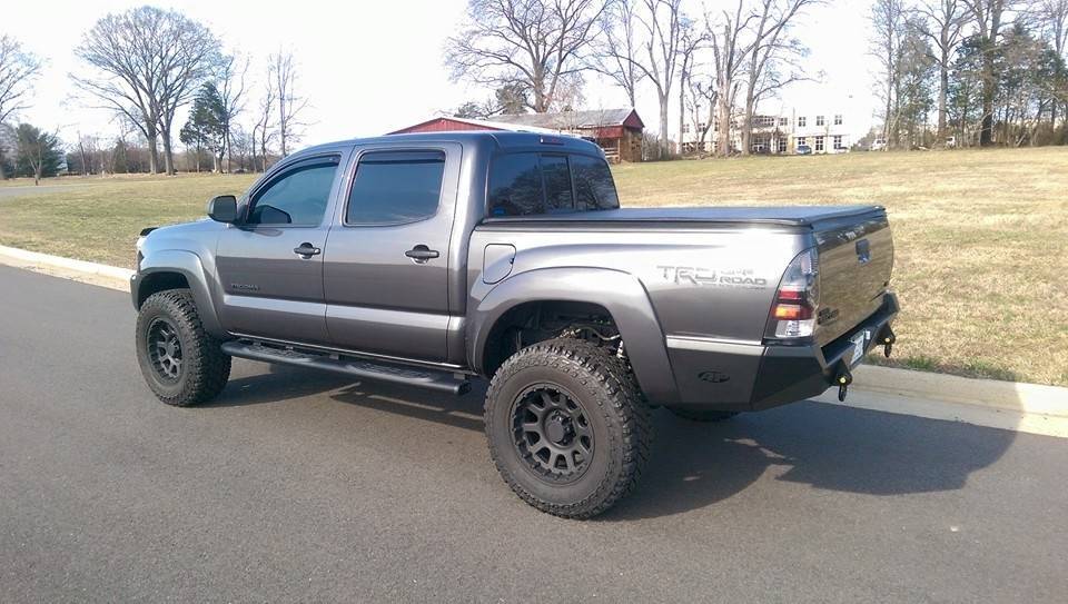

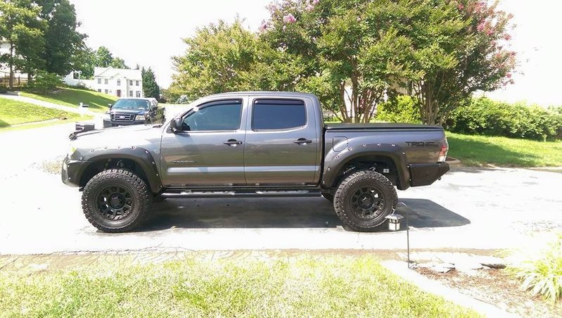

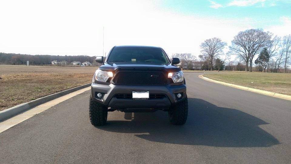

    Some stuff...

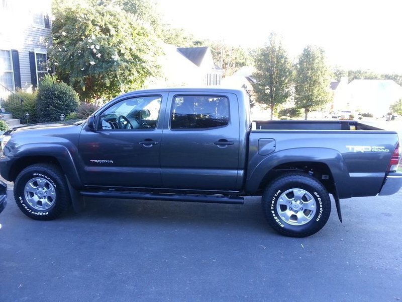

    2013 Toyota Tacoma Off Road, Double Cab Short Bed (Manual Transmission) Magnetic Gray Metallic
    Then (September 2013, Bone-stock - Ordered with TRD Short Throw shifter, TRD Cat-Back exhaust, Toyota bug deflector and black tube steps.)

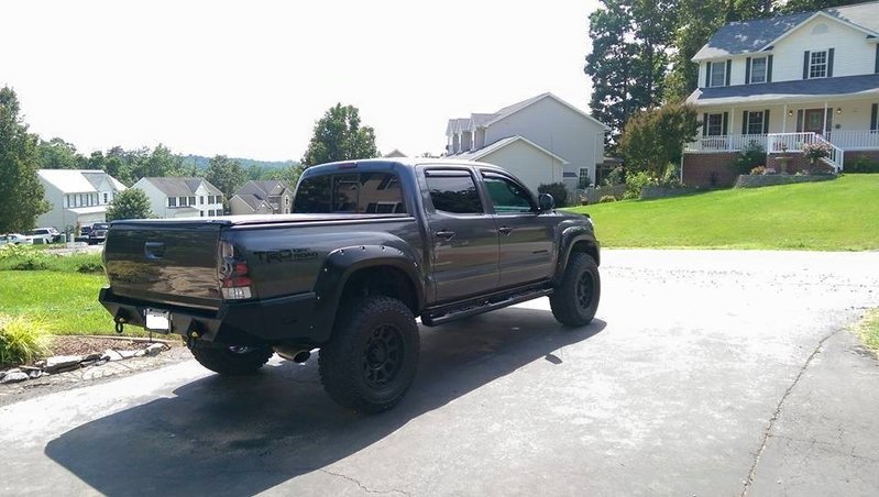

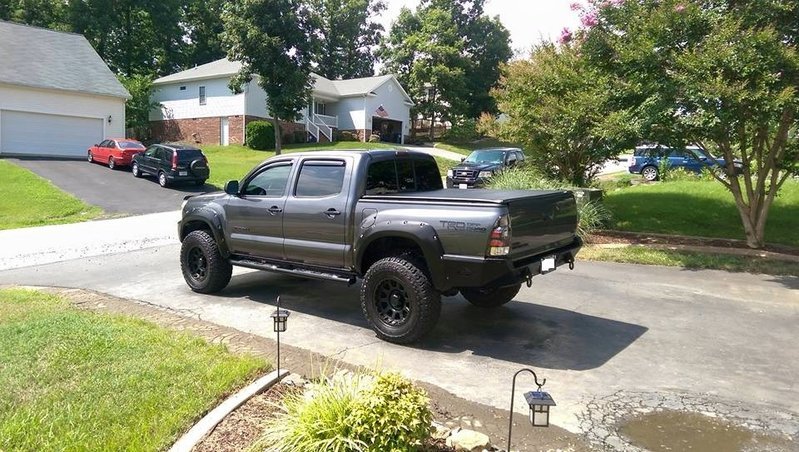

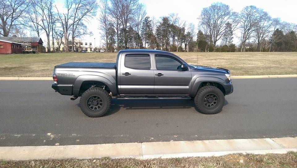

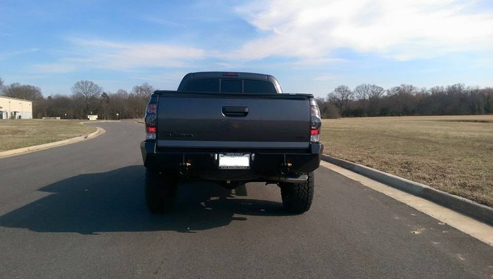

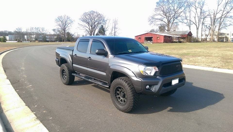

    And now (Complete mods listed below.)
    Mods
    -Magnuson Supercharger (w/ BullyDog tuner/flash - no issues)
    -URD SuperGrip 2.85 SC pulley
    -aFe Stage 2 intake
    -TRD cat back exhaust
    -TRD short throw shifter
    -SpeedHut Boost & AFR gauges (w/ AEM compatible Bosch Wideband Sensor)
    -ICON Stage 4 remote-reservoir coilovers (set to 3")
    -ICON Uniball UCAs
    -Dakar rear leaf pack (w/ adda-leaf, hence high-ass-end-stance)
    -ProComp 7032 17" wheels
    -Cooper Discoverer ST Maxx 285/70/17 (removed worthless OEM mud flaps)
    -All-Pro steel plate rear bumper w/ hidden hitch & side protectors
    -ATO front IFS skid (1/4")
    -UltraGauge
    -Black rear LED tails
    -Custom Satoshi TRD grill
    -Bushwacker pocket fender flares
    -LC Engineering Pro Clutch kit, heavy-duty 40lb flywheel and upgraded throw out bearing
    -Tint (30% front windows, 20% back side & rear window)
    -Toyota bug deflector
    -Toyota black tube steps
    -EGR in-channel visors
    -Aries floor mats (ditched WeatherTechs due to curling issues)
    -Locking gas cap
    -Oil catch can
    -Rear diff breather relocation mod
    -Cab mount chop
    -Extended length braided brake lines
    -Black TRD Off Road decals
    -Blacked-out emblems
    -Carbon fiber TRD 3rd brake cover
    -TonneauMax Tonneau cover
    -JDM ASTAR 800 lumen LED reverse bulbs
    -Dash-Cam (Crosstour 1080P FHD Front and Rear Dual Lens Dash Cam in Car Camera Recorder, External GPS, HDR Both 170°Wide Angel Sony Sensor Motion Detection)
    -Smoked LED Projector Headlights
    -Pop & Lock PL8540 Power Tailgate Lock

    WOW what a great build. I really like that All pro bumper. I need to look into that. Very good looking truck. Looking forward to seeing future mods as i have a MGM DSCB TRD off road as well.

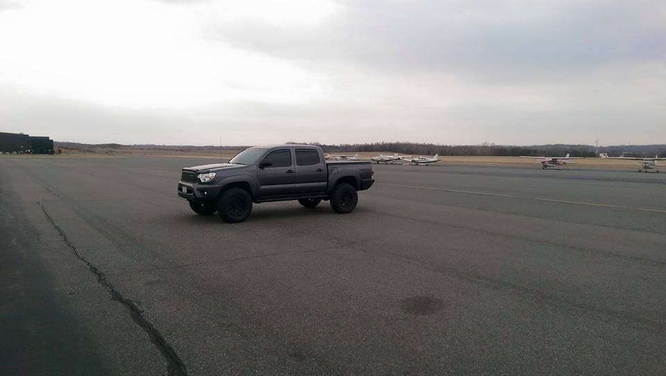

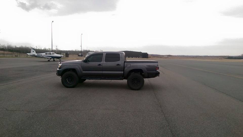

    Snapped a few pics while working at the airport today, just because. :D

    I really like that rear bumper!

    Clean truck!
    Do you like the combo of the lift and your new tires?
    Pretty much same size I was going to go w/ and the Dakars in the rear.

    Thanks, Man. I left the overload leaf in the Dakars so as you can see the ass-end sits a bit higher than the front. I personally like the slight rake look. I do like the lift/tire/wheel combo a lot, but I did have to CMC and do some trimming. Plus I had a noticeable loss in power so I'm debating on gears now (or S/C:D). Other than that I'm really happy with the setup.
