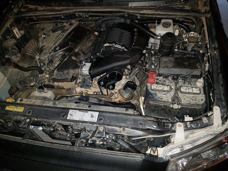

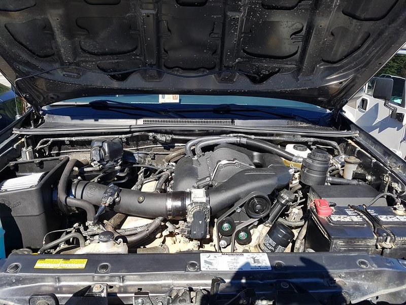

    Engine bay is dirty & looks like crap but that's on me. Supercharger is on - huge thanks & accolades to @DOUBLLD. Saw his shop & handywork - the Dude has major skills & comes highly recommended! :thumbsup::cheers:

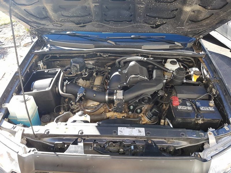

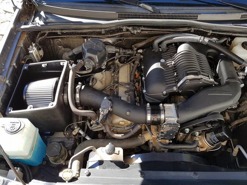

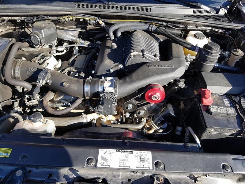

    Cleaned up the engine bay a lil. Will post more pics once aFe intake is installed soon.

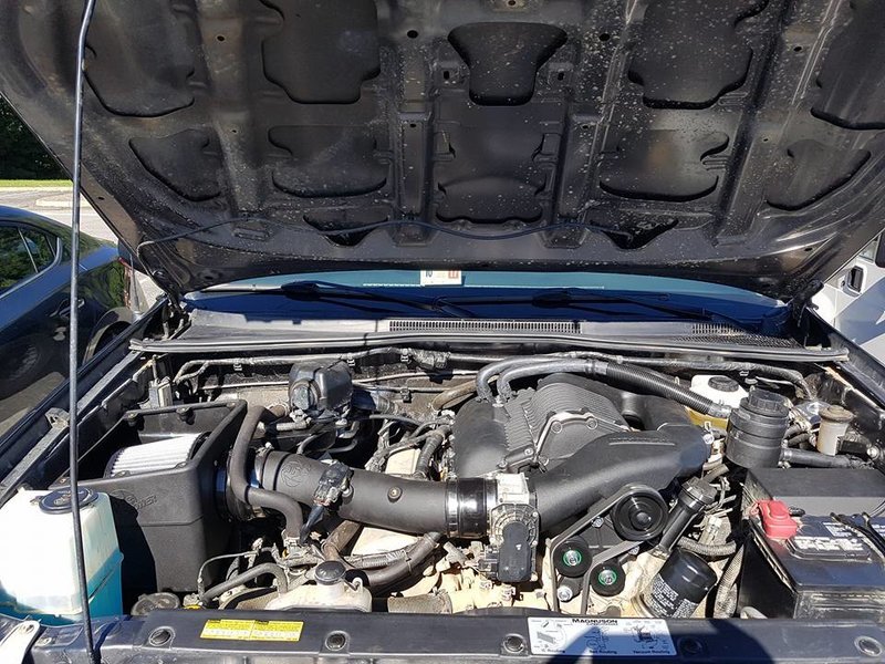

    aFe intake is on! Not a bad install, instructions are very good and it took about an hour start-to-finish.
    The supercharger whine is MUCH louder now over stock and it seems a lot more responsive. Very happy with this setup - might go with the URD 2.85 pulley next, we'll see.

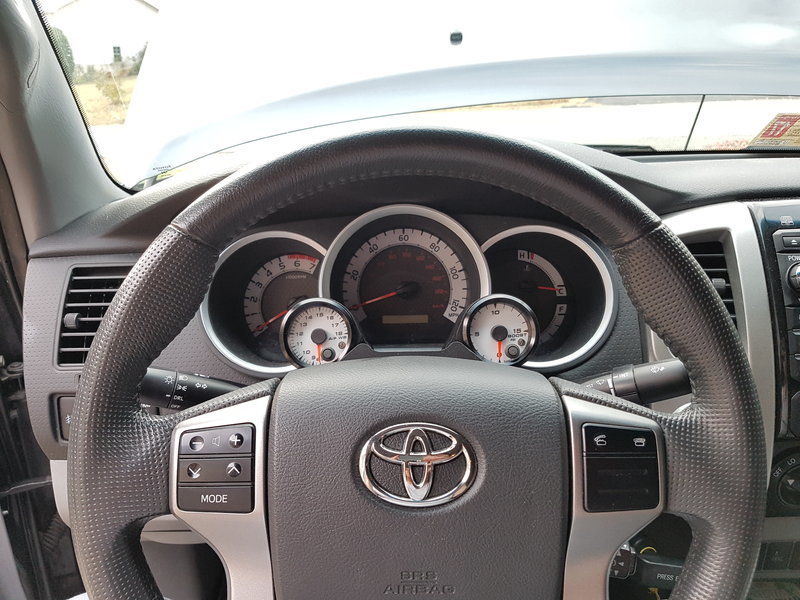

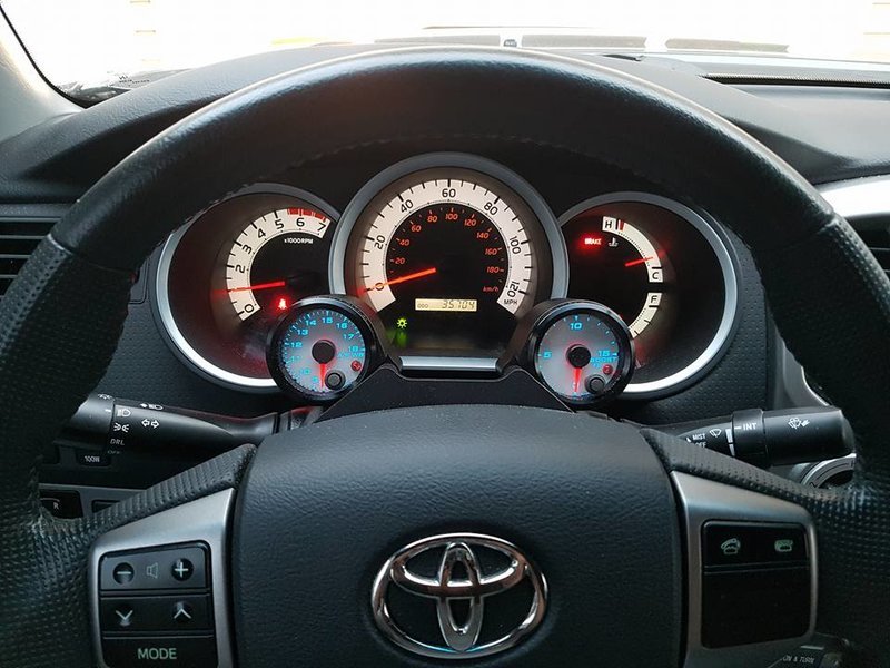

    Installed Speedhut AFR and Boost gauges a while back but haven't had time to update my build thread. I have pics of the install process - just need to do a write up when I have time.

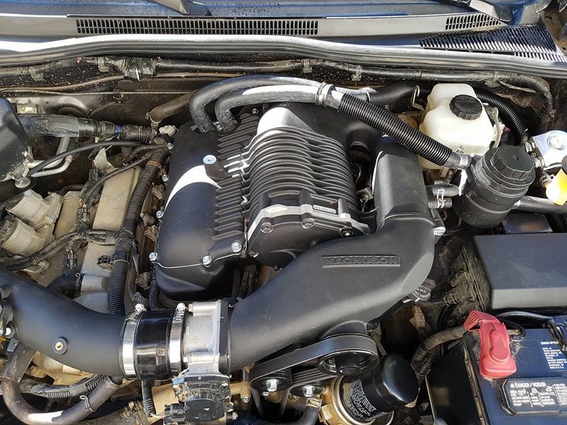

    Installed URD 2.85 SuperGrip pulley.
    [​IMG] [​IMG]
    Pulley install was a breeze. I followed the enclosed URD instructions to the letter as well as the write-up and tips below from @extremachn1.
    A few observations:
    -I figured doing this install on a cold day like today (high 30's and low 40's) would be a good call. Removing the old pulley and getting the new one on was easier than I thought it was going to be. Not sure if that was the cold or what.
    -AutoZone loans/rents 3 jaw pulley pullers. The one I rented worked great. I also picked up a rubber strap wrench set for $16 which is essential.
    -Take your time and follow the instructions - it took me an hour or so.
    -My regular 1/2 ratchet gave me a hard time loosening the tensioner – I couldn’t get leverage, so I used my breaker bar instead. The extra length made a world of difference.
    -Definitely makes a noticeable difference. The power band spins up a little quicker on the low end, and overall it seems “punchier”.
    :burnrubber:
    https://www.tacomaworld.com/threads/urd-2-8-s-c-pulley-install.175599/
    Well I finally broke down and installed my URD 2.8" S/C pulley after striking out on finding a place to do it for me and I am glad I did it. I was worried about doing it myself and screwed it up I am shit outta luck with fixing it. But I figured if I am a field engineer for a 24 foot tall $22 million robotic weapon system then I can handle this with the right tools. So with the URD press in hand, a set of 3 jaw pulley pullers, and the URD instructions I went forth and here are my instructions and what I found...
    1) Let truck cool overnight (VERY IMPORTANT, it will help a lot is all the engine components are cold.
    2) Remove skid plate(Optional depending on skidplate). I have the Allpro skids and was able to get to my tensioner front under the driver side without removing my plate.
    3) From under the truck, put 1/2 socket drive into tensioner. It is an aluminum colored mount- turn clockwise. I used a 1/2" ratchet.
    4) While keeping pressure on the wrench remove belt from the supercharger pulley. I used a block of wood to keep the wrench in it place.
    5) Install bolt into supercharger snout to keep from damaging threads with puller.
    6) Install puller centered in the bolt and use a strap wrench/oil filter wrench to hold the pulley and keep from spinning.
    7) Begin turning puller nut (will be tough at first but once the pulley starts moving it will begin to get easier. Use strap wrench to keep pulley from turning. Keep going until pulley pops off the supercharger snout.
    8) Put replacement S/C pulley in a pan of boiling water and let heat up.
    9) If using URD press tool follow instruction, if using a comercial press tool follow those instructions. My reccomendation is to use the URD press too, its simple and easy to use. Important, once you begin pressing on the new heated pulley, try to go as fast as possible once its going on straight. Its gets significantly harder once the heat spreads to the S/C snout and it begins to expand as well. It can be done, jsut gets harder. Once you start pressing on the pulley, do not stop until all the way on. The Pulley should sit flush with the end of the S/C snout just as the last one did.
    10) Once pulley is on and press tool removed, re-install the s/c drive belt. Double check the entire belt. My lower section had popped off a lower pulley but the tention looked correct, I would have shredded my belt at the least if I had cranked my engine so double check your belt.
    11) Start engine and ENJOY...
    Thats my write up on how to do it. It really is that simple. Here is what I have noticed...
    The power band feels PERFECT now. More power down low and feels like it pulls harder longer when giving it the beans. Because of the increased boost it now feels like even at partial throttle the power comes on sooner and smoother and the engine seems to respond so much better to having this pulley on it. Is it possible the engine was running a bit rich with the TRD tune and intake I had, now it seems to be running just right. I was getting about 22 mpg running around town today. All in all I am VERY happy with the pulley's performance I am just bummed I waiting this long to install it.
