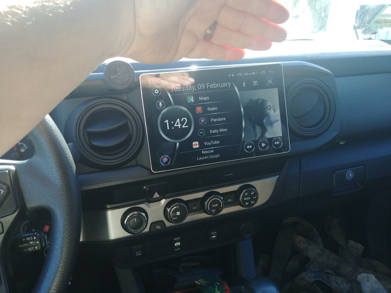

    Here is a pic of the 10.1 head unit installed in my SR 2019. Very happy with this unit so far

    That looks great. Are you going to share your background specifics too? Mostly the player/overlay that I see on the right. :D

    It's just Car Launcher (free version) and then I downloaded the "Leather Theme"

    It's certainly come a long way since the first time I used it years ago. I ended up building my own but that player/overlay would certainly be tricky. I wonder what this looks like in a 2nd gen considering the clock is below.
