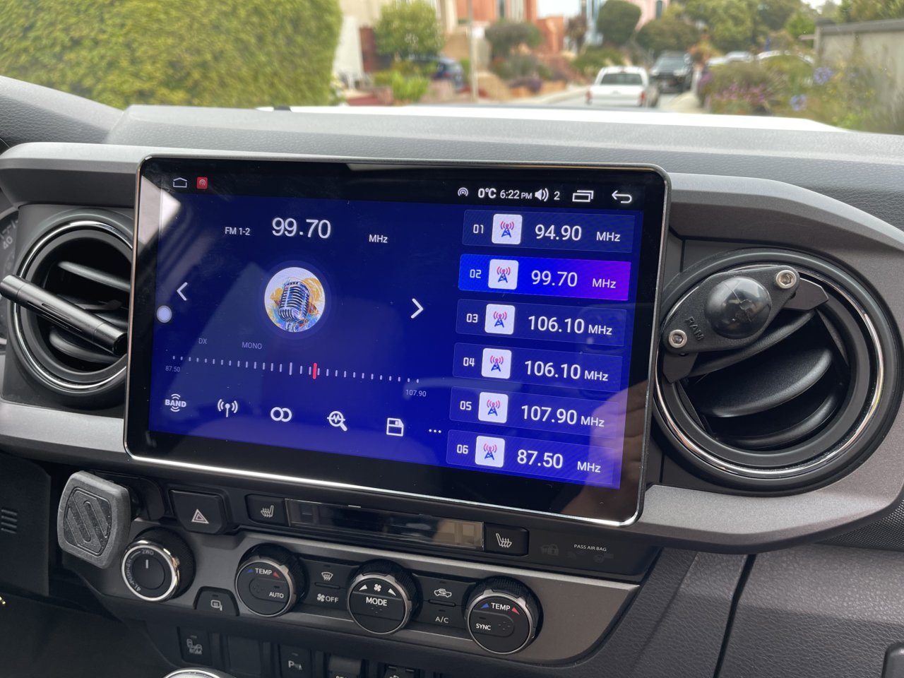

    I got this 3-4 months ago and don't regret it. FYI, i was able to use the oem antenna. You would have to buy 2 more connectors to make the oem antenna work so you don't have that extra gps module sticking out of your dash. Let me know if you want more info on the 2 item required.
    pic is my 10.5 screen size compared to the 10.1.

    Wow, is this a Tesla?! Kidding aside, looks awesome and is a much needed improvement vs. the small stock screen.

    It’s actually a big improvement than the entune junk!

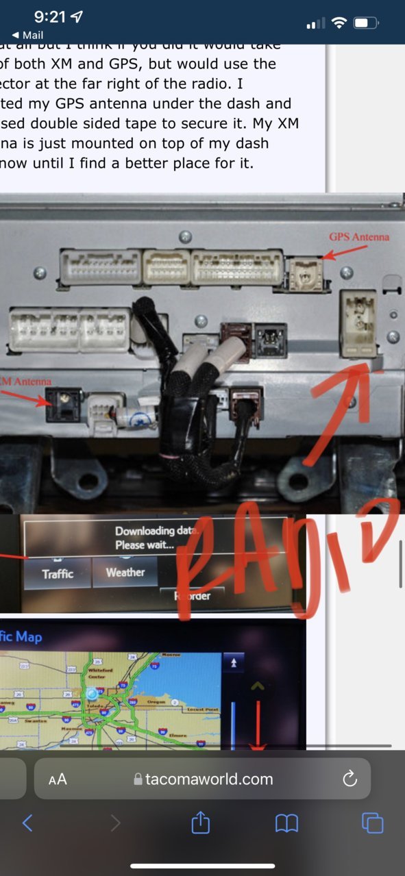

    Antenna is only for nav on the head unit or for radio reception too? I want to retain all possible factory equipment.

    Antenna is separate from gps. Radio is a silver type plug and gps is a screw in similar to the xm radio.
    gps, xm radio and radio antenna are all different. They give you an adapter for the radio to fit right in.

    So the radio antenna is included in harness from joying that you buy in addition to the radio and the gps is a separate harness I also need to purchase?

    All harness will be included nothing additional.
