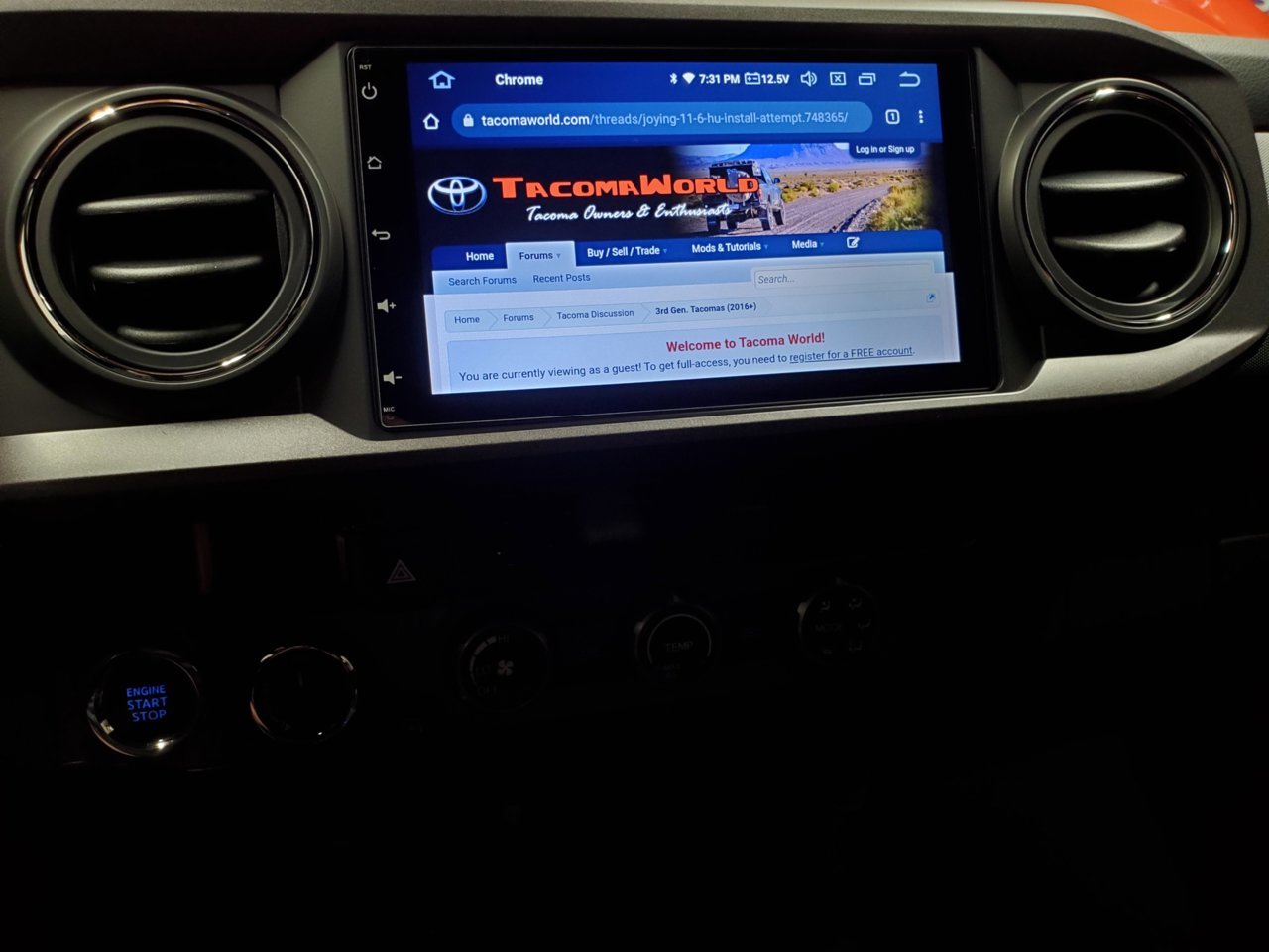

    How do u like it?

    After the first one being, for all intents and purposes, an out of the box brick, I'm worried about long term reliability.
    That said, it's replacement has been trouble free and I'd like nothing more than for it to continue to be. I just don't have any complaints worth complaining about. Come what may, and despite the fact I have the stock HU in a closet, there's no path back to OEM for me.

    What size is this one?

    It's sold as a 9 inch, but the screen in it's entirety actually measures 10 inches, diagonally.
    Ergo, it uses a 10" screen protector.

    Install mostly plug n play? does it work with the germes lab anytime cam? Is it laggy? Like click on something and it thinks for a bit then goes?
    Sorry for hijack op
