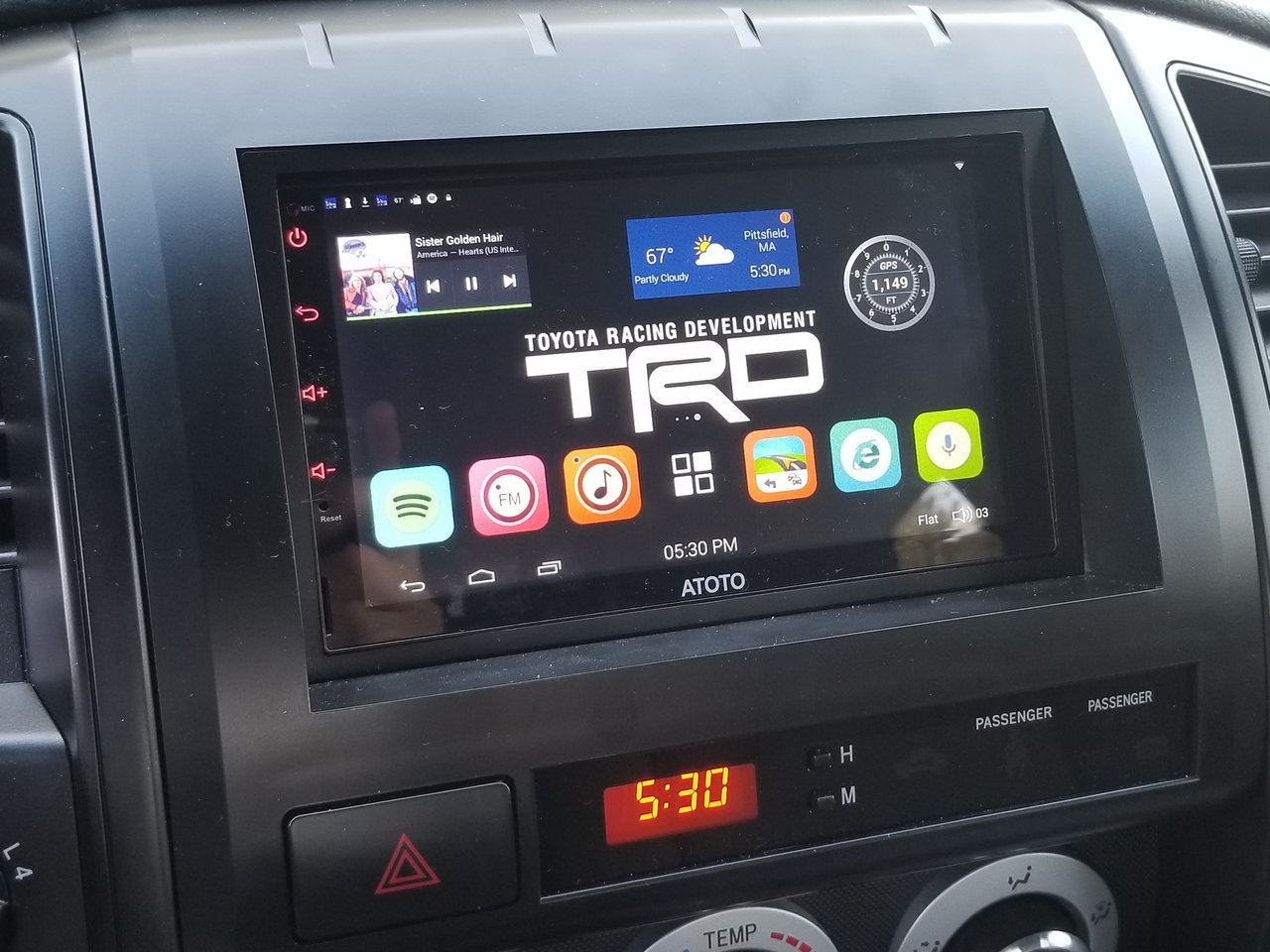

    yep..
    I have an ATOTO android head unit. Couple apps that I have found very useful
    HERE wego or Sygic - offline gps apps that let you pre download maps of states or whole US
    Gaia - off-road gps app with topography, elevation, breadcrumbs, the list goes on
    Spotify is great on these as you can download your playlists to the HD. I use the spotify widget for quick access

    yep..
    I tried to hook my OEM camera to my ATOTO android head unit (very similar to the joying) and I just ended up buying a separate camera on Amazon. The head unit requires coax in for the video and a reverse trigger wire to let it know when you shift into reverse. You would have to find which 2 wires in the OEM camera harness that are the video signal and shield, then solder them to a video coax cable to plug into the radio, along with the reverse trigger wire (found this up behind the glove box).
