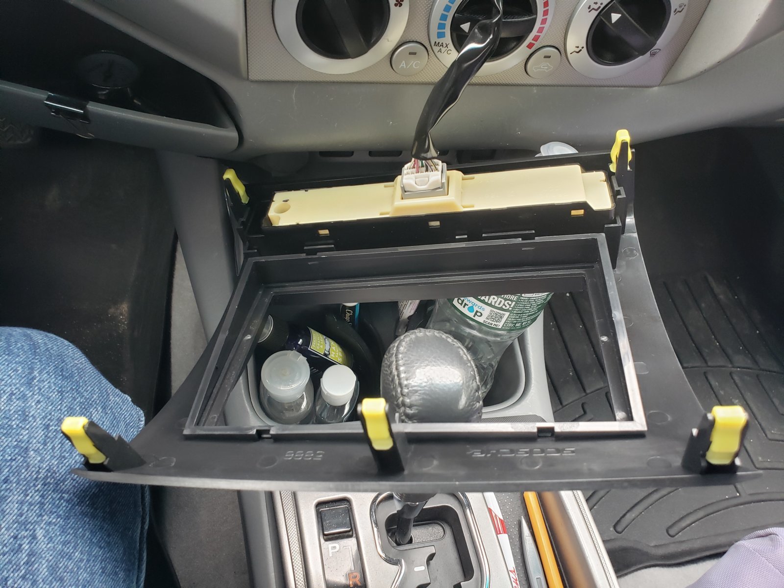

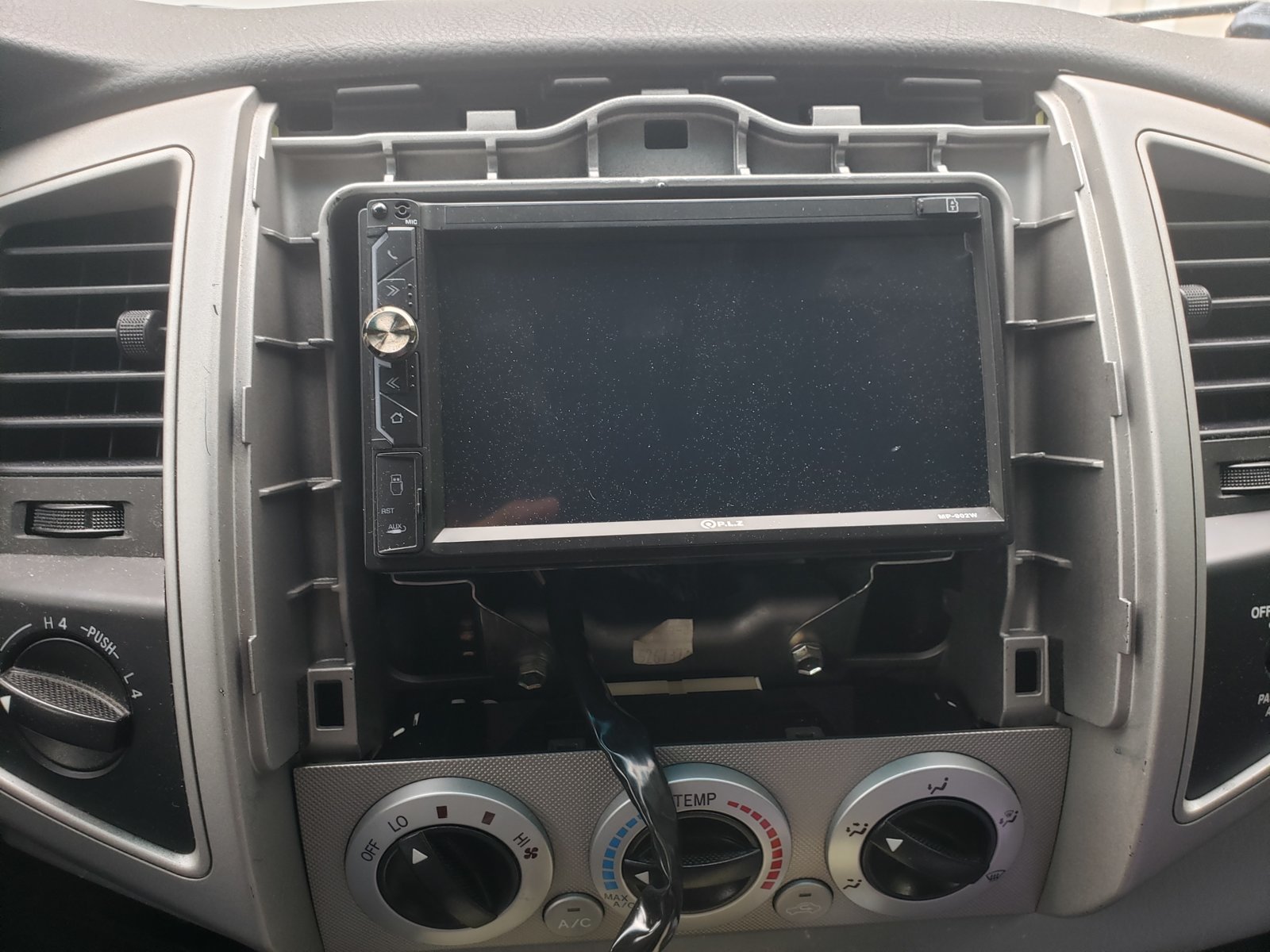

    I installed a PLZ 902W headunit in my '09 back in January of 2024. I did not want my dashboard to look like a Tesla, and I wanted a unit with a volume knob. I also wanted a unit that would work with the steering wheel controls. One year later, I still LOVE it.
    Look at my older posts for info on an updated PLZ unit that has a QLED screen.
    The cost of the install, including the headunit, bezel and plug & play harnesseS (there are three) is <$200.
    I had initially planned to paint the Scoche bezel with aluminum (color) paint, but I decided that I like the flat black better. The Scoche dash kit has 3 plastic pieces:
    • radio bezel
    • left bracket
    • right bracket
    I did not use the plastic brackets, but used the OEM steel brackets.
    The radio bezel is pretty self explanatory.
    You must remove the yellow clips and the Hazard Switch / clock / airbag indicator assembly from your OEM bezel, and reuse them in the Metra bezel.
    Here are some pictures of my installation;[​IMG] [​IMG]
