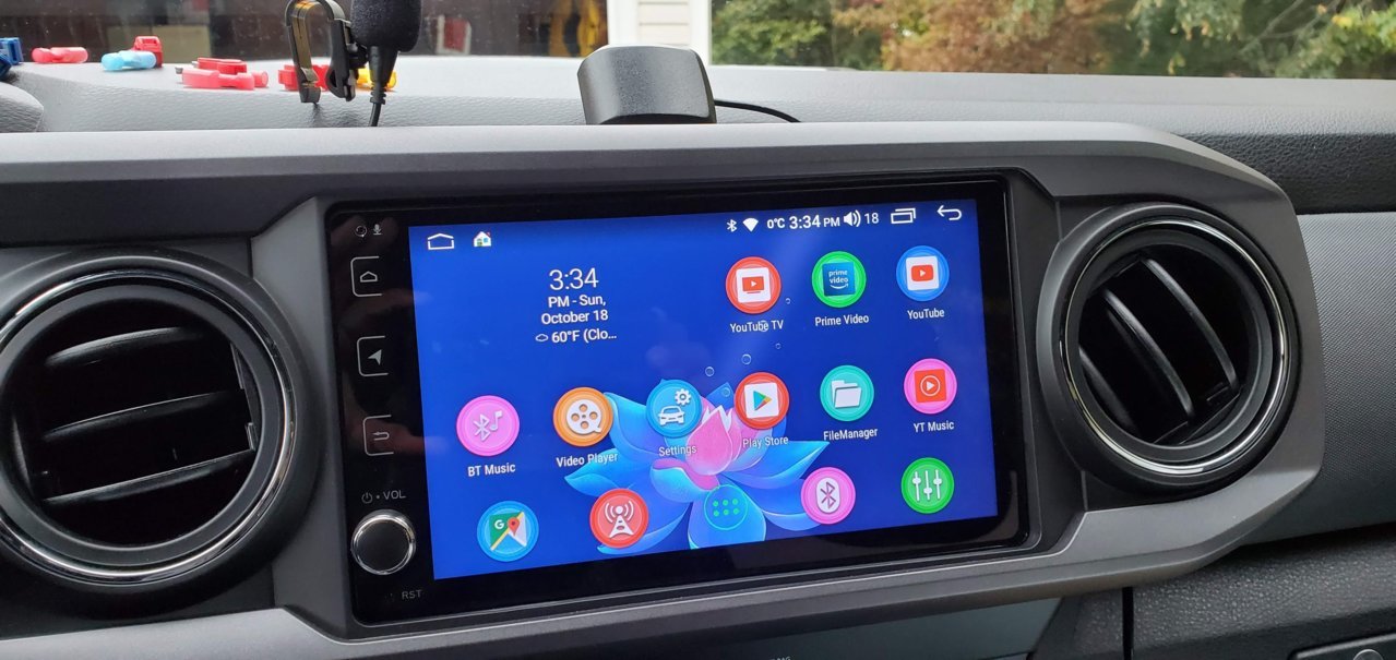

    I just installed this same unit in my JBL equipped pro and I found it to be pretty plug and play. Although I have an issue with it not being loud enough... I have to check to see if it is actually turning the amp on but my sub seems to work. Just not as loud even at max volume ‍♂️

    Turns out it was the wrong Canbus settings in the radio. Finally it came alive but now I need to get the CarPlay phone volume to be the same as everything else...
