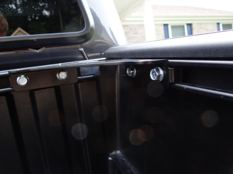

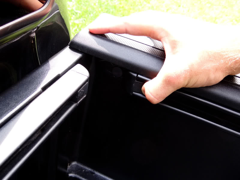

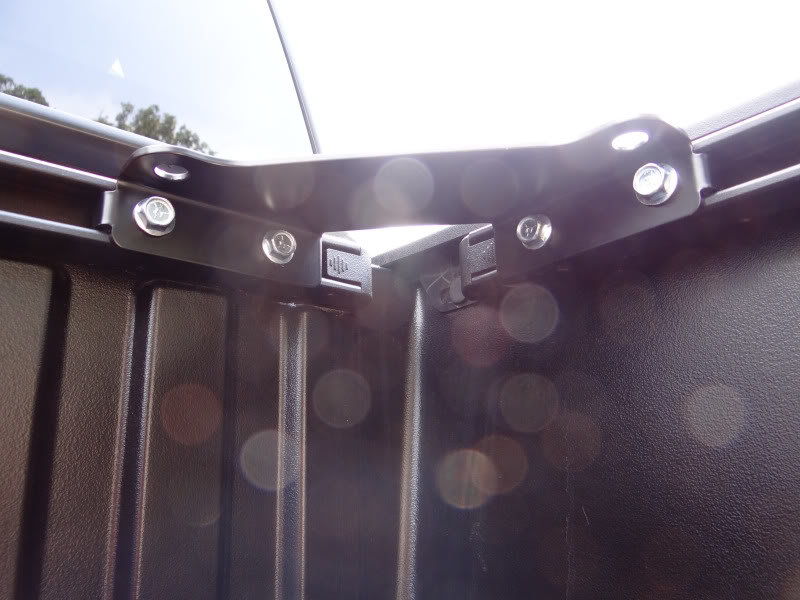

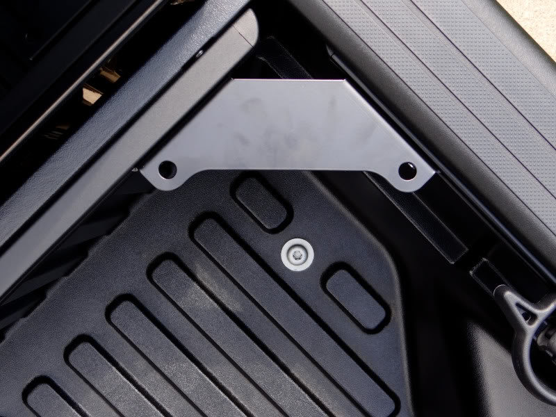

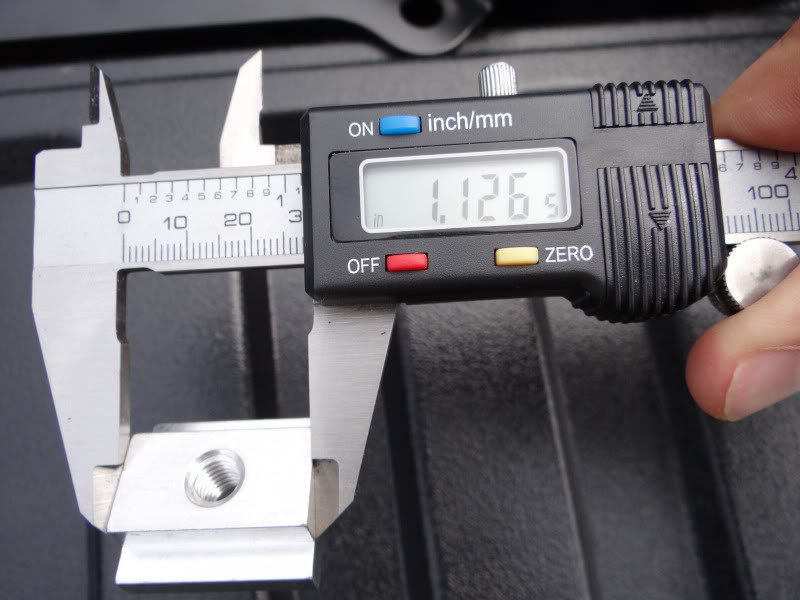

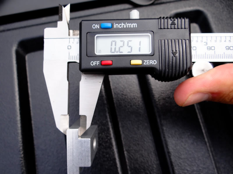

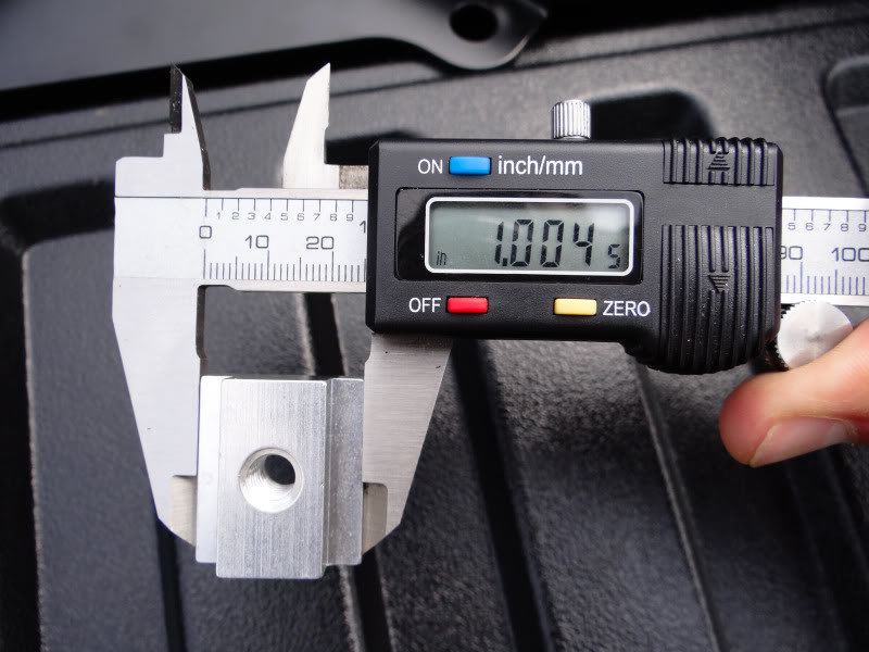

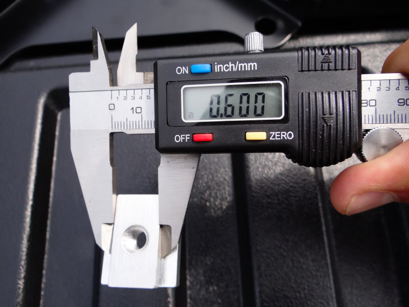

    The installation is EXTREMELY simple. This is more of an informational guide with lots of picture to know what your getting when you decide to order the Hook-Ups.

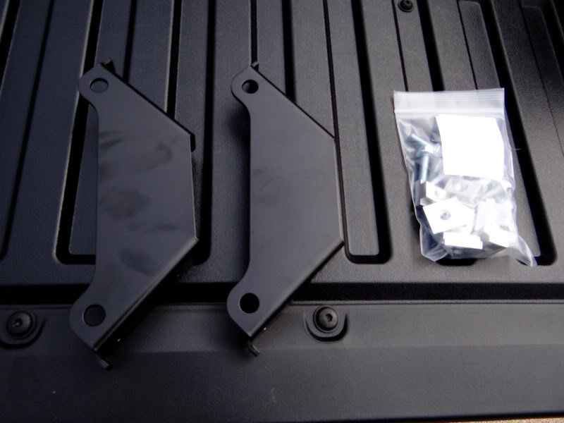

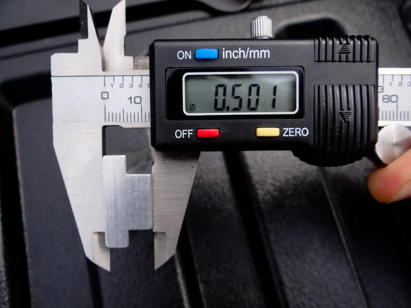

    The brackets, bolts (1/2" head) and Aluminum Tee Nuts are all very high quality. Powder coat was well done (Although it would be nice to have a choice of color). Once tightened down, the brackets look stock.
    Product Link: http://jpmetalfab.com/products.html
    Kit Includes: (2) 10 GA. Powder Coated Stainless Steel Brackets,(8) Billet Aluminum Tee Nuts, (8) Bolts
