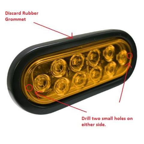

    exactly what part number for the LED front turn signal/marker lights? Not an electrician here but what mods did you have to do to make them work on the ARB bumper? any pics to go along with the wiring?

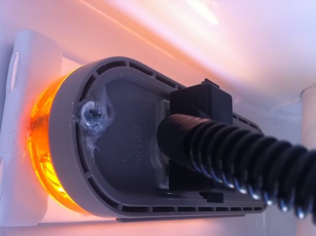

    As far as the LED lights, I wish now I had taken more pictures of how I did it at the time. I bought the lights at Northern Tool and Equipment, but I just looked online and found the same lights on walmart.com, and they are cheaper than what I paid. (I paid $18.99 each) BTW, the brand is Blazer if you can find them elsewhere. Also, just an FYI they are sold individually, so buy two. http://www.walmart.com/ip/Blazer-LED-Oval-Stop-Turn-and-Tail-Light-Kit-Amber/15111215
    Basically what I did was drill two small holes on either side of the light that matched up to the holes in the ARB bumper. The holes will be on the edge of the light, and you are only drilling through the plastic housing, none of the LED's or wiring will be affected by the hole. Then I used a little silicone and filled the holes on both the front and back and put in a screw and attached it to the bumper. The silicone set up with the screw in place and should keep them sealed up from moisture and dirt. As for wiring, I saved the pigtail from the original lights that came with the ARB so I could reuse the connector; I just wired these lights to that pigtail. It took a little trial and error as the wires were different colors and I didn't know which was which, but I got it. The lights are turn signals and can stay on as marker lights.
    EDIT: Heres a couple pics of the lights from the inside of the bumper, kind of gives you a better idea of how they are mounted.

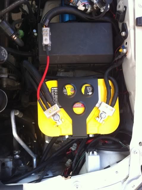

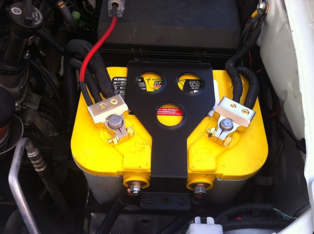

    Put in an Optima Yellow Top battery this weekend; and also cleaned up all the wiring while I was at it. I also picked up a steel optima battery holder off eBay, which works much better than the factory battery hold down, since the Optima is a little smaller than the factory battery.
