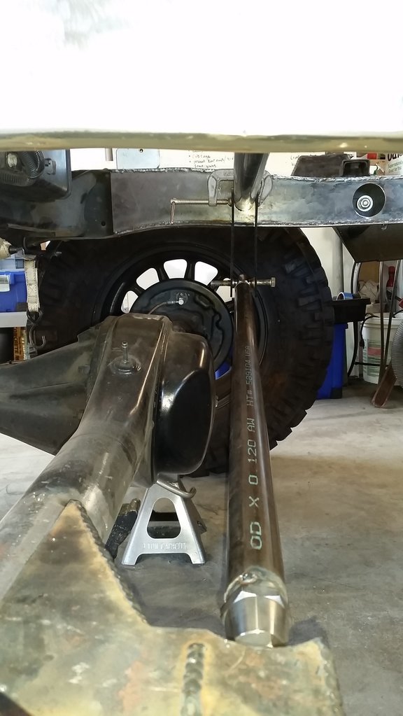

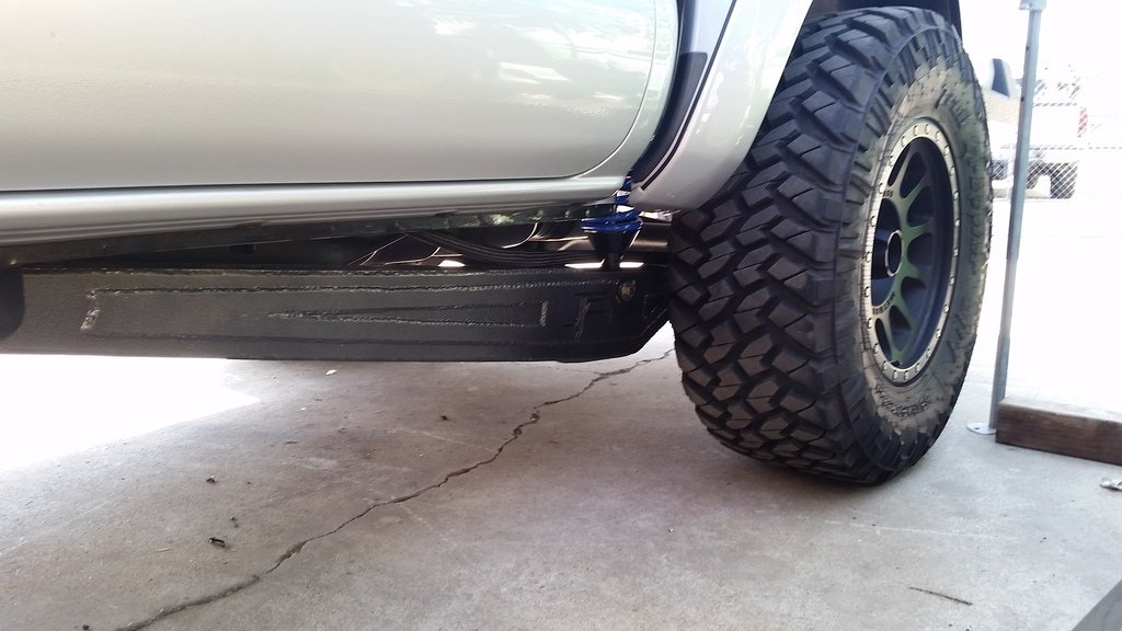

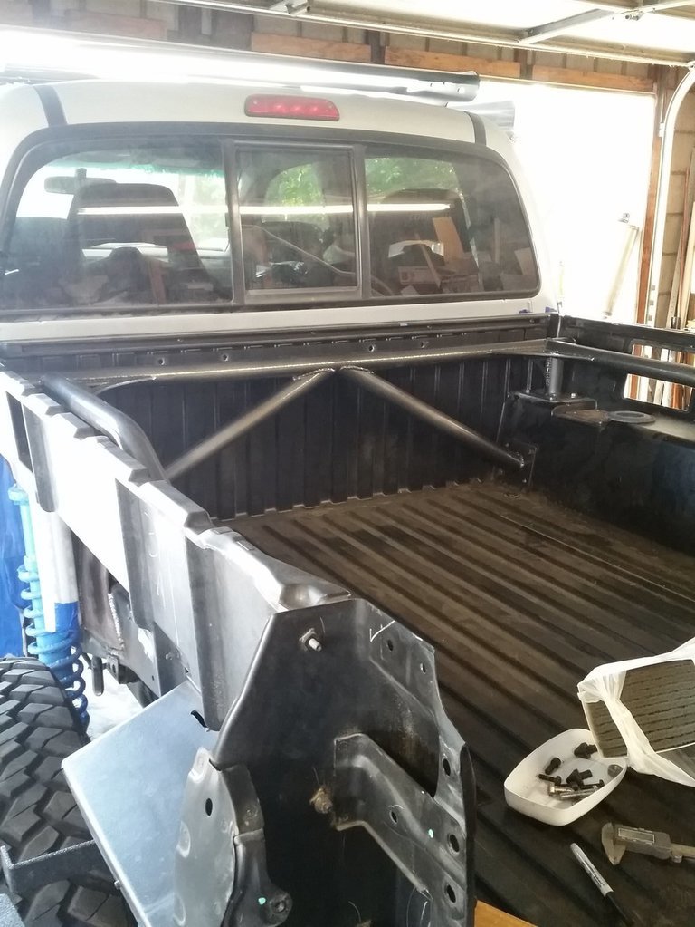

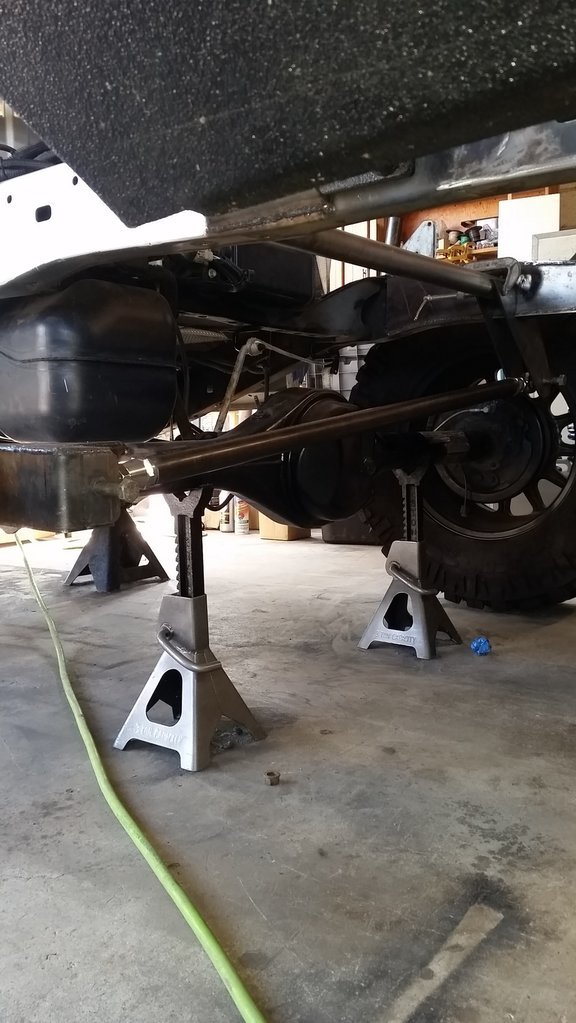

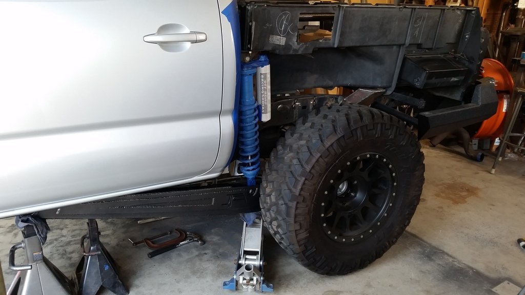

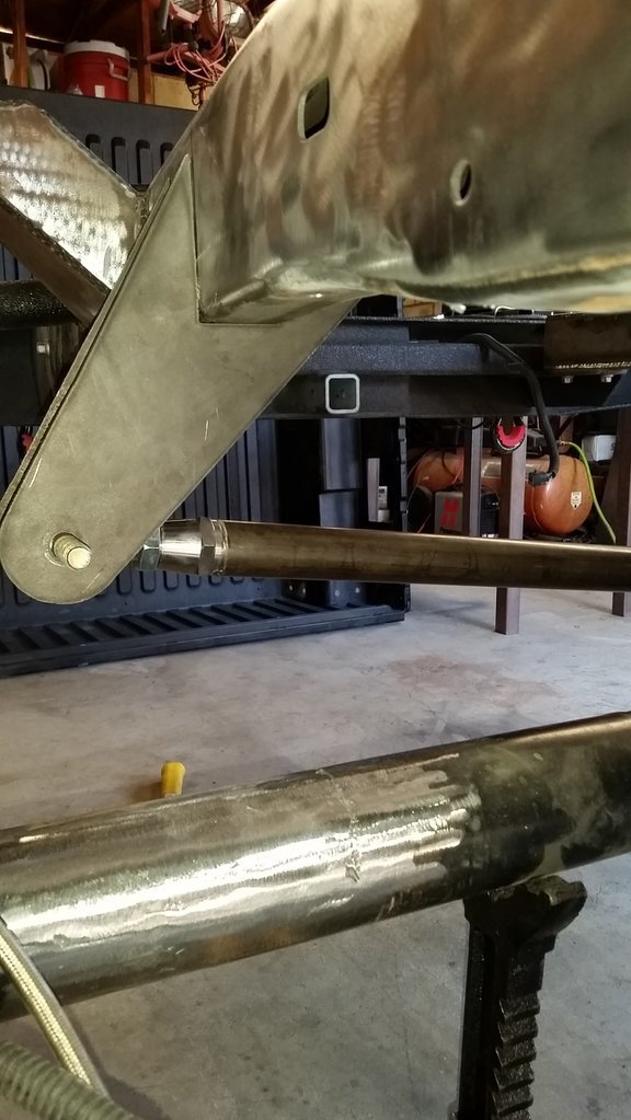

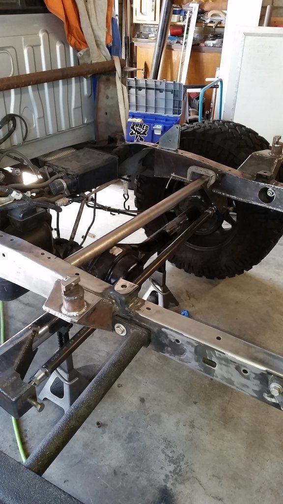

    The dcsb I'm finishing up. Should be on its own weight by Monday/Tuesday.

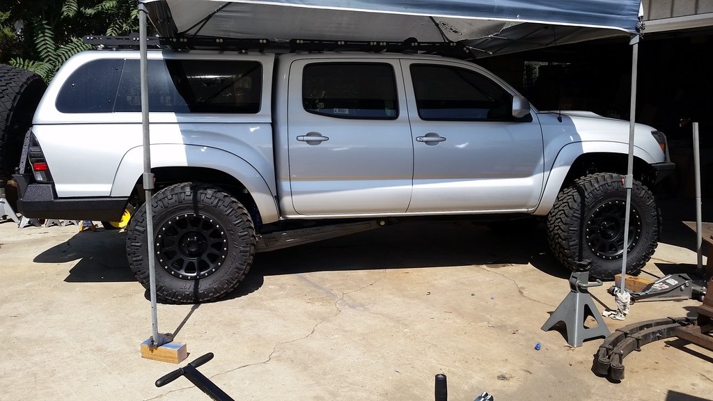

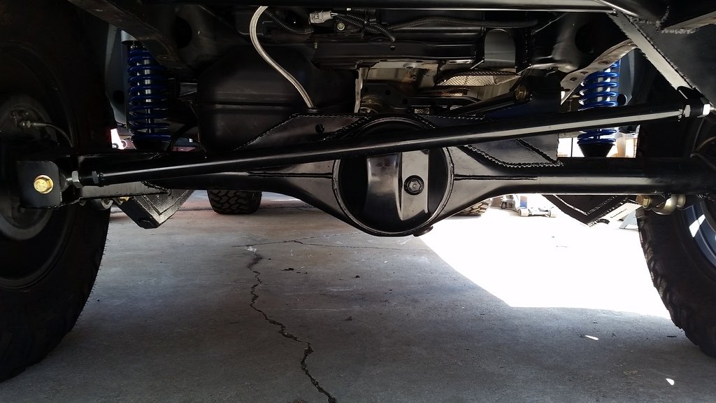

    Aside from some spring swapping, and some small details, she is finished.

    ...and yes I still have to cut the rear fenders :sawzall:

    And the fronts :D

    I already cycled the front and cut the front fenders, they had about 2 1/2" cut out and they clear at full bump. The truck is sitting about 2" too low right now which is why Jeff mentioned we are waiting on some springs to set the truck at its correct ride height.

    Oh sweet I didn't think you guys would look past it so just threw that out there just in case it looks great can't wait to see it mobile

    Very impressive work, Jeff!

    What is the advantage in using an upper link in controlling pinion angle, as opposed to mini air shocks in the rear axle?
  16. Oct 12, 2015 at 4:26 PM
    #36
    jeffz0rz
    jeffz0rz [OP] Well-Known Member
    Dec 9, 2009
    #27296
    3,958
    san diego
    1996 tacoma 4cyl, 5spd
    There's no mini air shocks to rebuild and replace, one of those shocks leaks out on you out on the trail your SOL. Those little air shocks are also really expensive. A single upper and panhard bar will always be superior.
