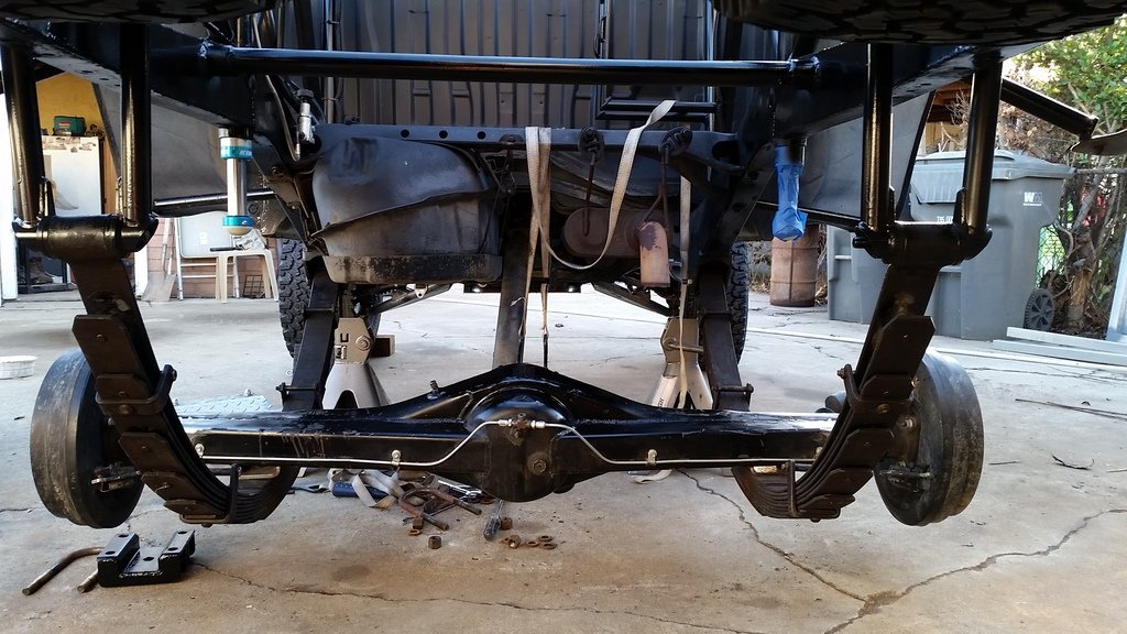

    Tundra swap just about wrapped up. Shock mounts tomorrow then it's on its way home.20151231_153911_8c8261cbacb22e4d317c31f8dc40059f6f588e00.jpg

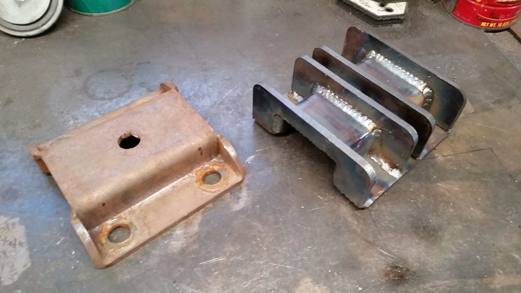

    Beefed up these spring plates. With no ribs, these start to cup when the u bolts are clamped down.

    I know very little about this level of off-roading. Are watts links acceptable for these types of applications or is a panhard bar such as the one in the picture the optimal way to go. Just curious. Your works looks amazing btw. Most of my knowledge of suspension is from minitrucks with air ride.
