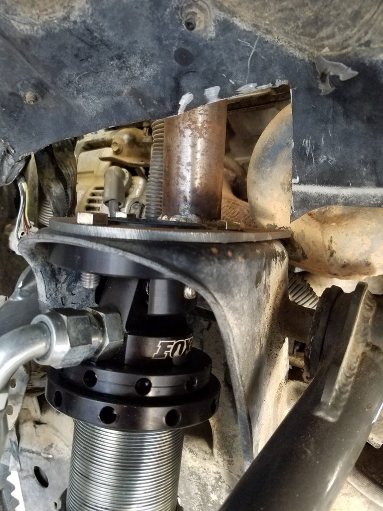

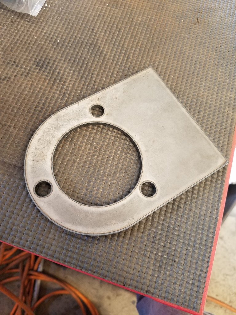

    Those of you who are do-it-yourself'ers might like this. 1st gen coilbucket top hat for engine crossmember. Bolts on, gives you a place to build off for an over engine brace.
    They come as just the plate. Ill make a thread to see if theres any interest. Im thinking $55 shipped. 2 plates, no hardware.

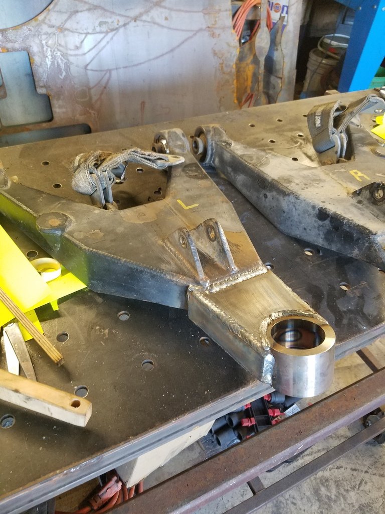

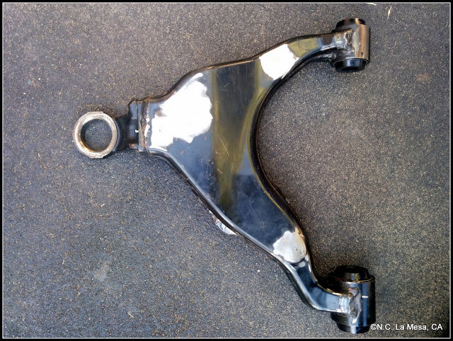

    Redoing the lower for a uniball?

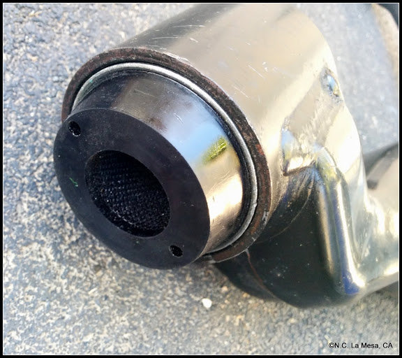

    These older LCAs had this long cast ball joint reciever sticking out. Cup is welded inside, and plated outside. Ugly arms to begin with, ugly after but solid.

    I really want a lower uniball. Super paranoid about these balljoints
    What do you do about the spindle now??

    Well, the ball joint in the steering arm is removed, it is then capped and welded to accept a three quarter inch Bolt. I'll get you a couple of pictures today when I get back to the shop. Let me know if you're interested in the swap.

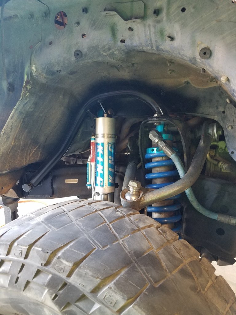

    Added bypass mounts to @BrownMike 's sweet 1st gen.
